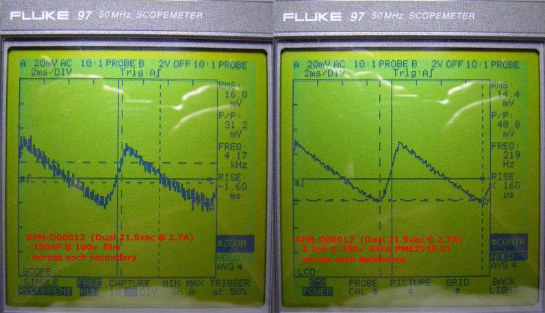

Scope shots, comparing transformer secondary capacitor effect:
- LM3886, BrianGT Boards
- XFM-D00012 Toroid (Dual 21.5vac @ 2.7A) (from ApexJR)
- 2 x 10,000uf @ 50vdc, Nippon Chemicon SMH per rail (total of 4)
- 2 x 100uf @ 100vdc, ELNA Cerafine, each amp
- shots taken at idle, no-load condition
- 150nF @ 100v (yellow box film)
- across each secondary
- 2.2pF @ 250v RIFA PME271E X1 Series

The AVX BF014E0154J is more likely to cause a pulse than to remove one. If you mapped it, it comes out to nearly ESR0 @ 10x less than its value, almost exactly like a blackgate or cerafine would do (if they existed in such a small size). So, at sizes larger than the recommended 1.5nF (see chart), you had a highly variable RC network, possibly down into the range of a 1.5uF cap--a lovely property of polyester if used on purpose. That model is a specialty product meant for bypassing large electrolytics in power supplies.
Hey, see if that yellow box cap has a T on top of it.
Maybe try a BC Vishay "370" series? Those are "normal" caps.
Howabout a nice old-fashioned 100v+ ceramic disc?--EDIT2: use a really cheap ceramic disc, not a "hi-k" or other specialty model.
EDIT:
THANK YOU!! Thanks for confirming that cap-too-big makes more noise. We had discussed this earlier. And some people think that 10nF is the only thing to snub the rectifier, then they buy a larger transformer. . . but, with this documentation, they can just buy a smaller cap. Wonderful!

no, no "T" on top of "yellow box" 150nF film cap
- have no idea who manufacturer is...
- (parts usually from surplus or excess lab stock)
You are Welcome
- if you plan on using scope shots as reference, use corrected version, below
- have used small value capacitors on AC power supply transformers for years
- posted difference for educational purposes, so others can get an objective point of view.

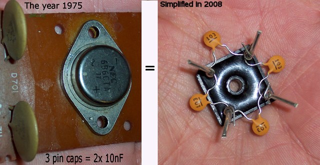

What about the common practice of "ring around the rectifier" like in this photo?:
EDIT: The original was on a 50vct (2x25) center tap of 300va.

This evidence does nothing to confirm a cap too big causes noise, quite the opposite it suggests that for every frequency of noise present the appropriate cap value has to be chosen to combat it. It's not as though we "must" choose only one capacitor if we're being picky about every last constituent of noise.
! said:This evidence does nothing to confirm a cap too big causes noise, quite the opposite it suggests that for every frequency of noise present the appropriate cap value has to be chosen to combat it. It's not as though we "must" choose only one capacitor if we're being picky about every last constituent of noise.
Of course you're entirely correct that just the right size is much better than either too much or not enough.
I'm just saying that the worst option is too much capacitance (too big). That was posted that for a "signpost" type guideline, because the component varieties of diode, cap, and transformer may make a "just right" size nearly impossible to discover unless one owns sophisticated measuring equipment.
I think its not so much about being picky on removing a small amount of power noise, but rather about little, inexpensive caps helping to match up diode+transformer choices and/or helping to decrease heat outputs. This is about money--purchasing many diodes and transformers to "luck" into the perfect combination and/or also buying large heatsinks. Or, we could find out what two little caps can do.

Another way to relate "snubbing the rectifier" is because there's a tiny capacitor directly across the secondaries of the transformer. This is quite similar to the early Pioneer B20 projects that had a Piezo tweeter (which IS a capacitor directly across the coil of the B20). In that application, any similar size capacitor could have reduced the peak of the B20 and it wasn't necessary for the capacitor to output sound--a sound that some of the projects aimed rearwards at a wall or upwards at the ceiling. My point is that the small cap across the B20's coil was not a crossover effective within the audio band (that capacitor size didn't harm the useful signal), but yet, it was a capacitor, and, as such, did remove some of the effects of inductance.
For reference, that was 130nF (0.13uF) according to this: http://www.piezosource.com/general/datasheets/Piezo_1001_1005A.pdf document. That is probably also the maximum size to consider for use in a speaker output zobel. In my opinion, its quite inappropriate to use the same maximum size all the time, when too-large is too-easy (component variety and more accidents waiting to happen) along with documented adverse effects. That also includes roasting the resistor. Why not go smaller on the speaker output zobel cap too? The application is quite similar to the one in this thread. Surely we could generate a chart for that too?
