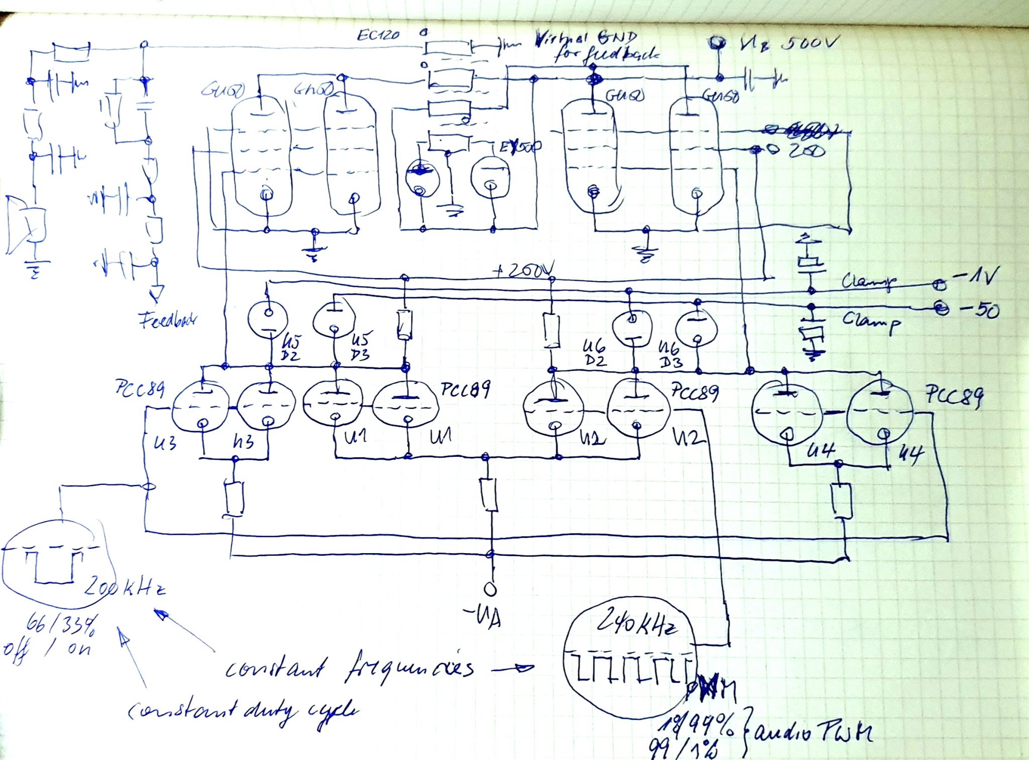

Now I made certain calculations, datasheet inspections and now a fast sketch again.
Omitted is the part of square wave generators and the feedback, which was already sketched.
The focus here is, how I want to guarantee a fast and reliable switching between -1V and -55V at the GU50 g1 pins.
U1 and U2 are a usual complementary amp with common cathode resistor feed of 30mA. Each triode will run at 15mA when on.
Result is a 30mA charge/discharge drive at g1 of the GU50.
U3 and U4 are switched simultaneously, on or off. They have independent cathode resistors and common gate.
During on, the PWM from U1, U2 appears at the GU50s. U3 and U4 are off.
During on of U3 and U4, all 4 GU50 are switched off and the transformer will rise all voltages in the last magnetization direction and one of the EY500 diodes will pump energy back into supply of 500V.
New is the clamping of the g1 swing by a pair of EABC80 tubes. Their d2 and d3 each are capable of iA 80mA, which is way enough. Important is the real independence of the diodes and the handy clamp voltages.
The swing at g1 of all GU50 is the same for all and always in required, allowed values only.
U1 to U4 degradation or drift are without danger.
Here the sketch:
Depending on a secure dimensioning of the resistors, the clamping is not excessive but will not drift. The clamping voltages are regulated.
Here the sketch:
Depending on difference of reality and dimensioning. But they start to conduct at 0V and go down to 40 Ohms.Looks like differential amplifier with inhibit input . Interesting , how many volts drop have clamping diodes in tube variant ? Traditional diodes would drop only volt or so ...
Nearly precise setting is possible.
I can adjust operating points of the PCC89 and the clamping voltages - easy and secure.
Funny - this very old EABC80 is ideal.
The aim is, to securely switch off all GU50 at once and to keep the differential amp tubes in operating point conditions.
When the U3, U4 return to off, current will immediatly charge g1 of the correct GU50 pair.

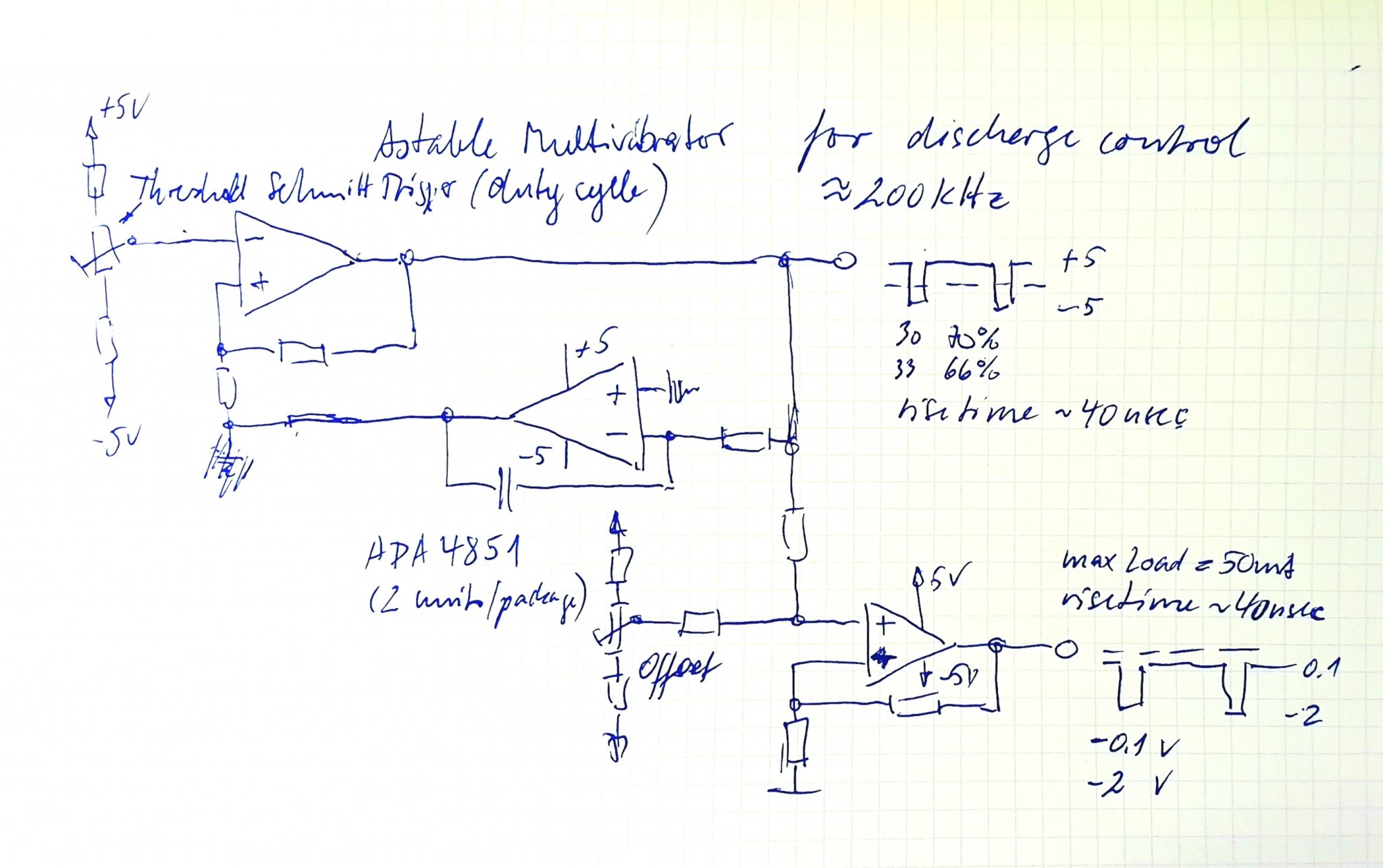

Here is the starting point for the signal generators. It is a standard opamp circuit. Both generators are essentially the same:
Too opamps form a loop between schmitt-trigger and integrator.
One is buffered and level-adjusted at the sqarewave output, the other at the integrator output. Level adjustment is required for the PCC89 gates of the driver circuit. Their swing is below 0V only, at around -2V the triode is in low current condition already.
Here is the circuit:
You might be surprised, I brake my rule for tube circuits only. The reason is simple:
It would take me too much time, to design matching circuits. Too many options, with drawbacks of unknown extent, for both generators.
Another reason: These generators shall run with full specs, before any heater will allow significant currents at the anodes. It is important to note, the PCC89 is heating up quicker then the GU50.
Each channel needs 12 tubes for the amp.
I estimate, if I continue with tubes only, I would reach target, but the innovative part is already in sketch. The remainder is just time consuming.
The opamp is fast. Settling time at g of 2 is 40nsec to 0.1% accuracy. Gain/Bandwith is about 130 MHz - way enough!
It can drive up to 50mA and uses ± 5V supply - ideal for the PCC89 gates.
The circuits are basically the same. One schmitt trigger is symmetric, the other is not. The symmetric is for triangle, the other for magnetic discharge control.
