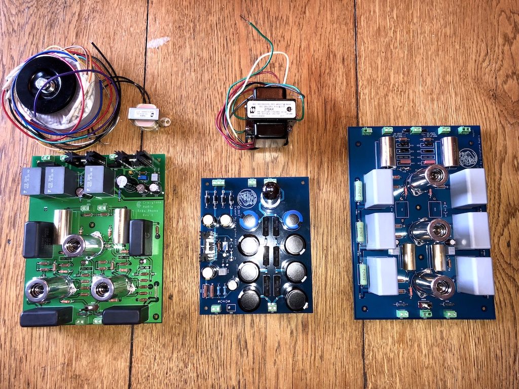

This was my kitchen table Friday ... and the second picture is this afternoon ... $600 worth of Mouser order later ... :D

Picture 1 and 2
...$600 worth of Mouser order later .....

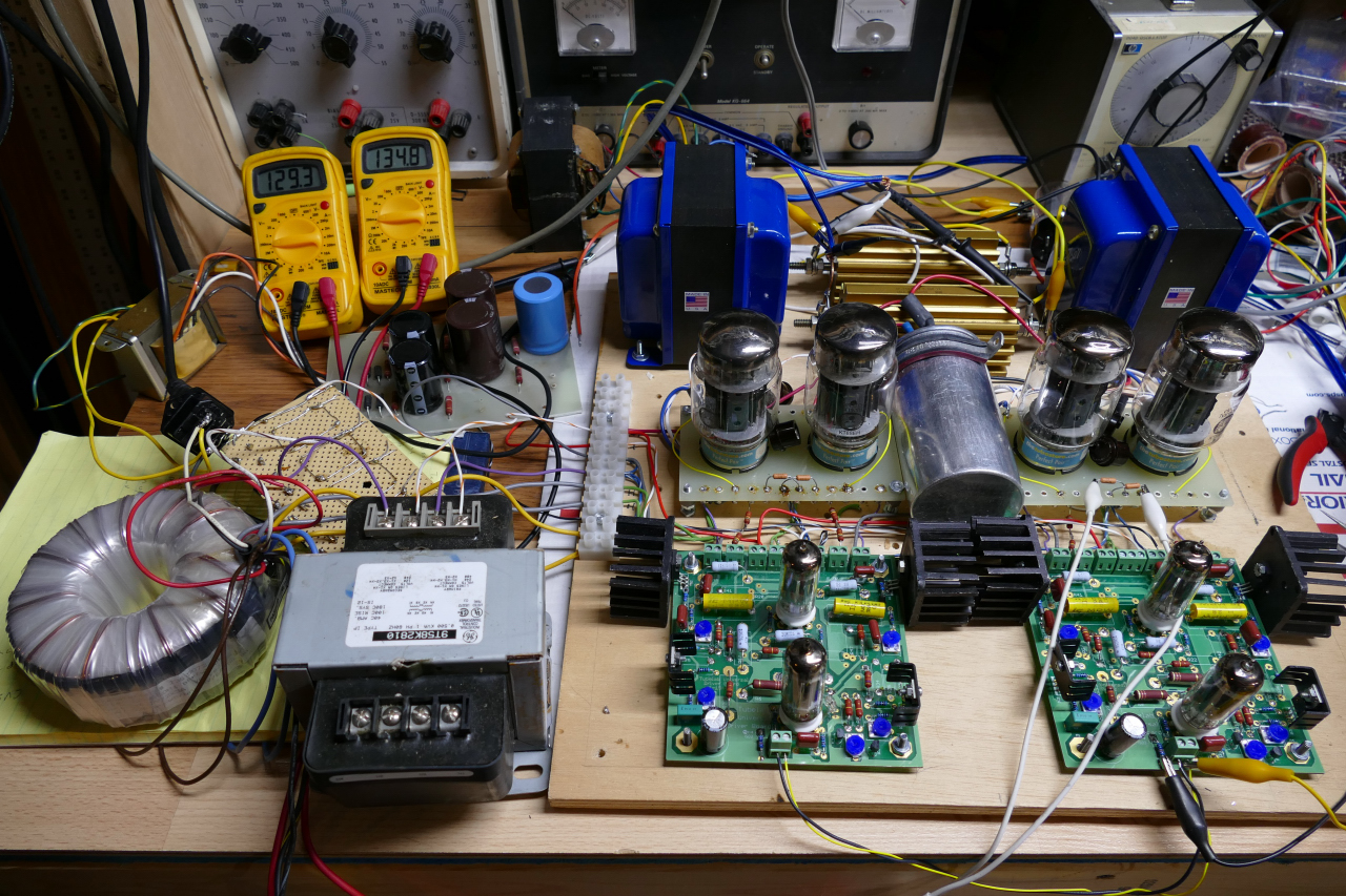

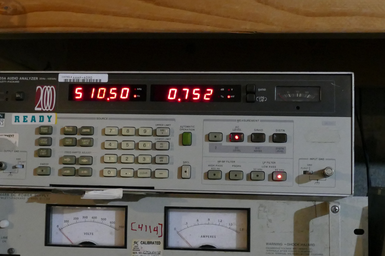

SO, I decided to build a KT88 / 6550 amp in a Landfall box. The amp works nice, but all those bench supplies won't fir into the box. Time to make a power supply.
First experiment:
I dig out a toroid that looks like a good fit. I bought this thing at least 10 years ago, probably more, when they first appeared on the market.....I have serial #001. It cost me $100 at the time which I thought was outrageous, but I wanted to make a big (at the time) tube amp. That amp never got built, and those transformers now cost $280!
https://toroid.com/Portals/0/236.5072.pdf
The transformer has two separate 6.3V 5A heater windings, so I wired one to each channel.
There is a 720 VCT 750 mA winding, so I connected it up to a perf board rectifier circuit that I made years ago. Basically a FW rectifier made with a bunch of diodes in series and a cap bank made with a bunch of caps in series / parallel to give about 200 uF in the configuration used here.
I connected this directly to the amp's B+ input, and flipped the switch.....as expected it went hummmmmmmm. There was about 10 volts of 120 Hz on the output, but I wanted to measure DC voltages so I cranked it up. Clipping came at about 65 watts where the DC voltage was about 480 volts. Idle voltage was about 520 and power up voltage (before the tubes got hot) was 545 volts. Obviously I need a choke, but I can't find one.
I found this tiny little choke stolen from an HP audio oscillator. I have a bunch of them, so I hook one up. Idle B+ was about 490 volts. A full power attempt resulted in 40 watts at a B+ voltage of 400 volts and a bunch of smoke and stink from the choke.
I remembered an old trick from when I was a kid making zero budget guitar amps. Find a power transformer with two 120 volt primary windings that's big enough to eat all the B+ supply current (600 mA ) and wire the two primaries in series with the power and ground wires from your rectifier / transformer / capacitor circuit like a common mode choke. I fetched a 500 VA industrial control transformer (overkill, but handy) and wired it into my simple power supply. Did it work?

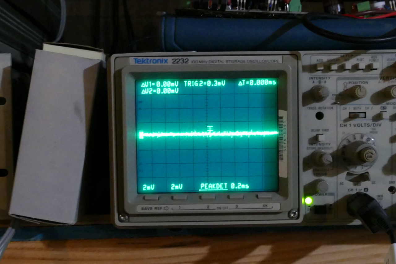

Lets say I have NEVER build a BREADBOARD this quiet. I had to run around turning things off to get a reading on the background hum......It's nonexistent. The Walmart LED shop lights were filling the scope with tiny pulses around 24 KHz at the 9 mV level. With them and the LED ceiling lights off, the voltage at the speakers with the input disconnected it 700 MICROVOLTS, and that's HF noise, probably from the 65 inch TV in the room above me.
Previous distortion measurements showed low distortion at low power, but they were with regulated bench supplies. Now I have just a single capacitor on the low voltage supply that feeds the mosfets, and a CLC (the transformer) filter on the main B+. How would this perform in testing?
Maximum output power is obviously lower since the previous testing was done with a regulated 525 volt supply. The unregulated simple supply made 545 volts at power on, dropped to 510 at idle and 485 at 70 WPC (both channels driven).
As mentioned the background noise on the output is 700uV (0.7mV) the analyzer could not read its frequency, and the scope showed noise with some HF spikes. The distortion numbers could now be read down to 10 milliwatts where I couldn't go below 100 mW before.

I have a 400 volt and a 360 volt Antek toroid. These are much cheaper, and technically 800 mA short on heater current. I may try the 360 volt version, but the 400 volt transformer may result in too much voltage unloaded and at idle.

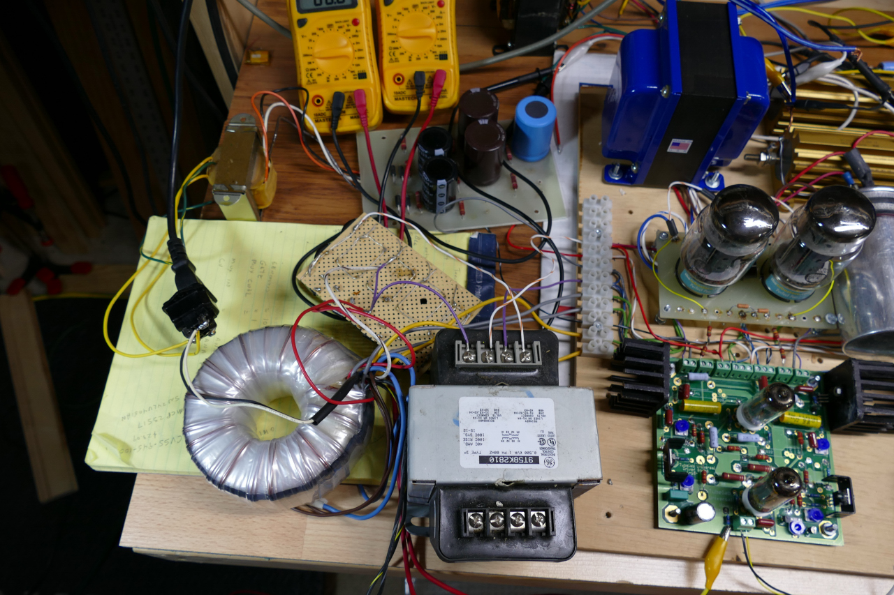

Picture #1 shows the crude and simple power supply.
The HV winding on the toroid feeds the perf board which has diodes and capacitors. Its output goes through the primary windings on the big GE transformer (silver and black). The purple wire is the negative output, and it goes to the ground terminal on the breadboard. The orange / white wire is the positive output and it goes to the B+ terminal on the breadboard.
The small transformer to the left of the meters ia a 50VA isolation transformer. It has a pair of 120 volt secondaries which are connected to 4 diodes and 2 capacitors on the green board to make +/- 160 volts. The common wire (grey) is connected to ground on the breadboard. The negative 160 volts (black) is connected to mosfet - on the breadboard, and the +160 volts (red) is connected to mosfet + on the breadboard. The meters are displaying the cathode currents in one channel at 65 WPC.
Picture #2 shows 752 microvolts of noise. The number randomly bounced around between 600 and 800 microvolts. The frequency display randomly showed anything from a few hundred Hz to 10 KHz.
Picture #3 shows the scope on its most sensitive setting across the speaker leads.

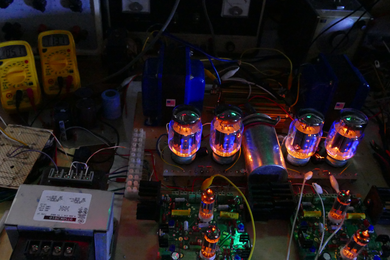

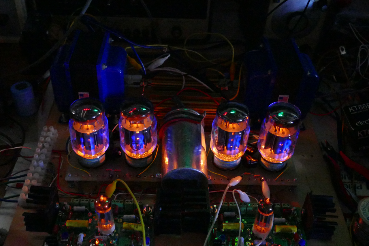

While the big Antek was powering this thing, I turned off the lights and took a few pictures. These EH KT88's are famous for the "blue on the glass" glow (good glow), but when have you ever seen a 6CG7 with blue on the glass?

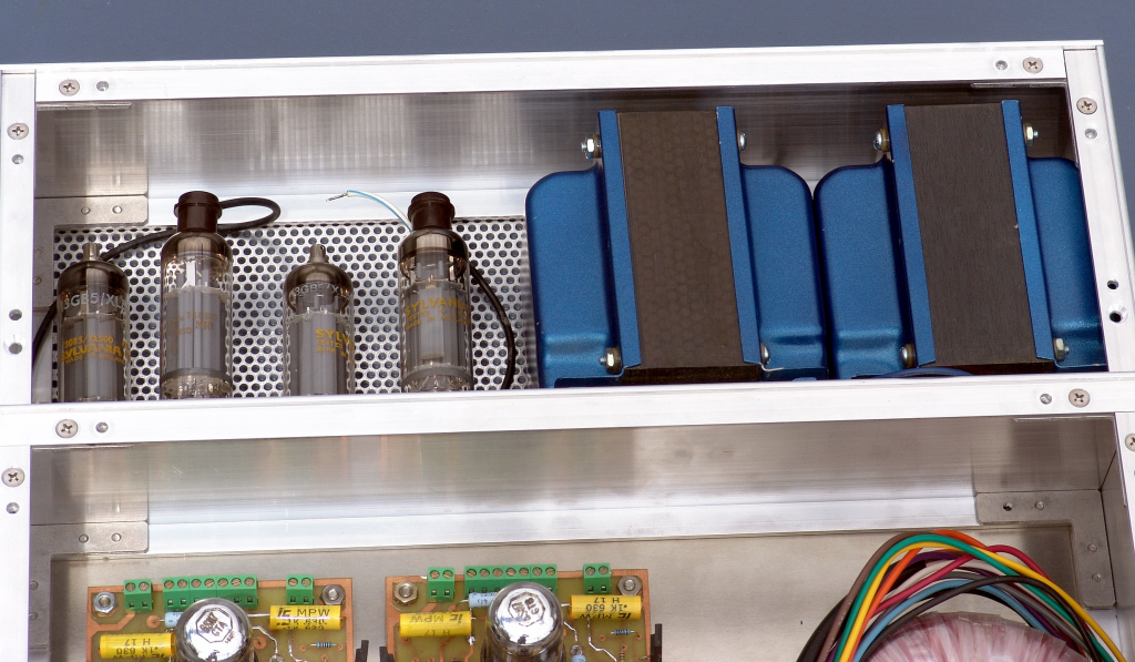

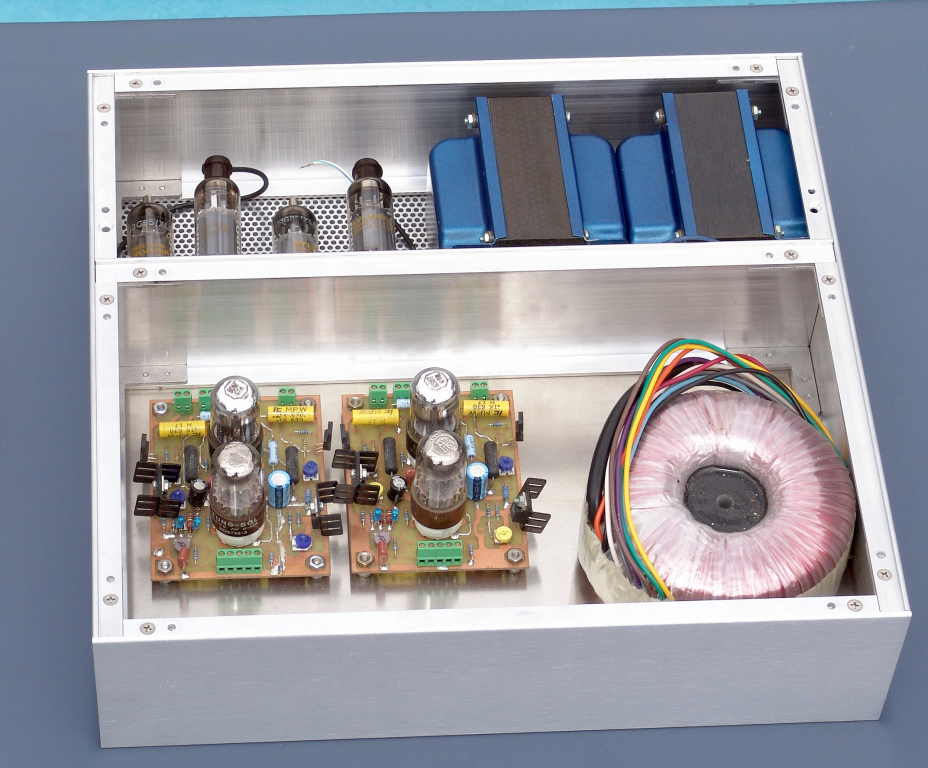

Did you perforate that cover in the PA section, or do they do that for you?
That chassis is exactly as received from Landfall. They had several options at to how it could be made, and I asked if the rear section could be perforated for airflow. That's what I got. All the aluminum is 1/8 inch thick for those monster OPT's.

It is, but it won't last. I put a pair of the same tubes into my SSE amp and the blue glow faded within a few months, and was totally gone within a year.

So do you know why the glow disappears?
The blue glow is caused by stray electrons hitting the glass at high velocity causing some impurities in the glass to phosphoresce. It has been stated that the deep blue comes from Cobalt. The two main theories as to why the blue fades is that the Cobalt looses some of its phosphorescence over time, possibly due to the electron bombardment. It has also been stated that the vacuum degrades over time, and the resulting gas captures (ionizes) the stray electrons, or slows them down enough that they are attracted to the plate instead of zipping through the holes and hitting the glass.
I tend to believe the second theory. The glow seems to be related to the voltage applied to the tube's plate, and not the current. This would cause the higher electron velocity. The images on the glass are sharply defined now (NOS tubes) but will get fuzzier as they fade.
