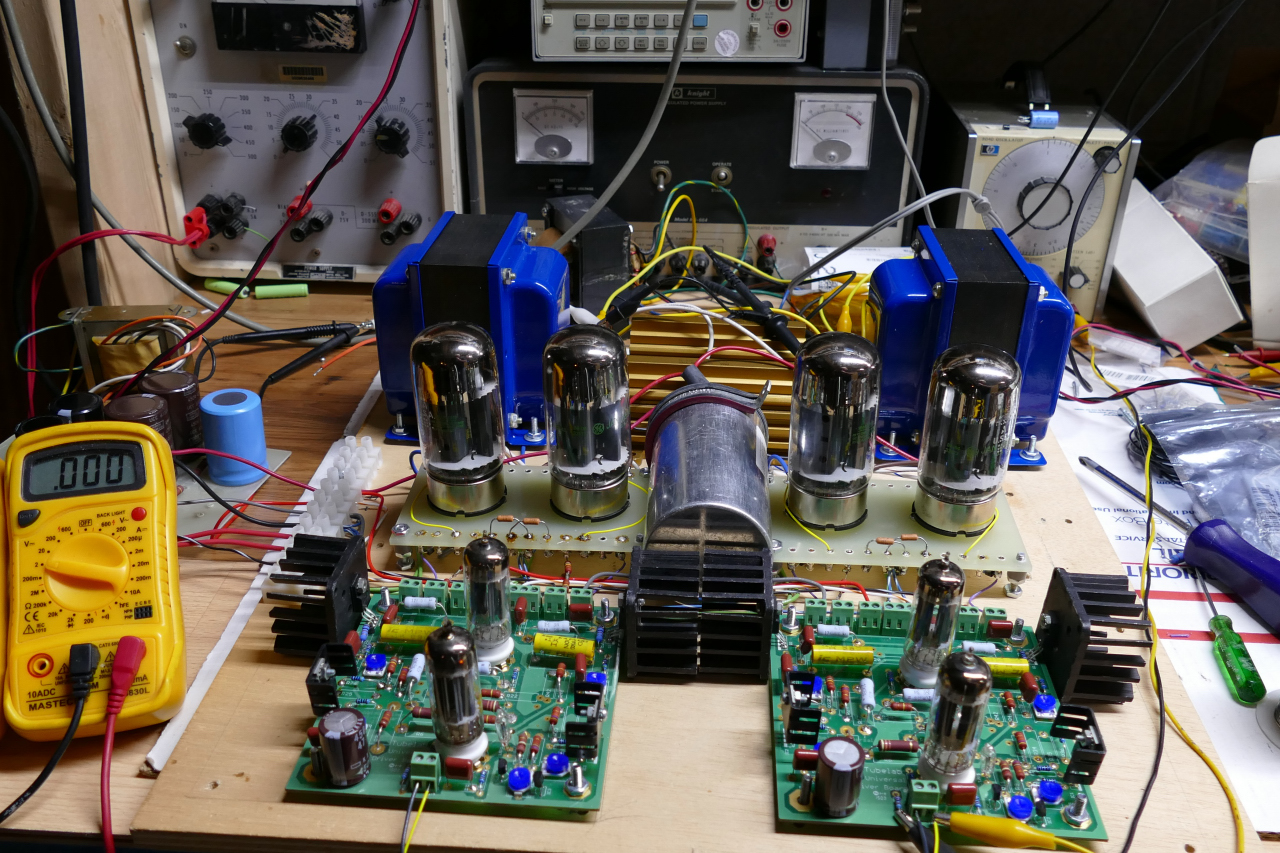

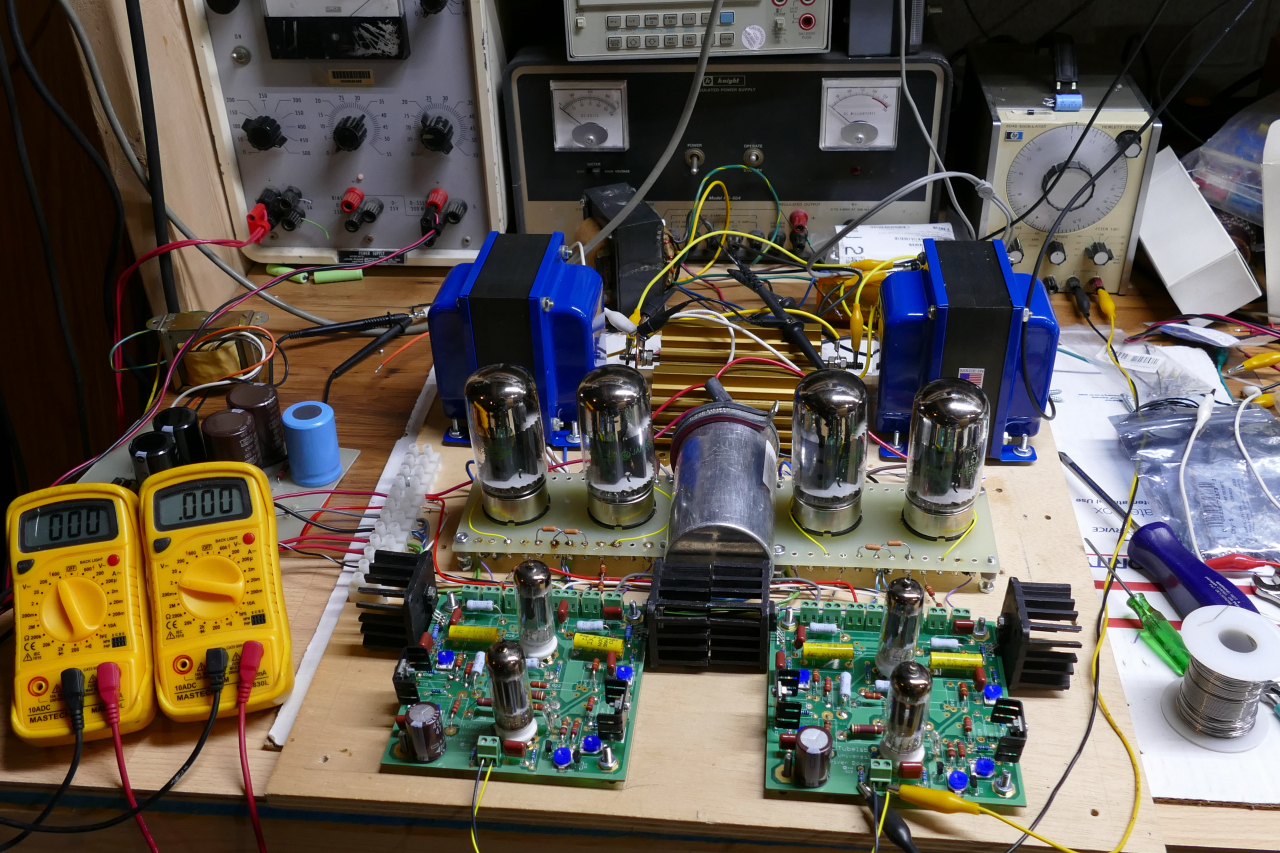

But even with the diversions and 3 wiring mistakes, I plugged it in last night at about 9:30 PM.
So what happens when you fire up an amp with the control grid of some Chinese KT88's grounded (0 volts) and the screen grids left unconnected?
In theory, nothing should happen, but modern production tubes often have a less than perfect vacuum, so gas contamination could create a path for current flow.......Well, both of my 15 year old Chinese tubes drew exactly 4 milliamps. No KABOOM!

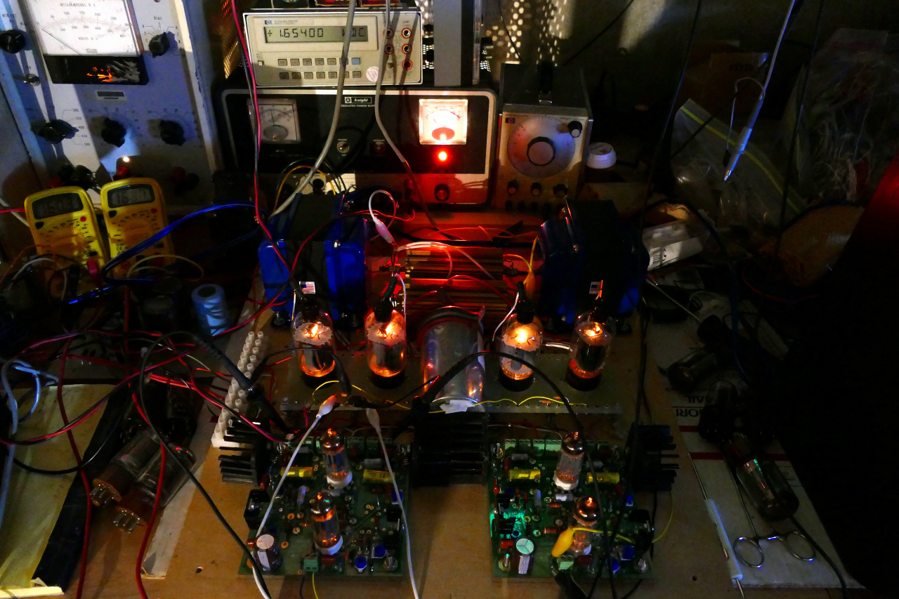

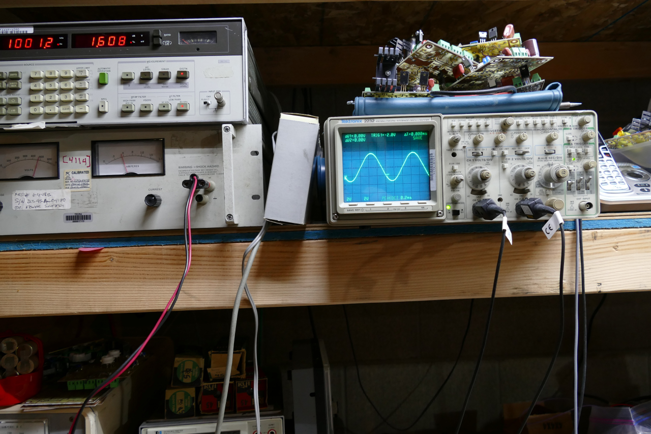

After fixing another wiring error, the amp was working. With both channels driven by the same signal generator I couldn't get over 50 watts per channel......DUH, my 300 mA power supply didn't like making 600 mA! I hooked up the big one. Both channels are almost perfectly matched. The scope traces overlap from no power to 75 watts where one clips about a watt before the other.
I left it at 75 watts for about 20 minutes while I put my camera on a tripod and took the usual shot in the dark pictures. No glow, no problem, just power. Tube current was 150 mA each.
Today, a few measurements, then SPEAKERS!!!!!!

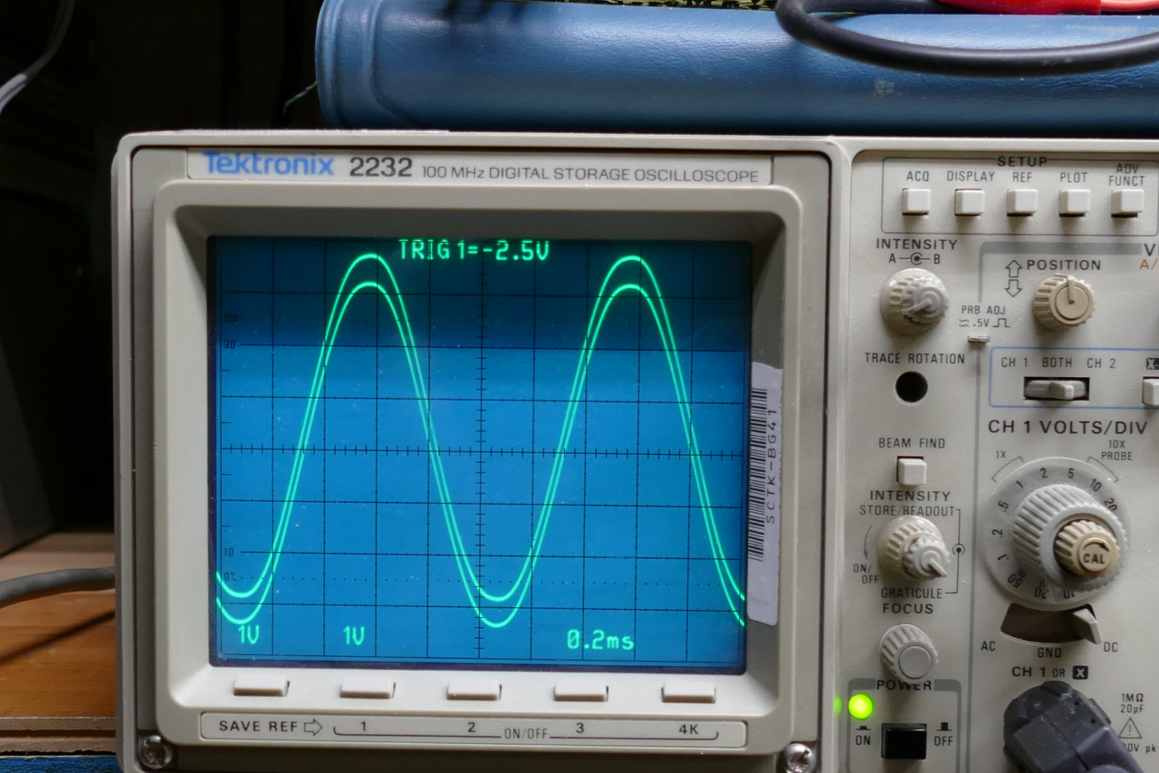

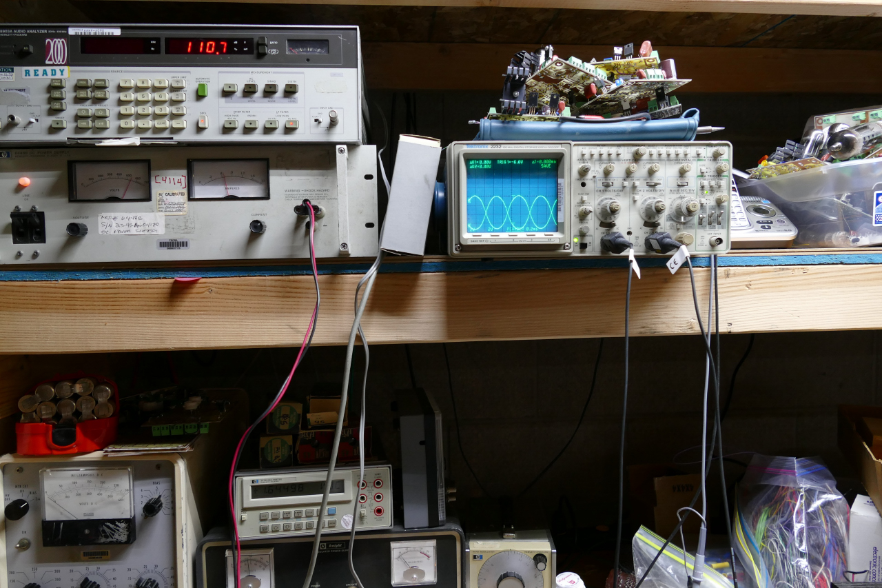

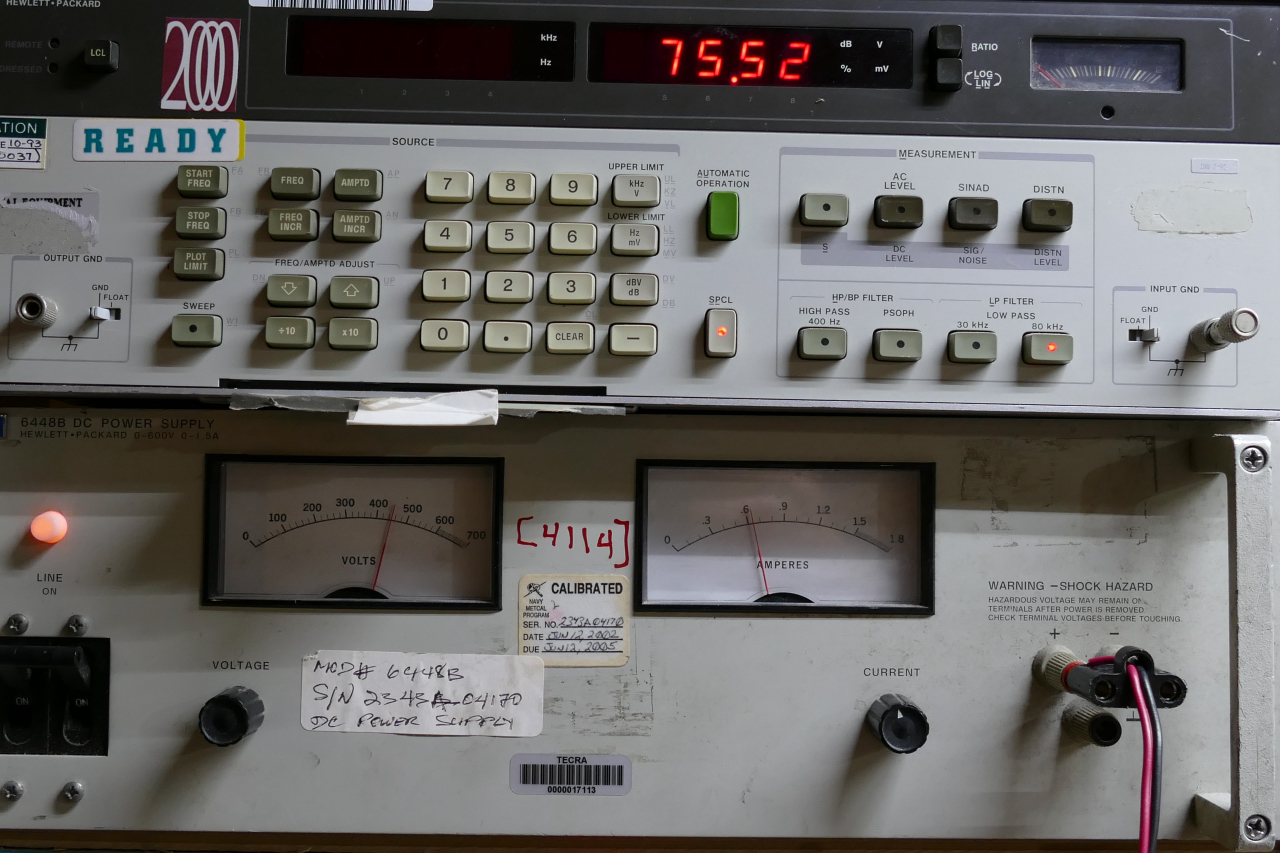

I did a quick frequency response test at 50 watts through the Edcor OPT's. As expected the bass response was outstanding. The lower 3db point was beyond my range of measurement. The first hint of core saturation starts at 10 Hz. The upper 3 dB point is 27 KHz. The amp is 1.27 dB down at 20 KHz. This is with no global feedback around the OPT.

I wanted to find out just how much power supply would be needed in a real world amp. I already know that to play 75 WPC sine waves for a week straight would require 450 volts at 600 mA, but I don't need to do that. How much current is needed for loud music that just touches clipping?
So I cranked on this thing for a couple of hours playing all sorts of music at full tilt. I could see clipping on the scope several times, but never saw the current meter go above 450 mA. Much of the current for transients comes from the big poly cap between the output tubes. Even with loud music cranked, the average on the meter hovers between 300 and 350 mA.

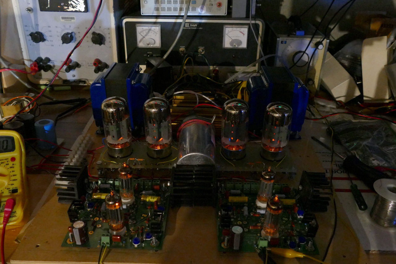

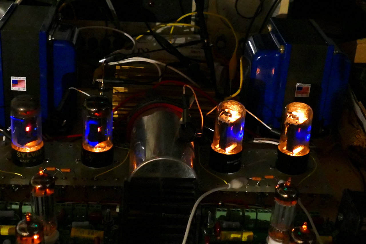

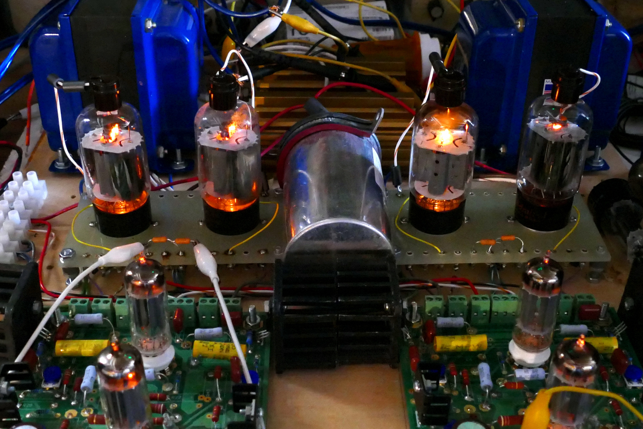

I added the necessary plate caps and plugged in some 7403's. I was met by a 200 watt power oscillator operating in the low VHF spectrum. It took some rerouting of wires, and a dozen industrial strength magic beads to tame that beast. Not the 3 big ferrite beads on each plate lead. All the grids already had the small sized beads right at the socket pins.
I can get 100 watts per channel in triode mode but it takes about 520 volts and 700 or so milliamps to get there. More experimenting tomorrow, and maybe I'll hook the speakers back up.
I spent a good chunk of Tuesday playing with the 7403's, and shelving them for the time being. They have the widest spread in Gm of any batch of tubes that I have played with trying to find 2 pairs that were somewhere near matched from 10 tubes obtained from 3 sources over 10 years shouldn't be that hard, but after several hours I'm still no closer than I was when I started.
It appears that 2 of the tubes may be bad, one for sure as it will go into a runaway condition such that removing all drive and applying -100 volts of bias will not cut the tube off, and the current will keep climbing until I shut the power supply down at 80 mA. This is usually gas, but there was no telltale blue glow.
Either way, pop any 2 good tubes in the amp, set the bias at 45 mA, and let her rip, and you can get 100 watts of triode power at 525 volts. The distortion numbers are nowhere near the GE 6550A's, and 4 out of 4 of the 6550A's read the same current at full power.
I will likely return to the 7403's later on, but unless I can find some matched pairs, I may not use them in my next amp.......'

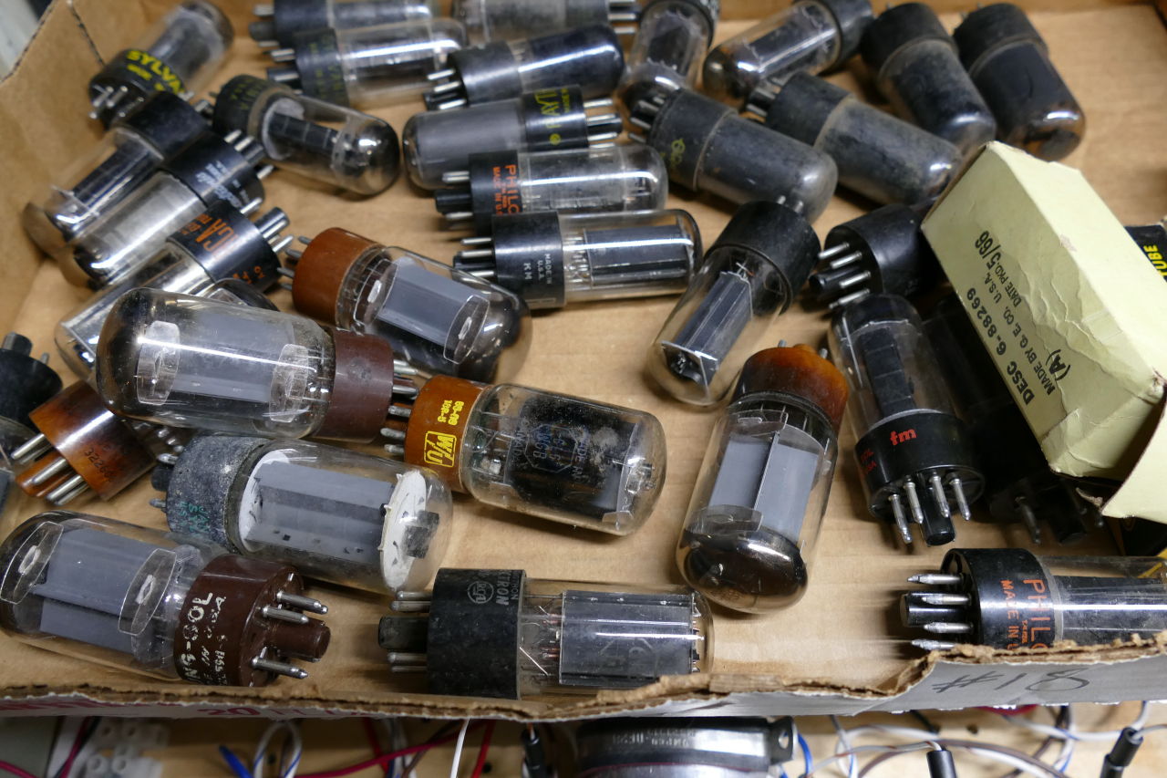

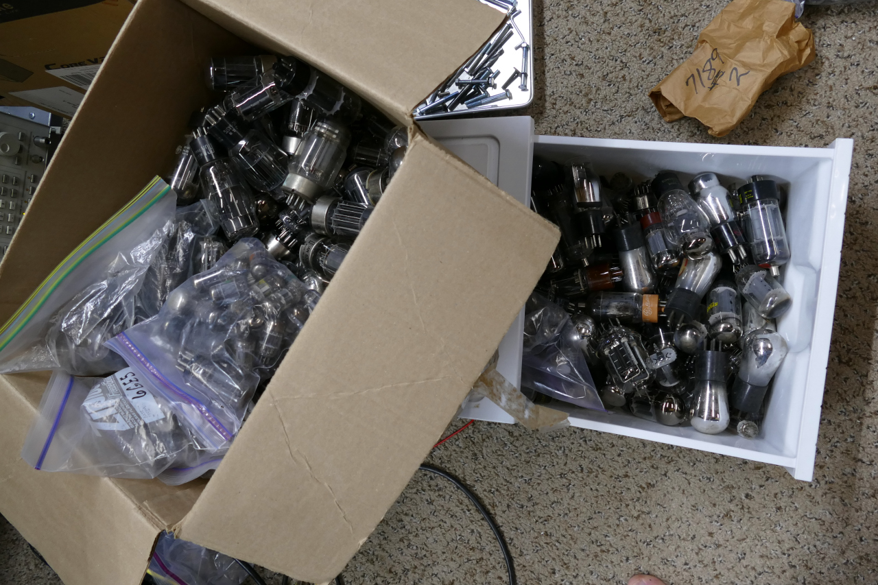

I have had this gallon freezer bag full of crusty old 6W6's. I had speculated that these tubes may blow up if allowed to sit idle on 300 volts in triode. I even toasted one of the ugliest tubes a few months ago doing exactly that, so....
I have devised an evil test. I could make up a little amp running 6W6's in triode on 300 or more volts and abuse it for a while to see how they take it.

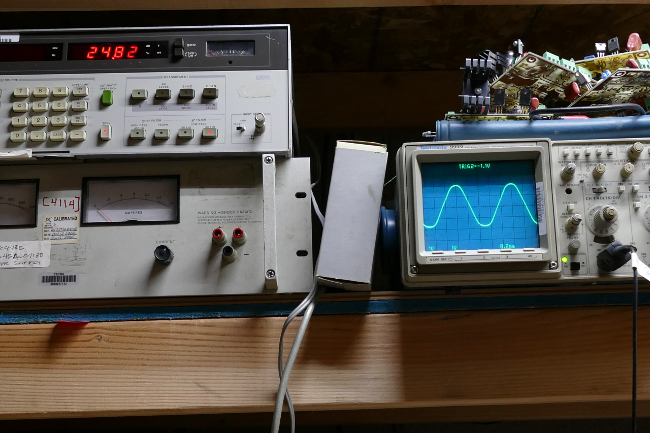

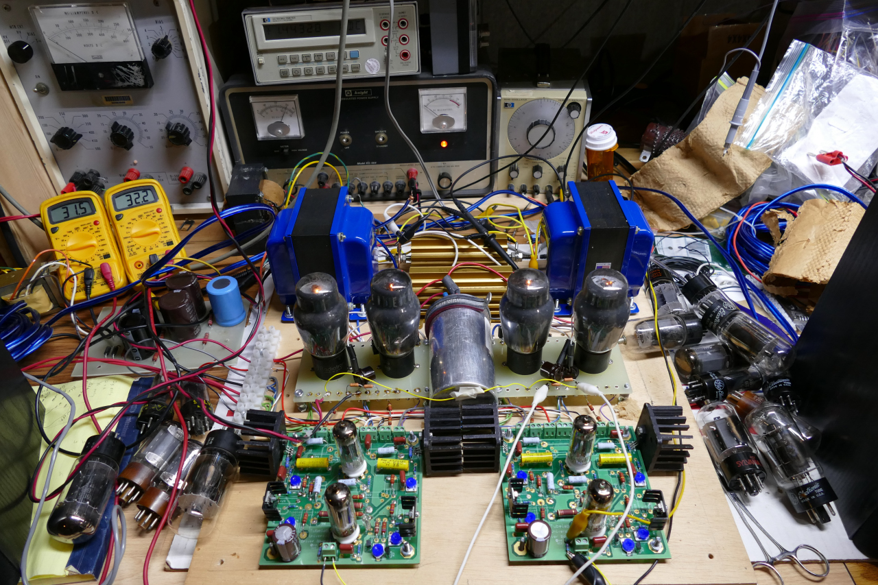

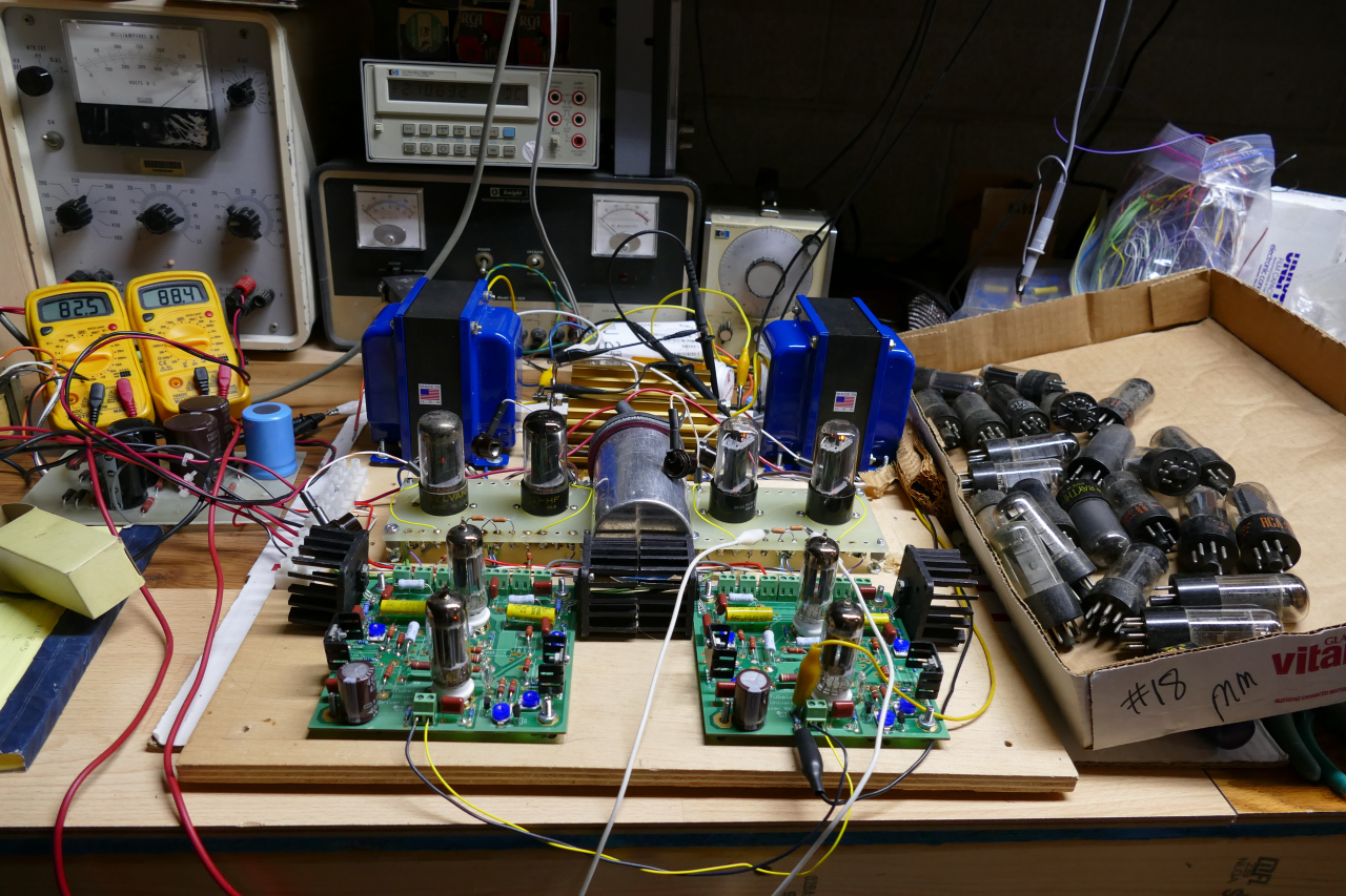

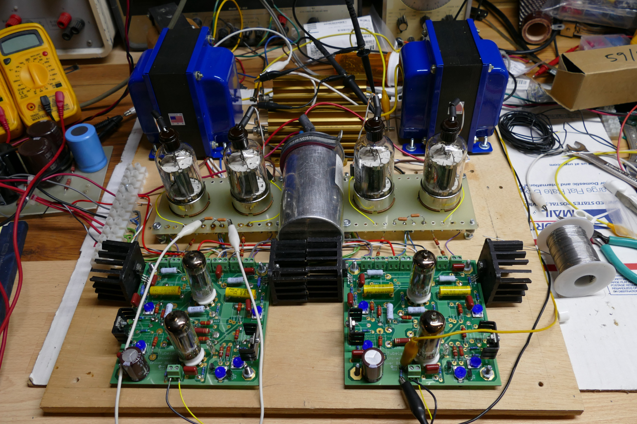

The picture shows the test amp, and the contents of the gallon bag dumped into a box. These are rather ugly, well used tubes, but it took me about 10 minutes to find two good pairs, and one bad tube out of maybe 7 or 8 tested. I picked the worst of the two pairs (old Sylvanias, I didn't want to fry some vintage RCA's that worked really well) for one channel, and a pair of identical military GE's for the other channel (the control pair).

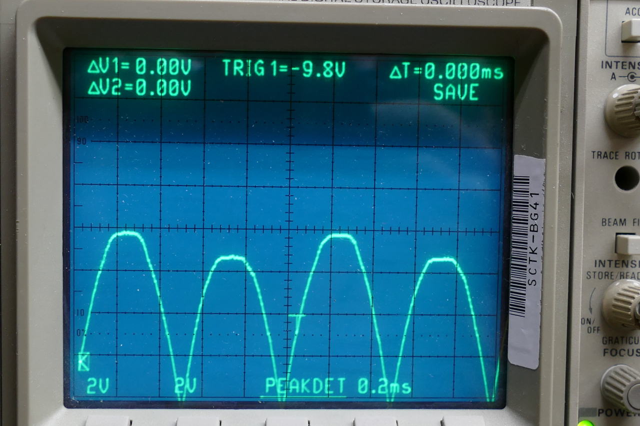

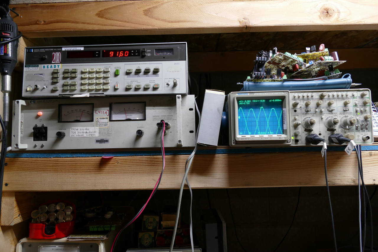

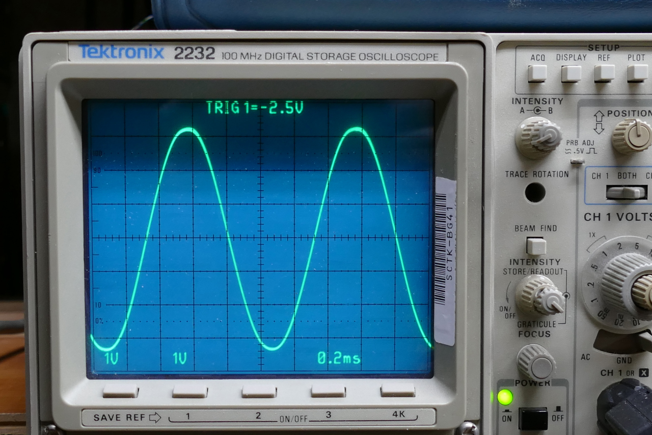

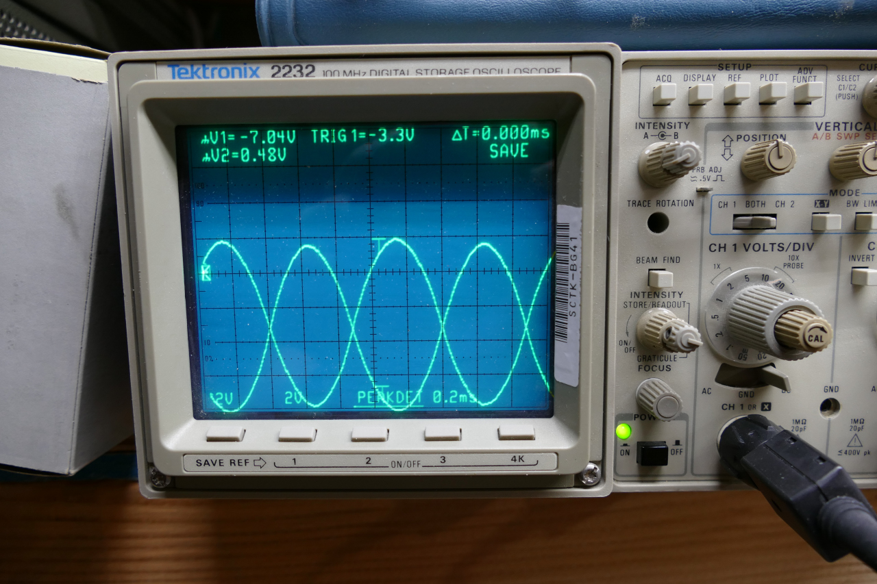

Both channels hit 3% distortion at around 25 watts (24.82W vs 25.01W) ands their scope traces overlap throughout the entire power range.

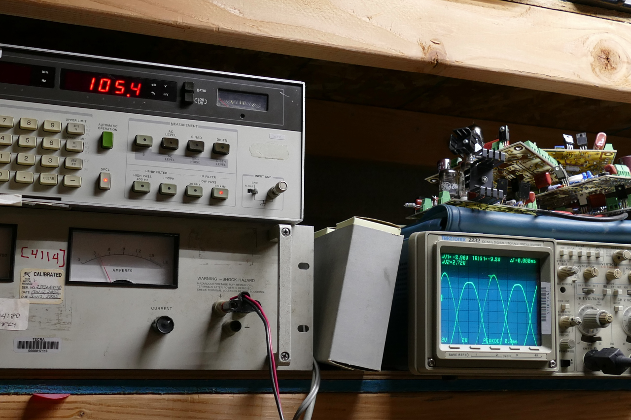

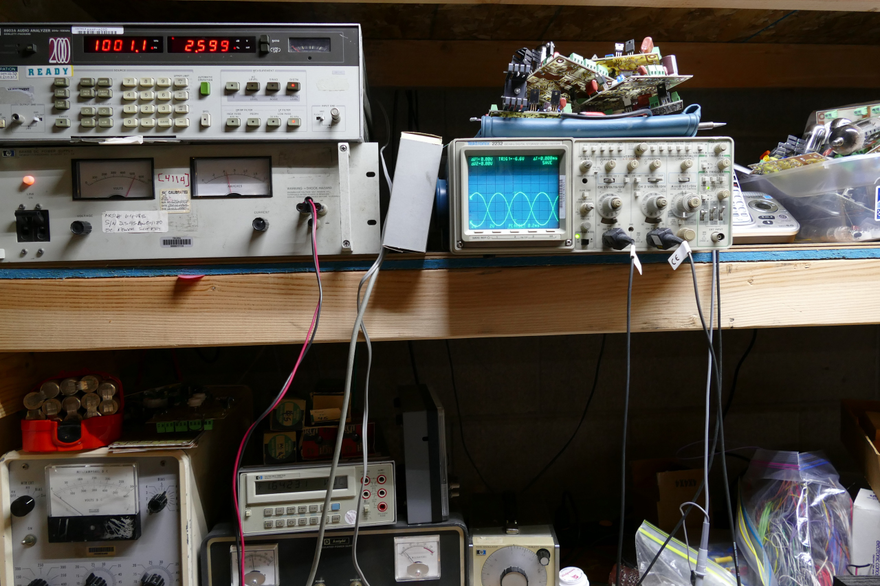

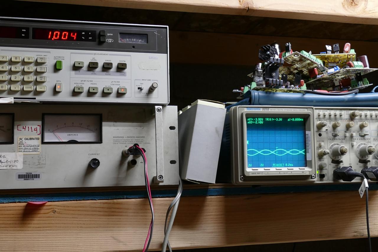

The first picture shows the setup. The second picture is the usual shot in the dark, no red glow, lots of good blueness even on old tubes. The third picture shows the power reading and the scope traces (yes both channels are displayed, right on top of each other).
A quick efficiency measurement shows that the output stage consumes 51 watts to make 25 watts of audio, just under 50%. This means that each tube dissipates 13 watts. The spec for audio duty is 10 watts plate, 1.25 watts screen, so we are slightly over spec. One of the crusty old RCA's (later deemed bad) showed red plate in one corner at 25 watts output. It did not bias up like the others and had high distortion, so I believe that it is misaligned from years of banging around.
This testing reveals that the boards work fine down to 300 volts without changing any parts. I will publish the new list as I build out a few more boards an the coming days.

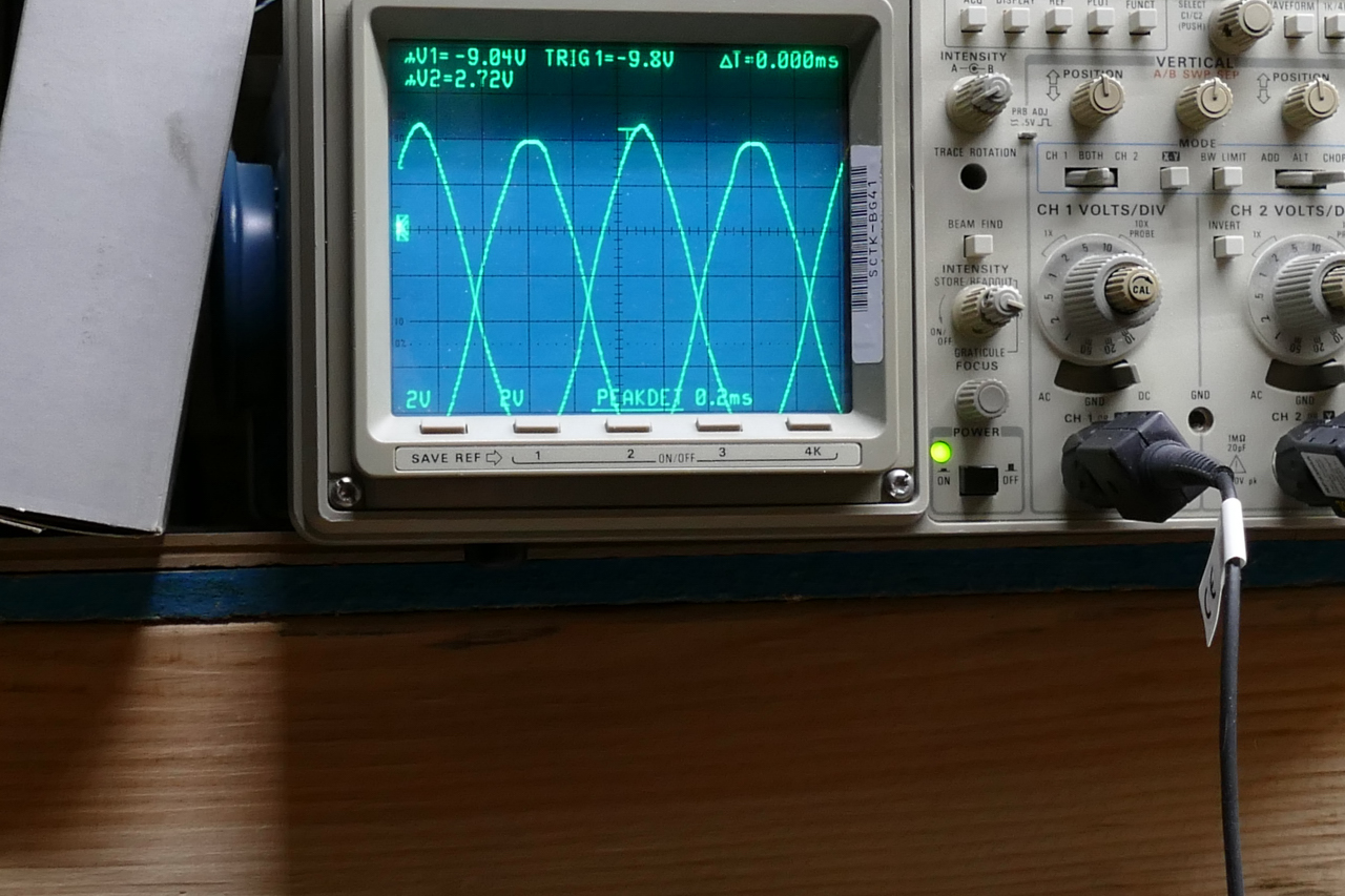

I wired the 6W6 test amp up to some Cerwin Vega speakers that I got at a thrift store for $20. I used them because they are 8 ohms (my DIY speakers are 4 ohms) which makes things easier because my test loads are also 8 ohms. They are also about 10 db less efficient than the DIY speakers which makes testing the amp at or near full power less annoying for the neighbors.
The 6W6's were wired for triode where they made about 25 watts. Testing with the scope across the speakers revealed some obvious clipping on peaks, some of which was quite audible. So for more power, I wired the amp for UL (just changed the screen grid jumpers) with no other changes. Power went up to about 32 watts, not much of an improvement. The amp sounded good either way, and may be good with more normal speakers or in a smaller room. So where do I go from here.......Into the boxes of crusty old tubes......for some 5881's.

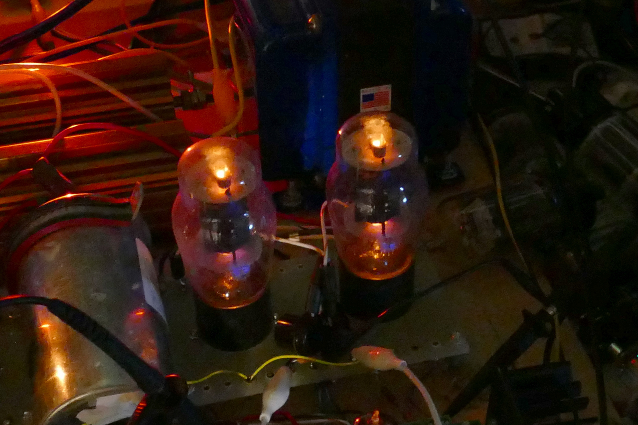

So, while digging through the boxes of crusty old tubes, I saw 4 tubes that would plug right into these sockets, BUT.....I have been telling people that you CAN'T DO THIS for years.....So, I'm going to do it anyway.
Leaving the power supply set at 400 volts, I simply unplugged the 5881's and plugged some 6DQ6 sweep tubes into the sockets. These were old used tubes of 4 different brands, definitely not matched. I set the bias to minimum current (-100 volts) removed the drive signal and flipped the switch......No KABOOM. The maximum screen grid voltage for a 6DQ6 is 200 volts. I'm feeding them 400 volts. Because of this two tubes were drawing 12 and 20 mA already and the others only took a little turn of the bias pot to get to 30 mA.
I have seen sweep tubes runaway rather quickly and sometimes violently under these conditions, and my shiny Edcors are still in there. I'm using the old Fluke power supply since it can't set an OPT on fire like the HP can, but is only rated for 300mA. The amp makes 58 watts on one channel, and 64 in the other. Distortion at 50 watts is in the 1.2% range......Speaker test......
This thing sounds good, so good that I listened to it for several hours. I kept an eye on the idle current which did wander around quite a bit. After an hour of so I noticed that the current went down when the heat pump kicked on, and went down more when it went through a defrost cycle (it's about 5 degrees F outside). Overall the tubes stayed within a milliamp or two 30 mA.
I still will not trust sweep tubes at twice their screen grid rating, but I will experiment further once I swap out the Edcors for some expendable OPT's.

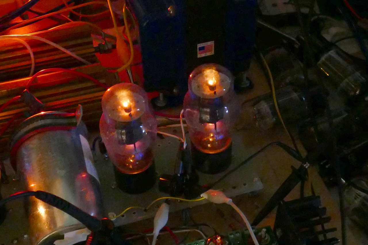

The 3rd picture shows the 6DQ6's in a darkened room. I can't see any obvious parts glowing inside the tubes except for the heater.

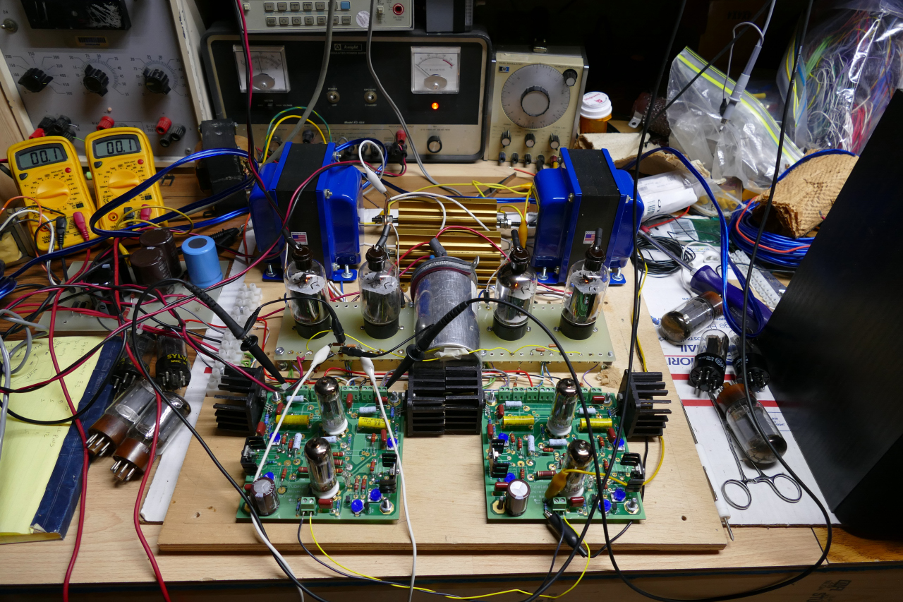

I rewired the tubes for pure pentode mode with all the screen grids (thin yellow wires) tied together and to a separate power supply set at 150 volts. I kept cranking and tuning to find that the mismatched channel shown in the previous post gets worse the harder you push it. Attempts to get over 80 watts by turning up the main B+ only made more distortion.
I moved all the meters and probes to the other channel to find that it was just quietly humming along at 110 watts and the tubes were relatively well matched having similar cathode currents at 110 watts.

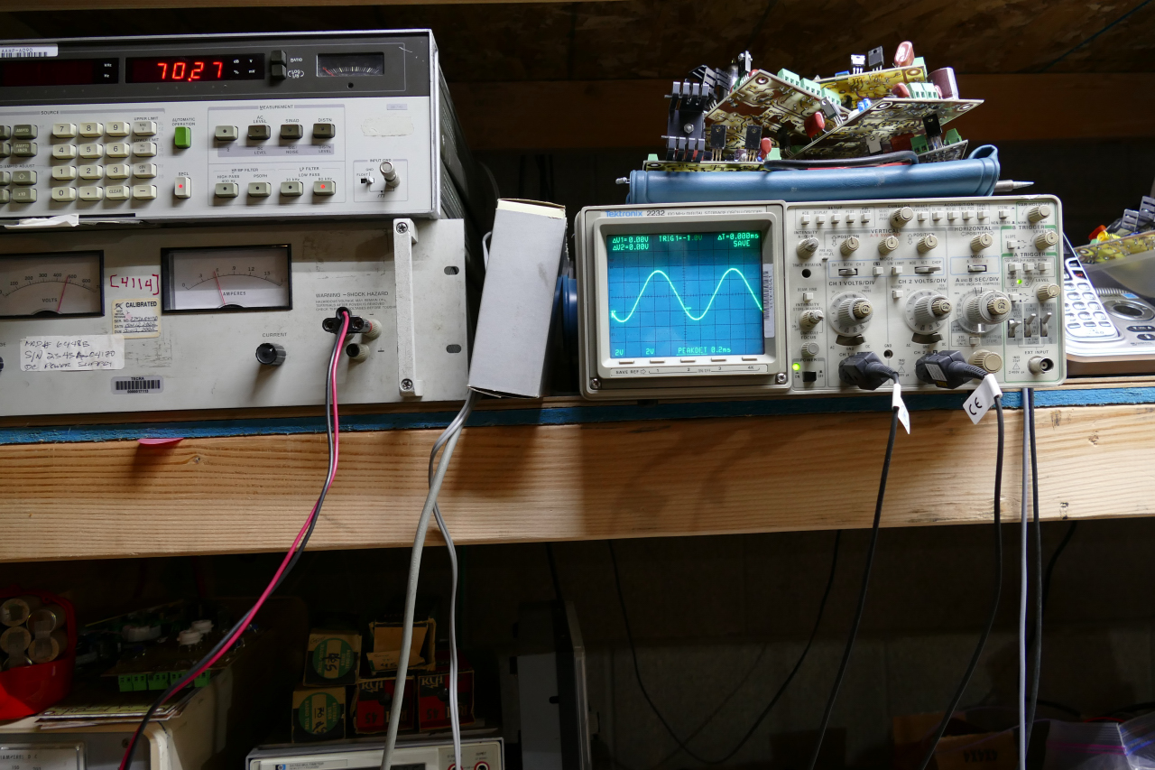

The distortion at 110 watts was 2.6%. This channel had been cranking for 10 minutes or so while I was busy messing with the other one, then for several more minutes while I pushed buttons and took pictures. I turned off the lights and took the usual shot in the dark (then lightened it with a photo editor to make glowing things stand out) nothing cooking at 110 watts output with dumpster tubes. Now ask me again why I like sweep tubes?

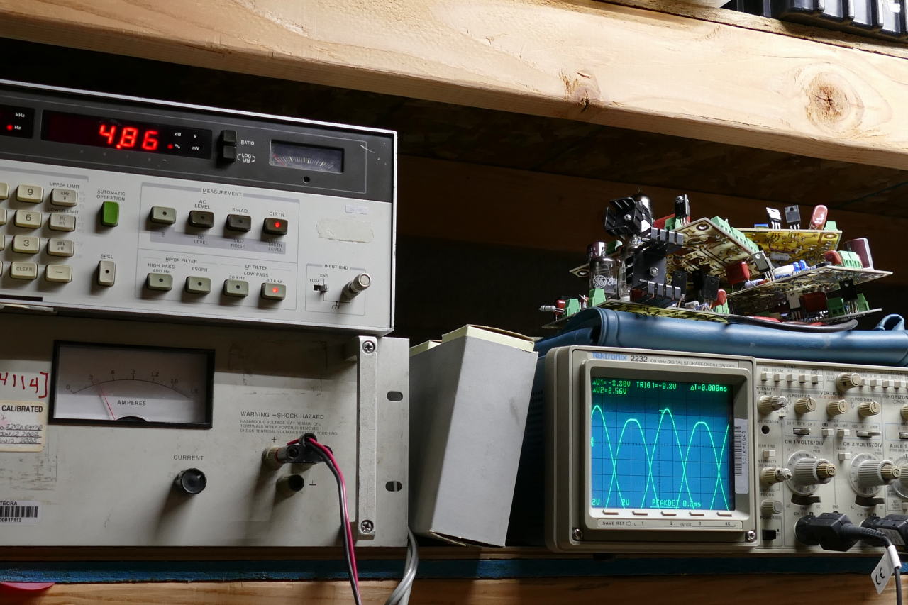

Note the scope pictures. The drive on one tube just touches the zero line, and the other tube might go 1/2 to 1 volt positive. That has been my experience with sweep tubes that are not abused, and in decent shape.
The bad channel was pushed about 10 volts positive on one tube as the plate to plate local feedback tried it's best to correct for the sick tube.....I looked at the tube brands, and I can guess which tube is bad......I have never met a decent tube with the Penta brand on it yet. I'm guessing its the bad guy.

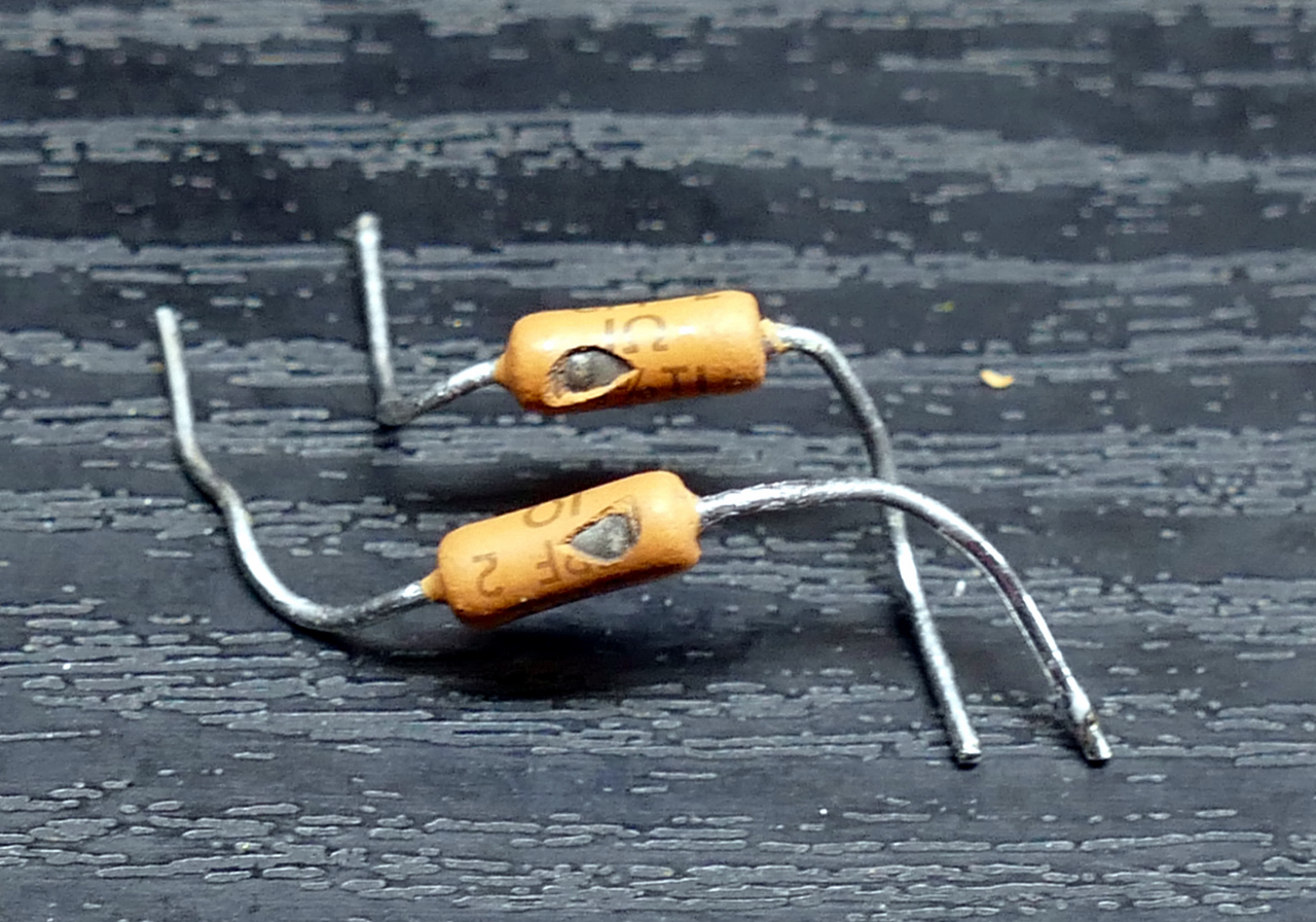

Autopsy (really easy this time) revealed a chunk blown out of the side of one of the 1 ohm 2 watt 1% Vishay resistors used for measuring cathode current. I assumed that the associated tube had arced internally, so I slapped in the other GAY tube, a National Union. The amp was alive again.
I proceeded to crank on it again and as I passed the 120 watt mark, BANG! The cathode resistor in the other channel blew. This is the one with the clear tubes that I had been beating on all night. This time I simply replaced the resistor, fired the amp up with the same tubes, pushed it to 100 WPC, and left it there.....no bang.
What's blowing my resistors. These are 1 ohm 2 watt resistors, it should take 1.4 AMPS to blow one of them up, more to blow chunks out of the side. 1.4 amps through a 6L6, not likely, really unlikely without fireworks or damage. That tube still works, and plays nice. I thought that maybe 40+ volts on the grid might be able to do some damage, then I remembered that I have a 100 ohm 1/4 resistor in series with the grid. Getting an amp through that would be impossible. The screen grid supply is incapable of sourcing more than about 350 mA even into a dead short....not there either.
The main B+ supply IS capable of blowing parts in half. It has 1000uF internally across its output, and has blown much bigger parts into black stains on the PC board where a part used to be. Could it do this through a tube????
More experiments to come.....but WITHOUT the Edcor OPT's. If amp sized lightning bolts are coming through the tube, they are also coming through the OPT!
You would think that if I was beating on 70+ year old tubes with voltages far beyond the ratings while extracting power outputs in excess of twice the "typical operation" it would have been the tubes, but that does not appear to be the case. In reality I'm still not sure exactly what happened except for parts with chunks blown out of their sides.........
In the last episode I squeezed 70 watts out of some crusty old 6L6G's with no issues. I was cleaning up the lab, and while putting those 6L6's back in the box, I decided to stick the pair of clear glass 6L6GA's into the amp and lean on them to see how much it took to make them glow!
The 6L6GA's behaved differently in the amp. They did not hard clip like the 6L6G's did. They also put out more power. with the same 475 volt supply I could get well into the 80 watt range before the output waveform started flattening on the top, and I got 91 watts at hard clip. I let the amp run for 10 minutes at this level while I set up the camera. Nothing was glowing. The drive waveform was pretty distorted trying to compensate for clipping.
OK, if nothing glows or blows up at 475 volts, turn it up. I kept twisting the knob until I got to 525 volts. I turned up the signal generator until I reached 5% (4.86% really), the power was 105.4 watts. The shot in the dark picture shows no glowing plate. Screen grid current was 7 mA per tube, 2.1 watts nothing glowing there. I turned the signal generator up until the distortion reached 10%, the power meter read 113 watts.
So this can make a lot of power. Immediately after all this abuse, I turned the signal generator down to reach 1 watt of output power. The distortion was 0.416%, it does quiet good too!
I then stuck the pair of Sylvania GAY tubes into the amp and throttled up both channels. I thought to check where the transition from AB1 to AB2 occurs. The drive on the most positive of the 4 mismatched tubes crosses zero at 22 watts. The tube at the other extreme crosses zero at 25 watts. +20 volts is reached at 68 watts, +40 volts comes at 104 watts, +45 volts happens at 113 watts and a big bang happened at 125 watts on the strongest of the two channels, the other was around 120 watts, but it blew up before I could poke it with the scope probe.

Very interesting how the 6L6 family goes to AB2 so willingly and the sweep tubes seem to resist it.
The 6L6 family is actually specified for AB2 as is the old 45. The "AB2 causes distortion" myth comes from the lack of good driver technology back in those days, not the tubes themselves.
The sweep tubes were designed for very low plate to cathode "saturation" voltage with zero volts on the control grid. This is largely due to the oversized cathode, and a requirement for long life in a TV sweep situation.
A good sweep tube doesn't need positive grid voltage, and the large surface area between these two surfaces will cause a lot of current to flow if there is much positive voltage on the grid.
Many sweep tubes give curves of plate current at zero grid volts for various screen voltages. Late vintage big sweep tubes can pass well over an AMP of plate current without positive G1 voltage.
