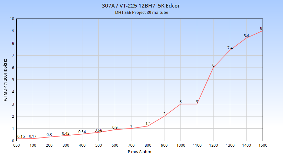

This is the gassy 307A. I actually got better numbers running it up as high as 25 watts, but it showed a tendency to runaway.
I re-ran it with G3 tied to the plate and saw higher IMD numbers, but not by a lot.
307A using the Edcor XSE15-5K.
test conditions:
Ken Rad 39 ma Gasser grey plate, GE 12BH7 grey plate, NU 5W4GT
Triode
G3 tied to cathode
B+ 322
Vk 26
Rk 470 / 25 watt
Ik 55 ma
Pd 16.25
SMPTE IMD 4:1 200Hz:6kHz
Win W5JAG

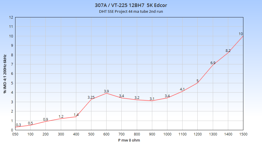

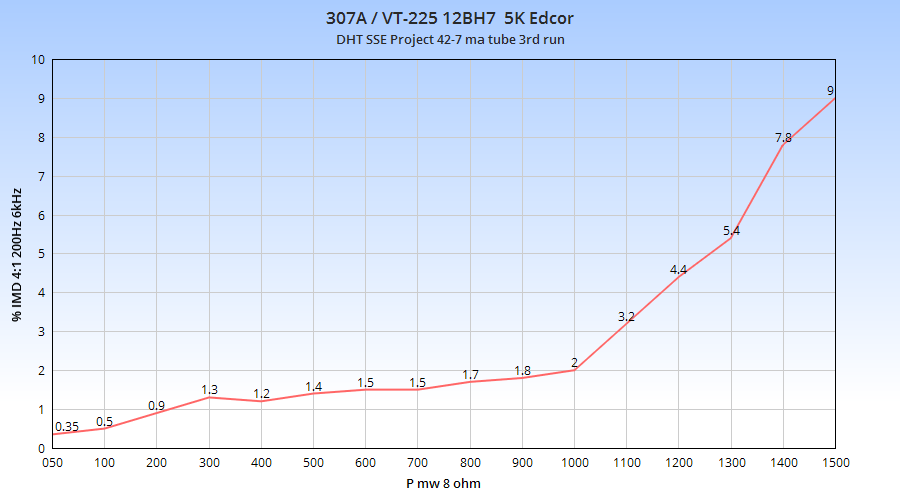

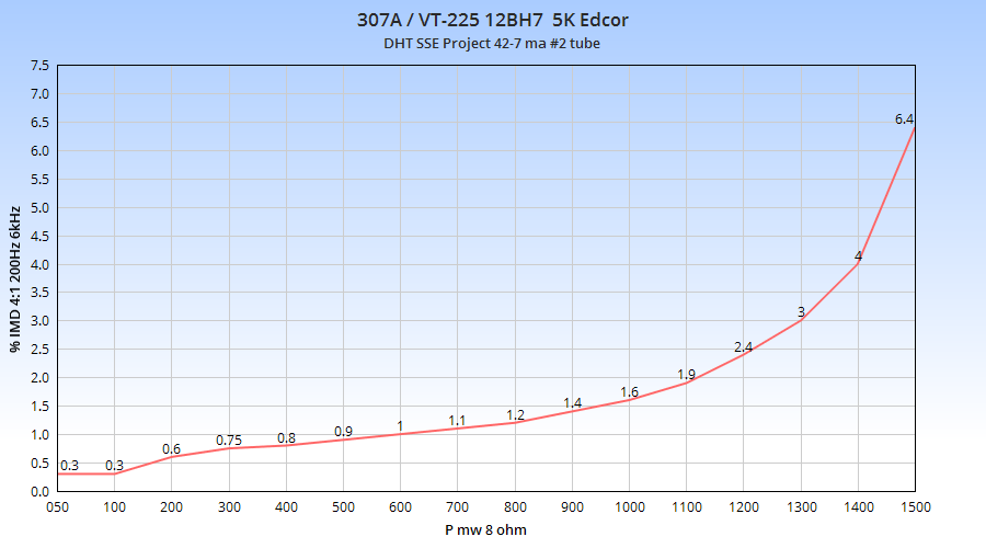

It looks like out of the six tubes, I have one pretty good set, one okay set, one single, and one that is probably bad.
These are all 16 watts Pd, about 55-57 ma cathode current, about 290 volts plate to cathode.

Not that long. Maybe three or four minutes while I double check the set up on the meter. Maybe a bit longer.
When I have some "time" I can try a few and see if or how it changes over time.

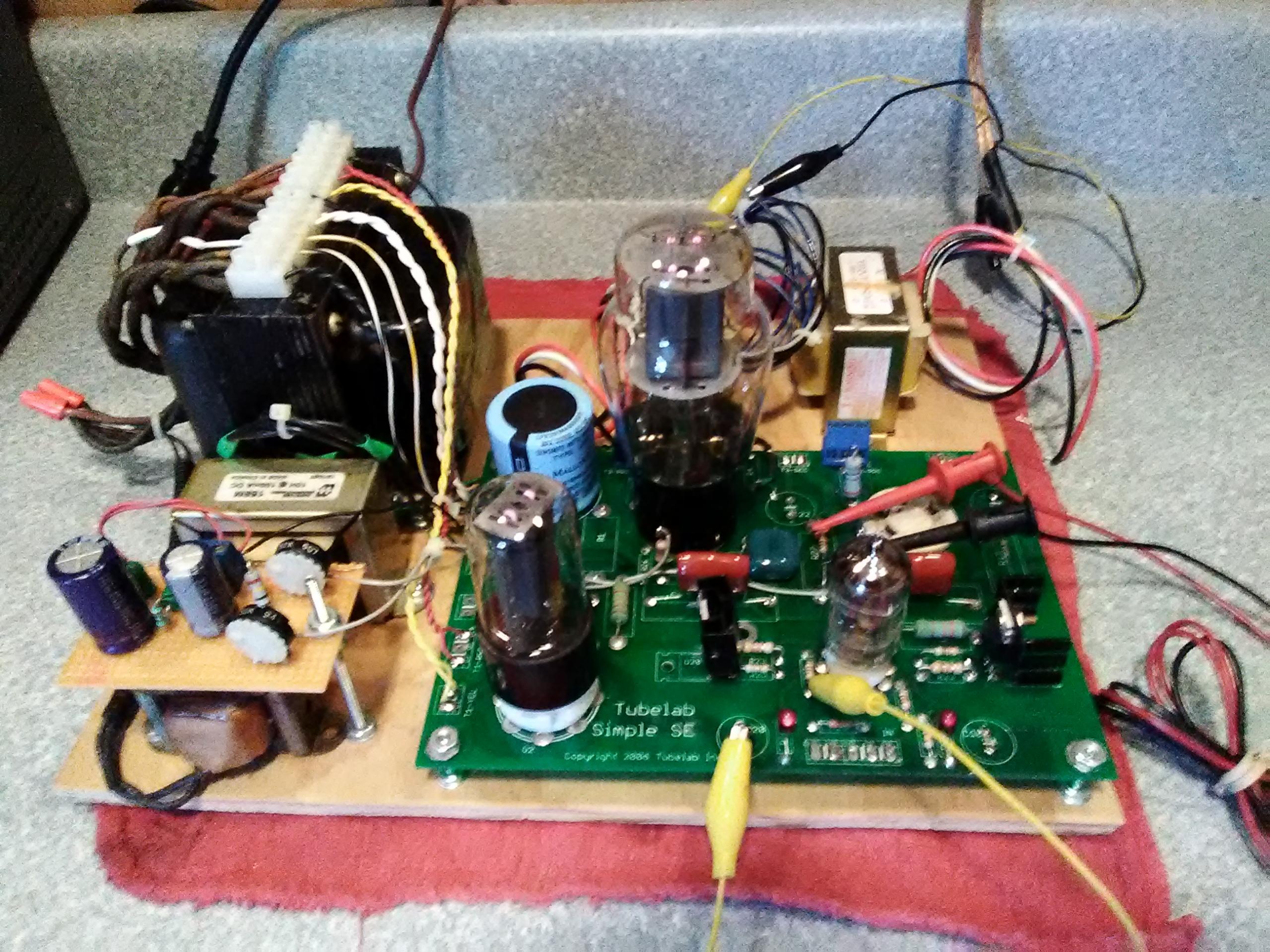

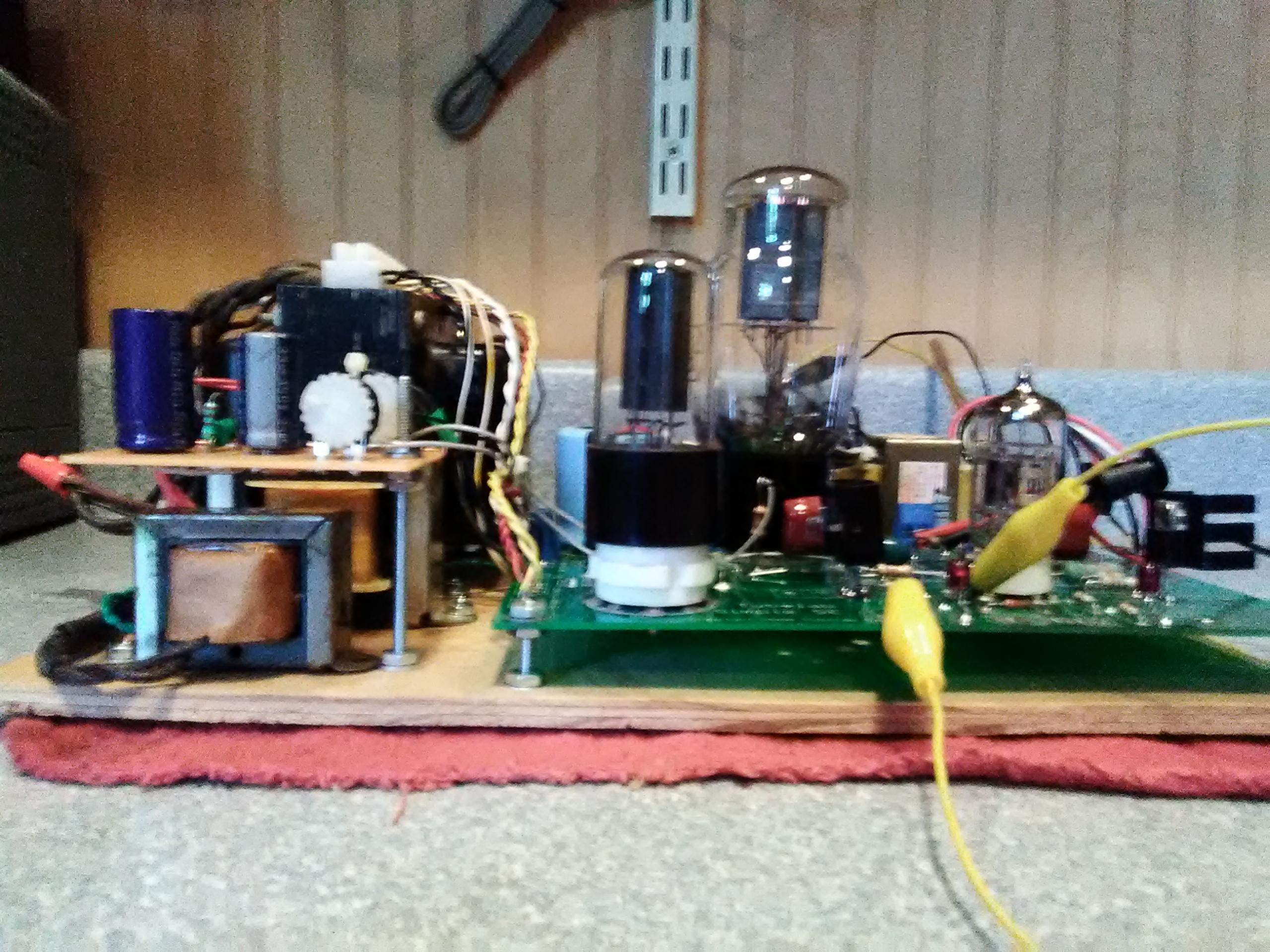

Here is the most recent iteration of Mule 2 - configured for fixed bias.
The board is starting to look pretty sparse at this point - the cathode bypass capacitors are gone, in lieu of grounding the filament transformer center tap, I used a 1/4 watt 10 ohm resistor where the cathode resistor would normally be placed, providing a convenient low voltage point to measure tube current.
Initial plans were to use a nice little Thordarson transformer, 6.3V @ 900 ma; 135V @ 15ma for the 12AT7 filament and bias supply. This was NOS/NIB and I paid a princely $3 for it. Unfortunately, it was bad right out of the box, resisted all attempts to salvage it, and long story short, ultimately went out in fire. This is why you have a kill switch, in my case, the toggle on my variac which I run the Mule from for "testing".
This was a bit of a pisser, since I had planned the layout of the breadboard around the ultimate use of this transformer. Fortunately, a derelict Eico VTVM was located in the warehouse of junk, and it donated it's power transformer to the cause, which actually worked out better from a fit and function standpoint.
The fixed bias board sits on a threaded stud, above the transformer. I just grabbed some parts and free lanced a bias supply, which works fine. Both sides of the perf are used. It uses a full wave solid state rectifier ( to make sure the bias stabilizes before the power tube pulls current ), CRC filter, bleeder, and the voltage dividers. AC into the supply is about 130, and - VDC into the dividers is about 200. On the face of it, this is a bit high, but in practice, it works well, as the Mule B+ is really high with a fixed bias arrangement - almost 360 volts. It takes a LOT of negative bias to deal with this, in excess of - 75 volts.
A lot of rules are being broken here. The B+ is a good 100 volts above the norm and well in excess of spec; the OPT's are 7K. It works well. 2A3 and 45 seem stable. It has no trouble putting out a clean single tone 4 watts with a 2A3 into an 8 ohm load, and 2 watts with a 45. If I am using SE Amp CAD correct, and looking at the load lines correct, the only way it works is due to the 7K load. 8K would be better. At this high voltage, the load lines look better for a 2A3 than a 45. SE Amp CAD suggests more than 6 watts might be obtained with a 2A3 at maximum plate dissipation, provided the front end has the stones. Maybe we'll get to that. I haven't tried 46 or 47 at this scorching B+. Yet.
It's a bit ugly, but it's working well. It still meets the volume criteria that I self imposed. There is room in the bias supply stack for a regulated DC supply for the 12AT7, but that seems somewhat pointless while the power tubes run on AC filaments. I expect this modified SSE would smoke the typical 6SN7/6SL7 => 45/2A3 type amps that are so popular.
edit: one other thing - I'm using 220K resistors in series with the bias supply. Playing around with my bench supply, it didn't seem to want to work with less than about 200K on the grid.

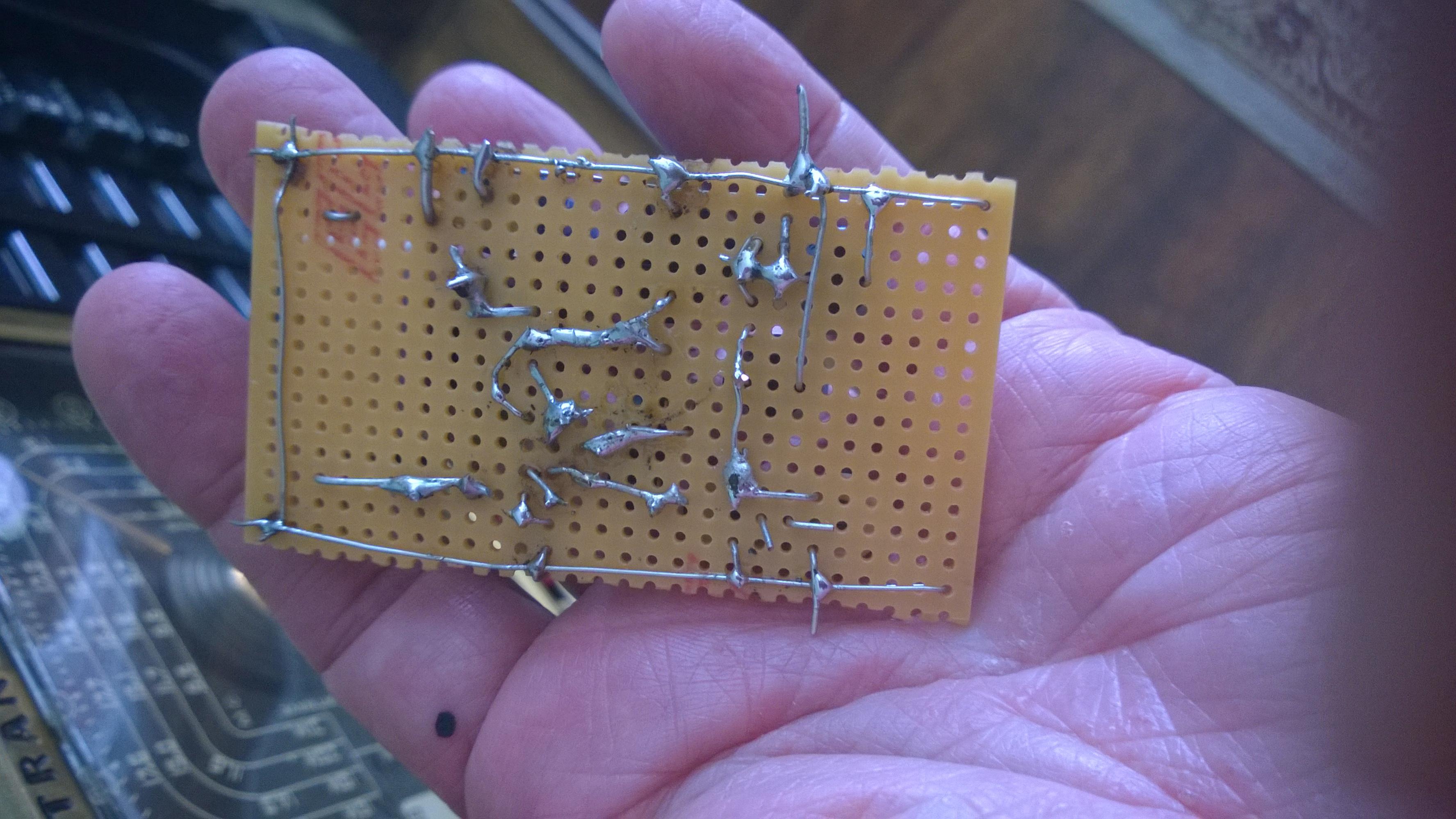

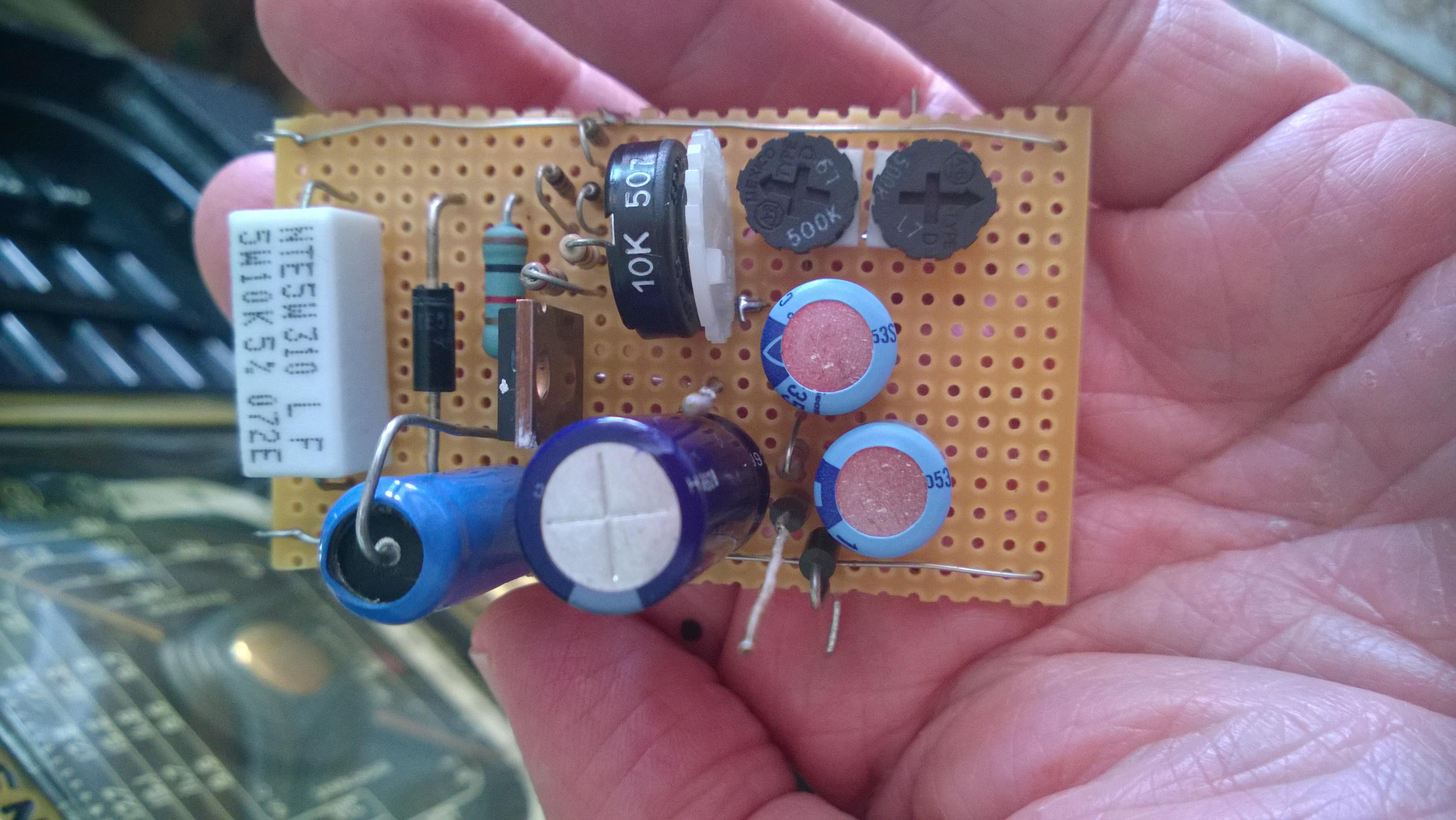

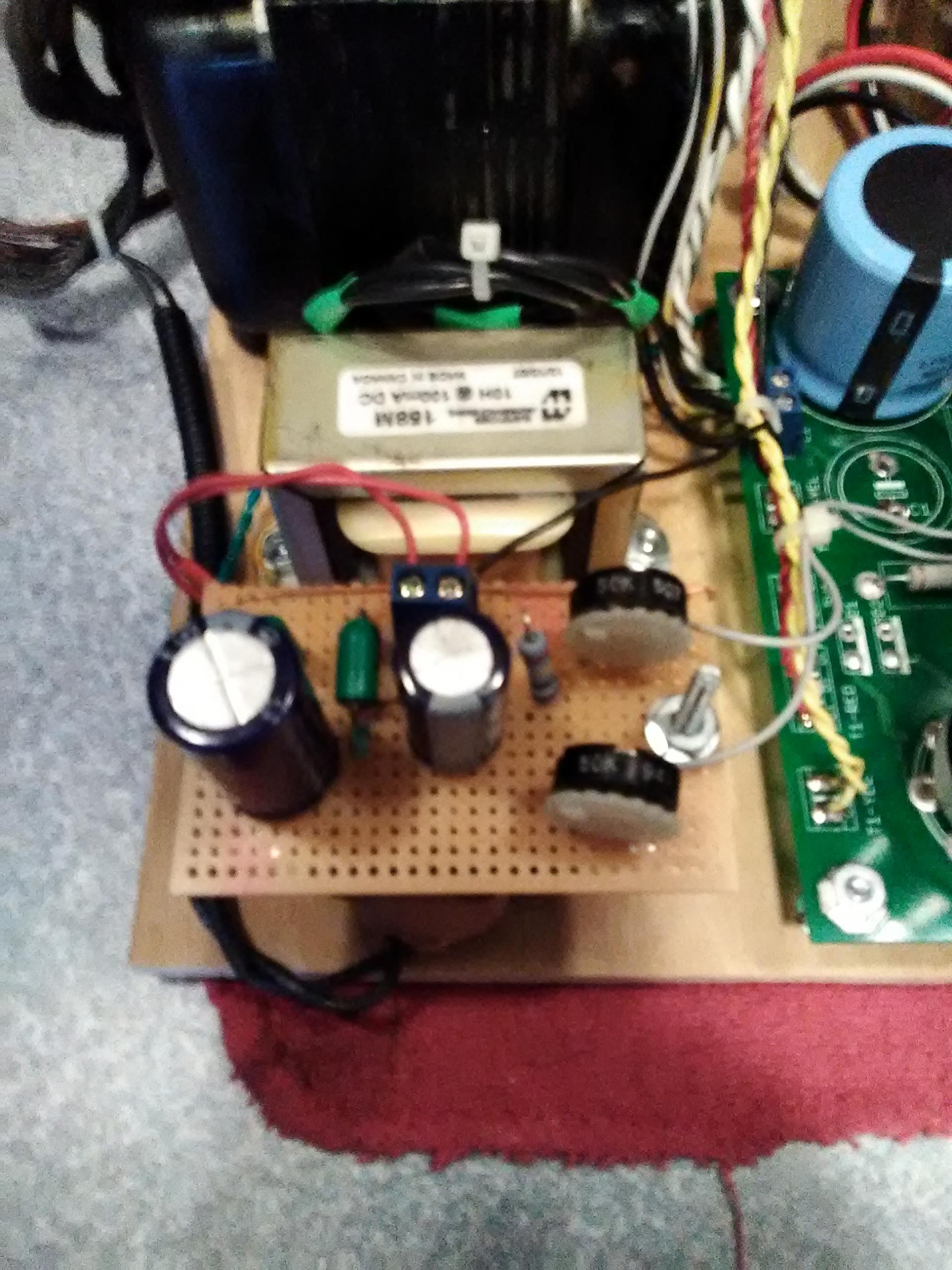

This is a simple screen regulator / bias supply that I built up for my low voltage SSE. It works okay on the bench, have not tried it live, yet.
The voltages in Mule 1 are similar to my low voltage SSE, so I'm going to try it live first in that, and debug it there, before moving it to the SSE.
The screen voltage comes from the main B+ supply; bias voltage from a small transformer stripped from a derelict 1980's cheapo clock radio. The board shows a lot of rework - I was aware of the concept of floating stuff above ground, but this is the first time I actually tried it.
It uses a zener shunt "regulator", which initially was all I planned to use, but if I use fixed bias, that would probably set the screens a bit high for tubes like 6Y6, 6W6, and 6U6, so I added an adjustable regulator.
I've tested it at up to 315 volts into the board. It drops out of regulation at 200 volts into the board. It provides an adjustable regulated output from 110 to 160 volts. That may or may not be enough for tubes like 6BQ6 and 6DQ6, but with some rework it can be bumped up, if need be. Topology is a zener shunt, RC low pass filter, TL783 regulator. *IF* it actually works in a live amp, I can give more details when it is finally debugged, if anyone is interested.

The screen portion of the supply seems to work fine. I jumpered it into Mule 1 last evening, and ran it about four hours feeding the screens of a pair of 6K6 running a constant one watt output into a dummy load. I need to fetch some 6Y6 or 6W6 - they should draw more screen current and represent a better test.
It was uneventful. Voltage into the board was 281 VDC. I set the screens to 150 VDC. The TL783 runs cool to the touch; I was afraid it would need a heatsink, it appears not to thus far. The 10K input resistor does get pretty hot - I measured about 160 F after about three or so hours.
I think there are still some improvements that can be made to it, although it is probably "good enough" as - is.

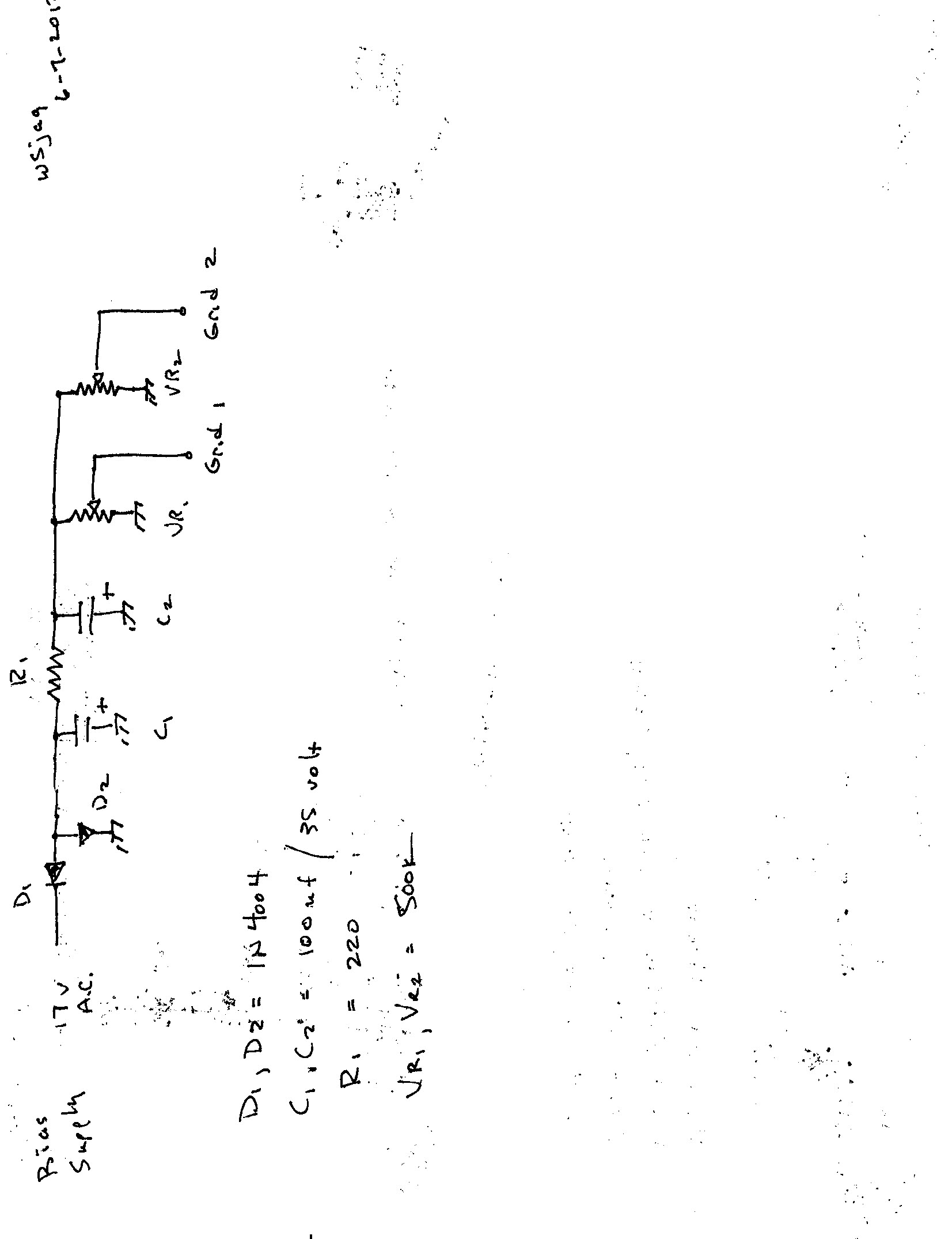

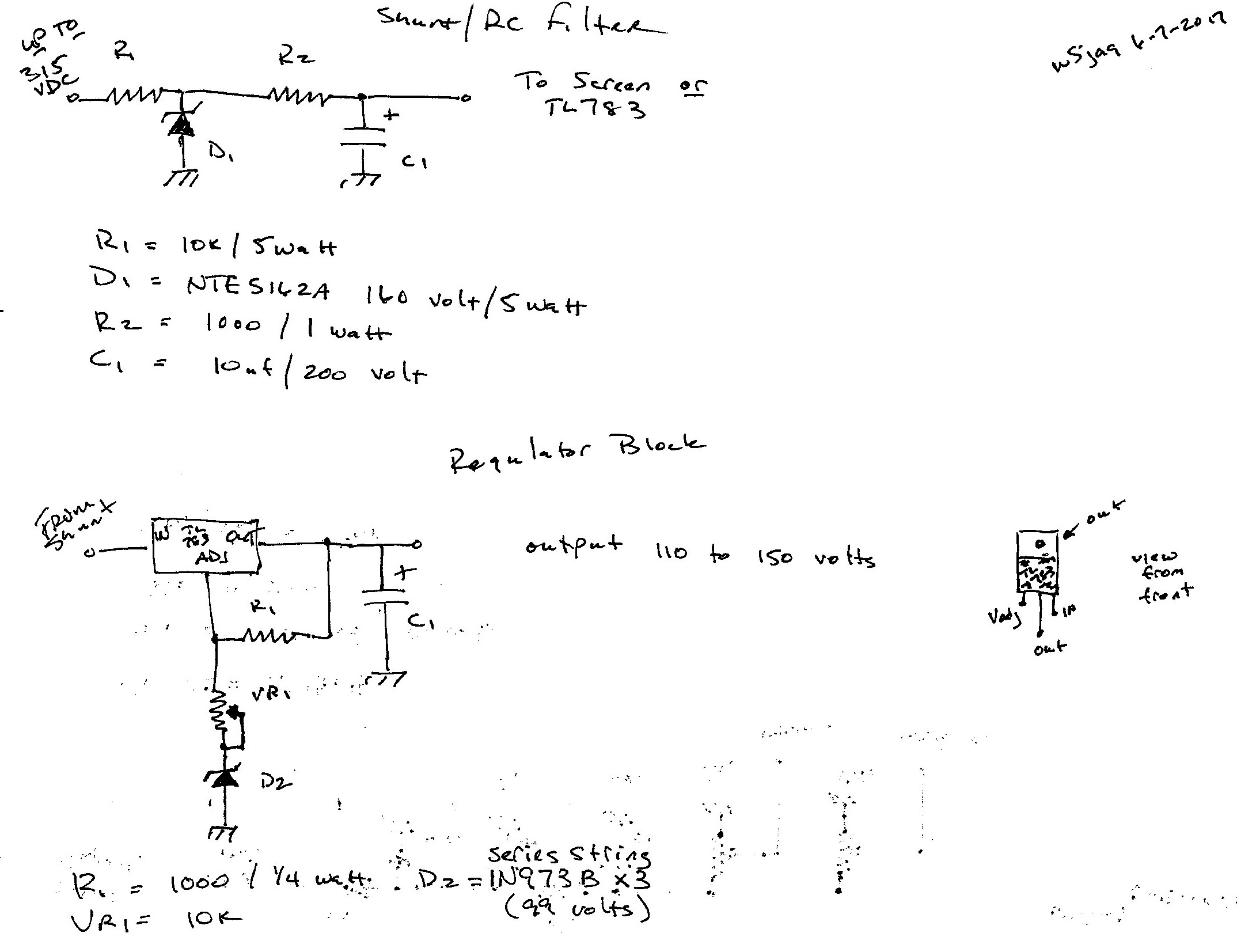

Nice work there W5JAG. Maybe when you get the time can you post a schematic of the screen regulator only with details on the parts and their values ?
As a side question, why do you choose to go with a separate bias supply with transformer ?
Sure, it's as minimalist as it gets right now. Comments, criticisms, and suggestions are welcomed.
I was just going to use a simple zener shunt. I had one 160 volt/ 5 watt zener handy. I allowed for up to 300 volts B+ from my low voltage SSE, so that makes a 140 volt drop. I allowed for 14 ma for the current, so that makes for a 10K ( 140 / .014 = 10000 ) (140*.014 = 1.96 watts) 5 watt input resistor. Power in the zener is 160*.014 + 2.24 watts, so the 5 watt zener looks adequate. The zener has to eat all this when no current is flowing. It is not a coincidence that I happened to have a 10K/5 watt resistor in stock .....
The 1000 ohm / 10 uF capacitor combination is an RC low pass filter, with a cut off about 16 Hz, I think ( can't remember ) to block any noise from the zener. The cap doubles as the input cap for the TL783.
The TL-783 can handle about 1.25 to 125 volts, so the input and output have to accommodate that. I floated it 99 volts above ground, which makes it 100.25 to 224 volts. Since the voltage in is only about 160 or so, that obviously sets the upper limit of output, and the zener string sets the lower. As presently shown, it does about 150 to 110 volts. I used zeners in series here, and fooled with it a bit, and finally decided there was no need to go much lower, and it provides a good safety margin. A 100 ish volt zener is fine here.
I went with a bias supply with transformer to make it easier to adjust tube current. I'll use a separate transformer, because I have one, otherwise you have to use a leg of the high voltage tap, and bleed off a lot of power.
I don't know if it's ready for prime time or not yet. I changed the thumbwheel for a smaller pot so I can place a mounting screw in the middle of the board. I did bring home some 6Y6GA's and tested the whole smack on mule 1. The fixed bias worked fine - maybe a bit too much adjustment, but that can be tweaked. The screen supply held regulation up to about 4 watts output from a pair of 6Y6GA, then it dropped about 10 volts. I haven't done any measurements to find out why, and it still may be okay as - is. Probably that 10K resistor needs to be adjusted to allow more current. I was running the screens at 125 volts, and a 10K load - way, way, too high of a load.
The extra bit of space on the end is for another dc supply for some accessory bits that I haven't built yet ....
