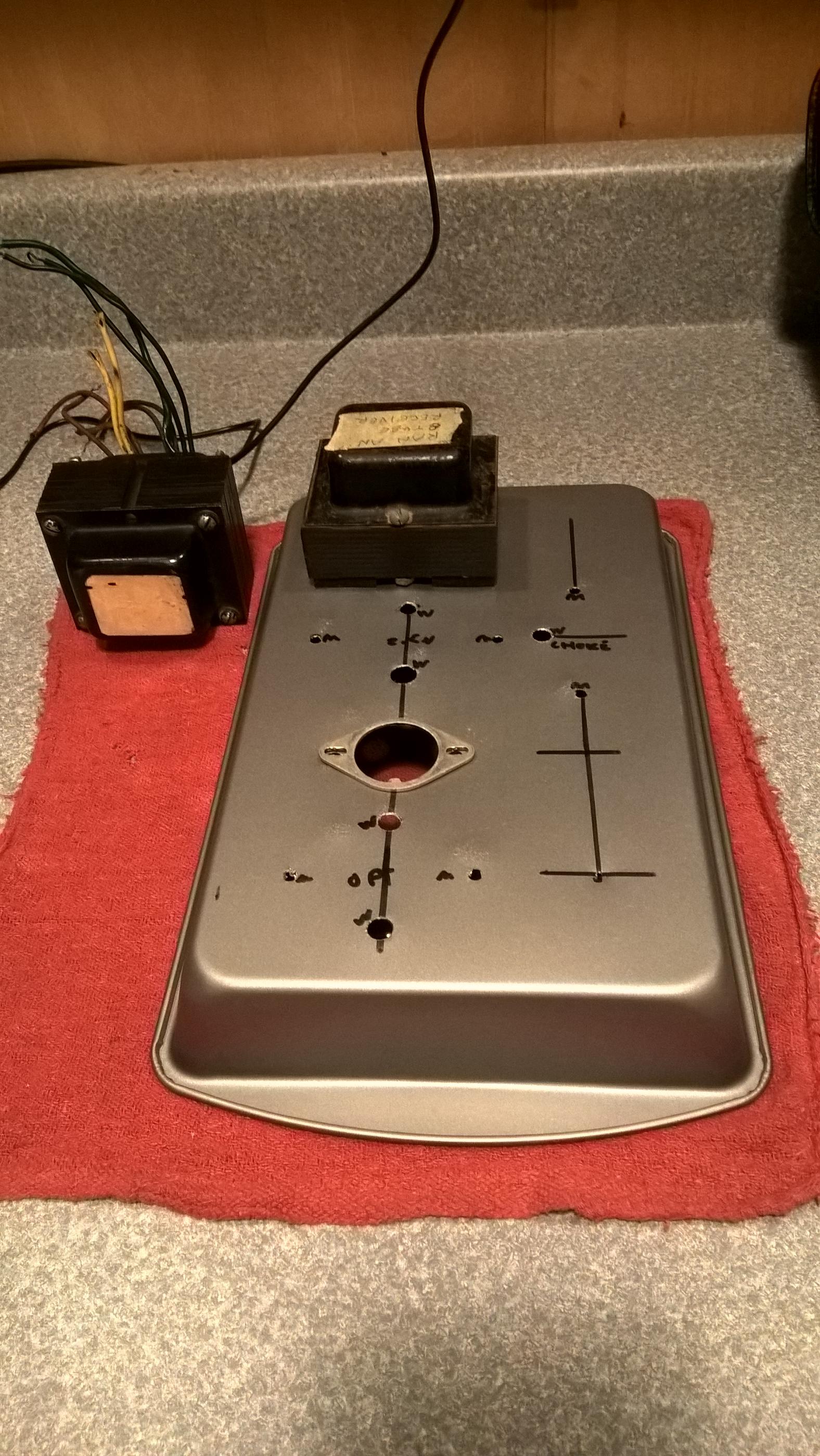

I cut the left side of the "chassis" in about an hour and a half last night. I'm not really a fan of cake pan construction - the metal is flimsy and harder to work with than a real chassis, imo. About all it has going for it is that it is cheap, and Wal Mart has a decent selection. Instead of a punch, I used a nibbler and file for the tube socket. I was afraid a punch would leave the flimsy metal so wavy I'd never be able to beat it back out.
I cut the chassis to accept either transformer pictured. Both are about 250-0-250, but the smaller one lacks a 5 volt secondary. The bigger iron could be useful for bigger tubes, and I want the ability to accomodate those with minimal hassle.
I haven't cut the right side yet - other than the location for the electrolytic cap, I'm undecided about the type of rectifier tube ( or solid state ) and the front end tube type.
Power junk will go on the rear, line in and speaker out on the front.
I'll make a new thread once it gets closer to fruition so as not to further pollute Jeff's thread.
Win W5JAG

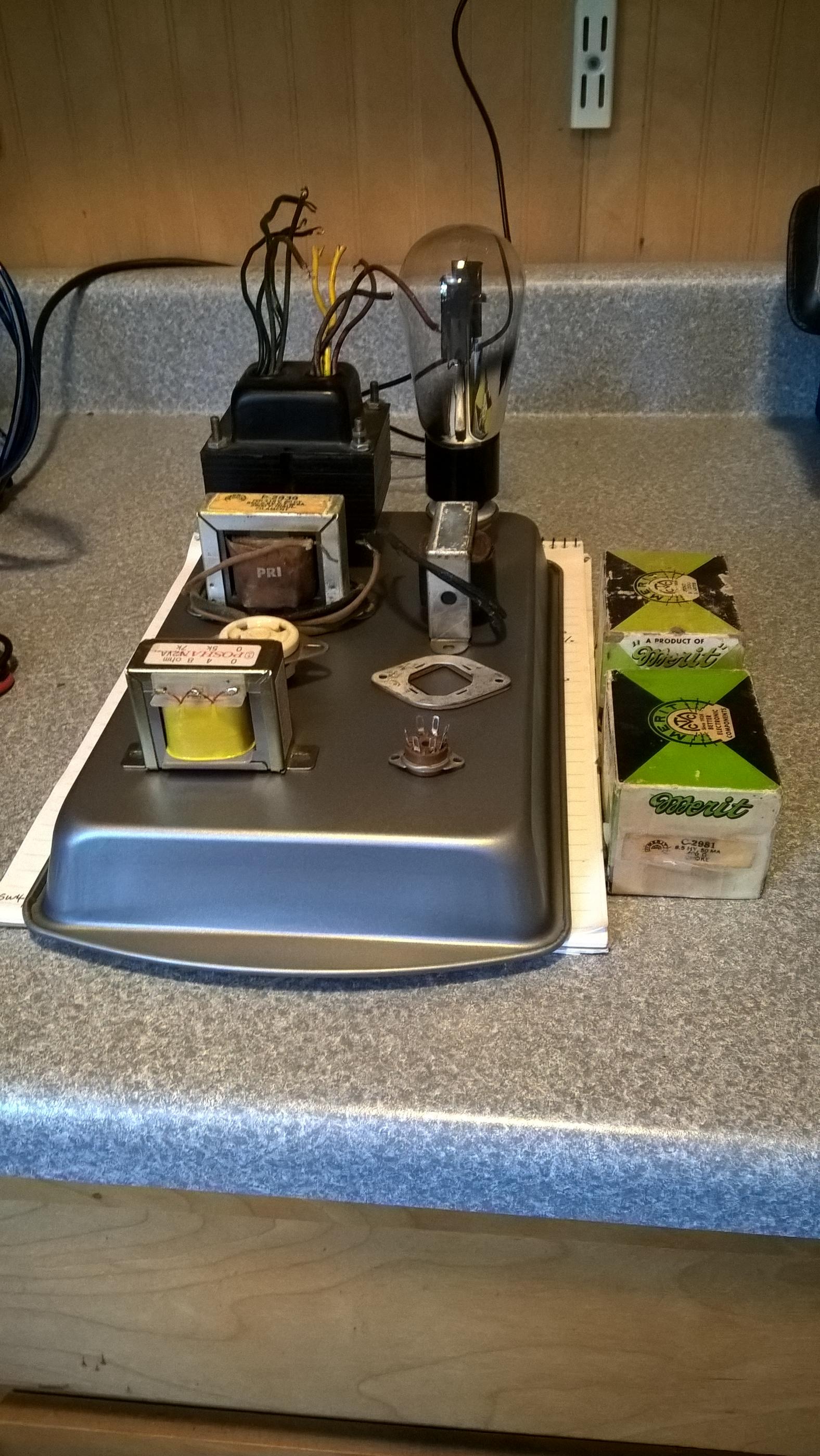

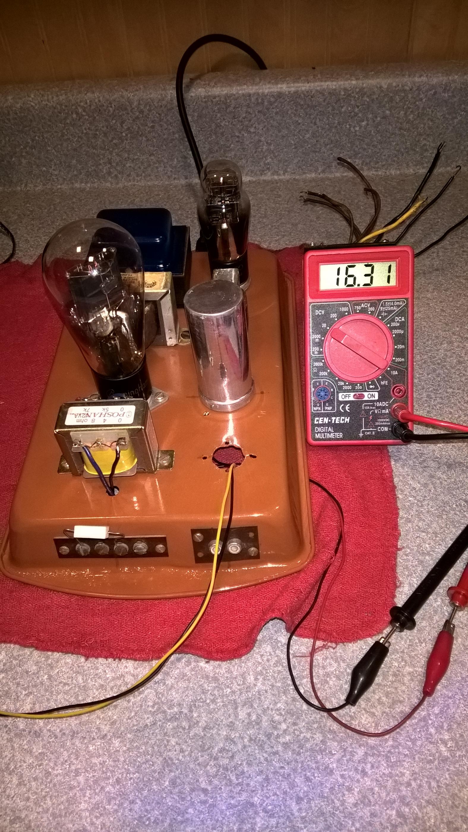

I have the power supply and a power amplifier final stage running.
This is a test mule, so no effort at beauty is being made - the nasty looking hardware and input / output terminals are from a dumpster dive Eico HF-32, I stripped down a few weeks ago. The PT is a used hamfest scrounge; the other parts were NOS hamfest scrounge, with the exception of the OPT, which is an Ebay deal. I spent a couple of days slowly reforming the 60 year old Sprague filter cap. The spray paint was supposed to be orange, but twenty years in a hot garage apparently made it more brownish.
The power supply is conventional: 6X5 rectifier, choke input. Not much to say here.
The PA is a 46, for now; a 47 will come later. AC on the filaments, cathode bias; the cathode resistor and bypass are on the filament transformer CT. I had a spot of trouble here - my target was a cathode voltage of DC 16 volts, and on power up, I got 0.12 volts. After about ten minutes, it dawned on me that I had left out the grid resistor. I installed a 220K resistor since I will be using the Tubelab front end in some form.
I repowered it up, and, of course, it still didn't work. This took a bit more thought. The 46 is a dual grid tube. I assumed the two grids were more or less identical, and I wired them to each other, simulating a triode. For whatever reason, this didn't work. I backed up, and wired the grid nearest the plate, what I call the second grid, to the plate, and repowered the device.
This time, it worked - cathode voltage settled at 16, exactly as I had planned. Anode voltage was 194 volts, pretty close to what PSU predicted for a choke input. That's the first time I've had that happen, but this is the first time I've used measured data on all the parts in my power supply.
The bias resistor is 470 ohms, bypassed with a 100 uF cap ( because I had a bunch of them, and figured that was a reasonable starting point ). That's about 30 mils, and about 6 watts.
Dizzy with success, I jumpered a signal generator to the first grid input cap, fed it a 1 kHz tone, and got a clean, hum free, 1 kHz tone from a test speaker. For fun, I fed the output of the AA-1 into it - it could drive it to about 90 milliwatts, and showed two tone IMD at a bit less than 6%, as shown in the second pic.
The remaining hole in the "chassis" can take either a 7 or 9 pin socket, so I have some flexibility here. Once I've tweaked the final and have it working the way I want, I"ll graft an SSE front end unto it, as a start.
The odd second grid of 46 needs to be explored. The OPT will need to be changed to a UL type at some point. The existing one has taps at 5K and 7K ( I'm using the 7K tap ) so of course I'll try to use the 5K tap as a feedback element before I spring for a new OPT.
Win W5JAG

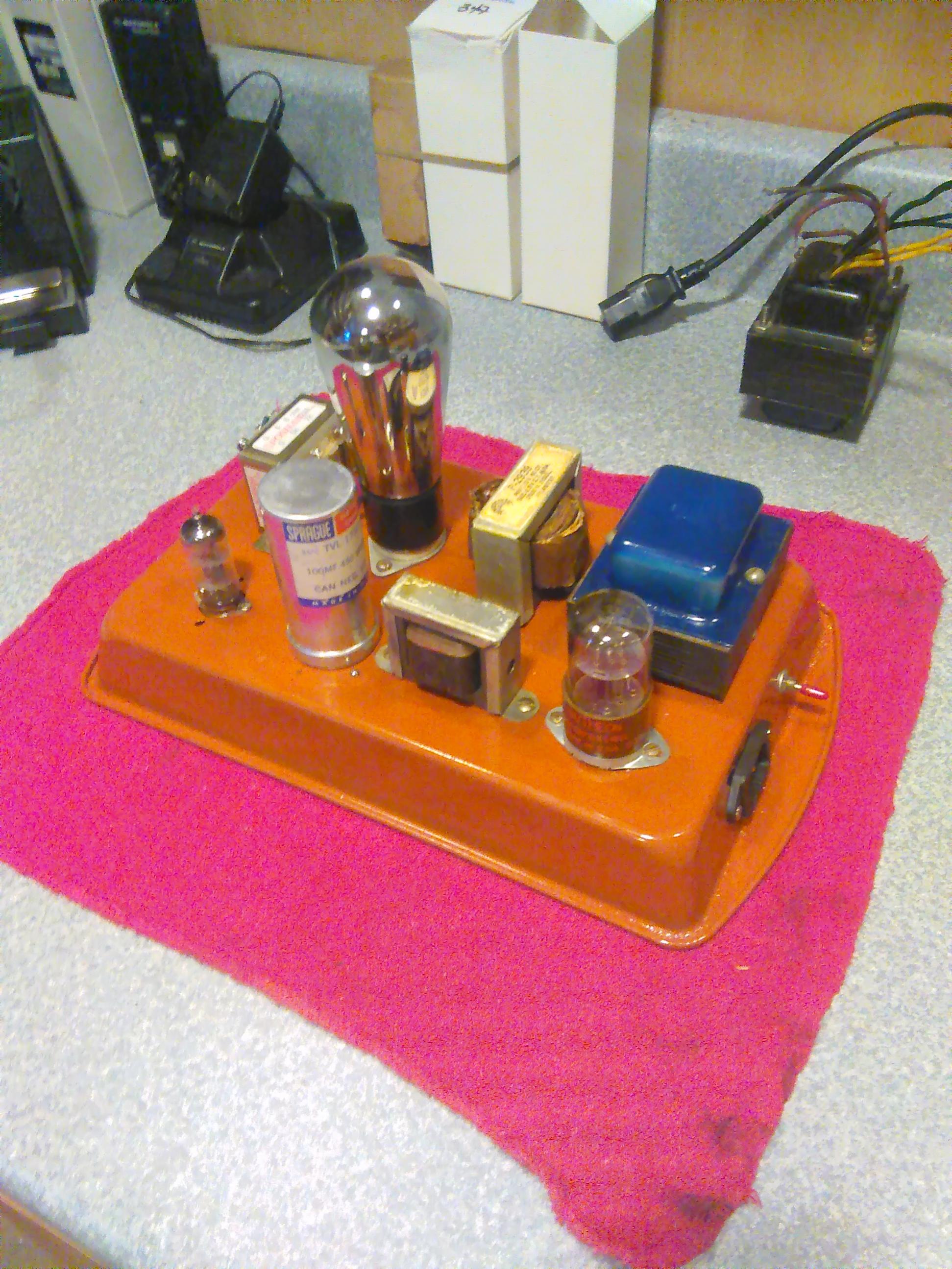

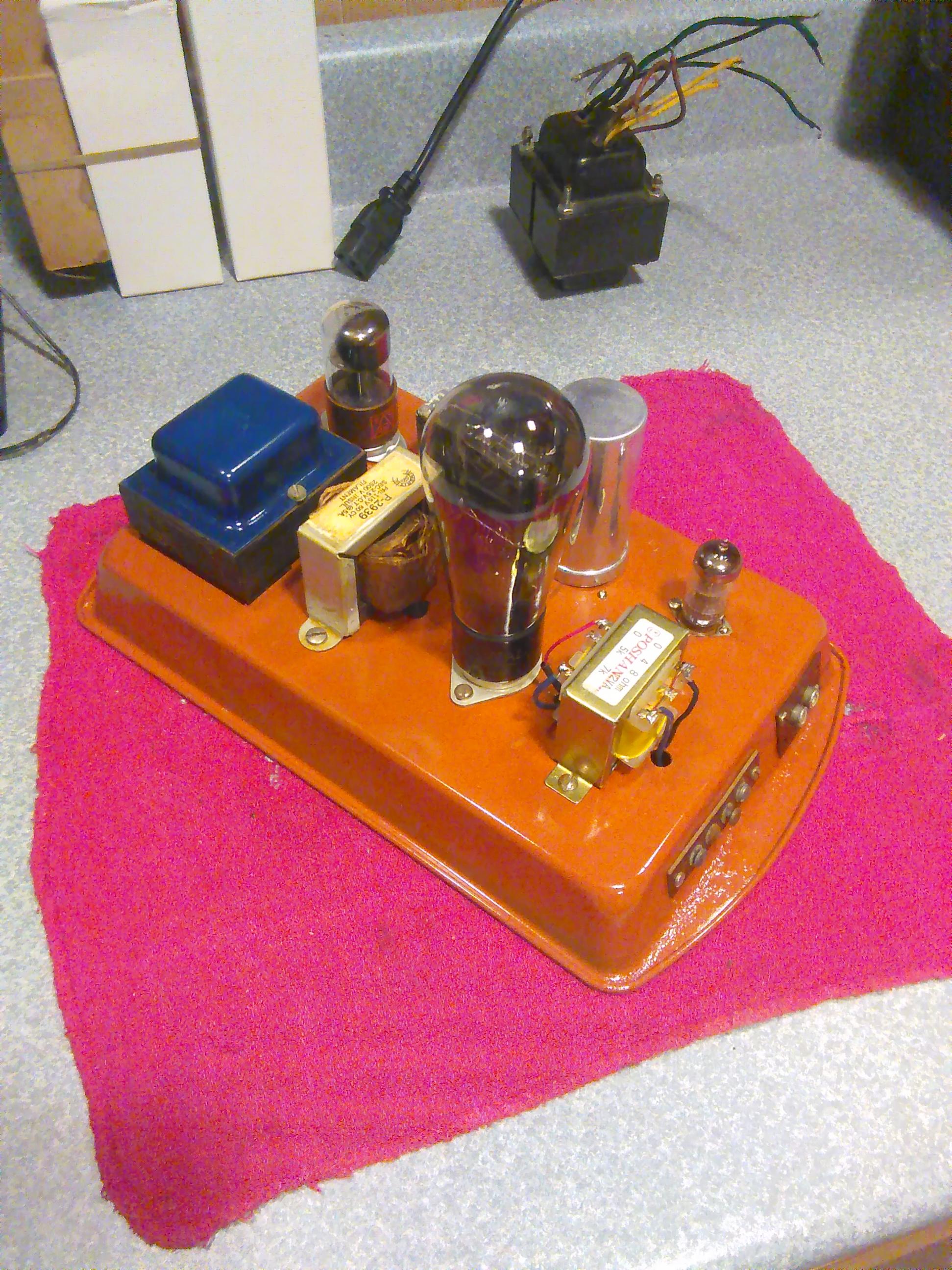

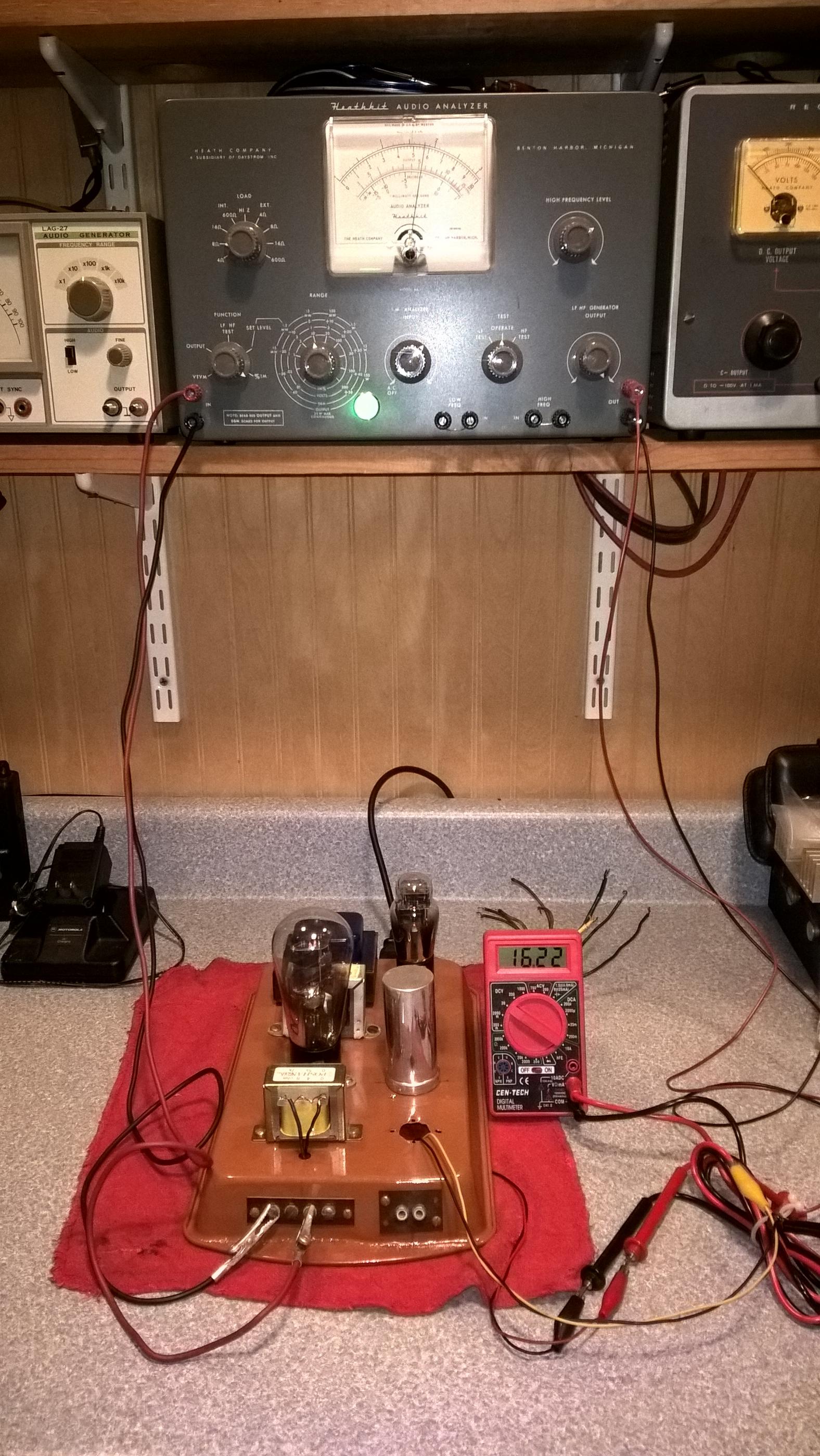

The mule has a functional front end now - essentially the SSE front end sans ( for now ) the CCS, and the cathode bypass cap is 1000 uF, because I didn't have a 1500 uF handy. In lieu of the CCS, a 10K resistor is the anode load. My plan is to put the CCS on a small perfboard, so it can be installed and removed as one component.
For now, I used a 7 pin front end socket, so the front end is either 6AB4 ( 12AT7) or 6C4 ( 12AU7 ). 6C4 and 6AB4 have similar enough pin out that it is possible to wire the socket to accept either tube.
Loaded B+ comes in at about 260 volts with a CLC power supply.
I've done some preliminary testing with both tubes, and 46 and 47 wired as triodes. My notebook is back at home, but this is what I recall:
Both tubes do about 850 mw output as triodes. 46 is running at ten watts, so is at about its limit, while 47 is at about eight watts and can ( and will be ) further exploited.
Both tubes can be easily driven to clipping with the 6AB4, taking about 0.5 to 0.7 volts RMS. It takes about 1.4 to 1.6 volts RMS to drive to clipping with the 6C4. The 47 drives easier than the 46. That could be problematic in some applications. Adding the CCS may change this, I don't know.
Two tone IMD for all combinations is pretty similar, about 8 to 9% at 100 mw output, and 4-5% at 50 mw output. Adding the CCS may change this, I don't know
This OPT is not good as a hi fi OPT, it's high frequency response is fine beyond 20kHz, but it is down 5 dB at 100Hz. This is probably why the amplifier is unexpectedly and completely free of residual AC hum. A better OPT is in order. It works fine as-is as a medium fi utility amplifier where response below 200Hz is not required. It has already put in a fair amount of time in that application.
Using the 5k tap as a quasi UL feed appears to have merit with the 46. Attaching the 5K tap to the second grid gave an immediate increase in power output to 1.45 watts at clipping, and an across the board two tone IMD reduction of 2-3% at all power levels. I don't know how it affects input sensitivity, if at all. I haven't tried 47 that way, yet.
Member hareynolds also did some work with 46 in UL and that thread is in this subforum.

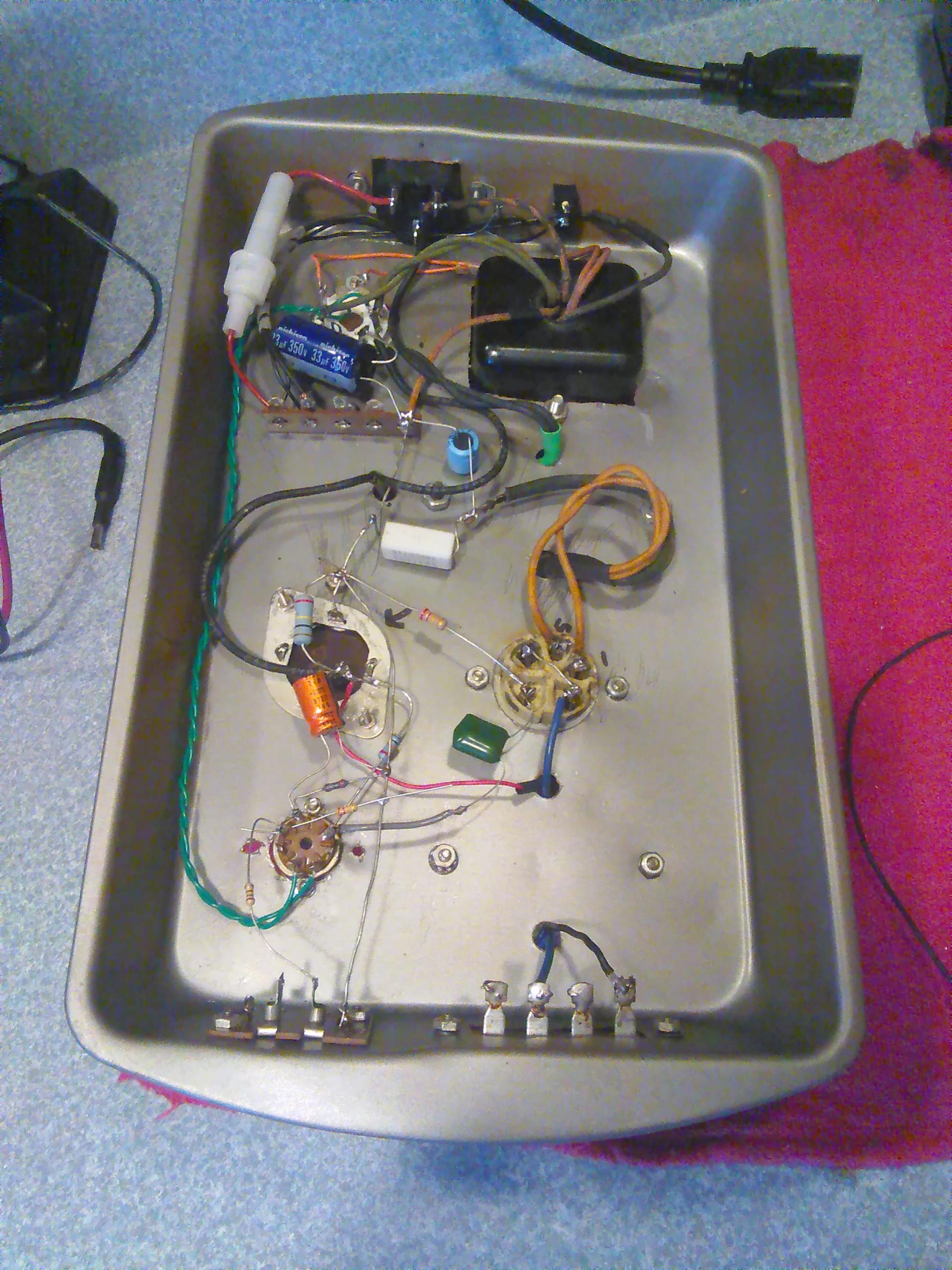

Pics are attached, still wired as triodes; there's not much to it really - very few components required to make a working amplifier. No leads were cut so the parts can be recycled for further use.
I'm already looking ahead to possibly a push pull amp using 45, 46, or 47 - I have enough tubes to do either. For some reason, almost all my 46 and 47 are globes, which is kinda cool. Not sure how that happened.
Win W5JAG
