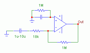

Rarkov said:Hi,
What is the purpose of the capacitor and resistor going from the +IN to ground?
Thanks,
Gaz
Without you will end up with around 100mV DC Offset on the output. Since the feedback resistor is 1M, the "+" to ground needs to be the same, the input DC currents on both inputs are then balanced out and the DC Offset should be below 10mV typically. Occasionally the "+" resistor value needs to be tweaked for lowest Offset. The 0.1uF AC bypasses the 1M at audio frequencies, so the 1M is only seen at DC.
Joe R.

I have just tested the amp modules and get 1.36 VDC on the output of both of them I've checked the circuits, voltages etc and am at a total loss loss to explain the amount of offset. BTW, I tested them with a 47K resistor across the input.

GC is DC isolated from buffer with 3u3 input cap. Problem is somewhere in GC. Please, measure DC voltage on 3u3 cap on GC side.

I was testing the amp modules on their own, ie not connected to the buffer. I just put a 47K resistor across the input and powered them up and both have 1.36 volts on the output (measured with a 10R resistor across the speaker terminals).

Is there any cap inserted in serial with input resistor and 47k from -input of LM to ground for DC isolating. If there isn't, that could be the problem in your test circuit. IMHO

The 47K is from the input to ground, and the 18K input resistor goes to the input of the LM3875 so I'm not sure how a cap could be in serial with both.
The answer is that apart from the decoupling caps, the only cap in the circuit is the 0.1uF which is in parallel with the 1 meg resistor from non-inverting input to ground.
In other words, the circuit is exactly as Joe's circuit AFTER the 3.3uF DC blocker BUT with the 47K from input (immediately before the 18K input resistor) to ground.

Moamps is probably right. It could be very likely you get the voltage you mentioned because you don’t have a cap at the inverting input’s path to ground in your testing circuit. Non-inverting input sees 1M, inverting input sees 47k//1M=44.89k DC resistance. (I’d rather expect to see negative voltage at the output in this case but I might be wrong here.) This input however should have an AC path to ground so I'd suggest you to try to put the cap in as shown below.

Edit: Note that you are dealing with higher values resistors around the opamp now and this makes DC offset issues more "obvious".

I should look more for all the relevant info but, assuming no external injection of current (and there wasn’t any in this case) i.e. one separate opamp (and no multiple DC coupled stages), I always seen that the higher (relatively speaking) resistance from the LM3875's non-inverting input to ground means lower (or negative) offset at the output and this is related to the fact that this resistance always develops a negative voltage (NPN input). I guess it is the same with the majority of opamps.
