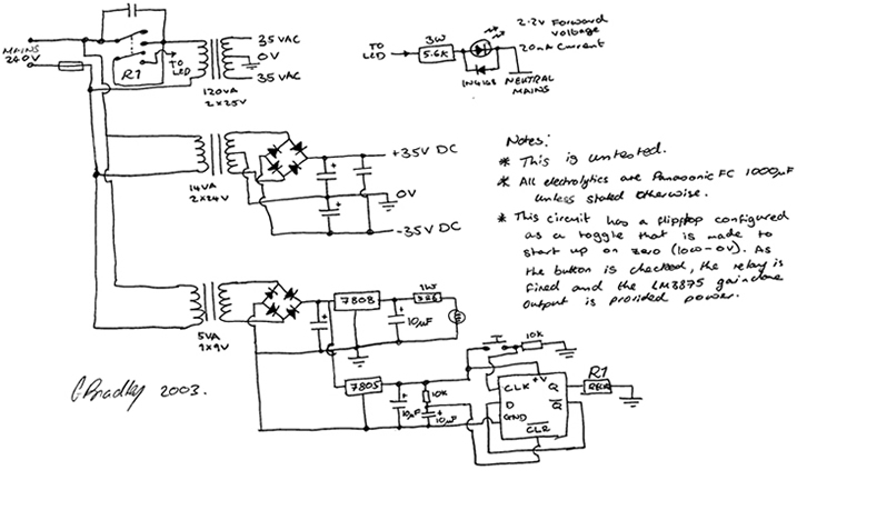

My PSU
Just in case anyone is interested, I have doodled a quick schematic that will make the Hybrid Gainclone always power up with the tubes on and the Gainclone off. There is a flipflop configured as a toggle that is reset to low (zero) on power up. It will not go high until the standby button is pressed. Similarly when the button is pressed again, the gainclone section will be powered down. This does not, however, include loudspeaker relays - although doing so should be trivial.
The button I'm using has an incorperated LED so there is a circuit in there to handle that.
P.S...Please note that this is UNTESTED...
Post on here if you want the full sized version.
Just thought you may be interested...
Gaz
Gaz

1. Recalculate preresistor for LED (Ohm's law!).
2. Check 1N4148 maximum characteristics
or place this circuitry on the secondary side (I don't like LED on primary).
3. Heater current is about 0,3A.
4. Toggle switch is incorrect (input impulse former is missing).
5. Relay must be driven with a transistor and a safety diode.
6. Is the tube going to work 24/7?
regards
Hi moamps,
Thanks for your input...
1) The resistor is half the values needed for the same value in DC. By putting a diode in reverse polarity with the LED and halving the resistor value, this enables it to run from AC.
2) Make it a 1N4001 or stick it on the secondary as you mentioned. You're quite right about the 1N4148 - it only takes 100V. My mistake! Sorry!
3) Hi sorry...Wasn't paying attention. I'll try again: 300mA for heater, 71mA for relay, 19mA for logic. Comes to 400mA, which is still 155mA under spec.
4) input impulse former is missing? Sorry - can you explain? I'm not sure what you're talking about. I got it from a book and some uni notes from the 1st year!
5) Yeah...I suppose so. I was hoping to get away with it but the datasheet for the flip flop chip I'm using doesn't have current handling specs in it.
6) That was the idea. Is it not advisable? I always leav my amps on. Sorry - never used tubes before...
240V/10mA=24kohm
[/B]
Your transformer will be too close to the limit.
Use one 7806 for heating and CMOS logic, directly connect the tube (6V)

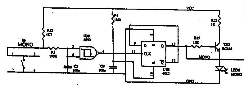

[/B]
Theoreticaly, your diagram is OK. But, switches are tricky things and tend to make noise.
Look at the picture below.(CD4093 on input)
regards
Rarkov said:2) Make it a 1N4001 or stick it on the secondary as you mentioned. You're quite right about the 1N4148 - it only takes 100V. My mistake! Sorry!
the reverse voltage on the 4148 is just the forward voltage drop on the LED or about 2v.
the 4148 will have no problem whatsoever.
