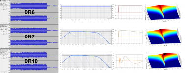

Two zip folders below one with B&K curve and one without and beside convolution file is also Rephase settings file inside folder if any settings should be wanted edited to generate a new different convolution file, convolution file is at 44,1kHz / 262144taps long / 32bit LPCM stereo wav file.
In below visual used the original Opeth track minus 6dB to get headroom in DSP engine and JRiver have nice function where it can output to disk writer instead of soundcard which is usefull for this situation with many taps long convolution filter because hole track only takes few seconds to convolute and be ready to analyze. To simulate linear phase plus IIR XO speaker used system stop bands at 10Hz plus 22kHz and XO points was 80/640/2560Hz 4th order LR.
