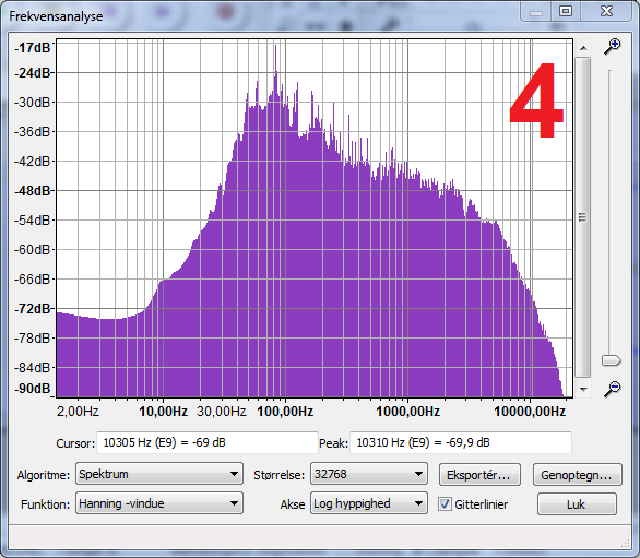

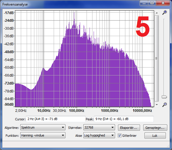

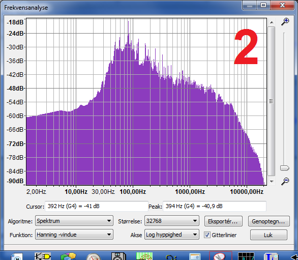

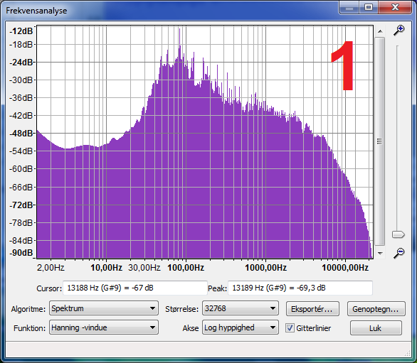

I accidentally found out that my tube equipment seems to act as a "dynamic expander" according to Dynamic Range (DR) measurement. I noted that Audacity's "Peak" bars were jumping higher when I recorded my tube equipment and I cheked the DR with Foobar2000. The DR was really bigger with tubes! This happens also with just the soundcard loopback (DR is slightly bigger than the original file) but at lesser extent and I don't know if transitor electronics would accumulate the effect like tubes seem to do.
Software: Audacity was used for recording, Foobar2000 played the file with wasapi drivers.
Soundcard: Behringer UMC202HD, acts as the recorder AD-converter in all recdordings. Also acts as DA-converter in measurements 2. and 3.
USB-bridge: (when using tube DAC): Sinxer SU-1
Tube DAC: CS8414 + AD1865 --> I/V-transformer --> simplistic 101D tube stage --> output transformer
Tube pre: TVC transformer --> simplistic 101D tube stage --> output transformer
Tube Amp: simplistic 101D tube stage --> 1:2 interstage transformer --> 300B (or GU50) tube --> output transformer.
When measuring the whole systeem I recorded the signal from speaker output while speaker was connected as a load.
Let the number do the talking.
Left / Right
1. Original file: 6,00dB / 5,80dB = DR 6
2. Soundcard loopback: 6.48 dB / 6.25 dB = DR 6
3. Soundcard with the tube pre in the loop: 7.09 dB / 6.69 dB = DR 7
4. Tube DAC + tube pre: 7.91 dB / 7.58 dB = DR 8
5. Whole system (dac, pre, amp): 8.75 dB / 8.32 dB = DR 9
You can download the files here: Opeth
I hope the magnificent Opeth does not mind being the test signal which I used in my experiment and distribute them for the science.
The difference was/is so big that it got me very curious what causes the "dynamic expansion". Any speculations?

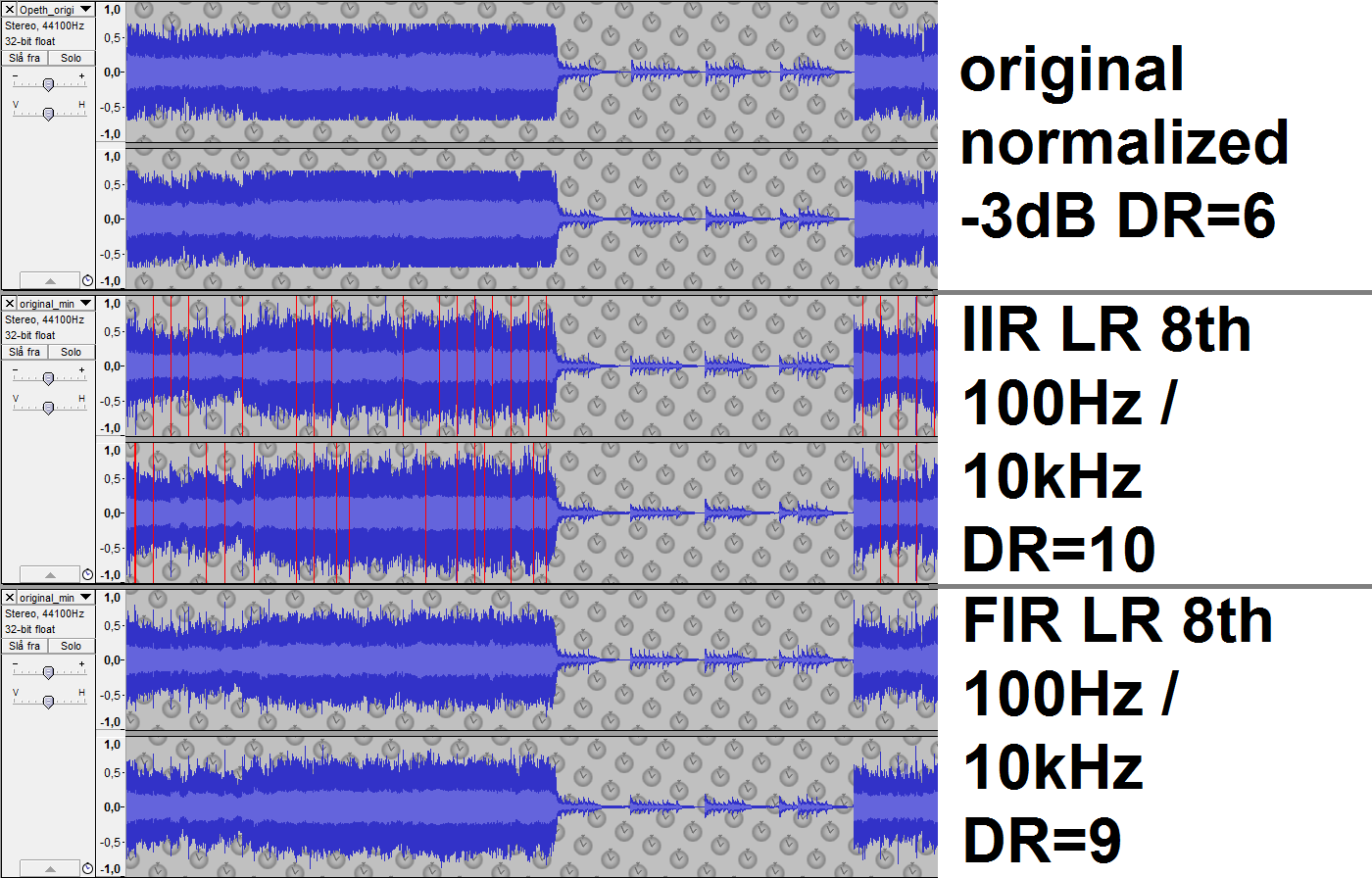

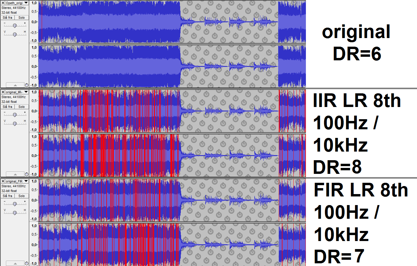

Found the culprit! The dynamics are "increased" because of the phase shift of the bandpass filtering of the tube stages and transformers.
I had done the previous experiments with the original file, which does not have headroom to show the increased peaks when filters were applied! When I did identical filtering to original file (1.), Soundcard-loopback file (2.) and "Whole system" file (5.) the Dynamic Range increased in both the Soundcard and Whole system file but not with the original file.
I added 48dB/oct filters to 50Hz and 10khz to rule out the differences in freq response near the extremes. These are the DR results after the filters (they should all be +/- the same):
Original file:
6.08 dB / 5.93 dB
Soundcard loopback:
11.37 dB / 10.59 dB
Whole system:
11.12 dB / 10.41 dB

Here's the pictures before and after the 48dB/oct filters from Audacity. The upper pair in both pictures is the "original file" and bottom pair is the "Whole system". The original file gets compressed by the filters and their phase shift - that's why the DR does not increase when one applies filters to the original file!
Without filters:
With filters:

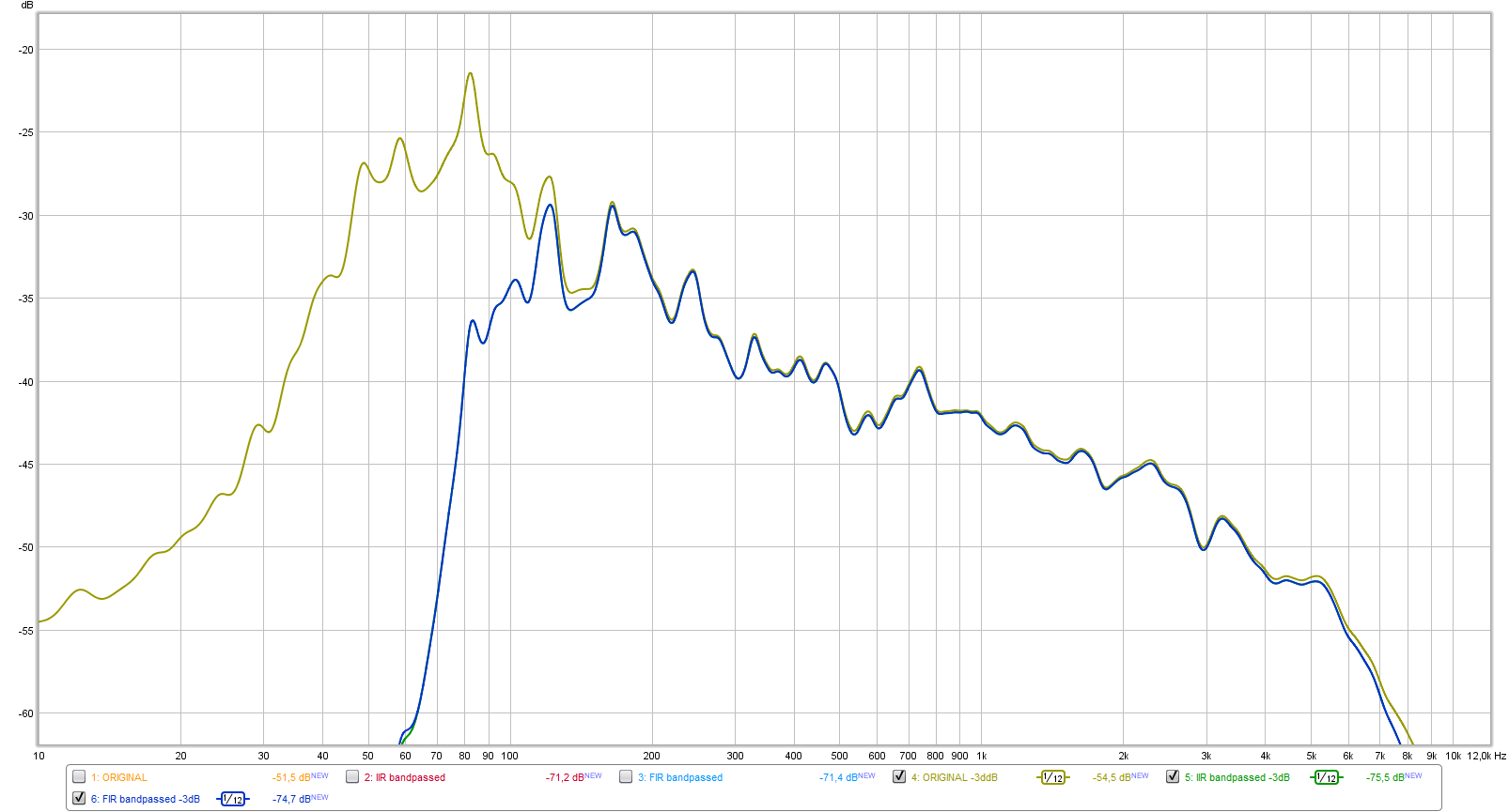

Not shure i get this stuff other than the band pass filtering effect.
Instead of using Audacity filters tried run original track through JRiver DSP engine with band passed IIR LR 8th order at 100Hz and 10kHz and after that tried same but this time as FIR filter (linear phase). Presented below in Audacity plus DR numbers taken from JRiver, REW plot is spectrum imported from Audacity and smoothed 1/12.
Second set below is same as above except that original track was first normalized -3dB in Audacity before processed.

A linear filter does not affect dynamic range. A distorting filter could affect all sorts of things and render all measurements meaningless.
What do you mean, filter's phase distortion will affect the wave shape and thus the "dynamic range" of the wave form. Below is -1dB and -7dB 1khz square wave with and without 100Hz 48dB/okt HPF. Yes, the filter's "filtering frequency" is much lower than the base frequency of the played square wave and still the phase is distorted.
I figured that square wave is a transient (starts from 0 and accelerates fast) and thus it's very short spectrum (at the exact time when it's state changes from 0 to non-0) is expanded towards high and low frequencies and this is why the phase distortion of the 100Hz filter affects the wave shape of the 1khz square wave. But again my signal theory is shite.
But anyway, filtered and unfiltered square waves have the same "sinusoidal information and level" (if that makes sense), only the phase is distorted and thus the wave shape. The DR of normal square wave is "+2dB", whatever that means (very low DR and the algorithm gets confused). The DR of the phase distorted square wave is 2dB so there is 4dB difference. For reference the DR of sine wave is 0dB.
Also the clipping is clearly visible in the pics what also happened with Opeth, the phase shift "moves the energy" so that the peaks get higher and the left side of the square wave is pronounced.

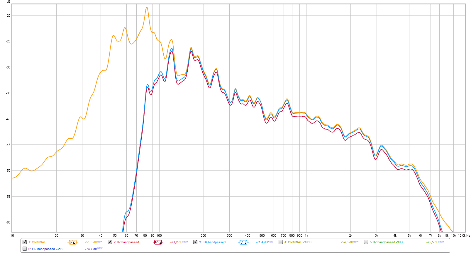

I wonder how DSP's handle these in general. Thank to BYRTT for measuring the software-DSP of Jriver, which did not handle the test very good(?) without prior digital attenuation. Could somebody else also measure the DR of the Opeth's song after you have put 48dB/oct 50Hz filter in it with the DSP and recorded the signal right after the DAC (which has good bass bandwidth)? Preferably some physical DSP like MiniDSP. Too bad that I don't have Nanodigi anymore, i would measure it myself.
If you want to test it even further, then upsample the Opeth to 24 bits, how the DSP handles it then. DSP's usually force the outputted signal 24 bits so 16bits source material might have better changes of survival?
