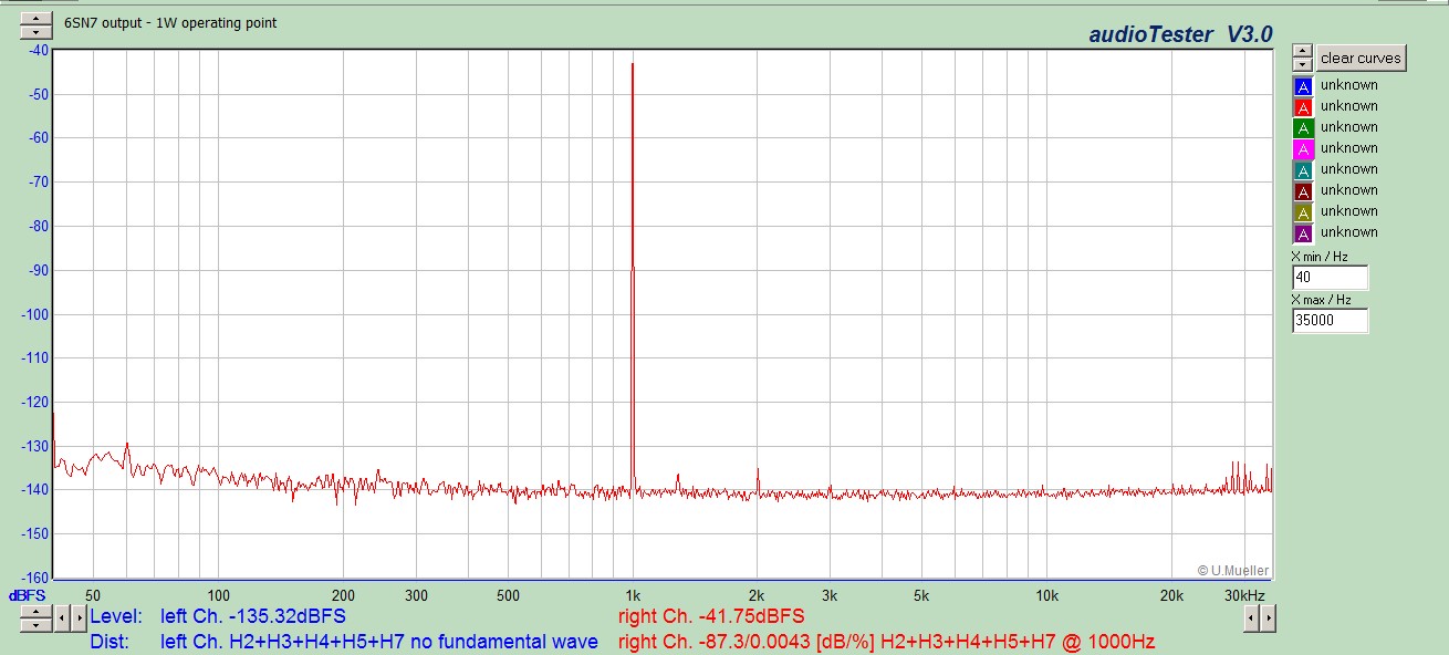

First they were "much the same", now it is more linear. I suggest you actually start to build some circuits and stop desperately trying to make your case from datasheets. It is not helping your trustworthiness.
The SN7 is ridiculously better than a 12AU7. Try getting a 12AU7 to do this. Yes, this is SN7 at preamp levels. And damn near perfect. I can also show you the same exact tube operating at tens of volts, but it might confuse you having to look at two graphs. It has before.
