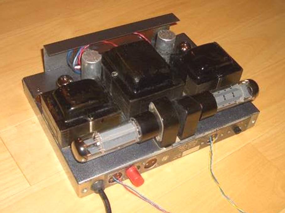

Thanks for the reply. I was asking because I have a Peavey Triumph and would like to try some KT88's because I hear they have some real character bur my sockets are mounted to a PC board and are too close together to mount such large tubes. I have contemplated making a horizontal mount and fabricating adapters to connect them to the factory sockets. But I wanted to see if there is a logical reason tube are never (to my knowledge) mounted horizontal.

You see it a lot in guitar amps, and yes, it is stressful (to power valves and rectifiers), as the hot electrodes can sag and short. Some data sheets specify certain mounting orientations. It isn't a big deal for preamp valves if they're operated at low power levels.
Upside-down mounting can also be stressful as the rising heat is blocked by the chassis and gathers around the valve base.
As a general rule, small signal valves can be mounted horizontally without any problems and some preamps do this to get everything in a small (SS-like) case.
As a general rule, power valves are best mounted vertically upwards. Horizontal mounting will require careful reading of the datasheet as there is often a restriction on orientation to reduce grid sag.

The Philips amplifier EL6405 had all the power tubes mounted horizontal (EL36)

amc 2030 has horizontal power tubes....I've seen many covered mono blocks with horizontal tubes
