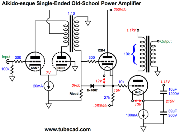

I just bought an Impasse pcb, and I'm still planning on trying that, but would an LTP with MOSFET source follower outputs be better for this particular application? I'm thinking a 6N6P LTP with 10k plate loads and a CCS in the tail, DC coupled to something simple like IRFBC20 MOSFETs, would work well.
yes, this seems like a good plan, and if using IRFBC20 MOSFETs looks like a simple and yet effective, and you have an option of balanced /unbalanced inputs with balanced outputs,
since you got this in your first post, i suggest that you do this and find out...
the 6FQ7 seems good for the ltp, or you may want to try the 6GU7, a tad lower mu...
I did some LTspice simulations last night, and the LTP with MOSFET source followers looks far better than any other option. You get the lowest THD and the most output swing, no matter which triode you use. There are several twin-triodes with mu of 15 to 20. All look very good in simulations.
I took the measurements from the pair of 10k:600 Edcor transformers I have, made a quick model, and did a simulation with various single-ended triodes driving them. I compared the various circuits with 1V RMS output on each output (which would be 2V RMS differential). The THD from the LTP and source followers is down around 0.01% at that level, and all 2nd harmonic, which will cancel in push-pull. The THD from any triode into the 10k:600 OPT is up around 0.1% (I tried 6DJ8, 12HL7, 5687, 6N30P), with some 3rd harmonic (which won't cancel out) along with the 2nd. I tried parafeed too, and the THD is basically the same.
So yes, the LTP w/ source followers wins in the distortion department.

Re: Shef's suggestion -- That's interesting. Basically use a line level version of this headphone amp:
DIY 6DJ8 (ECC88) Tube Hi-Fi Headphone Amplifier Project
Will need a negative supply for the tail, of course.

Cascode the source followers?
Or cascode the CCS under the LTP?
Anywhere. Really. Especially the source followers.
cheers,
Douglas
With 7V on the cathodes' CCS not really, IMO.Re: Shef's suggestion -- That's interesting. Basically use a line level version of this headphone amp:
If to make that CCS efficient from down to 0.6-0.7 == all to the minimum possible (correct me if I misunderstand smth) then 7V is fine without the negative rail. Versus e.g. CCS on LM317 where its "minimum efficiency voltage" is 1.25V + some 317's drop, that's what I figured from experimenting.
That 0.6-0.7 could be achieved with CCS path consisting of a single transistor, which could be controlled by the network fed from B+ or the additional LV source.
I think the Lundahl LL1922 4 + 4 : 1 + 1 will work perfectly for your goal. Unlike, for mine I need it opposite and at least 1 + 1 : 4 + 4 as suggested by Bandersnatch, which seems be the tough load for the 6SN7 LTP. I ordered some trafos for testing, hopefully it will work for driving either fixed-biased or the MOSFET output stage.
