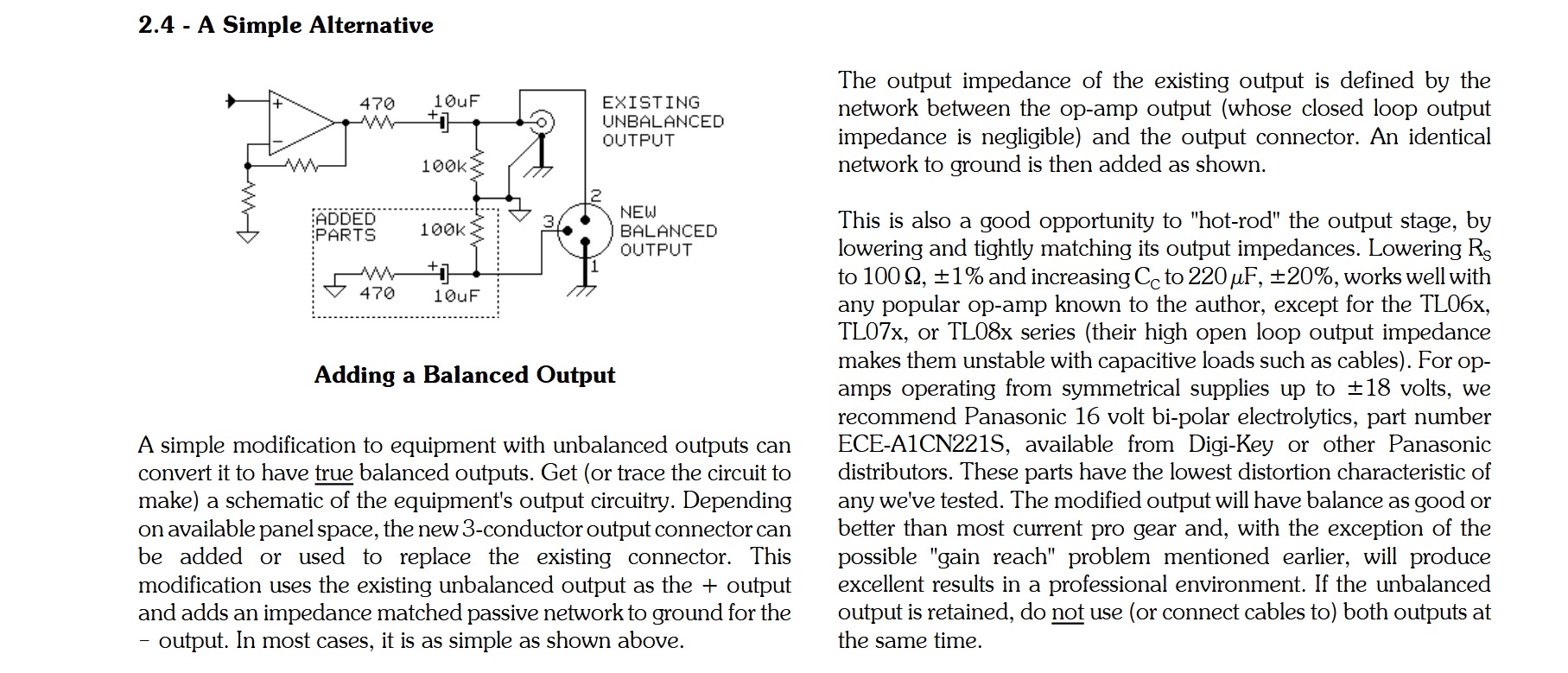

Here's something else to consider from Jensen Transformer's Application Notes #3. Posting this is like grinding sand in the eyes of certain manufacturers, but this frees you up to do just about whatever you'd like. (Also, I've used this and it works just fine!)

so why not just use a cinemag or a jensen 1:1 traffo?
Good question!
One (self-inflicted) problem is that I use one of Dave Slagle's autotransformer volume controls (AVC). That's supposed to have 300H inductance. My setup has a 'passive preamp' kind of thing, with a Niles Audio input selector box, with interconnects to the Slagle AVC. The output from the AVC would then go to the primary of the 1:1 transformer. Would that be a problem?
Incidentally, I do have a Jensen JT-114-1 waiting in the wings. I'd be glad to use it for this.
Perhaps I could put buffers after the volume control, before the primary of the 1:1 transformer. I guess a single 5687 or something with each triode wired as a cathode follower. I could use a bi-polar power supply so the grids could be at ground potential, eliminating a capacitor.
