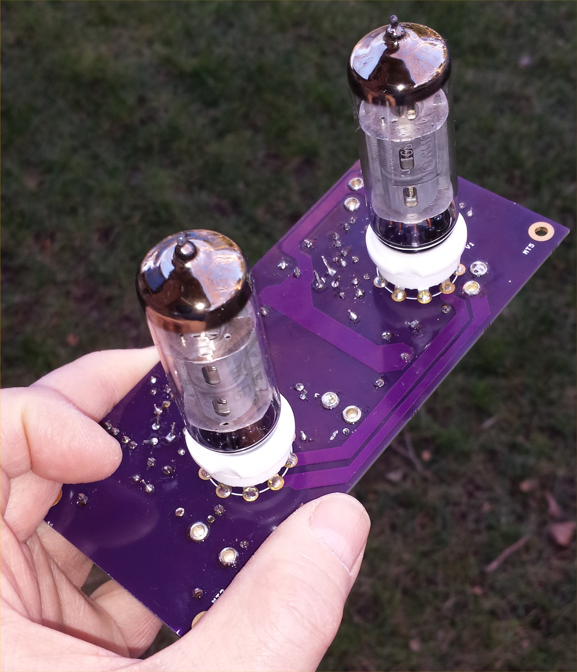

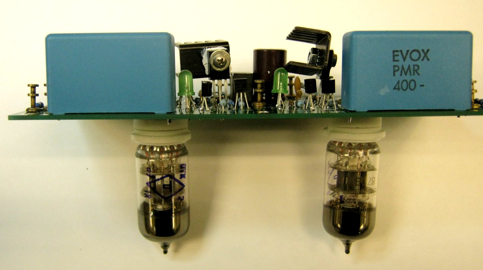

Here's the top side. The filaments light up, I'll try to light up the rest of it some time this week. If the static voltages check out alright, the rest should work. I did a somewhat simpler version of this circuit in breadboard form in my "Evil Sandman" thread that did just fine.

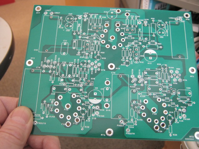

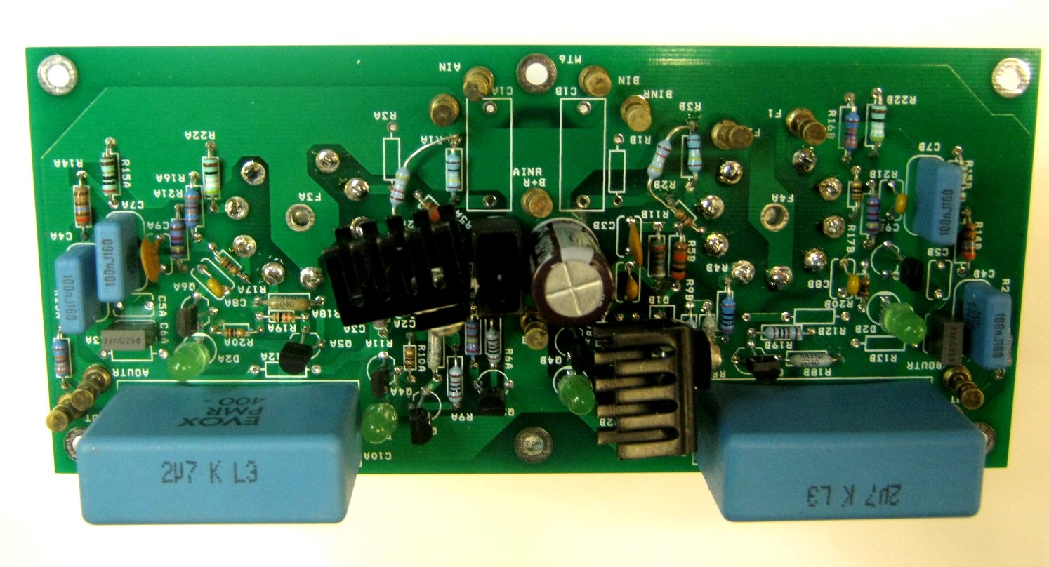

Here's board for the next module. a feedback-based RIAA preamp designed around the 6N3P-EV with sand helpers. The front end is cascoded to ease capacitive loading for finicky MM cartridges (high-end AT cartridges come to mind).
It's not a cool swooky purple board like the line amp module, but it's cheap, and will do just fine.
Another view. When all is debugged, I will do custom heat sinks or reconfigure PCB to make room for std heat sink. The heat sinks are mounted sideways so they'll fit. Since all the big components will hang down into the chassis one the board is in place, this is not a real aesthetic issue for now.

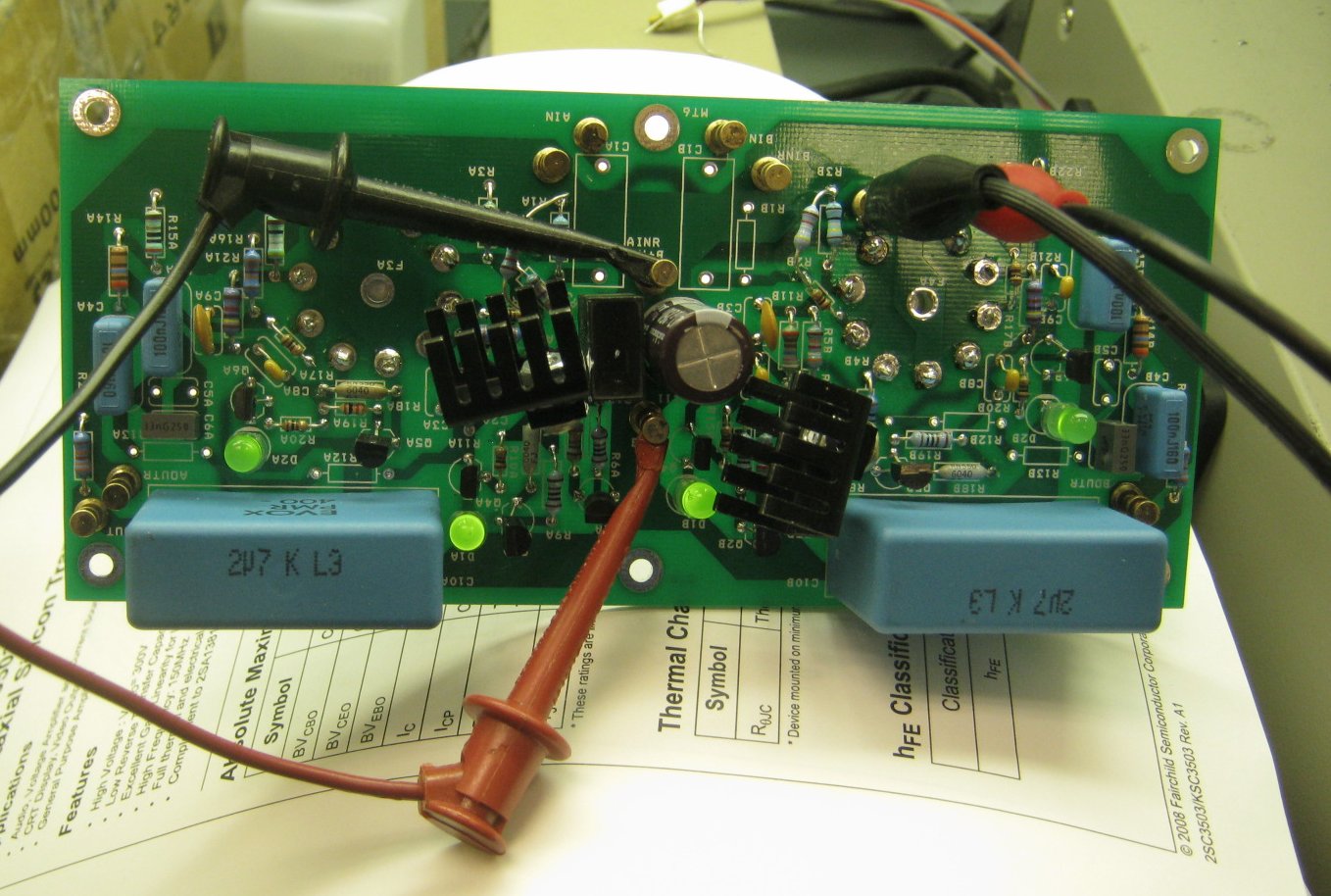

Fired up board with bench supplies. Filaments light up (easy part). Dropper LEDs light up on both second stages (sign of good health), and I get about 35V DC output level before the coupling cap (expected). The cascoded input stages (both of them) didn't light up at all. Digging into this problem I learned some interesting tidbits about the design philosophy for the chosen topology, applied changes, and got one input stage to light and deliver 45V DC before the coupling cap (expected). I'll fix the other input stage when I get some spare time. It better sound nice...

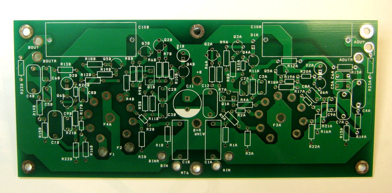

Power amp layout is pretty much complete. The design is similar to Pete Millett's "E-linear", but uses a much more humble pentode for the input stage, and there's a follower slung between the input and output stages. I'll be using 6L6GC for outputs, so am expecting at most ~8W output. I have a pair of 5k Transcendar output transformer with ultralinear tap that will serve well to test the completed amp, assuming I can find the transformers in the basement.
I got the power amp PCB last week, and I'm busy bringing up the amp with tubes in place but without the output XFMRs, in order to get the bias voltages and currents settled in. More info on that later. Today, more thrills & spills - my new RIAA/line amp combo board came in - here's a look.

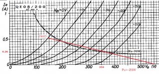

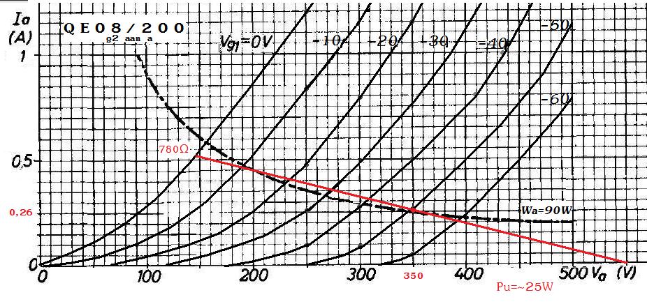

You could consider a QE8/200.Class A and filament draw considerations immediately ruled out sweep tubes (even though the price is right), as any sweep tube with 30W plate dissipation wants 2.5A or more on the filament. The hefty cathode in your average sweep tube is not used to advantage for a single-ended Class A design anyway. Save them for monster P-P designs.
I may try a KT88 in my next build of the power amp to try and squeeze out an honest 10W of single-ended power. Same board, slightly different stuffing and operating point.
Allmost a 2.5x KT88, plate diss.100W, heater 6.3V 3.9A and triode strapped 0.5A @ 150V max.(Vg1=0V).
