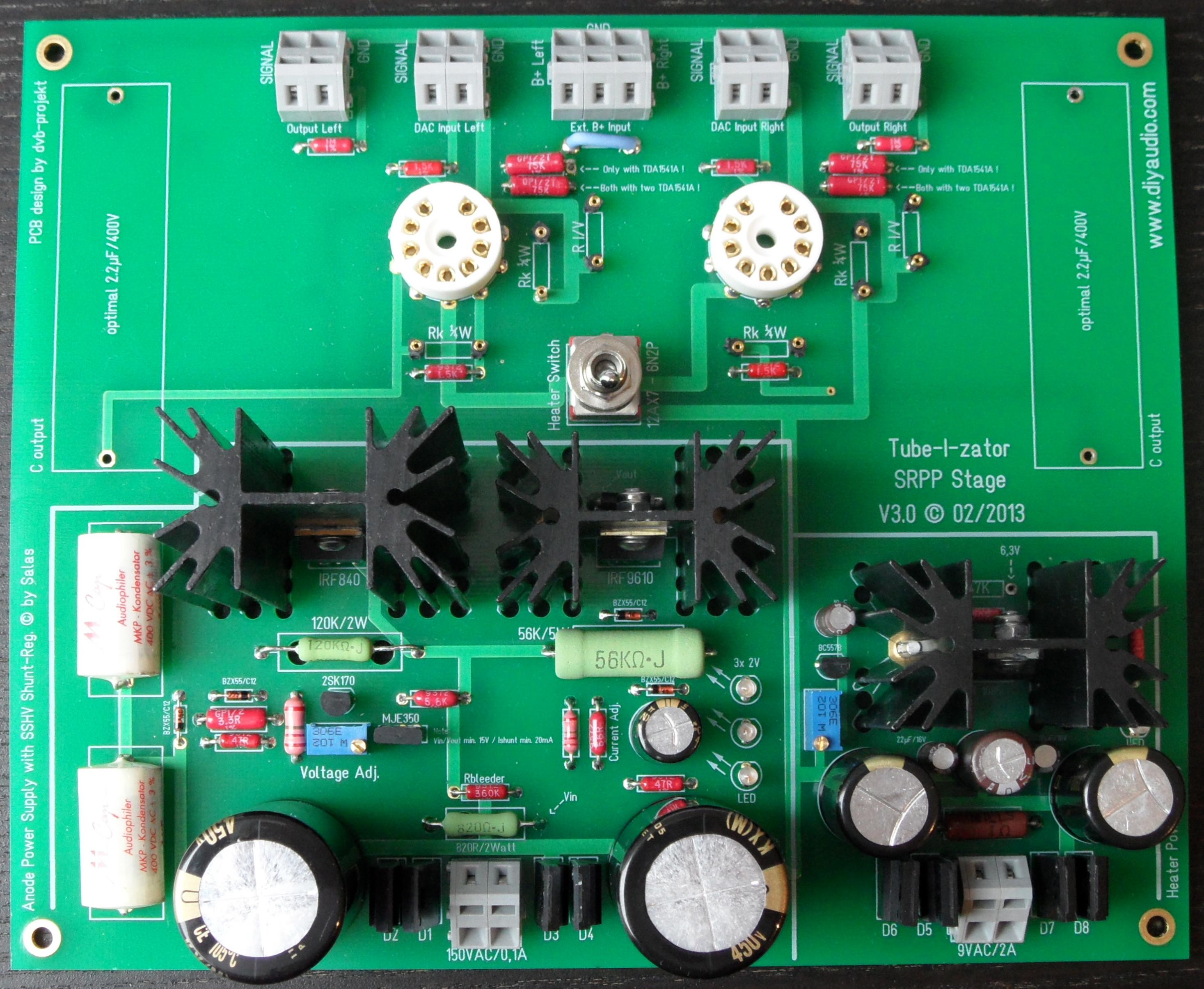

The new Tube-I-zator V3.0
The evolution brings the following changes:
- Anode PSU with Salas SSHV Shunt Reg. onboard
- External B+ Input for usage with other Anode PSU
- Heater PSU with C-R-C filtering
- Heater PSU with Softstart circuit
- Heater PSU Power LED
Thanks to John (-ecdesigns-) for the following suggestions!
- Grid stoppers to prevent unwanted oscillations
- Bias current injection for TDA1541A usage
- Pull-down resistors to keep the coupling cap output at GND-potential
Still on the Module:
- Heater switch for 6N2P or 12AX7 usage
An example for a balanced use (e.g. Bufalo II), you could see HERE.

Joined 2009
Attached two quick pictures of the populated Tube-I-zator V3.0
:wave:

Hi Oliver,
Is is OK to add R26-R31 from your V3 schematic to my V2 boards?
I am running 2 x tube-i-zators v2 in a balanced, dual mono format with 2 x Bullalo IIISEs. I am currently using 20R I/V resistors but have ordered 4 x 30R Rhopoint's to try out.
I obviously don't need the 1541-specific mods but what will the difference be having made the mods?
Any difference in values for balanced/dual mono build?

Hi Crom,
you could add easily the two 1M0 pull down resistors (R30 & R31) to keep the output of the coupling cap at GND potential. Otherwise equipment could be damaged when connected (high voltage on the output when the coupling cap is discharged).
If you haven´t problems with oscillations, you could omit the 1K5 grid stoppers (R26-R29). Because of the new layout for the V3, John recommended to add these resistors.
The values stays also for balanced/dual mono builds.
Best regards,
Oliver
