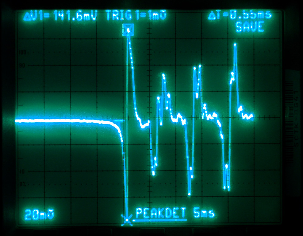

During the Hundred Buck Amp Challenge I wired a scope across every guitar I own and wailed on them pretty hard (humbuckers and single coils). The most I saw was about 3 volts peak to peak. The loudest guitar I have is an old Guild with DiMarzio humbuchers. I captured the initial peak of a single note here, about 2.8 volts P-P.
The humbucking pickup measurement was done playing a late model LP Custom with pretty hot (~8K-12K) pickups into a 10M scope impedance, captured with a stored trace.
The piezo measurement is from a single graph-tech "FAAS" bass pickup on a nylon harp string about .050 diameter and 24 inches length. This was also measured with 10M load and I'd estimate under 10pF capacitance.
I would characterize 10V as the not-ever-exceeded- but repeatable- value. At the same time, I would agree that designing for 3V p-p would be a reasonable assumption for most cases.

....DiMarzio humbuchers. I captured the initial peak of a single note here, about 2.8 volts P-P.....
Scale seems to show 0.14V peak to peak. A 10:1 probe would be wise and make that 1.4Vpp. Did you have a 20:1 probe or other attenuation?
I'm 90% sure that guitar very-very rarely deliver more than 0.5V-1.0V peak (1V-2V peak-peak), so they fit in the grid of a 12AX7 without distress. (And that players who do make more "want" distressed sound.)
