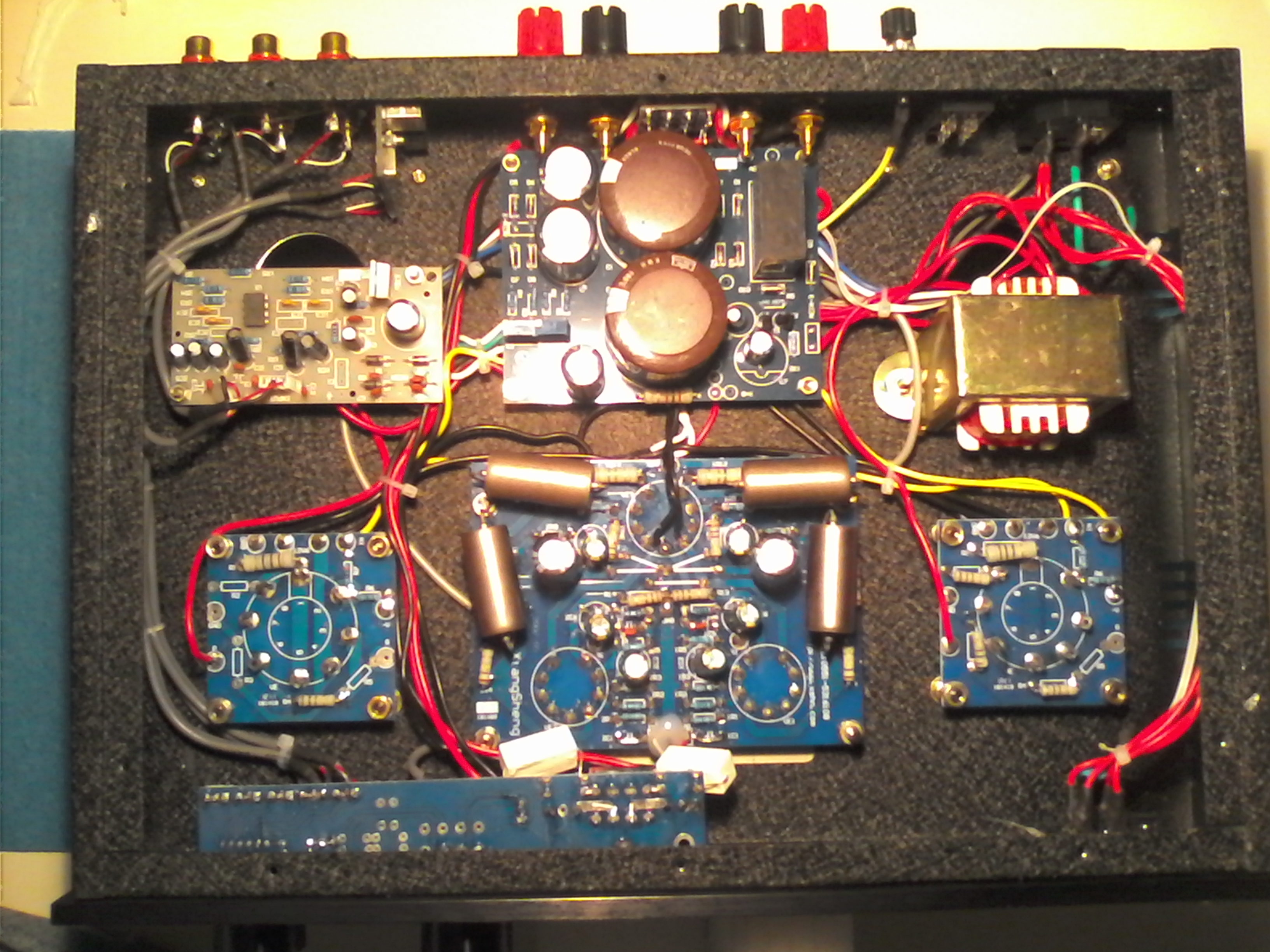

Hi guys,
This is my first post on this board, but I've been reading along a lot here (and elsewhere) in the last few weeks, and thanks to all the great contributors here..!
I've been getting back into audio gear (and listening) again in the last months after what has almost been a hiatus in the last few years, also bought some chinese value gear to substitute my broken old stuff.
Just yesterday, a sparkling new FU-50 peach - black of course - has arrived at my desk, which I'm planning to feed from my also Xiang Sheng made DAC 01A, and running into some 4 ohm / 83 dB speakers, which is plenty loud enough for me now since there are 2 little kids around the house.
First impression is quite nice, even though a few things are bugging me a little. There's some hum, the volume pot knob is grinding a little against the front plate, and the right OPT got a knock during shipping and is now leaning a little towards the power tranny... Also, the stepped actuation of the volume pot is a pita at low playback volumes. But all in all, still nice stuff for the price i paid, and good potential for modding.
My mods will be described in following posts, some pics should be enough for now.
gOLDENbEER

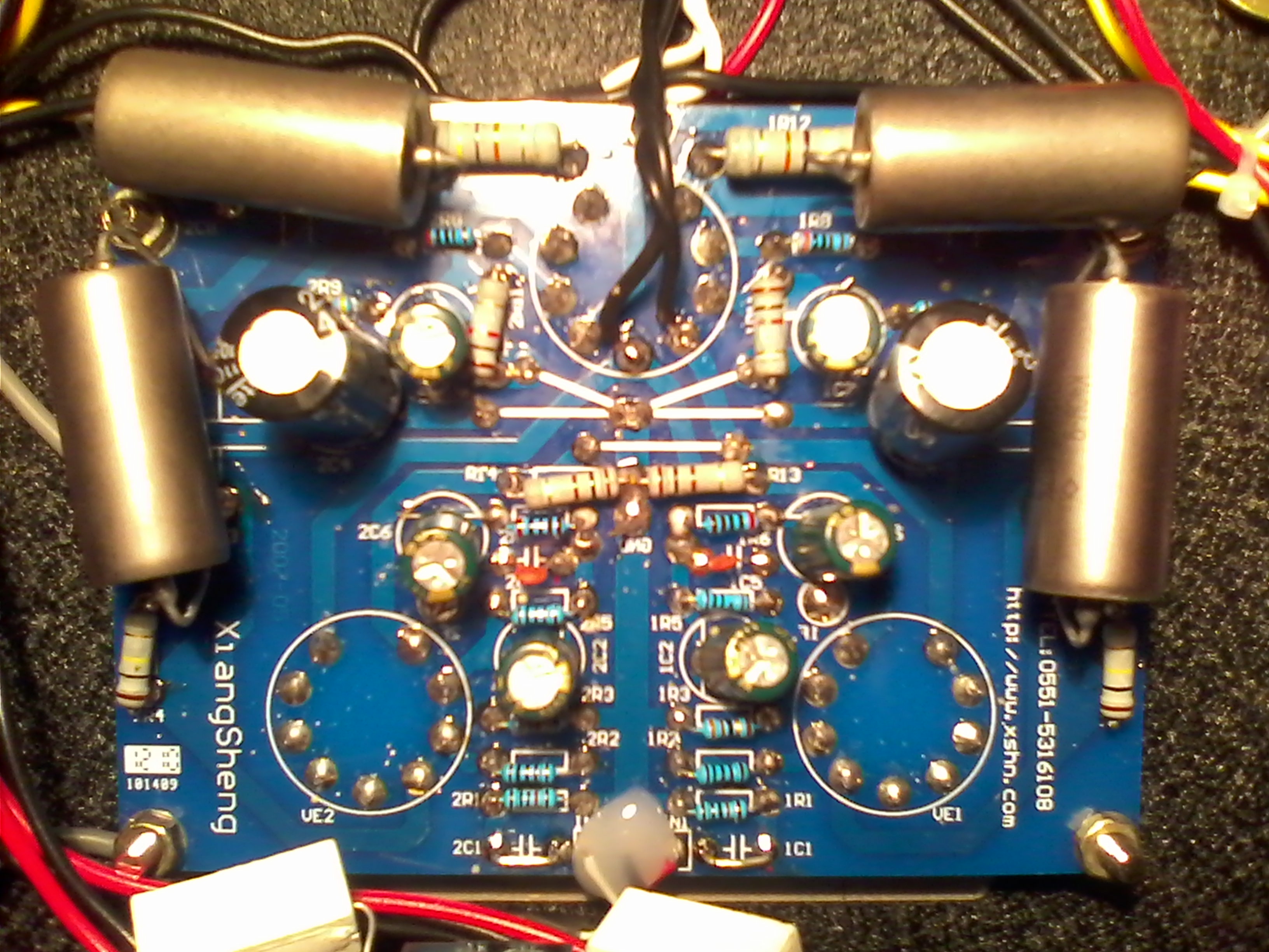

Ok, I started off with the essential changes which are
I am planning my next tweaks, and my approach will be KISS and not to mess with the topology for the time being if not required. Mods I was thinking about include
Last resort
- short wire the electrolytics on the volume selector input board - I did not pull them out yet due to bad accessibility. I guess it makes no difference in sound anyways.
- remove and short the small input caps on the center pre-stages board
- replace the 4 WIMAs with russian PIO K40Y-9 as coupling caps
- re-bias FU-50s for 60 ma.

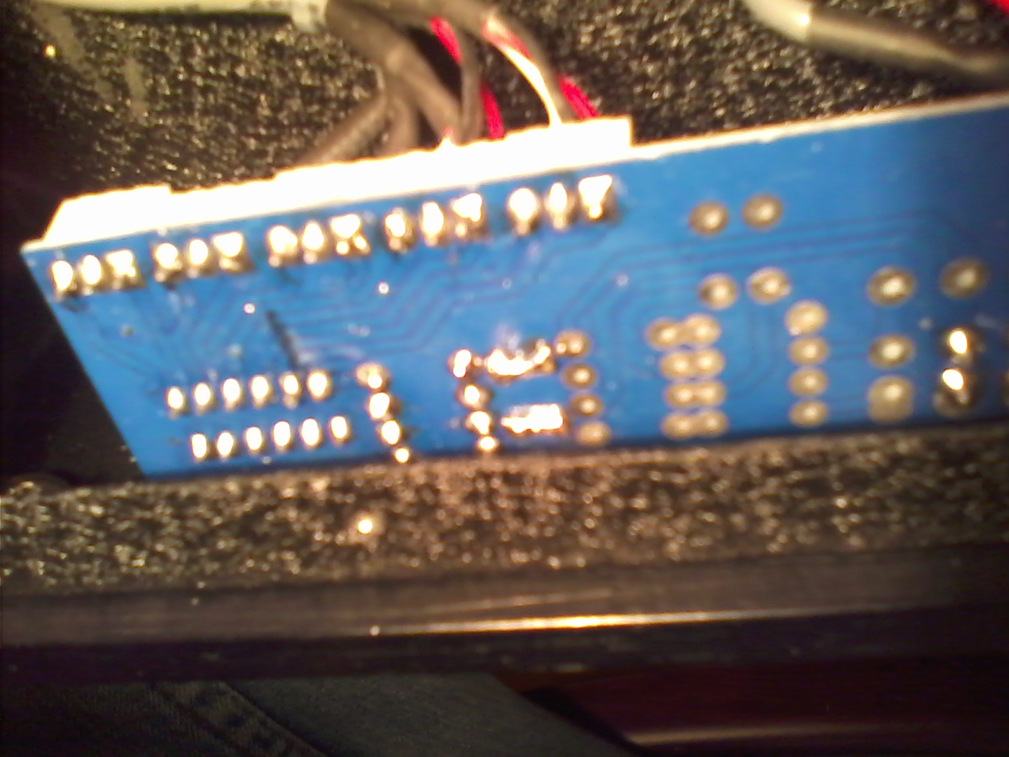

Some pics, first is the bridged input caps on the volume selector pcb, the others show the innards with the k40y-9 PIOs in place..
