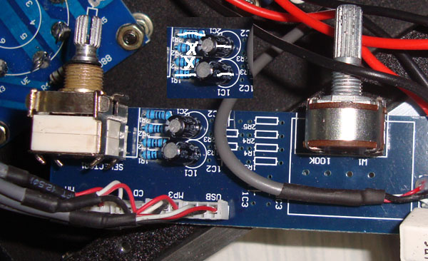

The input resistors have no purpose, just remove them.

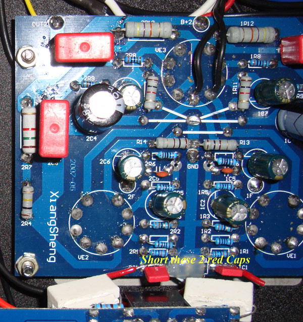

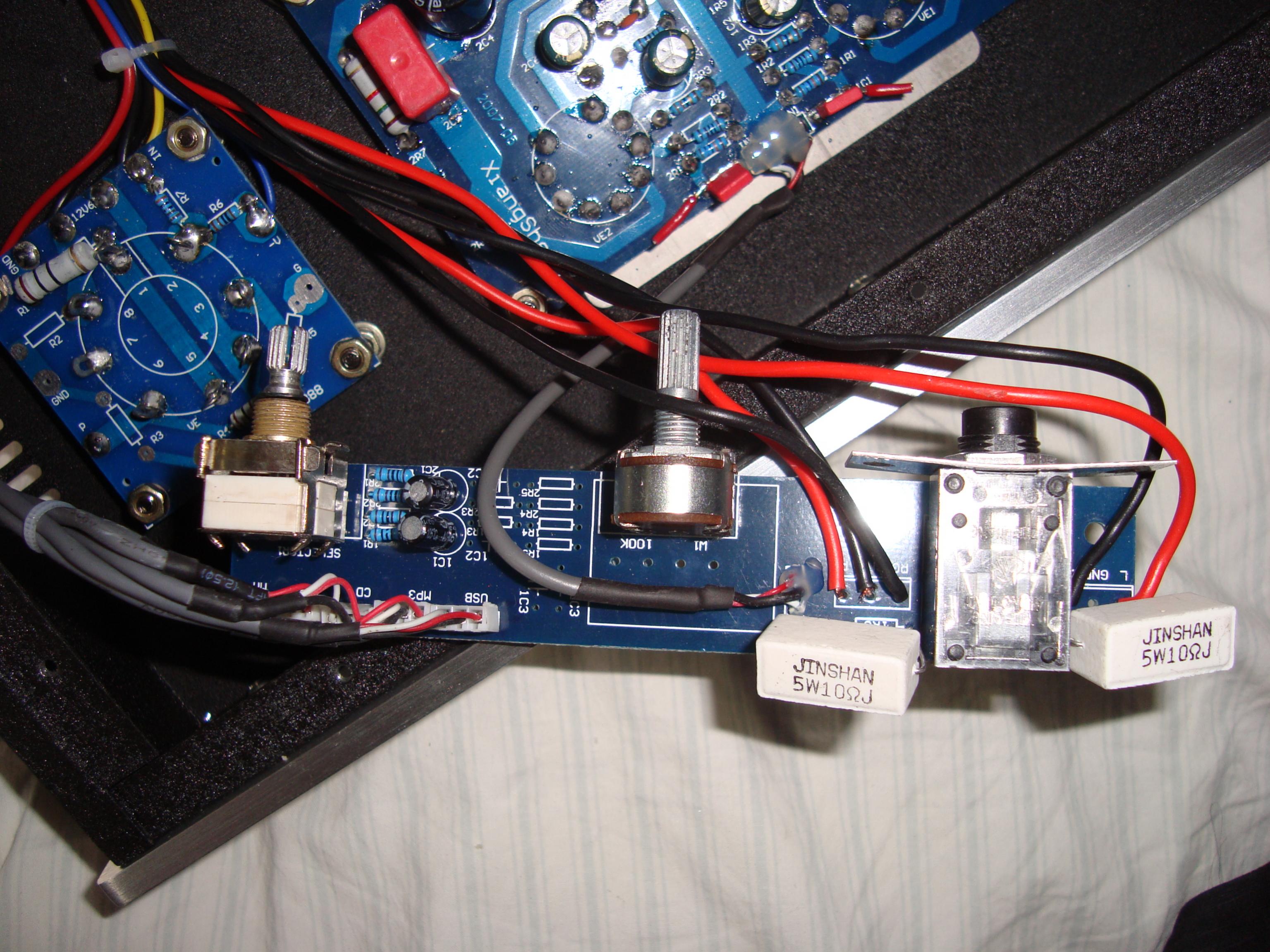

I thought that I would post my upgrade path thanks to all the info here.
In order of the changes, here is what I have done
1. shorted out the 2 (wima?) input caps on the tube board (1C1 and 2C1) (pictured)
2.removed input resistors on selector/volume board and shorted caps (pic). of the 4 resistors, remove the inner pair and short the outer 2. Short the caps. This can be done from the rear of the board without removal if you have solder wick to allow pulling the 2 center resistors
At this point there was clearly an audible improvement. It's too hard to describe.
3. Rewired 6N1 socket for 6v paired filaments for 12AU7 tube. Added Tung Sol 12AU7W. Sound improvement was dramatic. Soundspace/imaging quite noticeable. "cleaner" sounding. Replacing the tube was by far the best change. I should have done it first so I could tell what the diff was when bypassing the input caps.
Unfortunately, I ordered .1uf 250v Wima caps to replace the big red box caps because one of them was labeled 250v and I believed it. I can't seem to find a source for the 400/600 volt caps. Once I get the new caps, I'll replace all the ones on the tube board. I already have the Jamicon 220uf but the .68uf wimas are in the mail somewhere.
Does anyone know the min voltage for the 4 red box "wima" .1uf caps? Any suggestions for adding parallel bypass caps to the stock ones while my search for replacement parts continues?

Hmmm - why do you want to swap the wires around?
The 0.1uF/Red boxy caps should have a rating of 400V minimum, you can easily pick up suitable caps online, either from RS, Farnell, Digikey, Rapid etc. or ePay.
These ones look fine - I use them but I also bypass with Russian silver mica ;)
