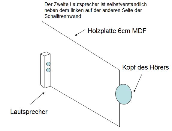

The barrier is a real drag, more so if you want to watch movies. I have to remove the top of the barrier for that.Plus I had to rig up 6 relay switches to derive the center channel to the dipole and left and right to an additional stereo pair in cinema mode. For me,however, it´s worth the hassle. I can´t enjoy music from standard stereo any more.
If you want to use a TV for Ambiophonics, you basically can't use a sound barrier. You have to use RACE software and a Computer. Although I successfully have build small 5" LCD Screens inside the sound barrier but that is no fun. According to Ralph Glasgal, a Sound Barrier has to be at least 3m high or alternatively reach up to the ceiling to work properly. It also should be made of 6cm MDF and some Rockwool to be able to hold frequencies successfully down to 90HZ.
Concerning crosstalk: I've often read on forums that some crosstalk is needed, because that is how it is in real life, but I am sorry to say that that is nonsense. A stereophonic system produces uncontrollable crosstalk and the one sound is represented by two speakers set widely apart. The sound stage is also limited to the incidental angle of the speakers. In Ambiophonics there is no crosstalk and with two closely spaced speakers the direction of the sound can be carefully controlled. The speakers are very close to each other, so it just seemes that one ear hears the sound louder than the other, which is the best way to produce sound as natural as possible. In stereophonics crosstalk happens twice instead of once.
Wolfgang

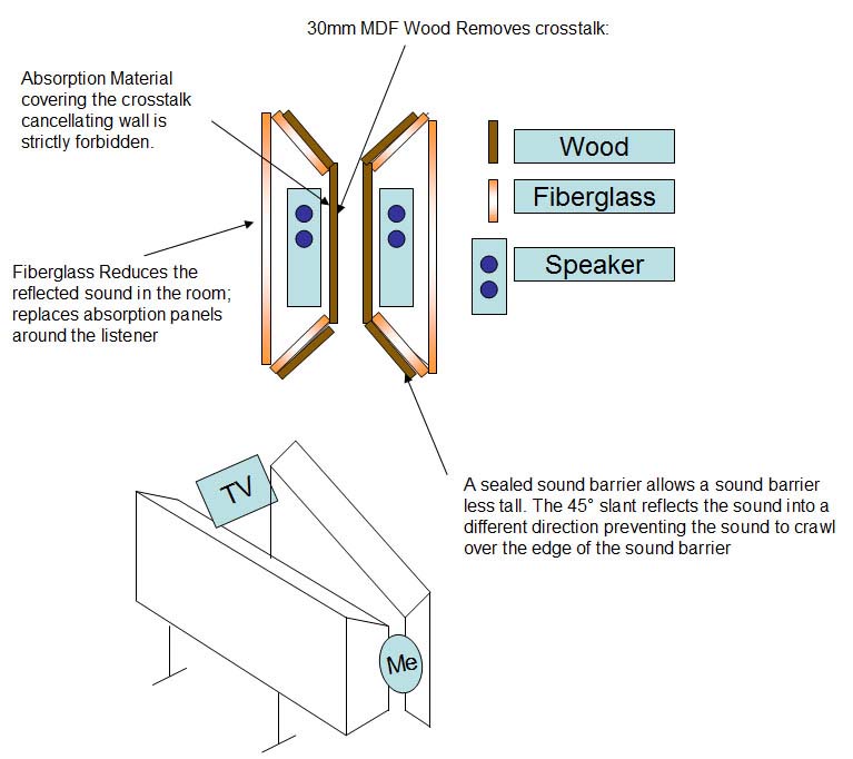

I've found a way to use a TV (if not a beamer) in Ambiophonics with a physical sound barrier. Ralph Glasgal was very enthusiastic of the concept and it should definately work. Call it a tube sound barrier.
The positive changes to the plain sound barrier are that, first of all, barely any sound escapes into the room and you need no room treatment at all except for the bass (Bass traps only). You have space for the legs and the barrier should be easy to shift in the room. If you would make the plain sound barrier properly (6cm MDF) you would even save a lot of money (depends how large the speakers are. You should be as close to them as possible, but large speakers with lots of drivers require a longer distance from the listener. Better stick to small 2-way ones) And of course, you can use a TV.
The negative changes are that it will be a little more complex to build (compared to a simple plain) and that you cannot move back and forth as much; you cannot move your head so well.
If you have a wive which doesn't really like your hobby, this is great news for her. Far less sound escapes out into the room because of the tube barrier and it disturbes noone.
I am building my tube barrier ambio system in about 4 months and will go through each step exactly.
Please post if you have questions! I will answer them as soon as possible.
Stay tuned!
Kindest Regards,
Wolfgang

Wolfgang,
That is a very, very interesting idea indeed. One I must have a stab at as soon as I can. Please keep us posted on your effort.
The need for the inner side of the cavities to be free of absorption seems intriguing to me since common sense would suggest otherwise. Could you explain the reasoning behind this?
Also I´m thinking a non absorbent cavity may add a honky signature to the sound as horns usually do ?

The reflection on the inside of the tube has a reflection angle of less than 5° so there is barely any distortion. If you use absorption material on the reflection point certain frequencies get absorbed more than others. The remaining sound is strongly distorted and with a reflection angle of 5° the sound doesn't decrease in volume. What you end up is a very strong distortion in the frequency response magnitude.
This is a very common mistake people do when implementing a sound barrier in Ambio. Make sure to remove the fibergless or rockwool from the wood on your plain sound barrier.
YES! I was worried about honky sound too when the sound gets reflected by the wood. But Ralph Glasgal explained a 5° reflection angle doesn't distort the sound enough to make a difference. (Make sure to use MDF!)
A quote from one of Ralph's e-mail:
"I still don't really believe that any reflections within the tube will be audible. But if the internal sound proofing will keep sound from escaping the tube then this is fine if it doesn't cost too much. A reflection angle of 5 degrees vertical or horizontal will not be audible in my opinion. If you actually eliminate every reflection in the tube you will lose loudness and this will strain your vacuum tube amplifiers and thus increase distortion. Also the frequency response of the sound will be changed because different frequencies will be absorbed at different rates no matter how you build the thing."

Wolfgang,
I just put some acoustic-absorbent material above and to the sides of my speakers and barrier. My crosstalk barrier is itself very absorbent, hence the severe db loss and need for more amp power.
Following your indications I´ll next substitute plain mdf for the current barrier and hopefully restore some of the lost db.

Make sure the tube barrier is tall enough for the speakers you will use. You might get a nervous breakdown when you realise your speakers don't fit in it. The speakers have to be very loud, because as you said the volume decreases in the tube barrier. I did not decide on my speaker project, but it's probably going to be some kind of PA two-way speaker.
In a normal room 100db is a nightmare. The sound rings in you ears and you get very aggresive. In a treated room it should be possible to play music at 100db and more without the sound quality decreasing. Using the Tube barrier, there is no limit. The sound gets as loud and as good as the speakers allow. Therefore I would recommend a pair of small sealed PA speakers. Hi-End PA speakers are very expensive, so better save some money first.

It seems like it's better to use a slant of 30° not 45° for the top wood plate. Otherwise the remaining bits of sound get reflected into the room horizontally, reflected by the wall and more of the distorted sound will enter your ear. Better use a slant of 30°.
And here is my concept of the tube barrier when using tall speakers. Use Rockwool and Wood in the same manner as in the smaller one. This one might be less practical.

After a hectic couple of days testing different iterations based on your design I have returned to my previous plain barrier. Two main reasons:
I found that a lot of absorbent material is needed for effective inter-channel interference, which along with the refflective inner sides of the tubes wreaks havoc with the tonal balance at the listener´s end.
This can be overcome by voicing the speakers filter in a way that counteracts the inbalance. Personally that´s a task I am not ready to tackle right now (spent a few years tweaking my filter to adapt to the absorbent plain barrier).
Also, an effective tube barrier turns out to be pretty bulky and at least as high as the listener´s ears, so it´s finally not as inconspicuous either.
I have to say that the idea warrants further testing, however. It may not be long before I give it another shot.
