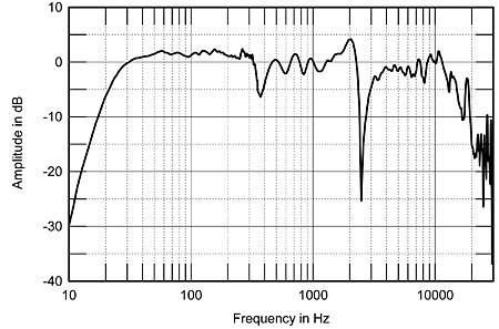

What about dips in the frequency amplitude (like in the graph I uploaded), can you here these?

from the article
"Crossover frequencies: 300Hz, 3kHz"
that is measured at 50".................
"To be fair to Avantgarde, however, they strongly warn against measuring not just the Uno Nano but all their speakers at distances of less than 2.5m (98"), because the relative differences between the distance of each drive-unit from the microphone will be extreme. Unfortunately, I can't place my microphone that far away from the speaker and still get a meaningful response that isn't corrupted by the reflections of the speaker's sound from boundaries. Therefore, these suckouts may look worse than they sound."
well, on the graph of the individual drivers, the mids peak near 2.2khz then drop like a rock, the driver resonates then vanishes.......... the high freq driver seems to roll off below 4khz.
this can be crossed at 2khz

I installed Audiomulch, and all of the impulse files were unlistenable. The pitch of the files was completely off; it sounded like the songs were being played at 75% of their normal tempo, maybe less. I have a quad-core, with plenty of CPU resources, so I don't think it's the PC.
After listening with the Foobar convolver, it sloooowly became apparent that voices had artifacts. It reminded me of the compression artifacts you hear with mpeg, where the decay of a sound is unnatural. Also, the reduction in treble grows irritating with music. When listening to podcasts, it was quite nice, because they don't have much treble. But with music, the treble sounded wonky.
Also, on some music, ambiophonics seemed to "null out" the vocals. It reminded me of one of those plug ins that are designed to remove the vocals from a music track for karaoke. Definitely not a good thing.
All in all, an interesting experiment, but the effect on the treble is (almost) intolerable. I only listened in the car for about 30 minutes, so I'm hoping to have an opportunity to listen longer.
