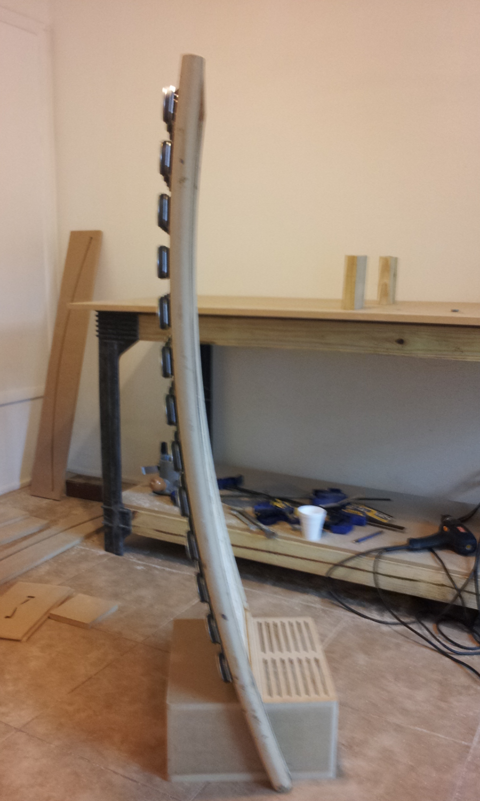

They are not side by side Norman.
The outer top 8 drivers on each side are the ones using race, those are actively crossed to the inner two rows and the last bottom 5 on the outer sides. I have two Dayton amps going in the box at the bottom, along with the mini-ambio.
I will eq the (top 8) outer drivers that are running RACE to achieve a 2nd order slope (LR) at the drvers fs. Mini ambio has 4 bands peq.
The rest of the drivers will be run off the second amp.
These Dayton amps have a 3rd order low pass....
So if I set the crossover on the amp at say 50 hz, that should get me a -6 at 40 hz because the 3rd order low pass will actually be a 2nd order low pass because the drivers are gaining 6db an octave as they are approaching the dipole (baffle step) if you will.
So, I'm guessing the crossover will end up around 150 hz (LR 2nd order) for both high and low pass. But we will see how that pans out in testing.
The good thing about this configuration is that I can set the low pass on the amp at 50 hz for extension or set it at 100 hz (which will give me a -6 db around 80 hz) for dynamics.
I have an 18" sub coming in the mail for my dipole H frame sub.
That one is going to be called (the singularity)
See the theme I'm going for?
I'm excited to hear your comments on the sound.Code:Im excited to try it out!
How far do you reckon should you sit from the speakers for the sound from all those drivers to gel ?
Well the arc is set to focus at 9 ft, 2.743 meters for you.
So, maybe 8 ft is better for a few inches of vertical movement.
Comb filtering will be above 20 kHz at that angle.
But I'm thinking (through my own observations with my dipole full rangers)
That, it should be set up 9 ft from the back wall, and having the ears at 1 or 1/2 ft away from the wall to have the reflections act as a 2nd ambiopole behind you.....to push pinna cues out to the sides.

what will be the final impedance and how many amps will you use ?
Only the top 8 of the outer sides use RACE
2 series 4 parallel = 4 ohms
I can choose to wire the rest for mono or stereo
36 drivers
Mono will be 6 series 6 parallel = 8 ohms
Stereo 3 series 6 parallel = 4 ohms
