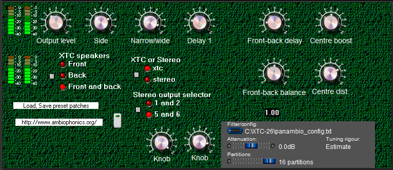

Is your program going to include the solution to the over-under estimates that R.A.C.E is faulty at?
And are you even going to add the attenuation and delay to the two bottom knobs that say (knob)?

I would feel honored to try your software. Ten knobs sound like a lot of fun.I am hoping to find a few experienced Ambiophiles here willing to trade my latest VST for free for some beta-testing. It does not have controls for delay or attenuation but it does have ten knobs to play with.
Right now I have a virus-sick overheating laptop with a noisy fan contraption that I strapped to it plus a jiggly dc supply jack-engineered to malfunction after a year of normal use so one has to change the whole motherboard or better yet buy a new computer. Add to that the two usb audio adapters and dc supplies plus the cable mess, and the idea of a relaxed listening session has turned into a nightmare.
I will try to fix these problems best I can. Having a go at your software is tempting enough to forget these issues.

I hope someone will make dummy head recordings of a barrier in action to find out what is actually going on there. I just bought a shop dummy head, binaural mics and a pro soundcard myself. I used to stick panasonic capules in my own ears. Angelo Farina provided me will MLS software years ago for Cooledit, but that has long gone.
RACE sounds much better than I would have expected but I can certainly hear the effect of low and high frequencies not moving much with pink noise.
It may be 'non-optimum' but so is everything else, except perhaps in the inventor's own mind.
Computer generated impulses are capable of much more precise control of frequency and phase than barriers or RACE algorithms, but they take time to perfect and are fixed. I don't see the point of providing controls so large that enable you to generate unsuitable combinations of attenuation and delay.
My VST does eight convolutions and mixes them together in various proportions to satisfy the demand for knobs!
"Is your program going to include the solution to the over-under estimates that R.A.C.E is faulty at?"
My filters always have as I am not restricted to IIRs or 'recursion', although after inverse filtering to create a Dirac impulse at the ear, they look similar to RACE as they must in effect 'cancel the cancellations' to obtain a single pulse. This is probably not strictlty necessary to do, but 'looks right'. A flat frequency response would probably do. I'm not sure why RACE does not attempt some filtering within the feedback, perhaps the original software used would not allow it.
My filters and VST do many other things than just XTC which is just a part of what I think is needed for good stereo reproduction. Happily it sounds very good with binaural recordings, although it was meant for ordinary stereo recordings and ordinary rooms.
I have not labeled the knobs at the bottom but I may well call them Hugo and Zuccarelli as they create interference patterns at the ears, I think.. They certainly enhance the extraction of distance cues and spatial resolution.

Ralph had a nightmare getting the previous 2 channel version to work. There are some peculiarities to ConvolverVST involving library files, and peculiarities with AudioMulch 1 involving reloading VSTs which meant that he loaded a wrong config file that Windows kept remembering it and could not be replaced. I also takes a very long time to load in Win7 which I think is down to SynthEdit and the fact that it is Complicated(tm). I could not get him to use MiniHost, which was much more straightforward, although ASIO4ALL is more prone to glitching than the AudioMulch drivers.
What VST hosts do you have, if any?
It will work with just two front speakers but to get the full benefit you need a second rear stereo-dipole. There is a third pair of outputs that can be connected to a normal stereo setup for comparison purposes.
Ralph said that with my VST on the front pair and RACE on the rear, it was the best he had ever heard. I don't think he can use this version without taking his system apart.
You would be the first person to hear this outside of my living room!
