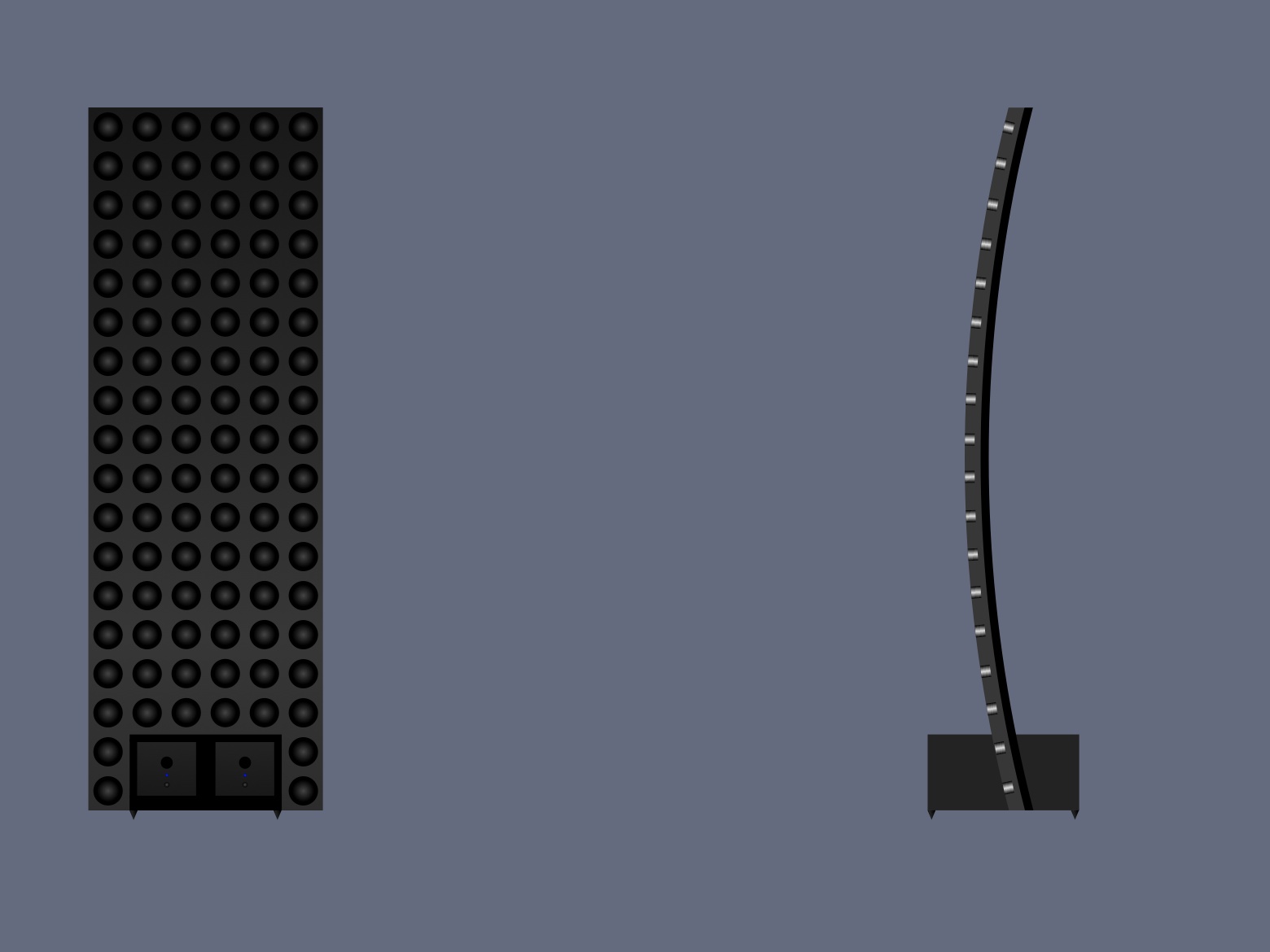

Alright you guys, I have been working on a design for an ambiopole on my vector drawing program, I will post the details and the drawing tonight when I get home from work. I've been working on this for a long time, I'm just about ready for the build. It's a culmination of all I've learned through the years. The build will cost me 1500 bucks so i hope i get it right! I'll be home in 7 hours, I got to go right now. Stay tuned
Ok, this is the ambiopole.
Open baffle dipole.
(click on above picture for enlargement)
It's a focussed array of 100 vifa drivers that Zaph has recently tested.
The outside lines are the ones that will be using R.A.C.E.
They will be wire in series parallel 6 groups of 3 to maintain a 4 ohm impedance. There are 18 of them.
High passed at 200 Hz 1st order, no high pass on R.A.C.E.
The remaining 4 rows will be split in two for right left, and will be wired in series parallel 8 groups of 4, also for 4 ohm impedance.
There are 32 of them x2
low passed at 200 Hz 1st order.
the array has an SD of over 4 alpha's with an xmax of 2.5 mm.
There are 2 two way Dayton amps at the base. 75 watts x2 in a 4 ohm load.
I will be using the minidsp-minidigi stack along with the miniambio.
I'm going to eq for a Linkwitz-Riley 4th order slope at 40 hz for easy integration with a subwoofer.
This of course will not be a cocktail party speaker, but a 1 person reference system.

I'd go with the $10-$15 tc9 driver. Is that the one ? copper cap on pole piece? The paper version of the ids25's fiberglass coned driver ? Had I someone to build one, I'd go for a 6' tall focused array and never look back. Seeing my avatar, I'd need at least the same area as a 12" driver per side.
Focused arrays are AWESOME !!!!!!!
You eventually get used to standing up and feeling disoriented (getting out of the sweet spot while listening). The combing makes you lose so much high end, your brain freaks out thinking that something is wrong. The music sounds instantly like coming down with a head cold, or it sounds like you are underwater when you arn't.
I look forward to your results.
