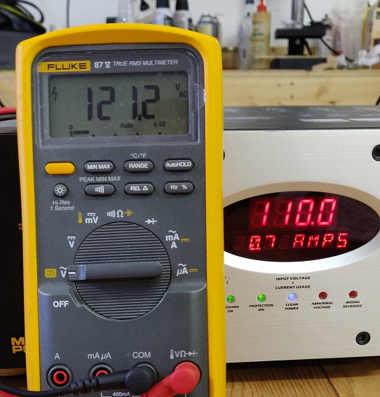

I'm bumping this older thread with the hope that I can get some insight into a used Monster HTPS-7000 mk2 that I just picked up.
The unit seems to operate properly, but the voltage reading on the front display is incorrect; my Fluke MM reads 121.2 VAC from the wall outlet, while the Monster unit reads 110. I measured 124 VAC from one of the isolated balanced power outlets on the unit. Is the incorrect voltage display indicative of a problem? If not, is there a calibration or adjustment so I can get the voltage to display correctly?

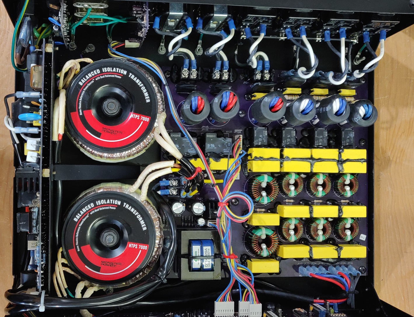

I removed the lid to have a look inside, and there is fairly loud buzz coming from the main filter board when the outlets are all powered on. There is no buzz when the outlets are not powered up. I think the noise is emitting from where the smaller transformer is located. The buzz is just barely audible when the chassis cover is in place. I'm curious to know if some noise is normal when these units are operating.

UPDATE: the voltage reading seems to jump around somewhat sporadically, it's currently alternating between 111 and 115 with nothing connected.

First, the buzzing of the filter inductors is normal although not desirable.
Second, the metering is "peak" responding and rms indicating. Harmonics make for the difference. Power supplies run from the peak voltage which is why we chose it. There is an adjustment inside somewhere. You need a low distortion AC source to set it.

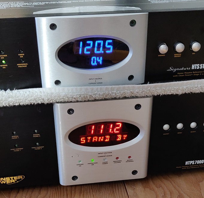

Does the Monster HTPS-5100mk2 measure power the same way as the 7000mk2? My 5100 stays quite steady at 120 VAC, while the 7000 is fluctuating quite rapidly between 111 and 115. I bought the 7000 to replace the 5100 but am not sure I should put it in my HT rig until I know it's working 100%.

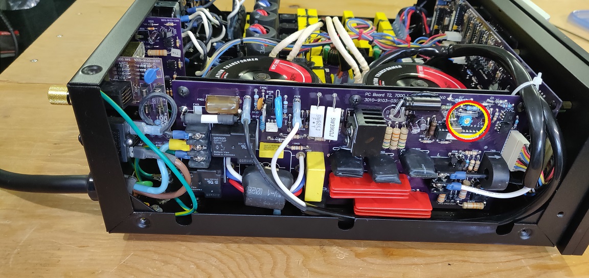

There is a trim pot on the 7000's T2 board which let me adjust the AC reading to match the 5100, which was reading the same as my Fluke 87V.

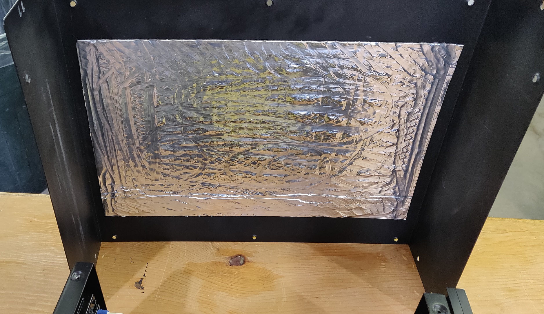

I kept in mind Demian's comment about the hum coming from the filter inductors, but I could barely hear any hum from the 5100 with the cover off, while the 7000 sounded like it was going to either launch into space or self destruct.
I foolishly convinced myself something must be suspect in the power supply located on the filter board. Since only cost a few $ in parts, I changed all the electrolytic caps (they had a date code of 2002) and the rectifiers, only to discover nothing changed. Hmm, could the transformer be on its last legs?
Then I noticed another difference between the two units...the film caps used on the filter board where glued in place on the 5100, but not the 7000. I got out my handy 3M hot glue gun and proceeded to glue the crap out the caps on the 7000. I also glued around the relays and the plastic screw terminals to kill any chance of them resonating. Now the 7000 is MUCH quieter, just a little louder than the 5100. Continuing with the damping theme, I also stuck a large piece of Dynamat like material to the chassis lid. Now with the top buttoned up, the buzz is undetectable.

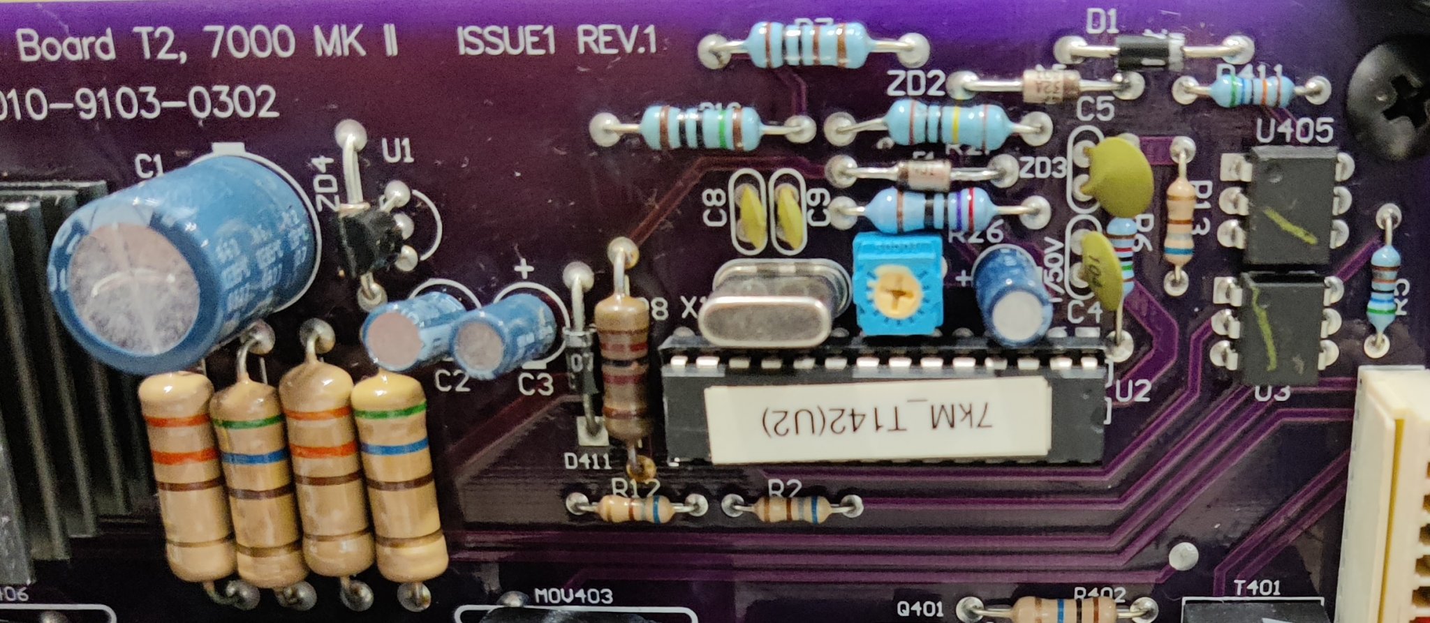

Digging up an old thread here, but my 7000 isnt powering up either. When I pulled the power board out, the R8 resistor next to the 7kM2 T142 chip was burnt up and all flaked away so I can't a good reading on it to order a replacement. The initial pictures in this thread are no longer available to view and I cant make out the color codes in other pictures since the schematics for this unit are unobtanium.
Would anybody be willing to help me out with a vale for R8 and or a reason why it may have burnt up in the first place. I checked the diodes around it and the immediate connections and they all seem to be fine.
