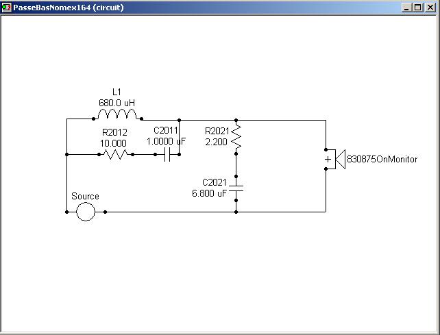

one thing that could be interresting is to put a CLR notch filter on the 810921 because it has a bump of ~2dB between the 12-14 kHz region.
Another approch is to use a waveguide to boost the 10-12khz region.
According to these pages, values of the CLR are 1.5 mF, 0.1 mH, 6 Ohms.

Is that coil part of a notch filter on the mid to deal with cone breakup? That was my guess, but I'm pretty unknowledgeable about crossovers.

I'm not sure if it is part of the notch filter...I don't really understand his drawings...I can however follow instructions...well I guess that depends on how much I've had to drink and how late it is...

Just to say that i'm working on voicing my Nomex 164.
Today I've increased the value of the coil of the upper medium/woofer,
Original value was 0.68 mH, I've increased to 0.82 mH.
I find the sound much more pleasant and less tiring at high SPL volume.
Simulations in attachment, blue is target curve LR24 at 3.3 khz,
black is with 0.68 mH, red with 0.82 mH value.
As you can see with a 0.82 mH coil value we are much closer from the target curve
