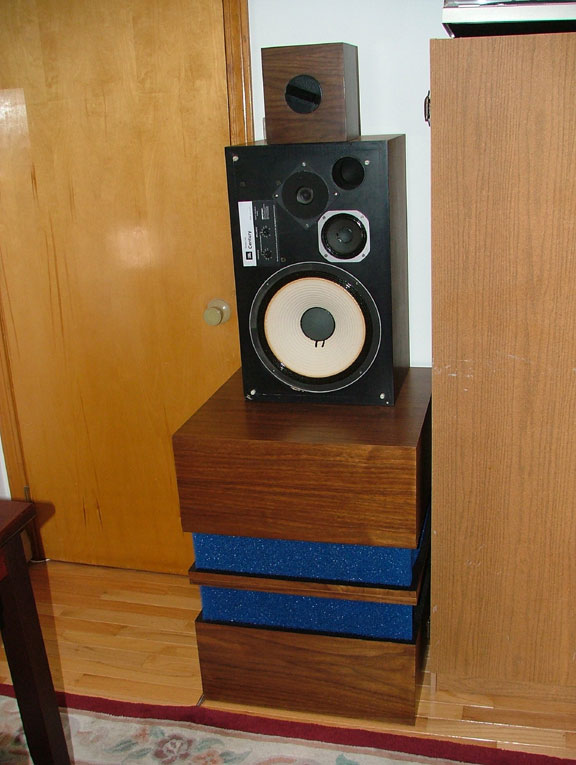

Well, I'll jump into the fray and share my opinions and experiences.
I run a tri-amped configuration. This is something I've evolved into for fun and in pursuit of better sounding music. since this isn't an amp discussion I'll stay out of those details. I do however use a DBX 234XL active crossover which I'm not happy with and will probably soon replace. The crossover is loaded with features, but I don't like the low-freq crossover. It isn't as clean as the Paradigm X-30 I previously used. Will likely buy an Ashly or build something.
I've separated my speakers into three types of enclosures. This allows them to be placed in the listening area in a way that best suits the characteristics of each. It also allows more flexibility in cabinet design. The sub x-over point is 80 hz and the HF x-over is 10K hz. This leaves a lot of bandwidth in the middle. No single driver will properly handle it. The three drivers in my JBL L100 do a wonderful job.
A good active crossover allows you to control the gain of each channel as well as contour the crossover frequencies. I wouldn't go any other way.

HipoFutura said:Well, I'll jump into the fray and share my opinions and experiences.
hipoofutura's design
Hippo, I'm curious, after looking at your pic. Do you connect to the JBL's and treat them as a single drive in your active crossover, which means you're also using the passive crossover inthe JBL's. Or, Are you bypassing the JBL xover and direct connecting to the drivers?

The L100 is fed by the "middle" band on the active crossover. This means it gets everything between 80 Hz and 10K Hz. Since this is such a wide band all three drivers in the L100 are used and controlled by the JBL passive crossover in the cabinet.
