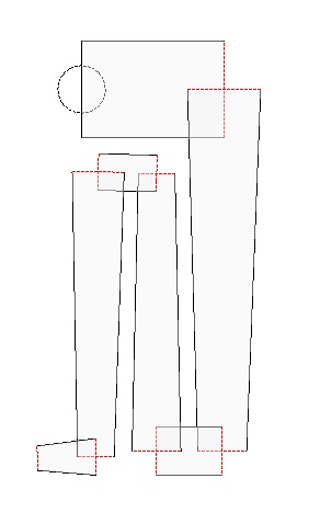

So does This image (in mirror)
Will be sort of the same as my attachment. (only to see if i have the correct perspective ) and this is also how you can create the corners i presume.
one thing dit i moddel the part where the driver is correct like this ? at the beginneing of the Line .
one funny thing is also calculated the volume in liters but what about the corners ? even if i slam in some corner to direct the sound , theres gone be a bigger volume with all those turns ?

I don't know enough about transmission line modeling to know how much the corners matter. I just know how the controls work. All of my modeling has been with bass reflex designs, and I haven't yet done the empirical tests to see how well those predictions match reality.
WrineX,
The corners don't matter as they do in a horn as we're not trying to preserve a coherent waveform through the length of the pipe. You could actually model your cabinet as a simple straight TL and then just fold it during construction, measuring the length down the center of the pipe. Empirical tests have shown this method works well.

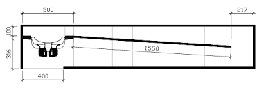

Just a quick guide on how you model Tapped Horns.
We are going to create a tapped horn which is similar to the design below:
images
The image below shows the steps to create a simple Tapped Horn.
Start a New Project and open the Geometry Display window.
The default project is a tapered transmission line.
Click on the element and press R. This reverses the element and you now have a horn...
We want to offset the driver. So select the element and press S to split it. Drag the split to around 0.3m.
Select the 1st small element and copy it (Ctrl + C). Then delete it (Del).
Then right click on the remaining element and right click then Paste -> As Branch.
Then select the element you have just pasted and reverse it (R). Spin it round so it looks right.
You now have a horn with an offset driver.
Select the long element and press S to split it again. Drag this split to around 1.7m.
This split point is where we are going to create the 'Tap'.
Right click on the element and select "Create 'Tapped Horn'".
This will copy the enclosure to the front side of the driver with the driver at the point we selected. The two enclosures are linked so making any changes to the enclosure will be made to both 'sides'.
This isn't a great design but hopefully it shows you how a tapped horn can be modelled.
