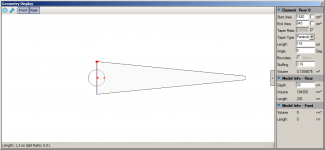

Sometimes, when clicking on an element to select it, instead the drawing jumps back to the original size and position.
The 'drag the split' doesn't seem to work, at least after there's another element attached - it jumps to one position and won't move from there.

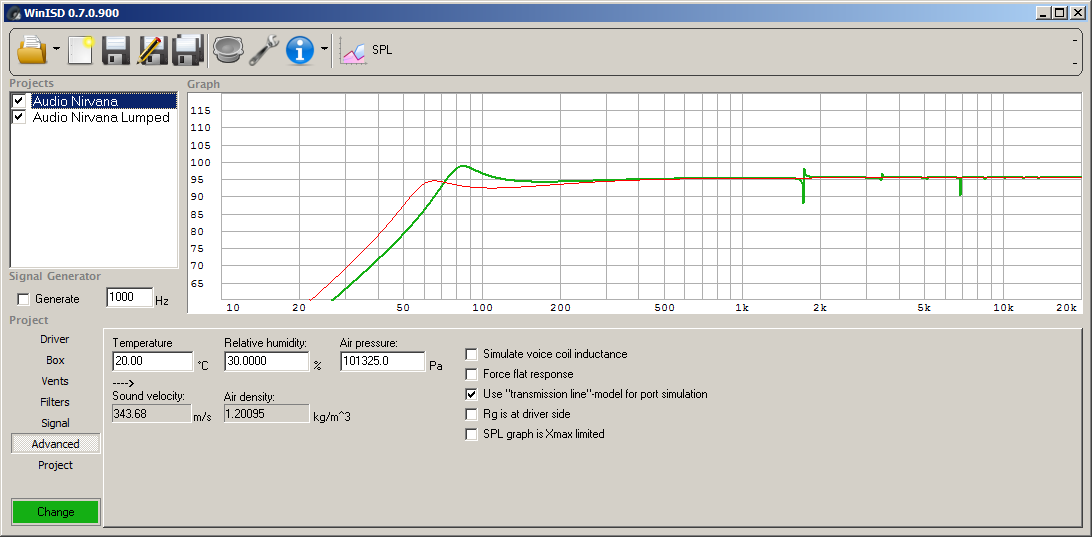

WinISD version 0.7.0.900 has a 'Use "transmission line"-model for port simulation" checkbox on its "Advanced" control page. Checking that box shows the effect of resonances within the port tube in the transfer function, and also, as noted, tends to predict different behavior in the bass extension region. That version was never formally released but a link was posted on Linearteam's (now-defunct, spammed out of existence) forum.

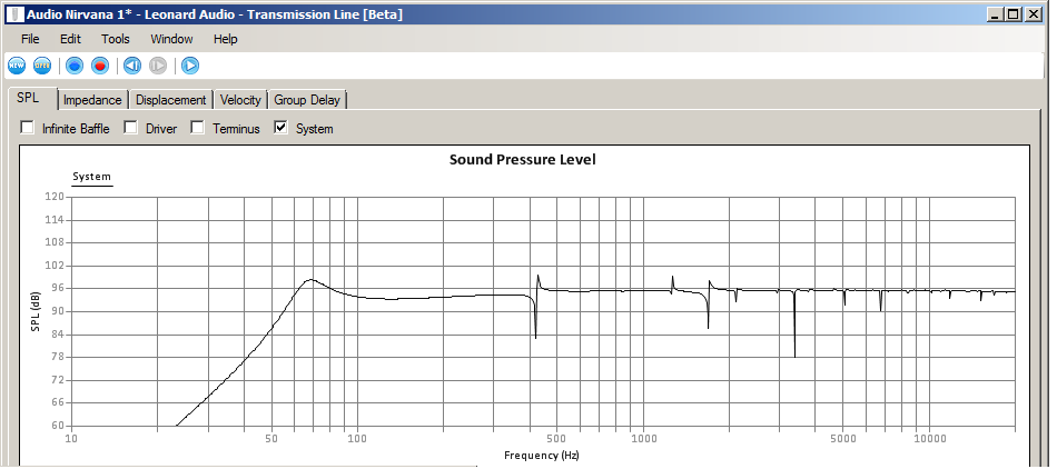

The attachments shows the WinISD and TL models of the same box, driver, and port. It's an Audio Nirvana 8" driver in a 38 liter unstuffed box, 10 cm diameter round (78.5 cm2 area) x 10 cm long (60 Hz) port. The TL model is "boxy", with 929 cm2 area and 41 cm total length.
The green WinISD trace is with the transmission line port model, showing the port resonances starting at 1700 Hz. The red trace is the lumped model.
Adding short sections of heavy stuffing at the box ends on the TL model brings down the port peak so the low-frequency part of the graph matches the red (lumped) WinISD graph quite closely, and also tames the box resonances.
The drag split seems to work well on mine. For example:
A sealed enclosure with two elements:
Then split the first element in two. Note that the split line is a different colour (This shows that you can drag it)
Add a port:
You can then drag this split, and thus the port, along the length of the two elements:
I have the same "jumps to a new position problem", even with no other elements attached. It reproduces easily, in the simplest possible case:
a) Open TL afresh
b) Select the initial element
c) Type S to split it (or use right-mouse, it doesn't matter which)
d) Click-and-drag the mouse on the split line, away from the square handle
At the instant you start to move the mouse after down-clicking on the split line, the split line jumps to the far left, showing "Split ratio 0.01" in the status bar at the bottom of the window. Subsequently, the split position cannot be moved from there; if you attempt to drag it, it just stays in the same position.
This misbehavior is very robust for me, to the extent that I have seen many failures but no successes. I have also tried the two-element-plus-port geometry shown in your report, and it fails in the same way.
