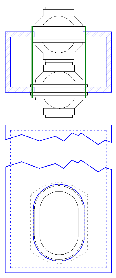

We used to use a pair of single B139 TLs with acoustats... they work fine. With 4 per side you will have a BIG box, but it should sound awesome.
Lengthening the line will not give you more bass, it will actually produce less bass.
Scottmoose & i worked up an optimum TL for the B139 using MJK for all those still fortunate enuff to have some around. I have CADed up lines for single and double woofer lines, i could do 1 for 4 or you could build 2 double lines. The other possibility if this is too big would be to use 4 per side in a push-push, push-pull TL. With the flat face and skeletal basket the B139 would be ideal for this. That would allow you to put 4 in the same size box as 1, and get the swept volume of a pair with a maximum amount of isolation from time smear back thru rhe cone as well as a reduction in 2nd order distortion (given it is an older woofer this might well be the biggest bonus)
Here is a straight version... it could be folded into a rectangular box.
http://www.t-linespeakers.org/projects/vProjects.html
dave

As far as using the KEF's, I think that I understand that
each time drivers are double up, it lowers the bass extension
by 1/2 octave? If that being the case I would probably want
to have all 4 drivers in contact with air rather than cones
facing each other, right? But I could still have a pair mounted
with magnet side facing out to get the distortion cancellation?

This leaves us with the KEFs as the 'best' choice. While Dave's right about extra drivers not lowering the cab alignment, it does allow us to take that extra efficiency and extend the BW with it, so four drivers in a dual bipole layout looks good at a glance tuned to ~17.7 Hz/~16 ft long TL, but it's going to be around 780+ L. or dual ~390 L bipole TLs if this is too big for whatever reason, and of course isobaric will cut these sizes to only ~195+/97.5+ L with power requirements accordingly and EQ will be required to flatten it in-room.
