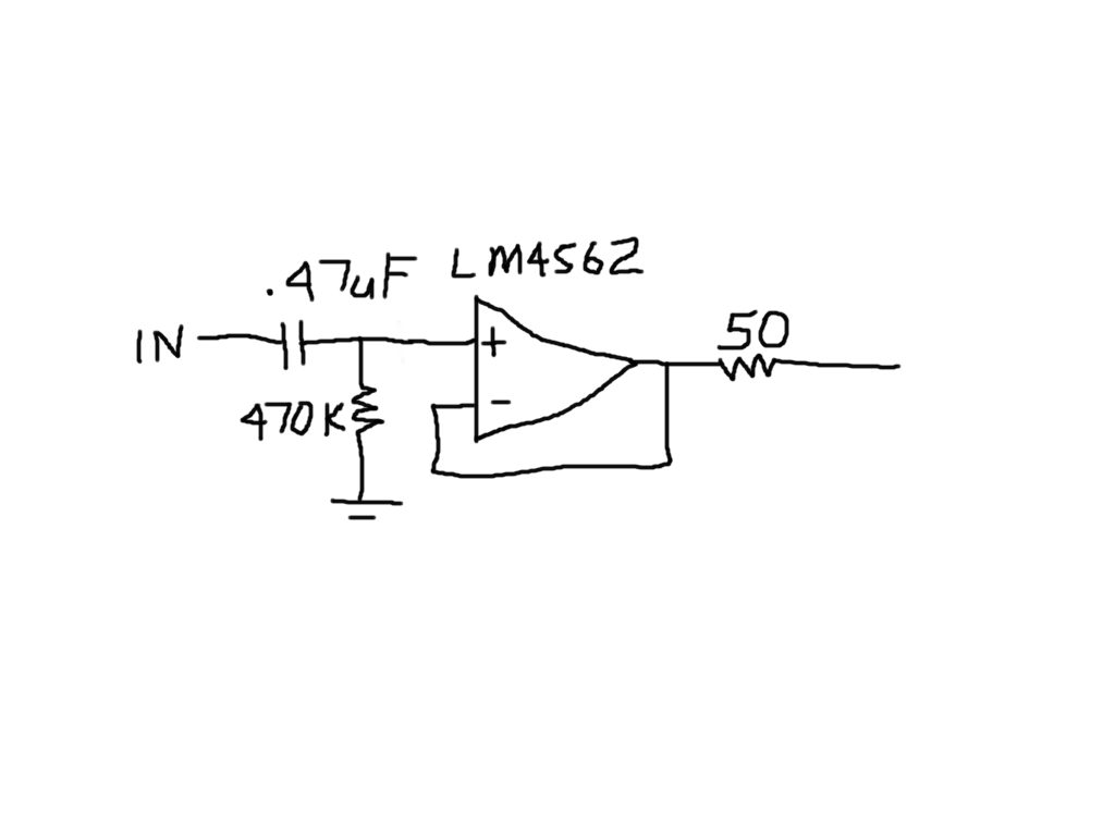

Also, when using the LM4562 as a buffer, is it better to use a 100 ohm resistor, from the output back to the inverted input, or just connect the two with a piece of wire?
I'm also using 100 ohm resistors in series with the inputs and a 49.9 ohm resistors in series with the outputs...Good idea, or not?

Actually, the transistors you have (the 2N5550 and 2N5401) give pretty much identical results. If you increase the 10 ohms back to 22 ohm then the current is reduced slightly and well within limits for these devices. And remember this is all worst case into 600 ohm loading. Into the more typical 10 to 20k of a power amp things are better still. Try it with what you have first and see if you like it.
The 4562 is fine connected directly with no resistor. A series output resistor is often a good idea with opamps because the cable capacitance and input capacitance of the power amp is an unknown and can provoke really high frequency oscillation under some conditions. I would use a 0.47uf poly cap as an input coupler and a 470k from the opamp non-inverting input to ground to define the bias and DC conditions. There is no penalty with the high value because its shunted by whatever the source impedance is feeding it.
