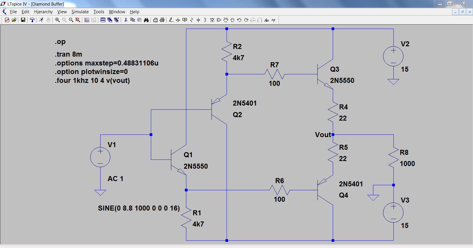

Adding some DC resistance to the input voltage source might be advisable. As it stands the base of the input transistors are defined as 0.00 volts DC and that won't happen in practice.

What is surprising in the simulation is just how much those added 47 ohms increase the distortion raising the figure to 0.12%

Yes, the voltage is approx. 16 volts peak to peak or 8 volts peak. That becomes slightly less than 6 volts rms (vpk/1.414). I set the input voltage to be 6 volts rms (8.5 volts peak) but the loading on the output pulls the level down. That shows the design has relatively poor drive ability. A good opamp would maintain the level with absolutely no change as it was loaded.

In the simulation the input voltage has "perfect" characteristics such as zero impedance, and at DC, it holds the base of the transistors to zero volts (ground) as if they were connected to ground via a piece of wire.
In practice (a real amp) you would probably AC couple the input and connect the bases to ground via say 10k to define the input impedance and DC conditions. That changes the performance slightly.

Based on the simulation, yes. One thing I did notice was that the design is very dependant on the transistors used. I suspect that would translate to reality too. The currents in the first transistor were particularly variable with different devices, all other things being equal.

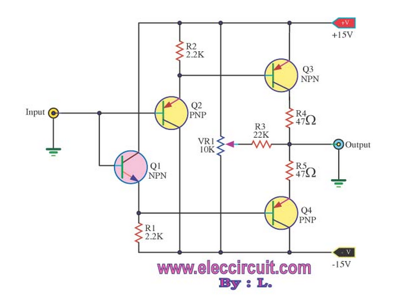

Shifting gears here a little...would the following buffer circuit from the Lehmann headphone amplifier have considerable more output current and drive, since it uses larger output transistors, vs. my initial circuit using TO-92 devices on the output?
You stated that my original circuit's output was being pulled down on your simulations, so I'm looking for a discrete BJT buffer that will maintain its output voltage better.
Oddly, this circuit also has 47 ohm resistors in series with the emitter of the BC devices.

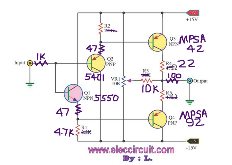

the reason I suggested the 47R resistors at Q1/2s emitters in first place was that they were of convenient value and were there already.
From the choice of Q1/2s bias current and the emitter resistors the 22R output resistors values quite fell in place.
Of course could one choose all four emitter resistors lower in value, but that increases tolerance sensitivity of the circuit.
Also function the output emitter resistors as protective measurement against accidental short circuits, if either the ouput is shorted or one transistor fails, and it shields the output from capacicitive loading.
If the resistors are chosen small one would need one more resistor of 47R-470R in series with the output.
Still though if one output transistor fails it's shortcut could result in a breakdown of the second transistor too due to overpowering.

Here is your latest "Lehmann" circuit. Much better than the previous ones. I've marked the currents and voltages on the diagram and AC coupled the input. This hold up much better into 600 ohm loading. No simple buffer will give no change as loads are added because there is no global feedback to sense the amplitude error.

Actually, the transistors you have (the 2N5550 and 2N5401) give pretty much identical results. If you increase the 10 ohms back to 22 ohm then the current is reduced slightly and well within limits for these devices. And remember this is all worst case into 600 ohm loading. Into the more typical 10 to 20k of a power amp things are better still. Try it with what you have first and see if you like it.
