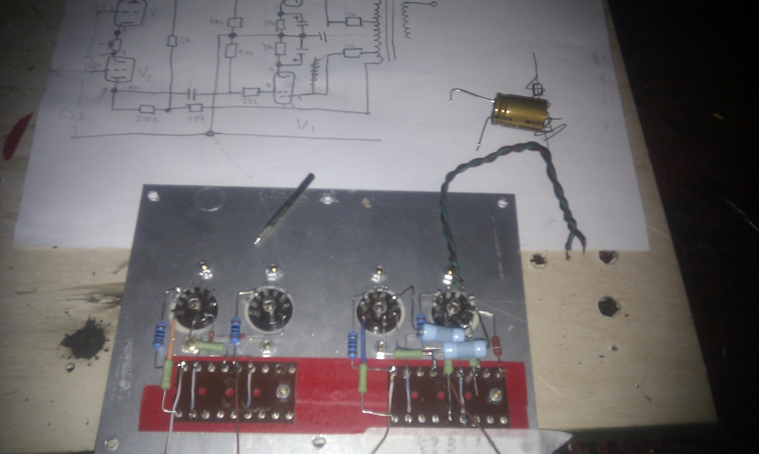

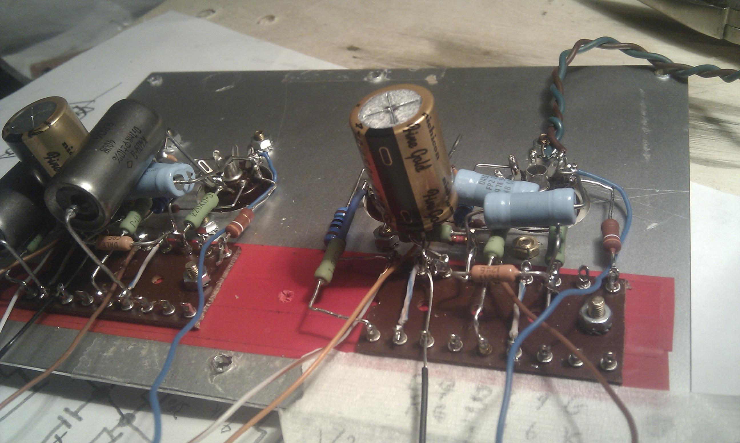

I know have a 180R 10W as my first resistor in PSU. I have taken your advice and moved this to its own place i.e. not soldered directly to first cap or second cap. Then I have made a new tag board which sits two 390R resistors. The B+ splits into this and both resitors have a 47uf cap to ground for a final bit of smoothing.
The 180R still gets red hot...
However, I think I've realised my mistake, I just don't want to admit it yet, I need to make a new aluminium plate for my valves as you can only squeeze half a valve between the pairs for each channel.... they are too close and this is causing unacceptable heat after an hour of running....
this means cutting all new holes for the valve sockets and moving all my components underneath.... not sure if I can continue but I will!

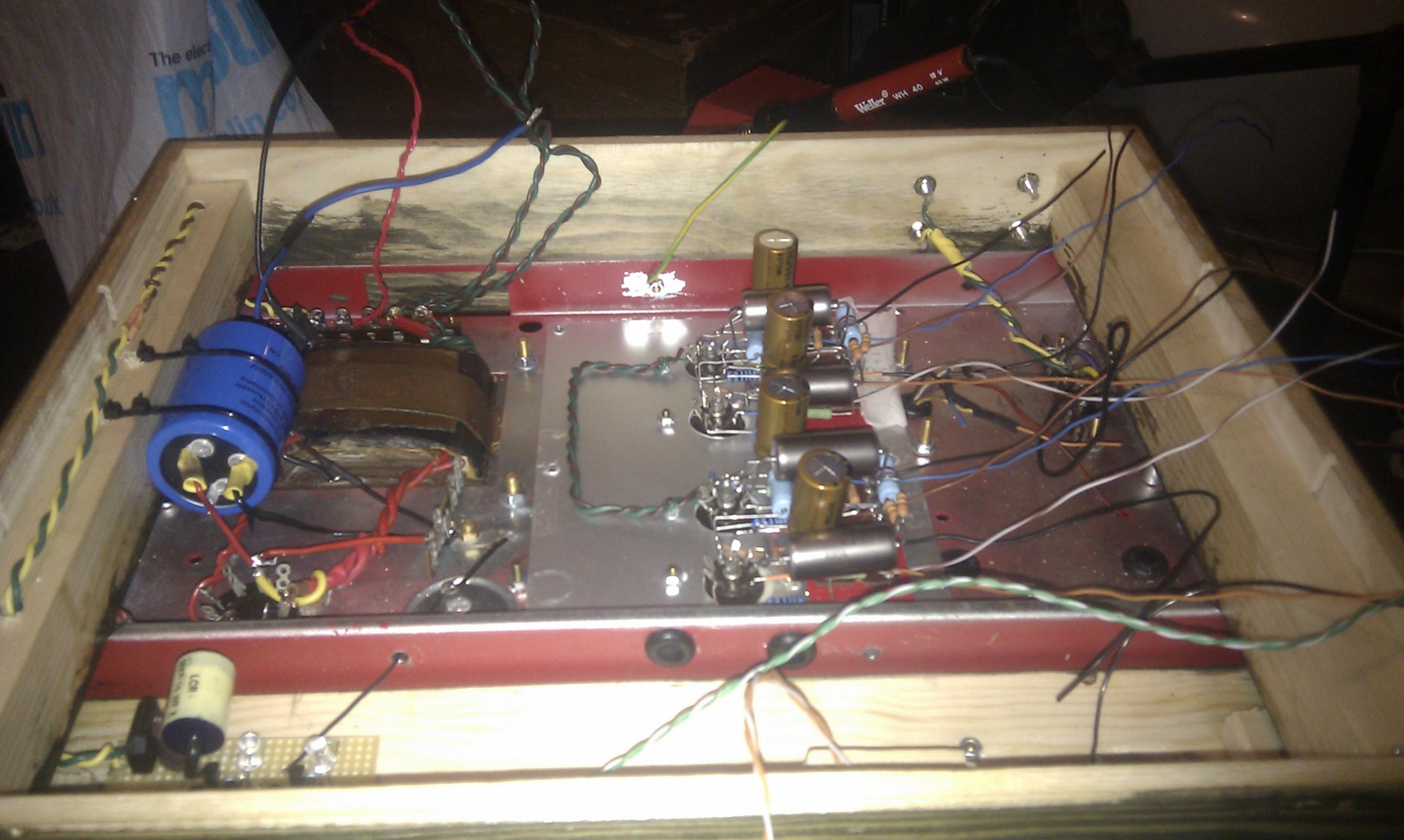

OK, my 180R is passing approx 110mA of current (V=IR) = approx 20V drop
If I use two 100R's in series then each should drop approx 11V
Power being dissipated through each 100R = 11 * .110 = 1.21W....
Power dissipated through using single 180R = 20 * .110 = 2.2W
then why is my 180R too hot to touch after 20mins of operation?
S

Something is wrong check your figures..:confused:....is your measured voltage drop correct under load? (sag)
See how hot it is without playing music just sitting there!
PS you should not be touching a B+ resistor with your fingers<<<if the insulation fails you will get a shock..2watt can seem quite warm..but not melting solder etc..

If your figures are correct..
If you are sure..then its 2Watt..and you need to work on the venting etc..Then again this is now about how hot the power Tx runs..and chassis..
So how hot is the power Tx? and chassis..What plans do you have to get efficient venting?

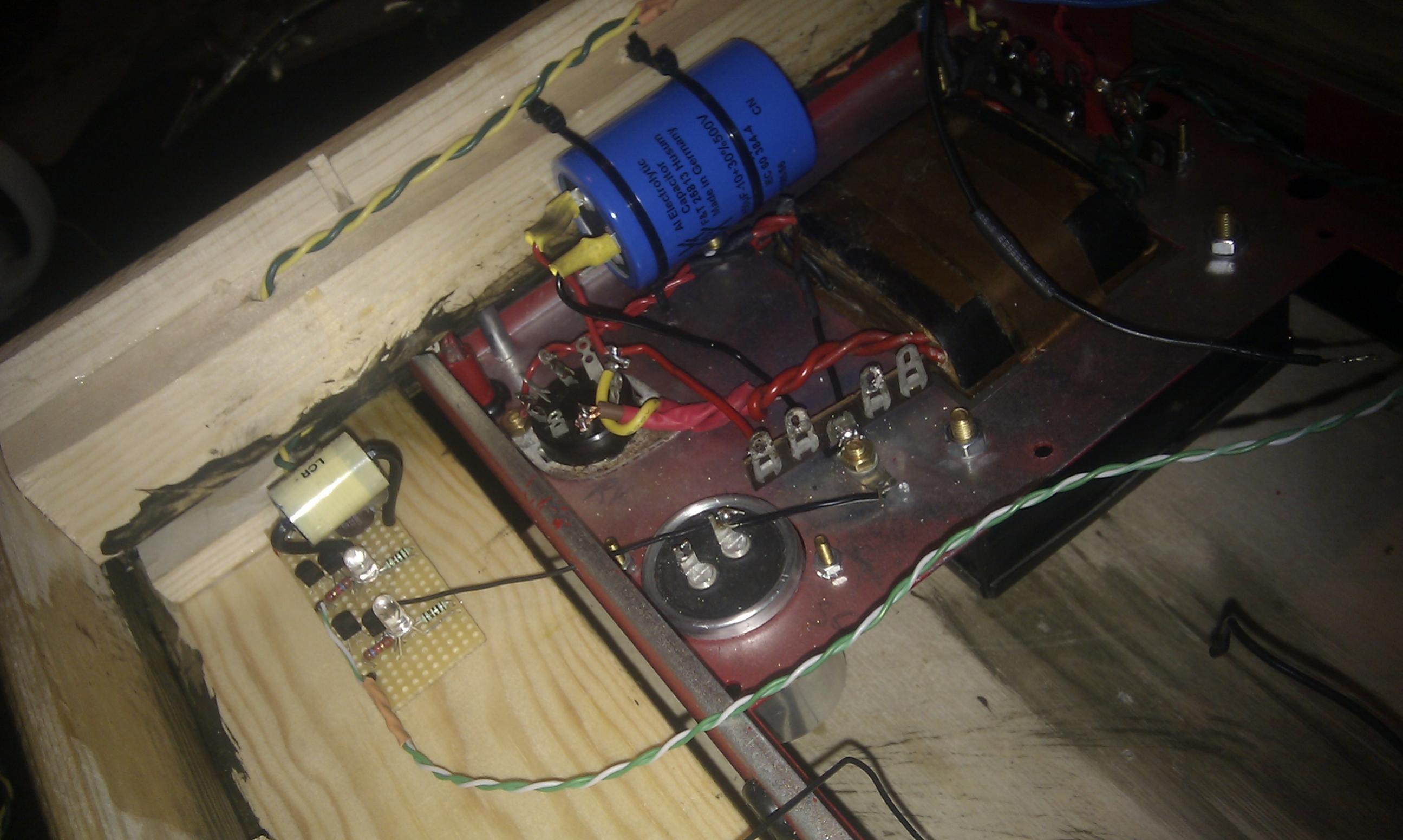

Thanks for the concern, just to let you know that my B+ is bleeding to approx 5 volts in 10 - 15 seconds and then it dwindles down slowly. I am making sure it is almost all gone before I'm touching the resistors to see how hot they are!
Had to replace a small fixed pot that I use to bias the ccs to the diff amps. Was probing around and shorted cathode of triode to pentode screen!!
Back up and running, even dug out my old gigaworks dac that i built with UTC A20 transformers to listen to tonight. Had Amp upside down which was a bit unfair to test seeing as valves are stuffed towards the ground. Ran the amp for a few hours and the transformer was 'almost' too hot to touch for more than 10 seconds but not quite. Am looking forward to digging out my 12b4 linestage that I also built... (bet your wandering how I managed to build all that stuff - so am I!!)
Anyways, back on track.... ventilation... will take your suggestions on board and go about working out how I may use the thermal rising affect to my benefit.

Yes, ventilation. Just while we're on the subject, this very amp belted me after I had been away for two weeks. Yes, it had no bleeds in... but I must have thought "whats the worst that could happen?" two weeks!! so now I know! Luckily, it avoided my chest and must have exited down my side.
Here is my plan: turn the amp the right way up and run it again tonight, I am going to try and get a better idea of how hot it gets and how quickly. The amp has no bottom panel at the moment and big rubber feet so I assume plenty of air can be drawn up from underneath at this stage.

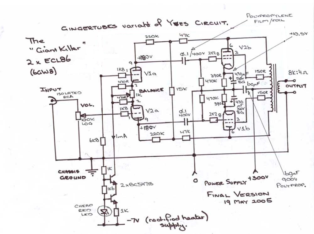

I will also be adding a global negative feedback from the 15ohm OPT tap to the diff amp... I am told this will lower the gain, so my logic tells me that this could further reduce heat?

Any oscillation is likely to affect power draw (and hence heat), often in a downwards direction. It could be NFB loop oscillation or parasitic oscillation in one stage. I only mention that as an exception to the usual rule that gain/feedback etc. do not affect heat as heat is set by quiescent currents and voltages (which are not affected by feedback). If an amp is too hot then it either needs more cooling or smaller currents.
