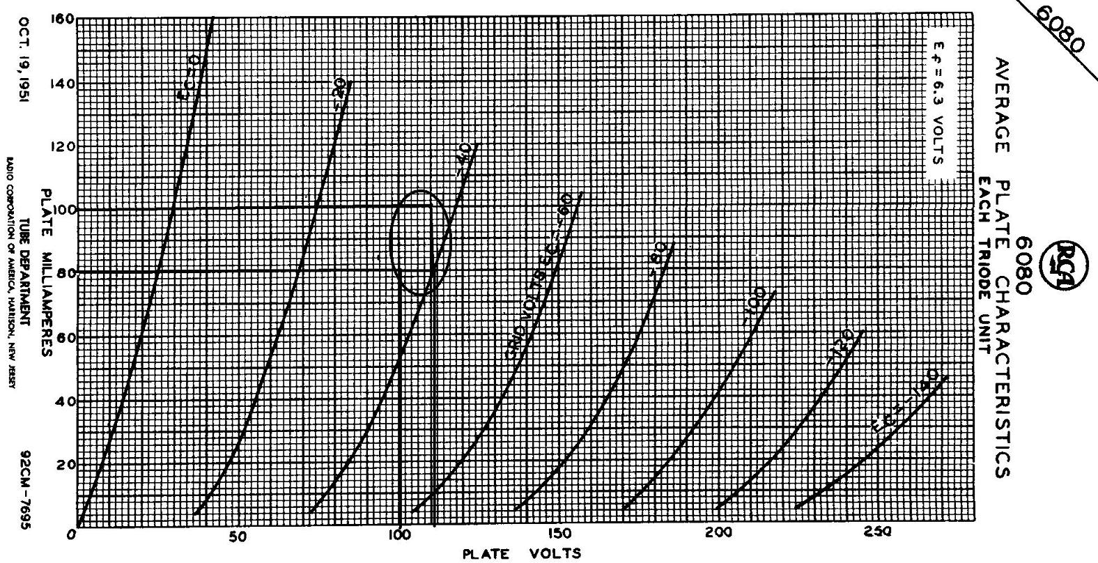

Using a fixed bias to drive the grids on a 6080 am I looking at a 30-40 negative voltage requirement on each rail if the plate voltage is around 100-120 volts?
I have 6080 cathode resistors of 3.9R. I should be getting about 0.35 volts across them to achieve about 90 mA right after adjusting the negative grid bias with the fixed bias on the CF drivers?
Success.
At exactly -40 grid voltage at 101 volts on the floating supplies, 3.9R on the cathodes I measured just 35mV DC on the outputs.
(just 1 channel to test with 2 x 6080)
Should I be getting this figure lower??
Does my LTP need to be more balanced? I'm using a SV83 as a CCS as the tail.
Maybe a SS CCS will balance them a bit more?
I know on my SS amp I have about 12-15mV.
