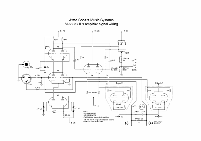

Many years ago (17?) a friend of mine, George Tice, purchased a pair of Atma-Sphere MA-1 50 watt monoblocks. Yes, the same George Tice of Power Block fame. I knew him as a mutual member of the New Jersey Audio Society.
These amplifiers were early versions of the model and were entirely hand wired without PCBs like current production. Wanting a schematic of his amps, he asked the manufacture for one but Karsten refused claiming he didn't even have one for himself!
Being resourceful, George came up with a copy of the patent. (#4,719,431) Still not satisfied, he brought his amps to my shop where I reversed engineered them and drew up a schematic.
For those interested, a 6DJ8 LTP cascodes into a 12AU7 that's capacitor coupled to a differential 6CG7 cathode follower. This follower directly drives the 12 6AS7G output grids. (6 per side) The output stage is powered from two floating 150V/750mA supplies and is configured as a Circlotron® There is no overall NFB. Only un-bypassed cathode degeneration in the first stage.
Curiously, Atma-Sphere was not manufacturing what was patented. The above numbered patent clearly depicts and describes an anode follower output stage. This amp, and I assume others, is a cathode follower output.
After making sure the DC balance and bias settings were correct, I made some harmonic distortion measurments. At rated output the THD was a little over 12%. This improved as the power level went down but never went below about 1%. George loved them and couldn't hear any distortion. Some time later I did visit him on Long Island and listened to them on his system. They were very dynamic and powerful, but I did feel I heard some distortion. This may have been because I knew it was there.

HollowState said:Many years ago (17?) a friend of mine, George Tice, purchased a pair of Atma-Sphere MA-1 50 watt monoblocks.

Many times I've read about this T8 and M60, but too tired of interneting to get those schematics so that I could start building this two amps. It's getting late and older and I must hear those awesome sounds. is there any one out there who cares to provide me at least the M60 schematic?
