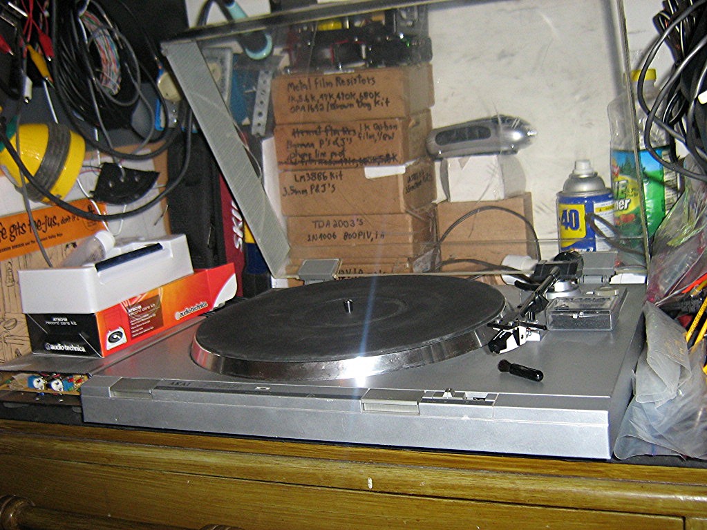

Close & Way Heavy
The Akai was pretty close to what the markings on the counterweight show. The Deccollaro, on the other hand, was, as I expected after rigging an Electro-Voice model 26 cartridge in its arm, far too heavy. The Deccollaro came in, after adjustment, at about 5.2 grams. That record player, with its .7mil diamond needle, is pretty easy on the records, and plays 78's and other records that are too rough for the Akai.

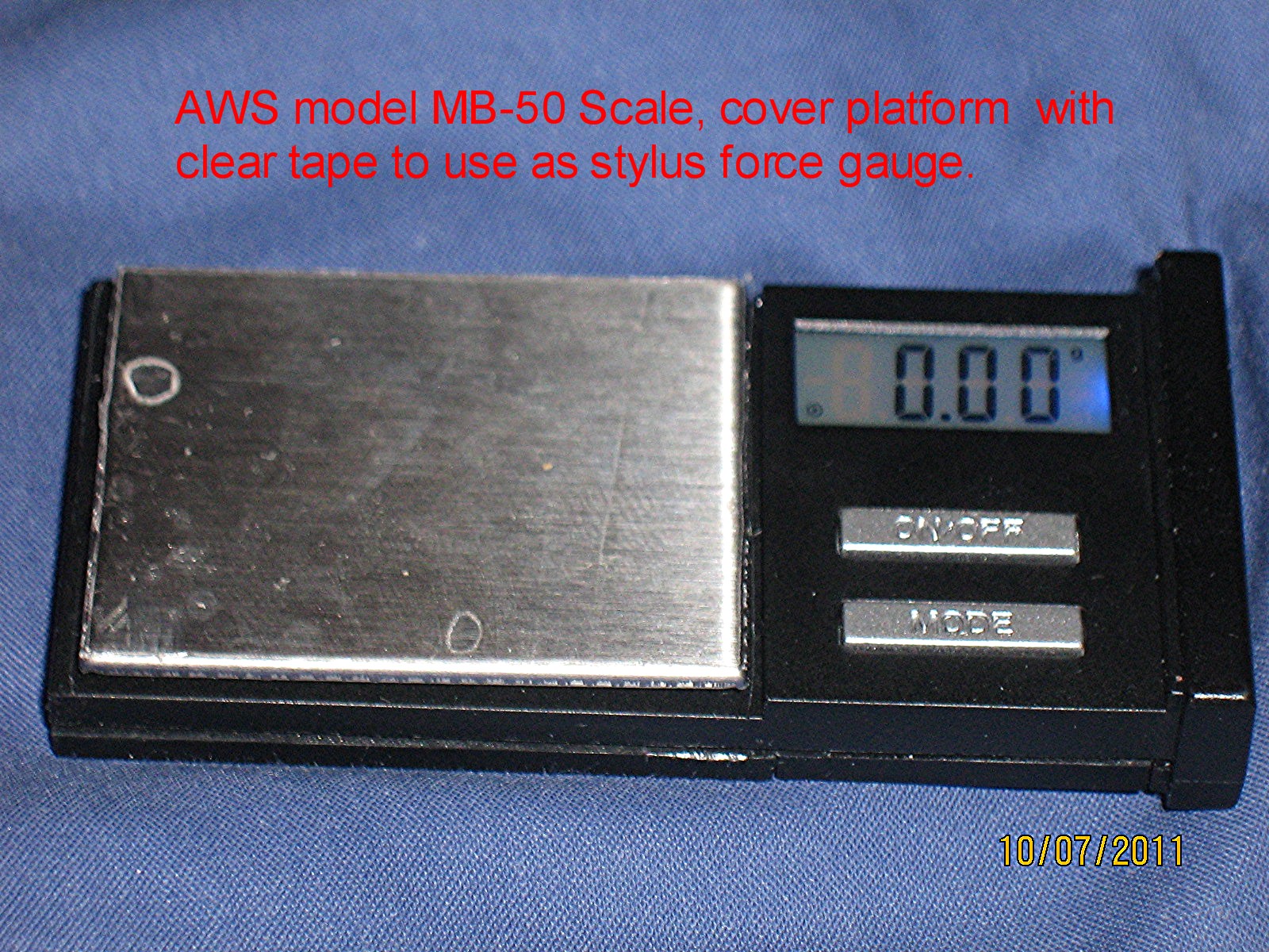

Hi Guys, I finally got one of these tiny digital gram-scales and covered the platform with clear packing tape to make a killer tracking force scale for just USD 13.

Very nice idea!
Thanks for the kind words, Sir. What intrigued me most about using this model scale is that it's only 1.7" wide and especially well suited for my purpose. It even has a tare function that "zero's out" the few hundreths of a gram that the tape weighs.
Very nice idea!
Nice!
Nice!!! I'll see if they'll start a sales commission account to pay me from. $$$$
It's on my shopping list for this afternoon.

Even better:
Digital Precision Scale with Leather Case (5g Max / 0.01g Resolution) - Free Shipping - DealExtreme
(watch out for some of the other scales that have iron-base, unusable with MC-pickups(unless you stack a 1/2" plastic-something ontop...))
Arne K
(sorry for ruining your business-opportunity...)

No Problem
No problem. I don't think they'd pay me any way.. Mine, with its 50 gram limit, suits my purposes because the precision scale's 5 gram limit wouldn't have let me do my ceramic cartridge.

50 gram scale...
I bought one a few years ago. 50 grams, .01 gram accuracy. It can do carats, etc so jeweler's "precision". Biggest hassle is devising a way to read the weight when at record level. One thing of note: if a calibration weight is not included get one. These scales need to be periodically calibrated to ensure accurate readings. I use water measured in a 10 cc hypodermic needle (less the needle). Good enough for my insulin, good enough to precisely measure water.
The 5 gram scales look very much like some VTF gauges sold by some of the record retailers.
