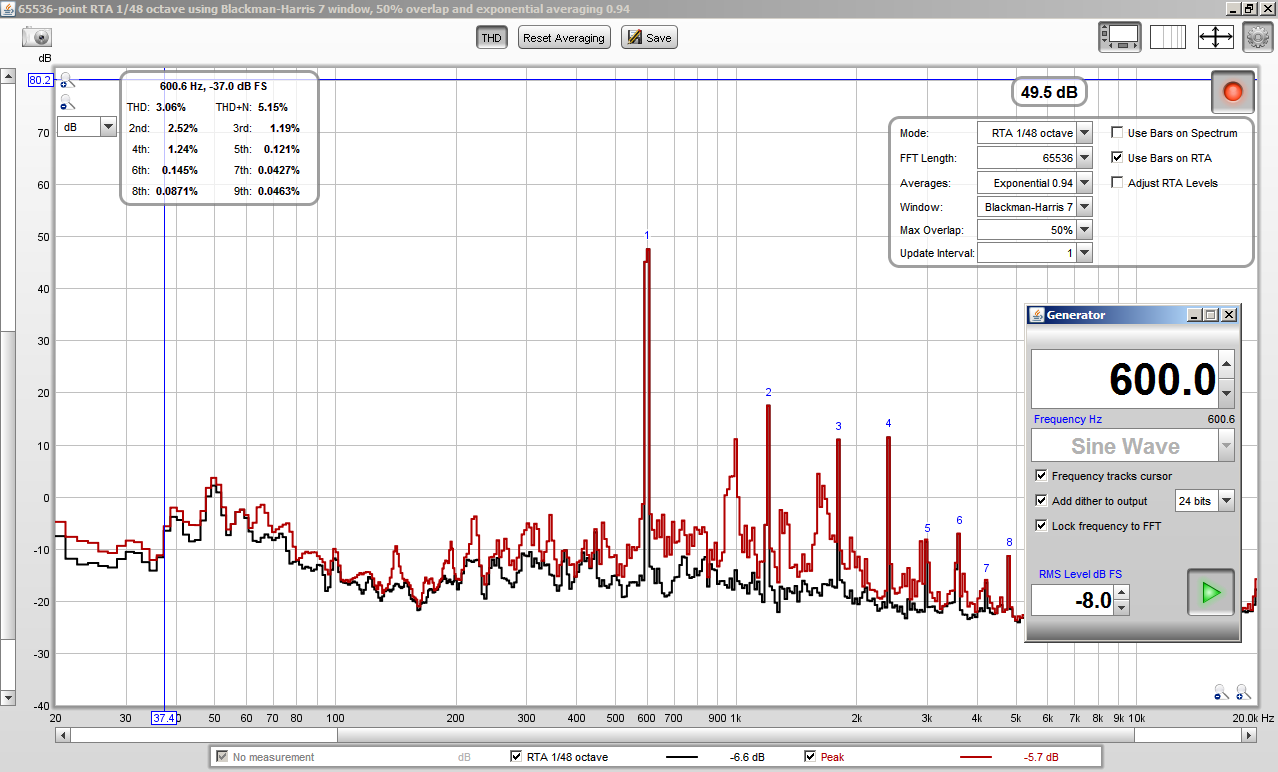

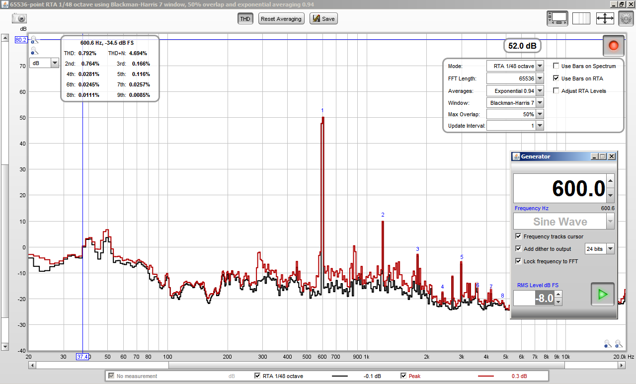

I've epoxied a nut back in and tightened up the fourth bolt. definitely an improvement. Can't find the blu tac so that will have to wait.
Mic position is a bit different, I hadn't realized my mic was flapping around for the previous tests (basically sitting on the sofa rather than sticking straight up in front of it...
Still to test with the crossover again, I had one measurement where it was showing 2nd harmonic nearly as high as the fundamental Living room has been invaded by Mother in law and Wife as the iphone needed charging and the charger happened to be plugged in in here, so can't blast out any more 600Hz tones for now

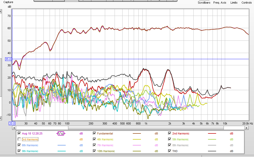

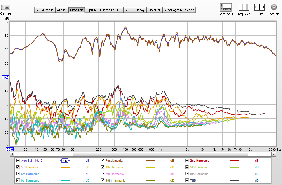

first pic is the damaged one after tightening. 2nd pic the other one for comparison. 3rd pic I went WTF. it is the left unit with crossover. I think I was clipping the preamp input.

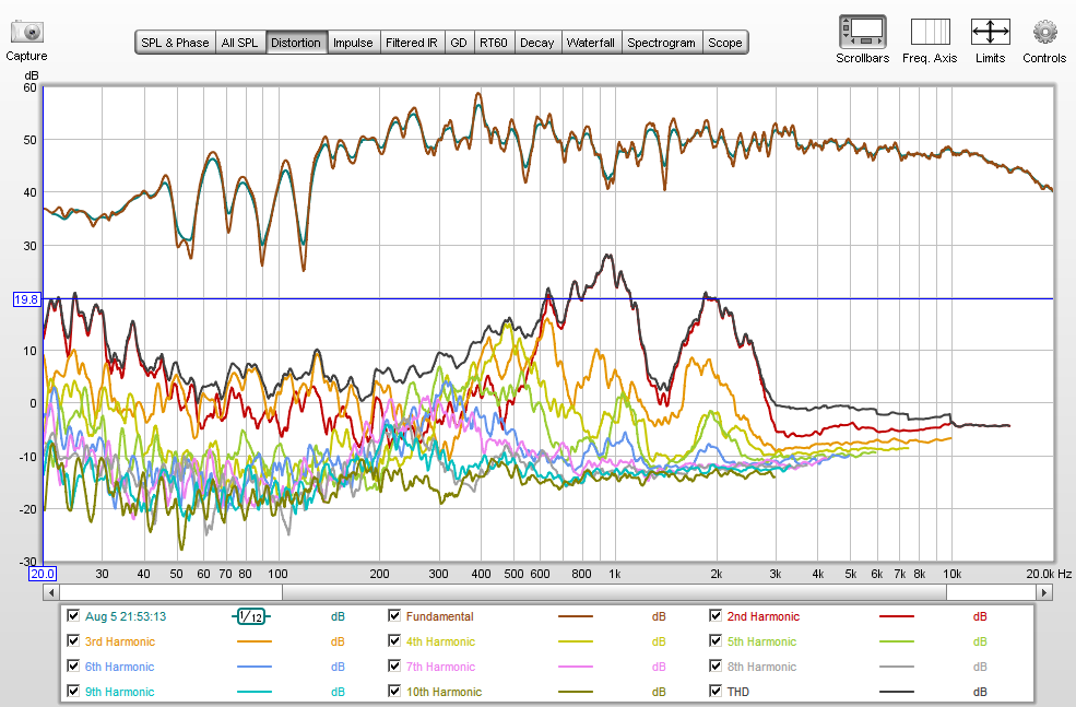

I may have just shifted the problem Sweep of the left and right speakers in room. quite a difference between the two. I guess I really need to do it outside with both speakers tested in the same position, but it seems my 600 Hz narrow spike has been replaced by two higher and broader ones... and all I've done is tighten up a screw...

Look at how the second harmonic is defining the issue. That's mechanically, suspension/cone related irregularity. Third also but far less so, looks like he's being taken for a ride.

Below is a suggestion Mike made via PM before this thread was started, based solely on the original distortion plot.
Mike they are the much maligned Morel MW144's usually criticized for their horrible distortion and terrible motor design Does the second plot of the undamaged speaker indicate this? It looks ok to me, certainly not vanishingly low distortion but seems ok. edit: the tweeters are morel DMS37's
Note that the spl levels in these plots should be considered relative only. I did not check voltages at the speaker or the distance to the mic, though I'd estimate the distance to mic is probably around 3M. It was pretty loud, way louder than I could have endured without hearing protection on.
To many variables to work out actual level, but I'd say I was pushing a lot more than 1W!! probably more like 20!! I guess if I don't change the settings on the focusrite I could at least work out what voltage I had at the speakers terminals.
Tony.

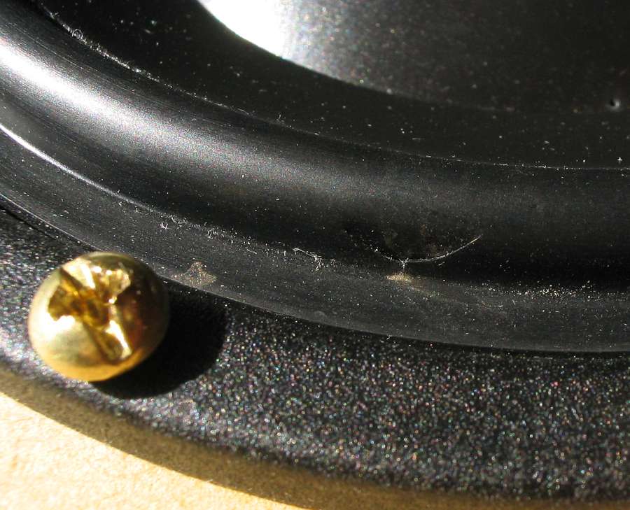

And indeed one screw was completely loose. Tightening has removed the 600Hz peak almost completely. Unfortunately my damage, or the uneven gluing of the surround (probably both) are still contributing a significant amount of distortion that is not there in the other channel.The ¼ wavelength is roughly equal to the diameter of the driver itself... are they secure to the baffle? One screw needing a little more Oomph might be the cause... still thinking

Tony, loosen all screws, reseat them like you would torque head bolts.
Ok you may not know how to build engines, chris cross tightening (1,3,2,4 or 1,4,2,5,3,6) a little at a time til snug. The unbalanced condition may also have warped the frame. This should help in that regard.

I was actually thinking about whether there was any way to undo my original repair. I didn't get a good clean fit when I did it. It looks somewhat irregular. I would need to be very careful with the acetone I think, but judicious application with a cotton bud should avoid too many accidents I would hope!

I'd say try something local with Limonene first. This will not damage and may help act like a mold release once penetrated, even if from the edge peeling it back little by little. Perhaps even through the surround. Then acetone applied as you've mentioned albeit cautiously.

I did another measurement today, outside of the problematic speaker. Then I decided to put a new neoprene washer on. When I started to tighten (only gently) one of the other bolts started to spin in it's well Now I'm having difficulty getting it back out again
anyway here is the first measurement. I'm going to need to do the epoxy trick on this one too. The original mounting of the nuts was less than durable
