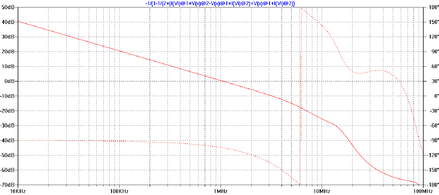

I only show 'Loop Gain' cos several people are pontificating about how this is the answer to Life, the Universe & Everything.
You seem to have missed the point.
There are several loops so there are several Loop Gains, or as a reader of Bode would prefer, Return Ratios.
The outer-most loop is all you have shown. This is not a reliable indicator to stability in a multi-loop amp.
This misconception caused interminable confused debate in the TMC/TPC thread before it was finally understood and a reasonable consensus reached.
Some of the rest of your post is also a result of this same misconception so I won't answer it point by point if I can avoid it.
Please don't start that debate again!
Read especially JCX's posts in the TPC/TMC debate and then Bode plot the other loops in your OIC and TMC amps.
In your amps the output transistors are about 20 times slower than the other transistors.
Yet you have the same loop ULGF about them in your OIC amp as the loop around just the IS in TMC.
That is not reasonable.
The outer-most loop is all you have shown. This is not a reliable indicator to stability in a multi-loop amp. This misconception caused interminable confused debate in the TMC/TPC thread before it was finally understood and a reasonable consensus reached. ... etc
Dave, you are correct.
But I have never said the outer loop response is a reliable indicator bla bla. In fact I say this and the other loop responses are probably the least useful to assess stability. Please read my sh*t a bit more carefully. :)
But the point I made was that if you really want a 'linear' measure of stability, just close the loop. If ANY of the inner loops peak or have nasty 'margins', this will appear in the closed loop response if they are important.[*]
Of course this will not give you any idea of non-linear 'parasitics' but none of the 'linear' stability measures do this either.
The old pedantic measures ARE useful if you are trying to improve stability though.
[*]One which doesn't appear cos its unimportant is the mid peak with TPC.

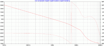

If I do understand David right, then he is concerned about the robustness of the circuit in reality. As you pointed out elsewhere, Spice simulation only gives us estimates about reality.
So, it is good practice to evaluate as many as possible savety margins, e.g. stability margins in all important loops or SOA margins, just as another example.
In circuits here in the forum, one often sees a quite sharp 'knee' in the global loop reponse, perhaps stemming from a stability issue in the (darlington) VAS. If you distinguish between important and unimportant problems, would this be an important one?
(Your global loop response for Miller compensation including OPS, post #4, does show such a knee at about 10MHz.)

You are right about these extra loops but IMHO & E, the Closed Loop response is an accurate linear indication of what's happening in ALL the inner loops too. The important variation is to look at it with various loads & some changes in devices.
BTW, I'm only doing in LTspice what I used to do in 'real life'.
In fact I design for just this behaviour.
Bode proposed his 'ideal behaviour' with a slope of 9dB/8ve and PM=45.
A good approximation to this which I've used successfully in my 'real life' past, is to have 12dB/8ve up to your 'unity gain' freq and 6dB/8ve above that. This is of course how TPC should be done.
I didn't do it properly on my TPC example :eek: Mea maxima culpa. But that's how I used to do TPC type compensation.
Alternatively, you can have 6dB/8ve up to unity gain and 12dB/8ve above and this is what's in my 'pure Cherry' example. (Better if this happens above unity gain cos better margins bla bla) Usually easier cos above those frequencies, there's loadsa evil poles. The tweaking cancels ju.uust those which may affect this nice behaviour on the worst possible loads.

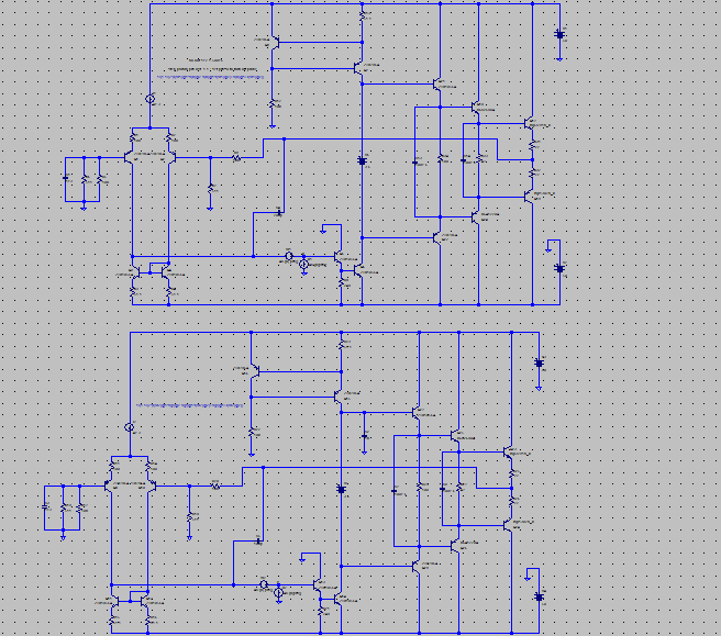

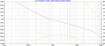

Damir, will you try my .ASC files and suggests values for better performance from the TPC & TMC version? I've tried to make it as easy as possible for people to do this. I don't care what 'margins' etc are .. just what stability the final amp has.
As I've said ad nauseum, my stability criteria isn't a 'linear' measure like Phase/Gain Margin/Nyquist .. but what happens on different loads on both Close Loop .ASC and .TRANS in SPICE world .. and the same in the 'real world'.
This is what the outside 'real world' sees.

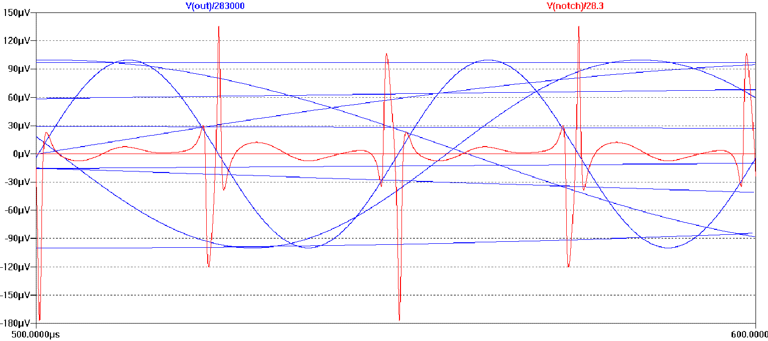

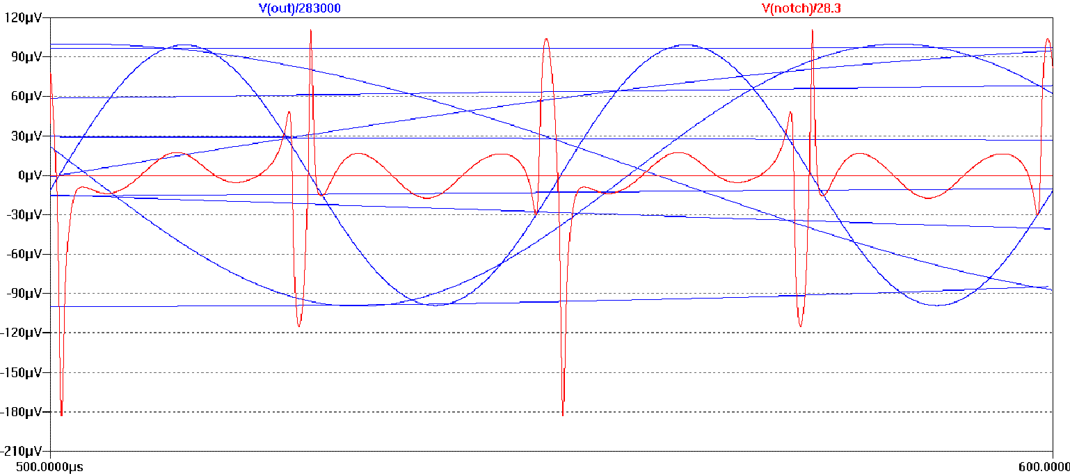

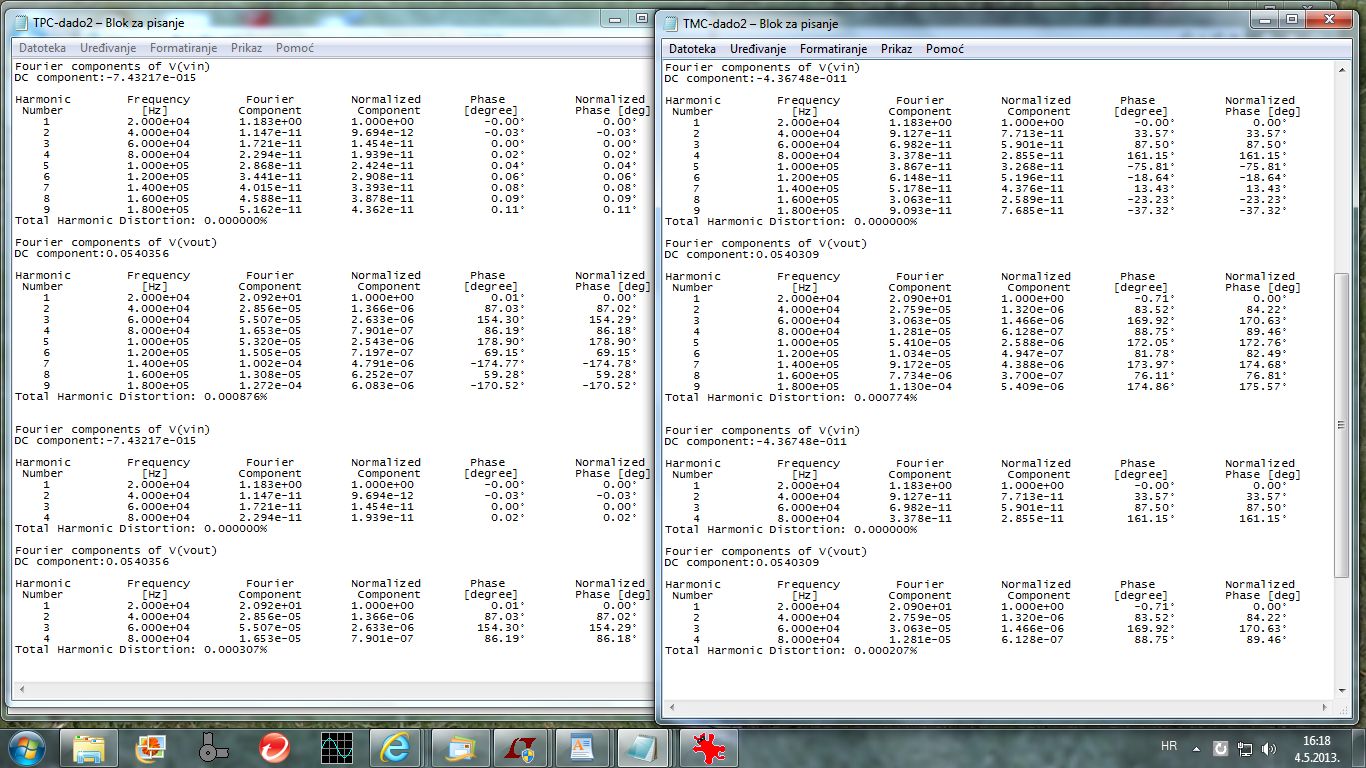

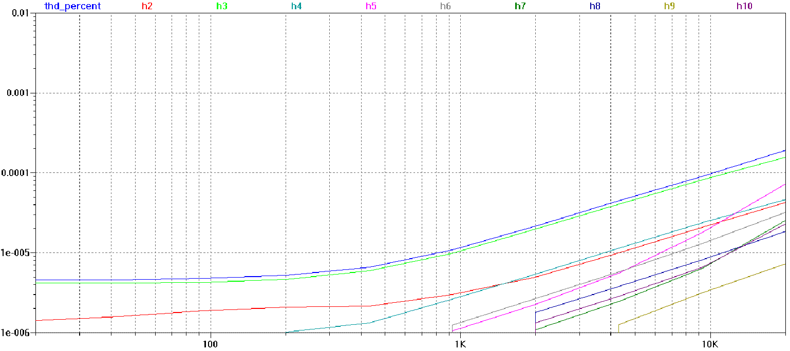

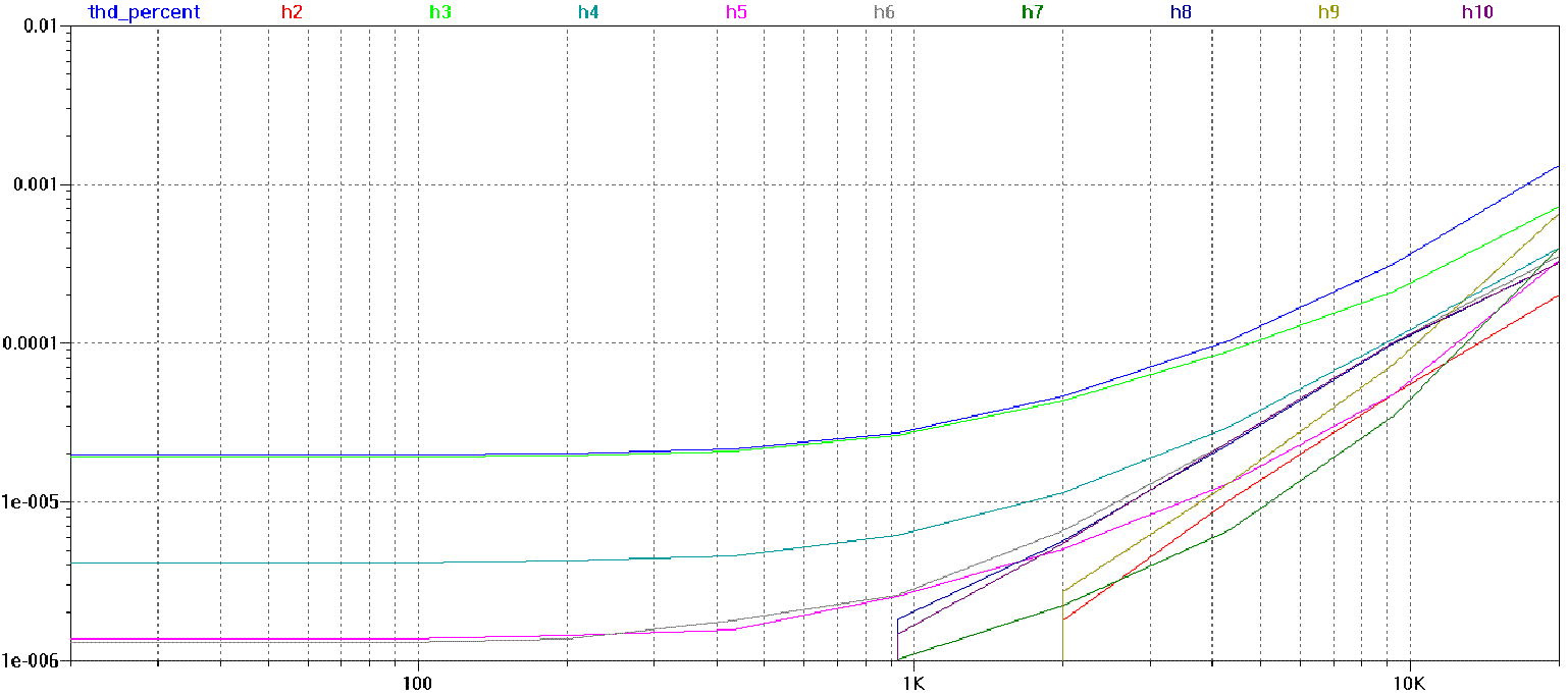

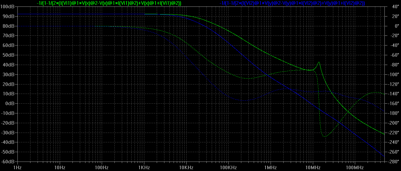

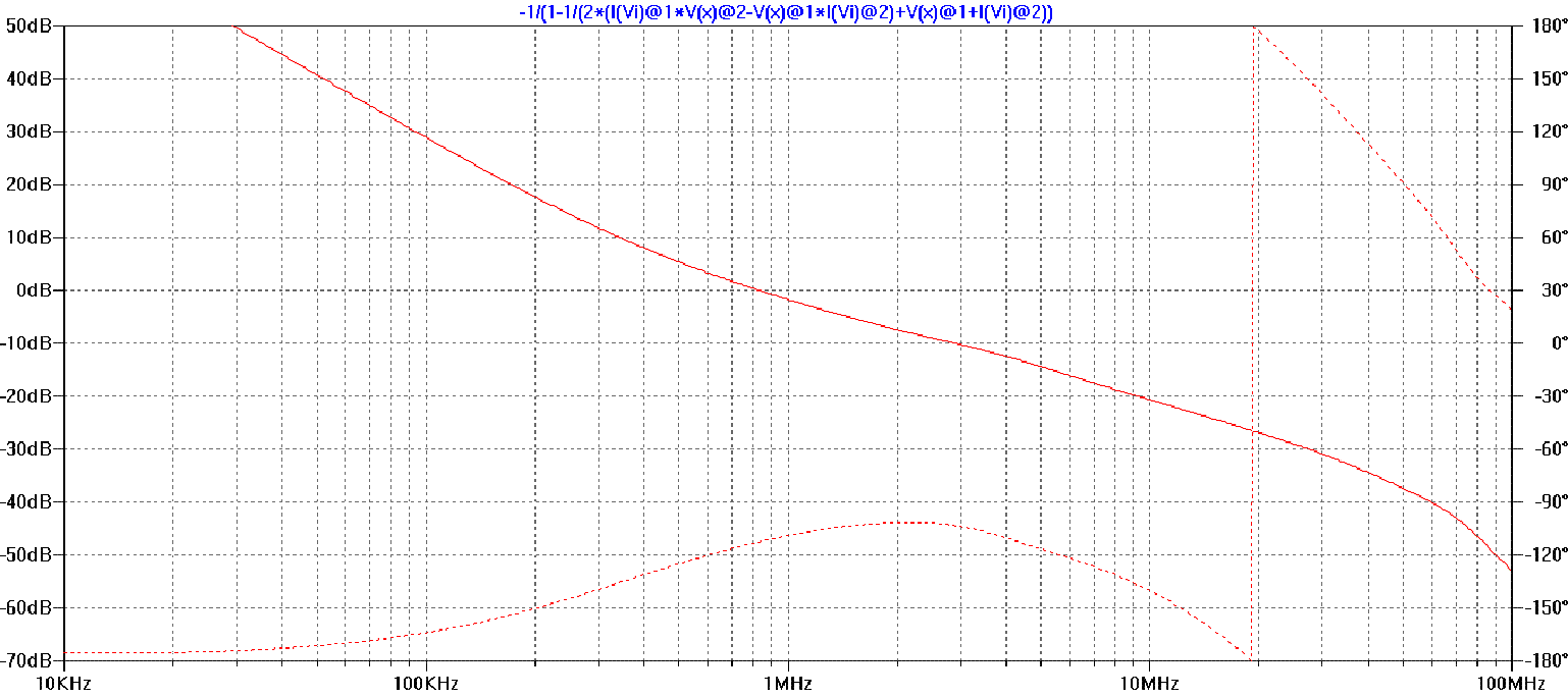

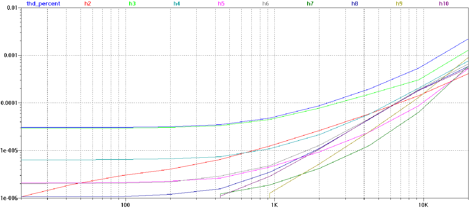

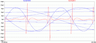

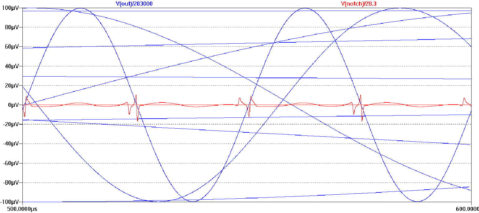

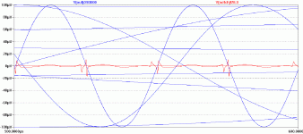

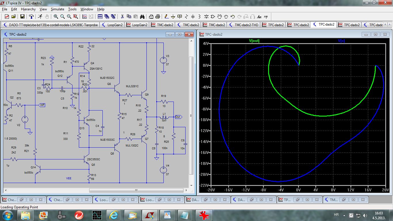

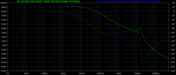

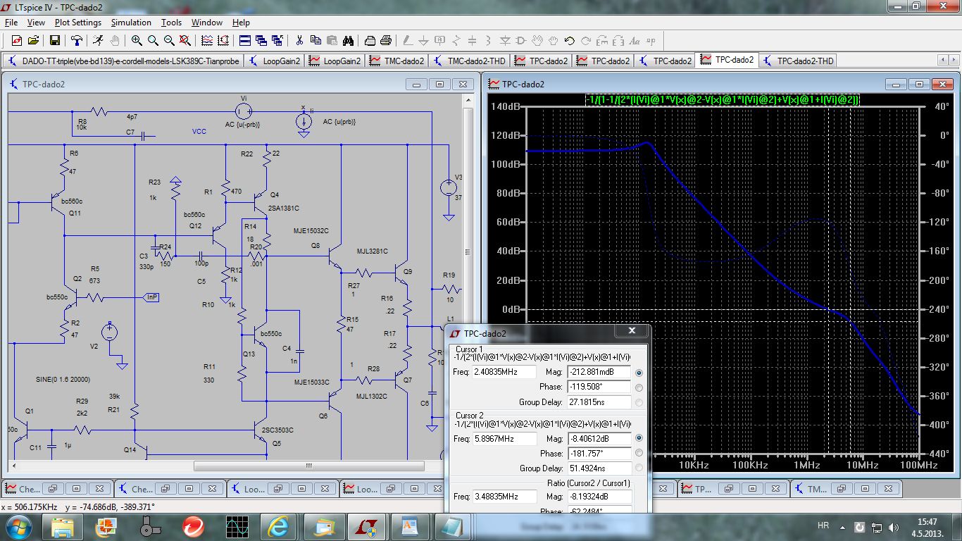

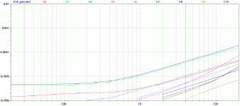

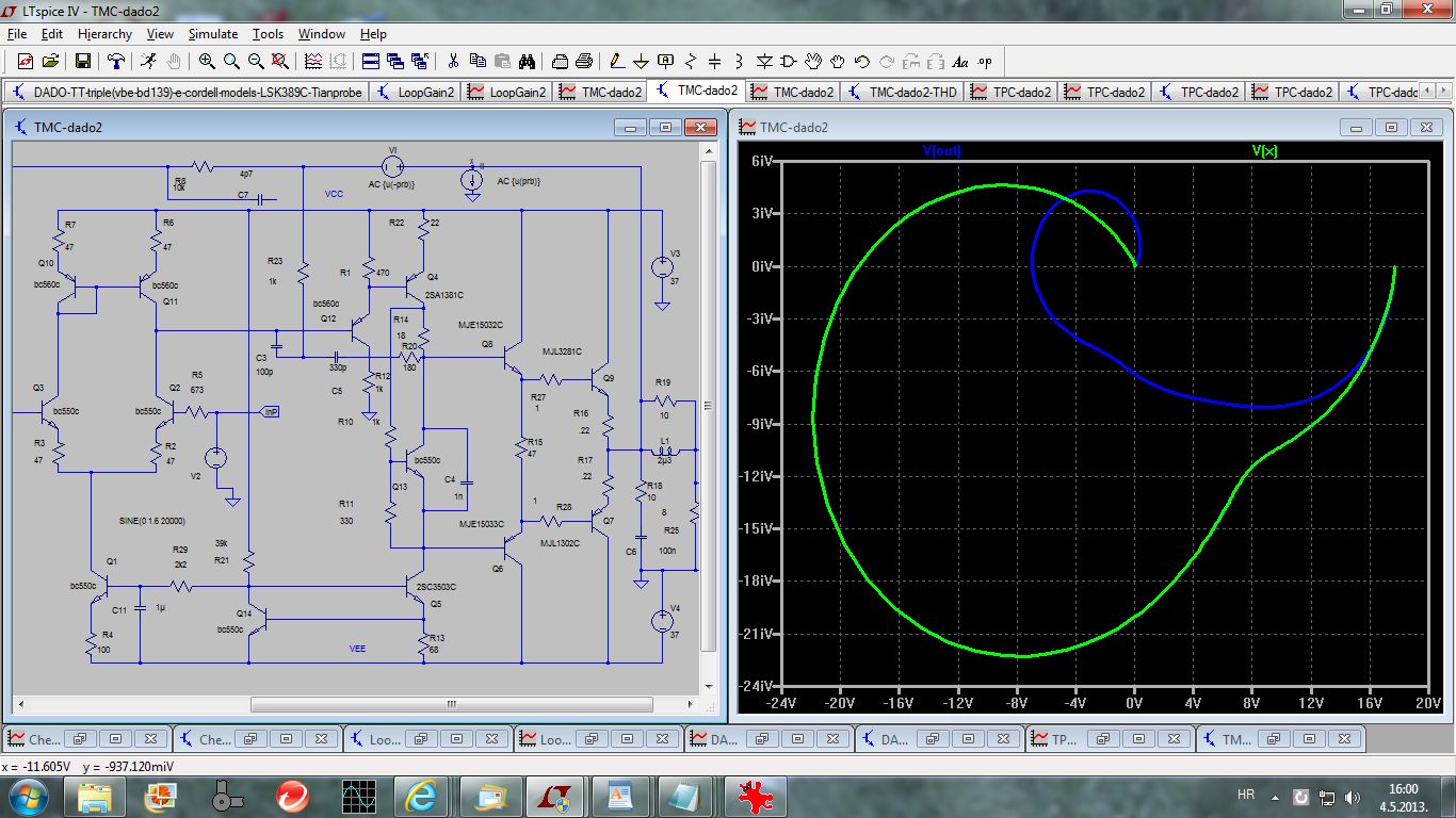

Here are some simulations with your amp, TPC vs. TMC. I changed a bit your shematic to simplify it a bit and removed C7 as Cordell does't like it. It's not that I want to increase your nausea, I put here Phase and Gain margin at the same level, showed Nyquist for CLG, and simulated distortion. In my simulation TMC wins by small margin with lower THD20k.
Regarding real world load simulation you have not showed what it is.
One question: I could not get thd_percent graph, with notch_out it was OK.
BR Damir

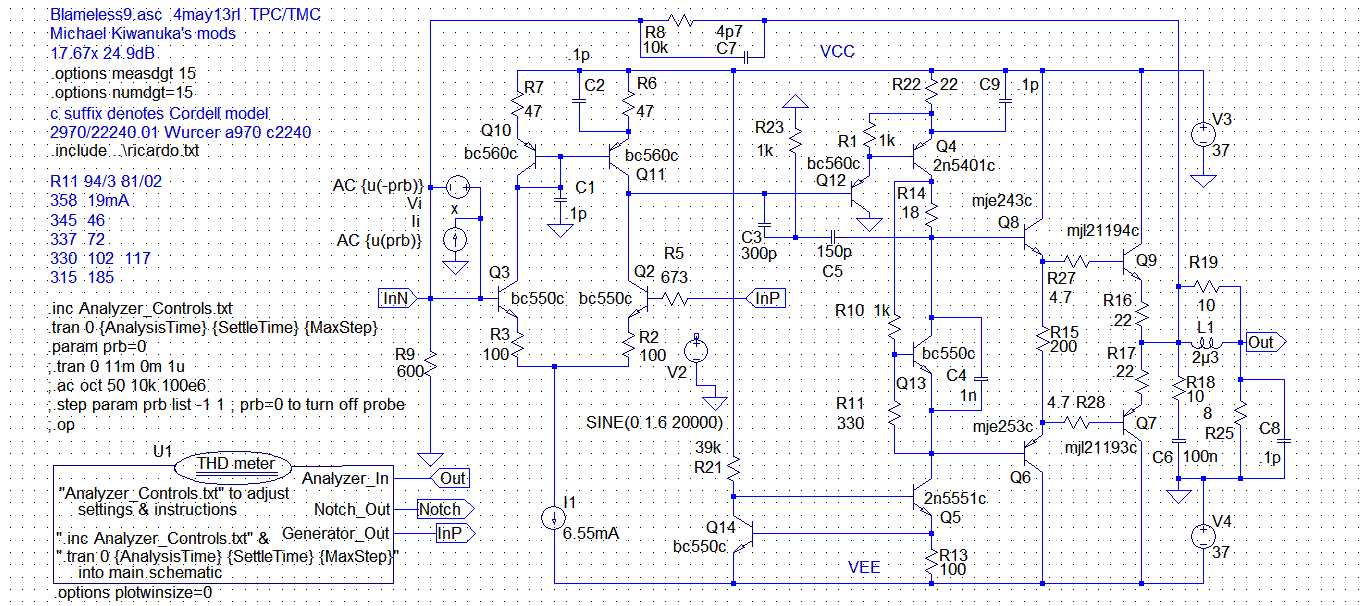

Michael Kiwanuka's version
Gentlemen, I simulated the TPC & TMC version with Michael's recommended mods. I've used a perfect CCS, I1 for the LTP cos in this sim, with perfect supplies, it makes little difference.
Assuming a 'independent amplified negative feedback current source' takes 2 devices, this gives him a spare active device in hand cos he removed the input cascodes. I've left the VAS load 'fully' simulated cos it has substantial effect on performance so needs to be accurate.
Please note several caps have a value of .1p This is much less than the stray cap across a thru' hole resistor so is my crude way of removing caps which I may want again later.
His versions have better 'stability margins' but also much higher distortion. I've included the evil Loop Gain plots cos I need some sort of 'stability' measure to fudge the 'pure Cherry' version to compete on equal terms. I maintain and accept that simple 'linear' stability margins tell you little bla bla ... and prefer to judge stability on behaviour with different loads with .TRANS bla bla ... both in SPICE & 'real' worlds bla bla
First his TPC version.
and the winner, "pure Cherry"!
But yus guys will have realised, my evil mission is to promote 'pure Cherry' over evil TMC and even TPC.
Michael's versions have greater 'stability margins' than those in posts #1, 2 & 4 which use Bode's & Cordell's recommendations.
For a fairer comparison, I've reduced the Loop Gain of the 'pure Cherry' from post #4, by 10dB. This is done by making C1/3, the 'compensation' caps 150p ... and C9, the cap across the VAS emitter resistor 470p.
You'll note it still has nearly 20dB THD advantage over his TPC & TMC versions, even with its loop gain hobbled like this.

David, in his 82' paper, Cherry does 2 analysis. One at LF, looks at THD. It is this that shows the 'insensitivity' of the VAS emitter resistor.
The other analysis is of HF stability. There, the VAS emitter resistor is very powerful. In da dim & distant past, I extended his matrix to stuff connected to the VAS emitter resistor and removed some of his other evil caps.
Damir, the instructions for using the THD meter are in 'Analyzer_Controls.txt'. I made THD.plt to simplify the last step to show all 10 harmonics. The models are set to do the THD plots directly. They take a long time to do on my PC ... 2 or 3 cups of coffee.
The 20k residual plots are V(out)/283000 (for a 0.01% reference fundamental) and V(notch)/28.3 to give the residual. You do these on the RAW display. The 20kHz residuals are from 0.5ms to 0.6ms

As I've pointed out many times before, Cherry's output-inclusive compensation is not stable because the second stage continues generating gain long after the output stage poles have taken effect.
What is required is shunt capacitive compensation at the second stage's collector to roll off its gain to below unity before the output stage poles come into effect.
But you should note that shunt capacitance at the second stage's output compromises its linearity.
Below is a minor loop gain sim of an amplifier with OIC with (blue trace) and without (green trace) shunt compensation (1nF) at the second stage's output.
Note that although the blue trace (with shunt compensation) is stable in this simulation, its unity loop gain frequency is roughly 9MHz, which, I suspect, would still lead to instability in a real amplifier whose output stage dominant poles are likely to reside at somewhat lower frequencies if power BJTs rather than MOSFETs are used.
Mike, your two-transistor VAS/TIS and triple output is outside what kgrlee is proposing (and what Cherry analysed); see post #4 in this thread. Also, you don't have the VAS/TIS emitter resistor and kgrlee's parallel capacitor. Does addressing these issues change the outcome?
Potentially the bootstrap VAS/TIS load and the load stabilising network should be added also (post #41), though I don't know whether these have any significant influence.
On the method of simulating the inner loop gain, I've seen others disable the global loop with a massive inductance in series with the global feedback resistor. Is that what you have also? In the bottom schematic, the feedback component looks like an inductor, but in the top circuit it looks like a resistor. Maybe just the grid points blurring the picture.
kgrlee,
