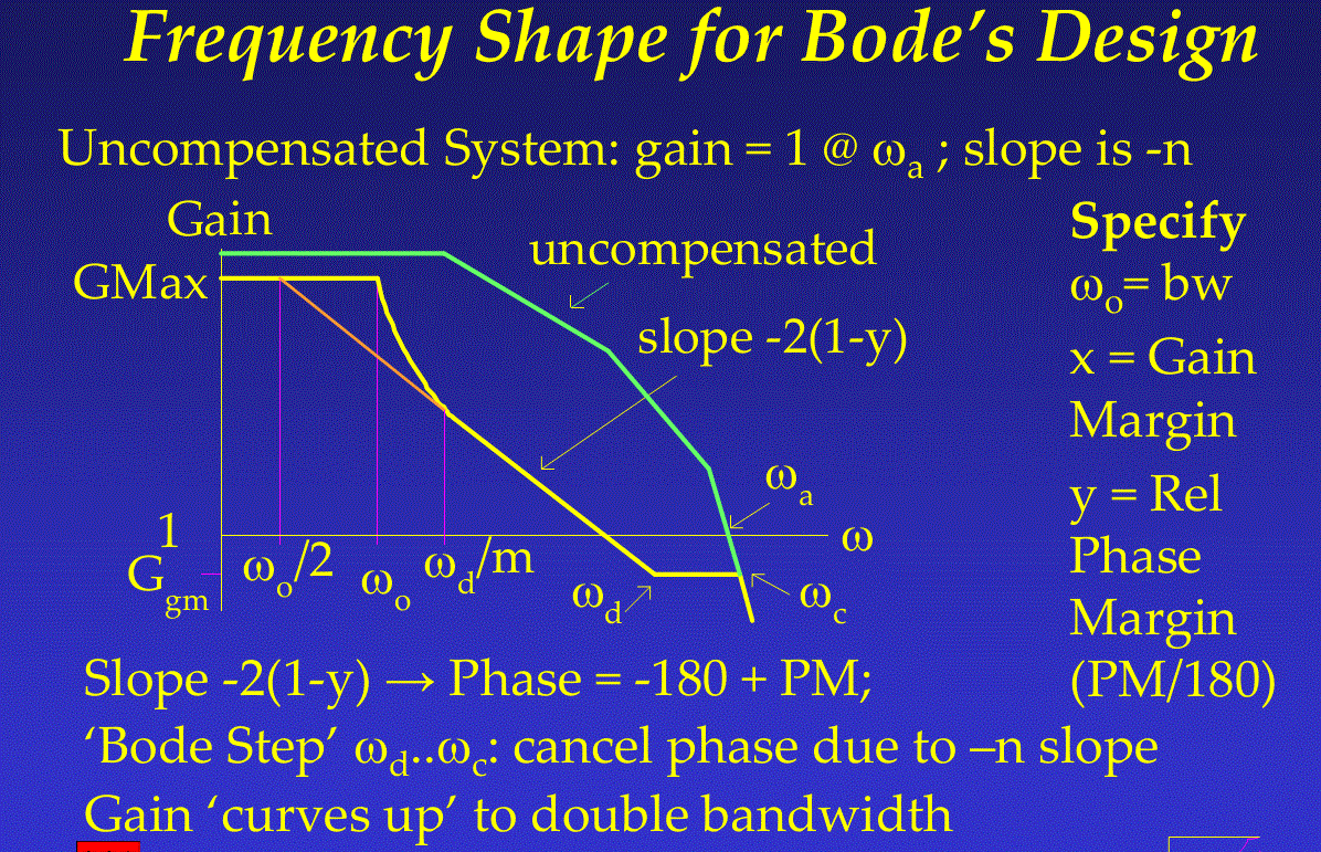

I'm not sure who and on which thread posted a link to yet another Richard http://www.personal.reading.ac.uk/~shsmchlr/selected.htmAnd do I interpret you right, that probably nobody has done/shared a rigorous simulation analysis of the different loops using the methods we all together have applied in the the forum for TMC, TPC, MIC and so on?
He isn't a mere electrician but a horny handed mechanical .. but the mechanicals usually have a better grasp of control theory than us electricians.
http://www.personal.reading.ac.uk/~shsmchlr/miscfile/asm2003.pdf
http://www.personal.reading.ac.uk/~shsmchlr/miscfile/scarpbode.pdf
http://www.personal.reading.ac.uk/~shsmchlr/miscfile/asm2004.pdf
http://www.personal.reading.ac.uk/~shsmchlr/miscfile/C2004RJMitchell.pdf
http://www.personal.reading.ac.uk/~shsmchlr/miscfile/ac2005RJMitchell.pdf
are all worth reading for those wanting a rigorous analysis of different loops.
For Guru Zan, he gives an practical implementation of Bode's irrational element. His lectures mostly show this important version of Bode's Max F/B design as in the attached pic.
I used to calculate something very similar when I was playing with TPC in da old days. You see this in the important Zan/Tian Probe (ZTP) at the output for properly designed 'pure Cherry', TMC and probably TPC and other advanced methods too.
His Bode Step is my Nyquist kink.
There is another useful 'Bode approximation' which has 6dB/8ve until the ULGF and then 12dB/8ve above that. You see that in the 'outer' loop ... but the ZTP will show Mitchell's behaviour.

Dr. R Mitchell's stuff allows you to design for a particular PM & GM.Exactly what improvements can be made within the limits of conservation still escapes me.
In the pic I posted, he shows the uncompensated gain. Anything you do has to lie within this ... and eventually match it at very high frequencies. One could load the 'uncompensated gain' with parasitics galore and this might give us a better idea of what is possible.
Yes, JCX posted it in response to some claims of mine, so I read it very studiously.
