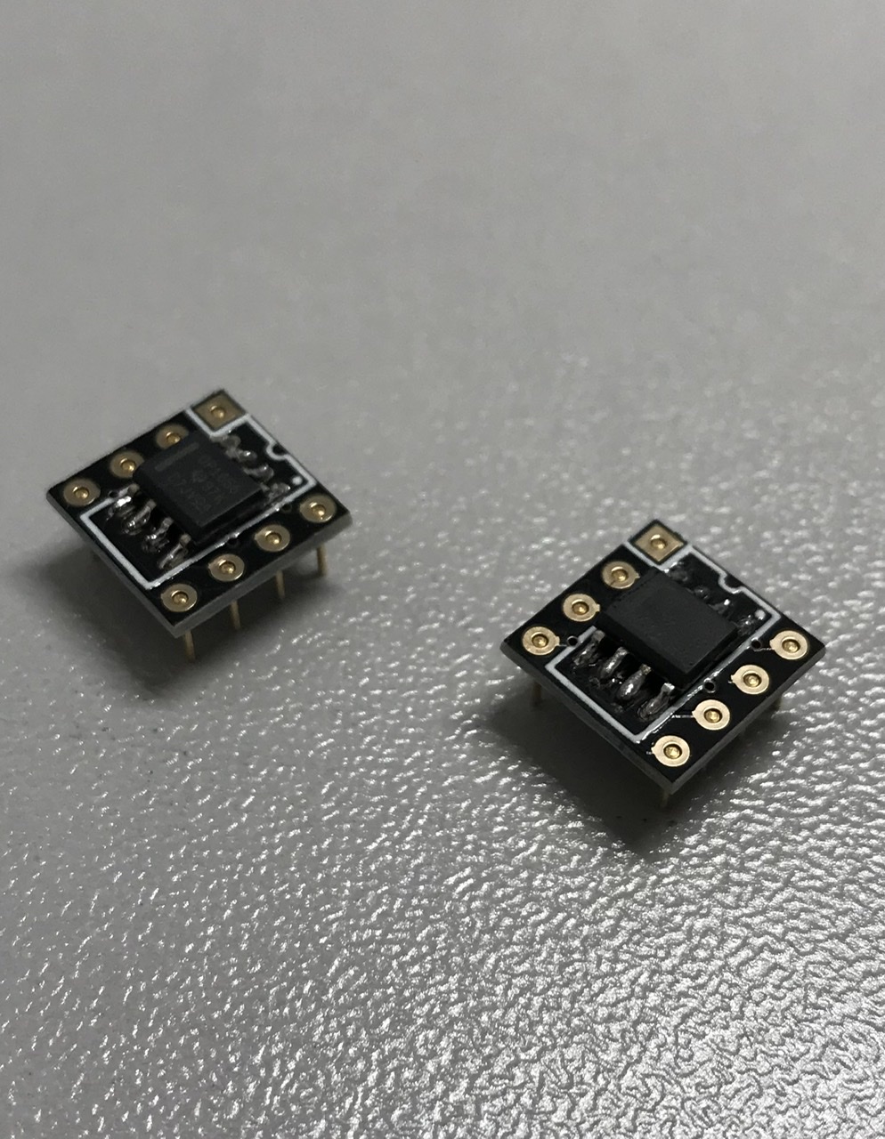

Hmmm. I soldered the OPA1656 op amps from Mouser Electronics to the BrownDog adapters, but I don’t get any sound. The orientation looks correct, but any input is welcome.

The orientation seems correct (top picture, the one we see the logo)... I have no idea about the issue hummm

Maybe this picture could help you :
Hi Rich,
I defo don't use the same adapter as you but my understanding is there are the wrong way for your adapter, based on the markings.
I would say that the small white dot (on your pix "up and right" on both units) one can see is probably to show where pin 1 of the SMD op amp belongs.
If so haven't you inverted their mountings?
If so, turn them 180° and hope for the best. Be careful desoldering them (not always easy) and perhaps try them in a non expensive unit first, not sure how they reacted when you plugged them the wrong way...

Well, now I feel like an idiot.
ClaudeG, you are correct. I turned the op amps 180 degrees, and now the LEDs light up and I have sound! Good sound at that too! I will do some critical listening now that I have the amp working properly. Listening to the Bill Evans Trio’s “Waltz for Debbie” on SACD. Very nice!

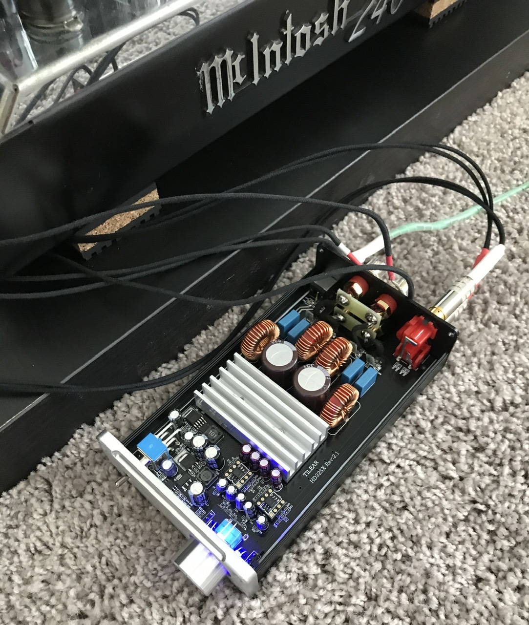

Well there must be protection diodes, because with the wrong orientation, the amp didn’t even power on. Once the op amps were properly oriented, the amp powered on with the LEDs illuminating. The sound of these op amps is very nice transparency.
I’ve put my Sony ES SACD player in repeat playback, and now I’m going on a walk with my wife by the lake to get some fresh air.

That’s exactly what I will do with this pair. I have another pair of OPA1656 op amps and adapters that I have not assembled yet, so I will make them up correctly. In assembling and modifying Class D amps, I have developed a personal technique for applying a tiny amount of solder flux to the solder pads on the board and the device I am soldering. Then I put a tiny bit of solder on my iron tip and touch the joint to be soldered. This has worked well for me as I use a dental tool to hold the SMD component in position with my left hand. I made sure I didn’t drink coffee this morning to keep my hands steady and my patience.
My next Class D project is to assemble a pair of TPA3255 PBTL amps using boards from member drmord. That will take some time, and I’ll use the supplied stencils and an oven to mount most of the SMDs.
Other projects include replacing the aging Sprague Bumblebee caps and Carbon composition resistors in my McIntosh MC240, building Nelson Pass’ next single-ended Sony VFET amp project when it is released, and maybe a DHT amp using either 300B or 2A3 tubes.

ClaudeG,
I will have to check how much space is available for a full-size volume pot like the Tocos Cosmos. There is a daughter board for the stock volume pot that is soldered to the main board, but I will check.
I took your advise and purchased a 50k Tocos Cosmos volume pot for my Pass DIY B1 Korg NuTube preamp and it was better than the Alps Blue Velvet that came with the completion kit from the diyAudio.com store.

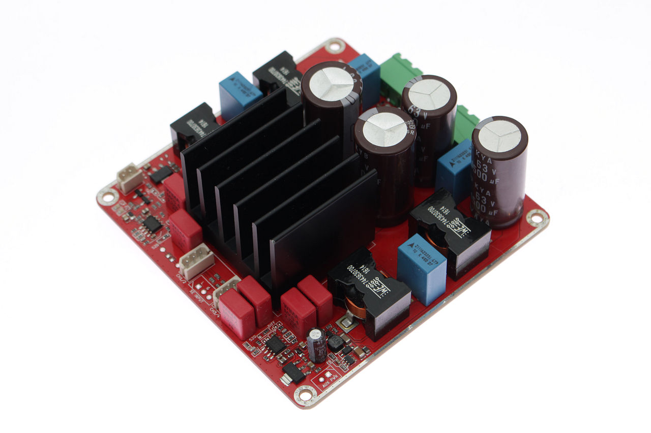

Hi Rhing,
Are you talking about this board ?
Or about this one ?
Or this last one :

This one:
Hummmm the one you shared comes from 360 customs. Any link between Drmord and 360 customs ?
By the way any idea if its price ?
My apologies, doctormord is the diyAudio.com member who produced these boards. I cannot remember what I paid for these PCBs, but you can reach out to him via his Website:
TPA3255 / TPA3251 / TPA3245 Rev.1B Final – #360customs
Looks like doctormord has created a Rev. 1B version. I have the Rev. 1A version.
