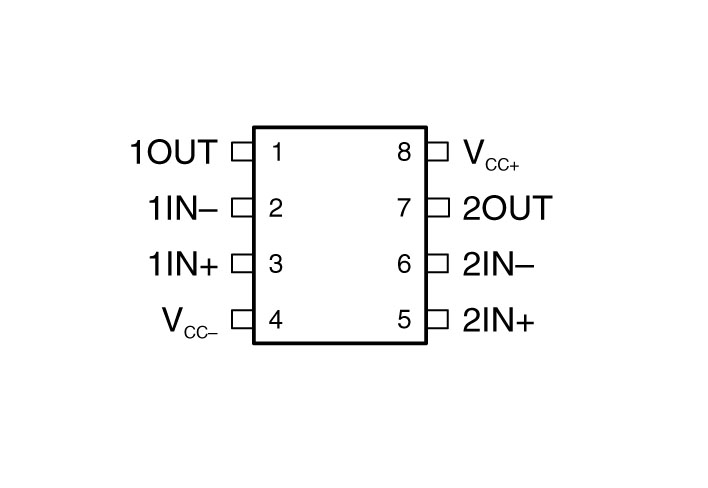

zek is correct, you would need to make up two cables which are female XLR to DIP8 socket adapter.
Wiring at the DIP8 socket is to the pins where the opamp has its two outputs, plus AGND. So as per the NE5532 pinout from the datasheet, this will be your wiring:
+ve XLR-F pin 2 (red) to DIP8 pin 1
-ve XLR-F pin 3 (white) to DIP8 pin 7
AGND XLR-F pin 1 (braid) to DIP8 pin 4

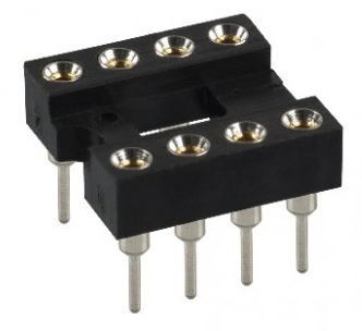

I take note of it but without conviction... I need to find a dip8 adapter and a XLR Plug. But many thanks for sharing.
By the way, any idea about this hypothesis : With a TPA3255 Amplifier equiped with Bluetooth chipset : I wonder if the signal received passes through the OP Amps or if it is directly transmitted to the TPA32XX chip ? in the second case, this could give us an idea of the sound with an unprocessed signal
DIP8 socket from Mouser -I need to find a dip8 adapter and an XLR Plug.
https://au.mouser.com/ProductDetail/Mill-Max/110-13-308-41-001000?qs=%2Fha2pyFadugNqN7TEfSg9dgVPVw4Cip4QS1IvzyqsD4nViX%252B7uIdxq0MjFrVtLjW
10x DIP8 sockets from China -
10pcs 8Pin DIP-8 SIP Round IC Sockets Adaptor Solder Type IL | eBay
XLR plugs are all over eBay, or your local pro-music shop. Or from Mouser -
https://au.mouser.com/ProductDetail/Neutrik/NC3FXX?qs=sGAEpiMZZMv0W4pxf2HiV1SJfrv4woLT9X2Ff%2FA3REo%3D

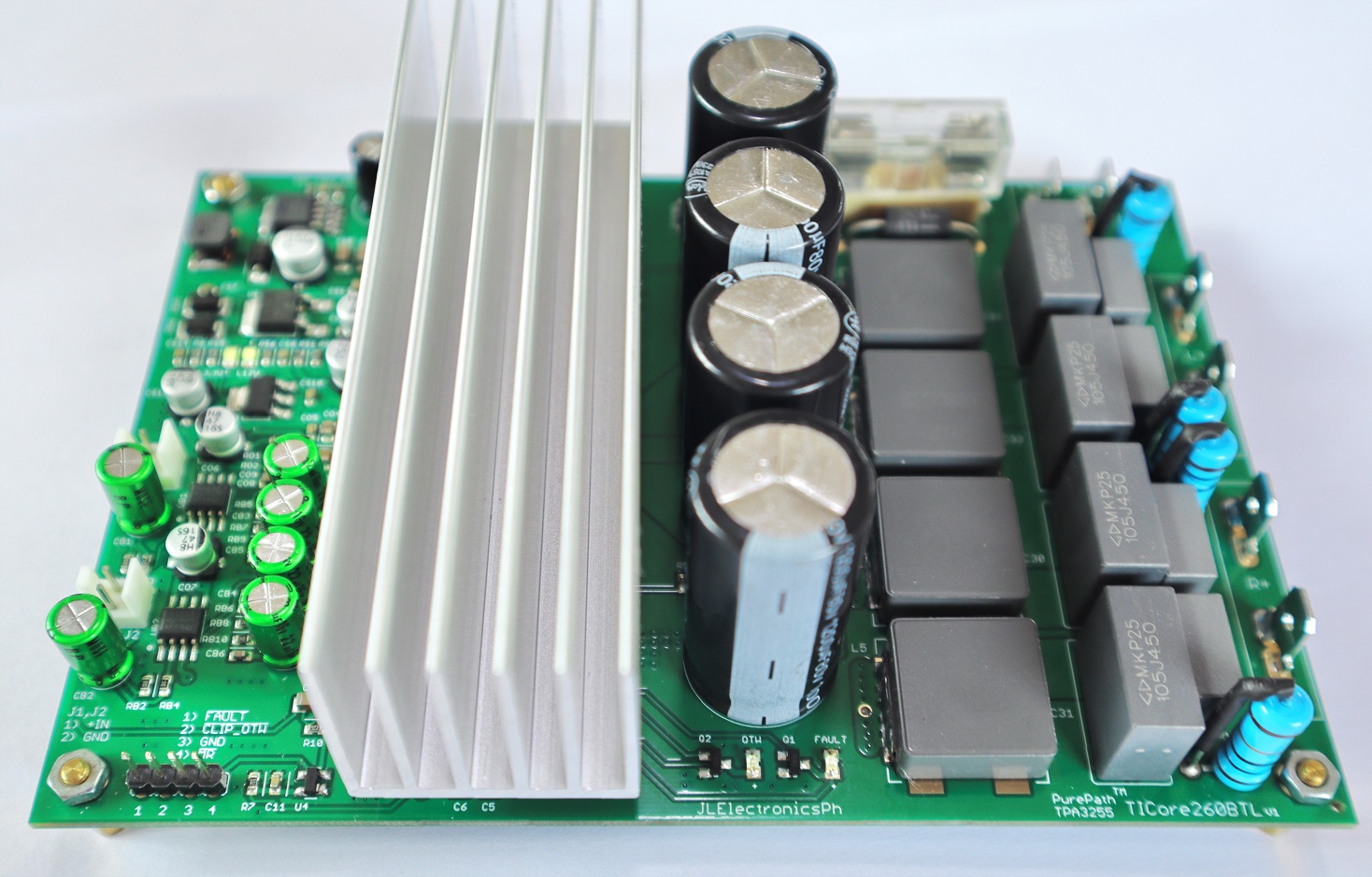

Suggestion : I am very interested in the TPA3255's JLElectronicsPh board.
I am almost sure we can ask the designer to bypass the OP Amps on their pre-prod. boards. They are normally sold with OPA1656 on it (DIP8 or SOP8).
Would you like me to ask to the designer If I can get it without any OP Amps installed and bypass the buffer ?

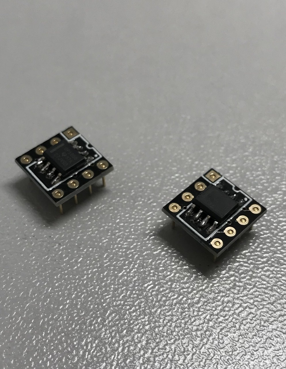

On another note, I received the OPA1656 op amps today, so I will solder then onto the BrownDog DIP8 adapters and try them out.

Let us know if you feel any improvement with those OPA1656 and what about the MA5173-AE coilcrafts ?
