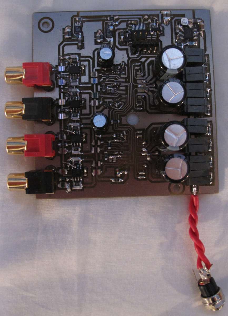

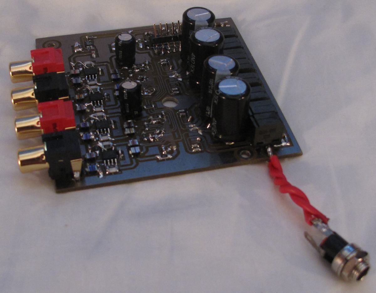

The pictures are not so great due to bad lighting, but they boards are now done.
The only thing left to do is solder on the TPA3251 chips and the 1uF caps in the output filter. These are polypropylene and are quite large physically. I will put them on the underside of the board.
The board itself uses a LM46002 buck converter to step down the power stage voltage to a more appropriate level. This is then post regulated by a pair of LT3042s.
I had wanted to use these since Linear released them but haven't had a use for them yet. Well here I figured they would make good sense, what with their excellent high frequency PSRR for removing the grunge that the switcher could put out. I have actually measured the grunge that the switcher puts out with the scope and it is minimal to say the least.
One LT3042 feeds the TPAs and one feeds the opamps on the input stage. I am using LME49724 fully differential opamps for the input stage.
There is a micro controller included to control the power up sequence to ensure quite start up and to allow the unit to be trigger turned on and off by another unit.
I figured I'd add in decent quality parts just to see what the TPA is capable of. It's not exactly fair to do comparisons to my other amps with a design built on compromise as they were not.

Do you expect this layout to be capable of running the chips at full power? Is this a 2oz. copper pcb? What about cooling? Nice one so far.
Are those really 4u7 MLCCs at rated voltage?
2oz yes, full power? Probably not. One of the applications intended for is the mid and treble section of an active setup, it's got good sensitivity too and I use hardly any power. The other would be another active setup this time two way with 8 ohm drivers. Again not particularly challenging in terms of current or dissipation. It will be interesting to see just how far the intended heatsinking will go.
Which caps are you referring to?

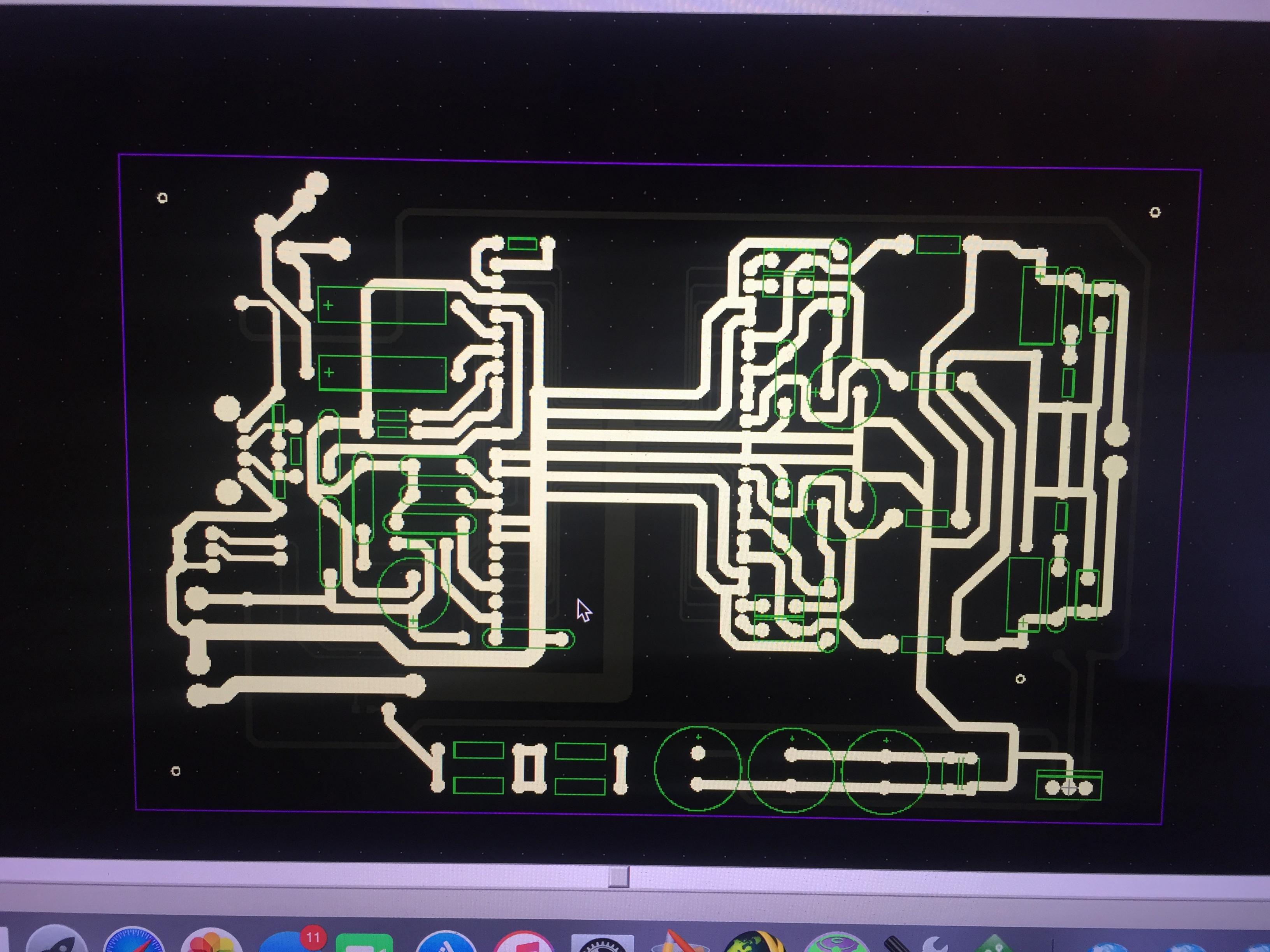

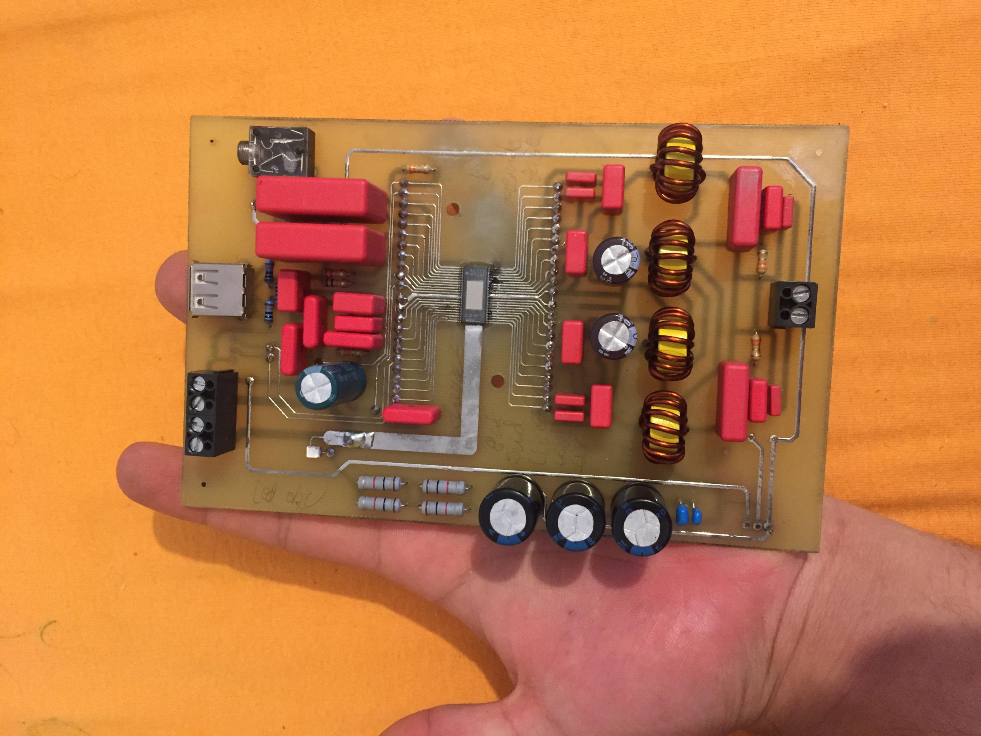

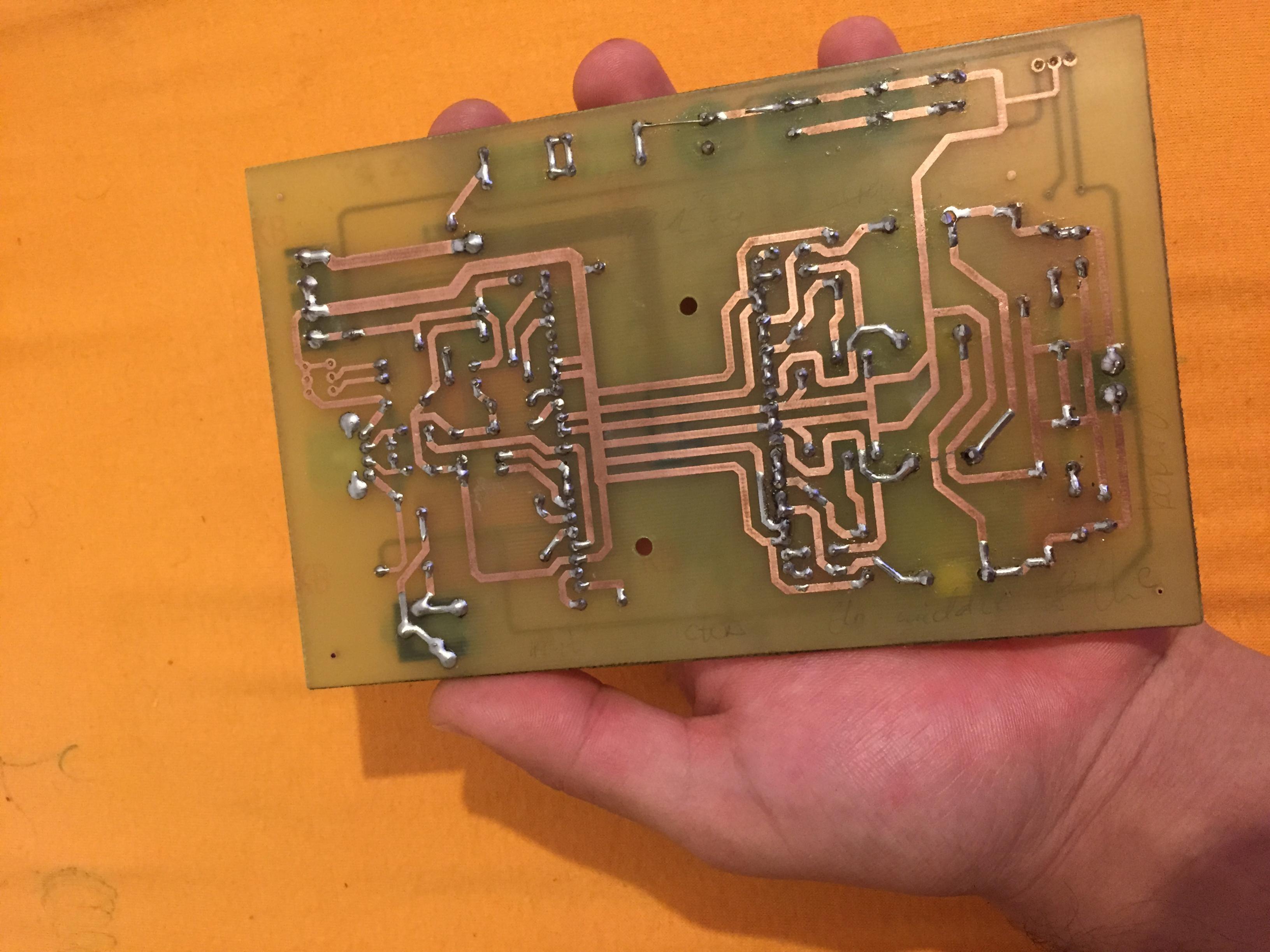

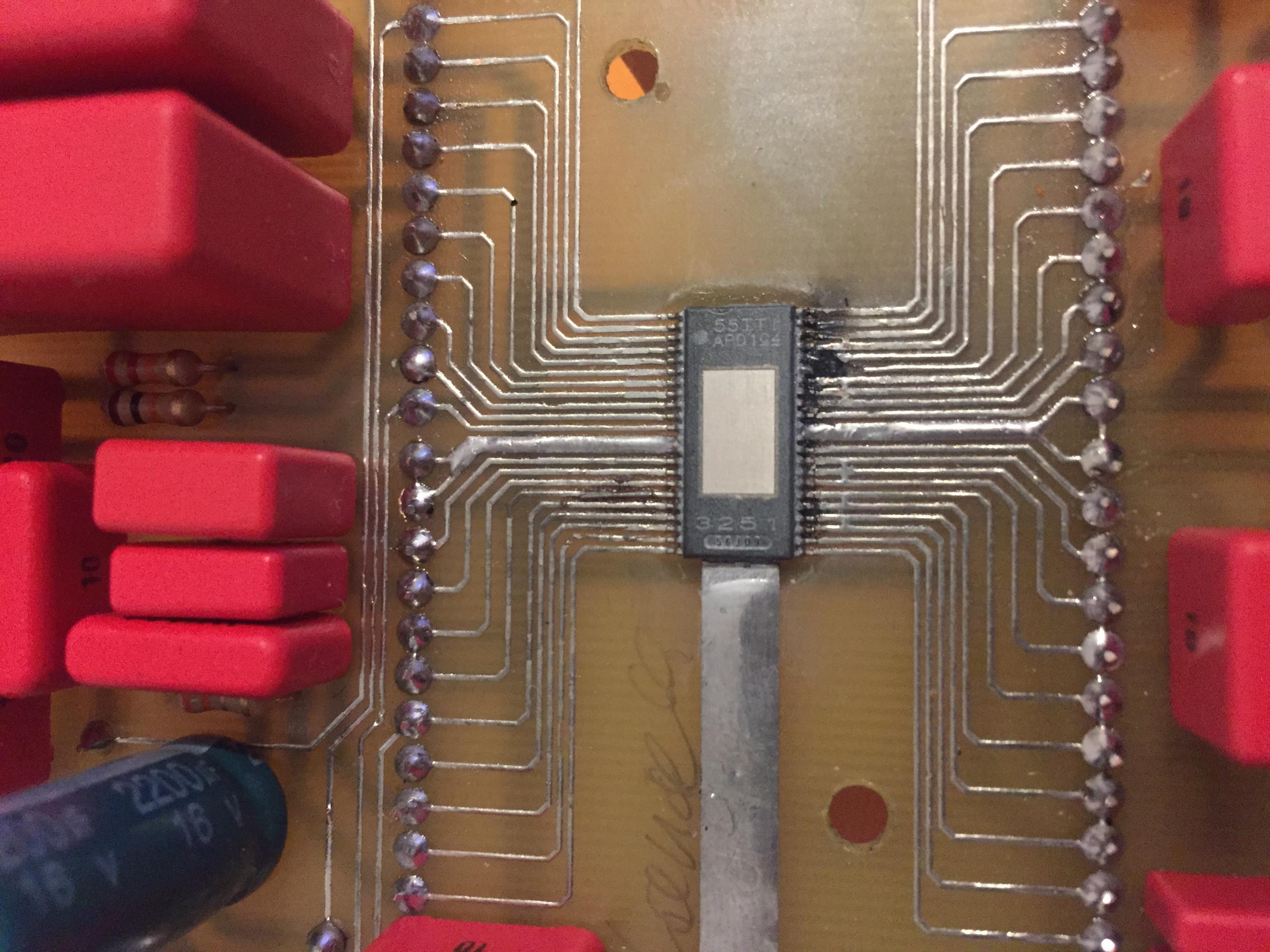

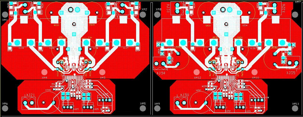

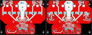

Hi, I am fairly new to electronics and i requested TI's TPA3251 a week ago. I received 5 of them yesterday and I just finished my PCB. I made a PBTL Version And It burned out just when gave the IC its juice. I couldn't see any solder bridges on my PCB so I can't figure out where the problem is, cause I followed TI's Schematic as my 1st Prototype. I didn't connect The Reset, Fault neither the OTW warning pins. I don't know if thats alright or not cause they say in the data sheet that those pins are only for resetting the chip and warning outputs, which I don't want to use for now. Elec caps are 35V and the red Film caps are all 63V ( Wima ) I have only used good brand stuff so I really can't figure out where the problem is btw The PCB has a thick solder mask on the SMD side so the traces are no problem besides I didn't connect a load... :( I'll attach the pics and I hope someone can help me :(
Ps. sorry for my bad english, hope I can improve
