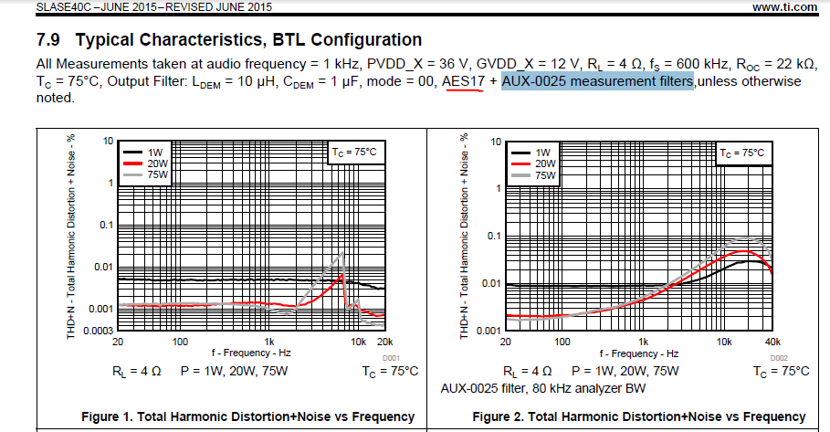

for your perusal http://www.ap.com/download/file/148
good luck trying to recreate their THD measurements.
you can bet TI does use linear PS for all its testing. if you've ever done muli-tone linearity testing you know the effects of down sampled spurs (mixed spurious inband)
(my conclusion > new class D amps need new ways to make them appear cleaner than they really are)
THD curves at shown at one frequency ( curves will be different for other frequencies ) this is an example of what 'downsampling' does. Now throw in real world music signals and switching power supplies!
interestingly the added filter shows worse performance. > IDK there must be other differences besides the added filter
correction attached curves above are swept tone not single.
Yes I was thinking that too, the distortion rise happens far earlier on for the 80k bandwidth measurements than it does for the 20k. Clearly something else is happening here besides just harmonic attenuation.
The distortion minima is lower for the 20kHz bandwidth as would be expected due to lower inherent noise, but the rise only happens at around 2-3k for the 20k limit rather than 100-200Hz for the 80k.
If you extrapolate from the 20k bandwidth graph what the distortion at 10kHz would look like then you end up at around 0.05% for the 75 watt plot. Coincidentally this is exactly what the 10kHz distortion level actually is when measured with 80k bandwidth.
If you look at the 1 watt figures what's odd here is that the 20k bandwidth is good till around 6.7kHz and yet it shows no rise whatsoever. The 80k one though shows a rising response from around 3kHz.
The only thing I can think that would cause this is way out of band noise or spurious components.
The AES17 filter is largely a brick wall imposed at 20k, whereas the AUX-0025 filter rolls off slowly beyond 20k and then brick walls at just above 100k.
It could quite easily be a SMPS that they use too. Unless newer bench PSUs are still built from linear transformers. There are some videos out there of TI measuring a TAS5630 I believe so you can probably snipe a look at what power supply unit they use from that.
I would have actually thought the opposite, newer class D amps are able to function will less severe filters than their predecessors. Owing to lower EMI emissions and in some cases amplifiers that do not even need an output filter, mainly because of the switching scheme used.
There is nothing inherently wrong with a SMPS if it is designed for the job and real world signals or IMD can be predicted from single tone distortion testing.
I don't doubt SMPS for class D power stages, b/c they create their own ripple in great amounts. but I think they (TI) may not like to have power supply spurs show up on the data sheets. it's expensive to have to retake a weeks worth of data. AFAIK DC ripple and "other SMPS stuff" > 20KHz shoots straight through to the audio outputs
