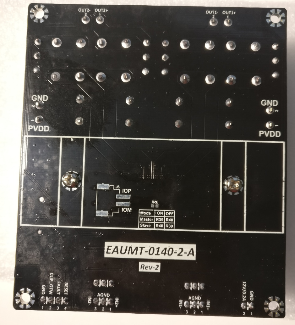

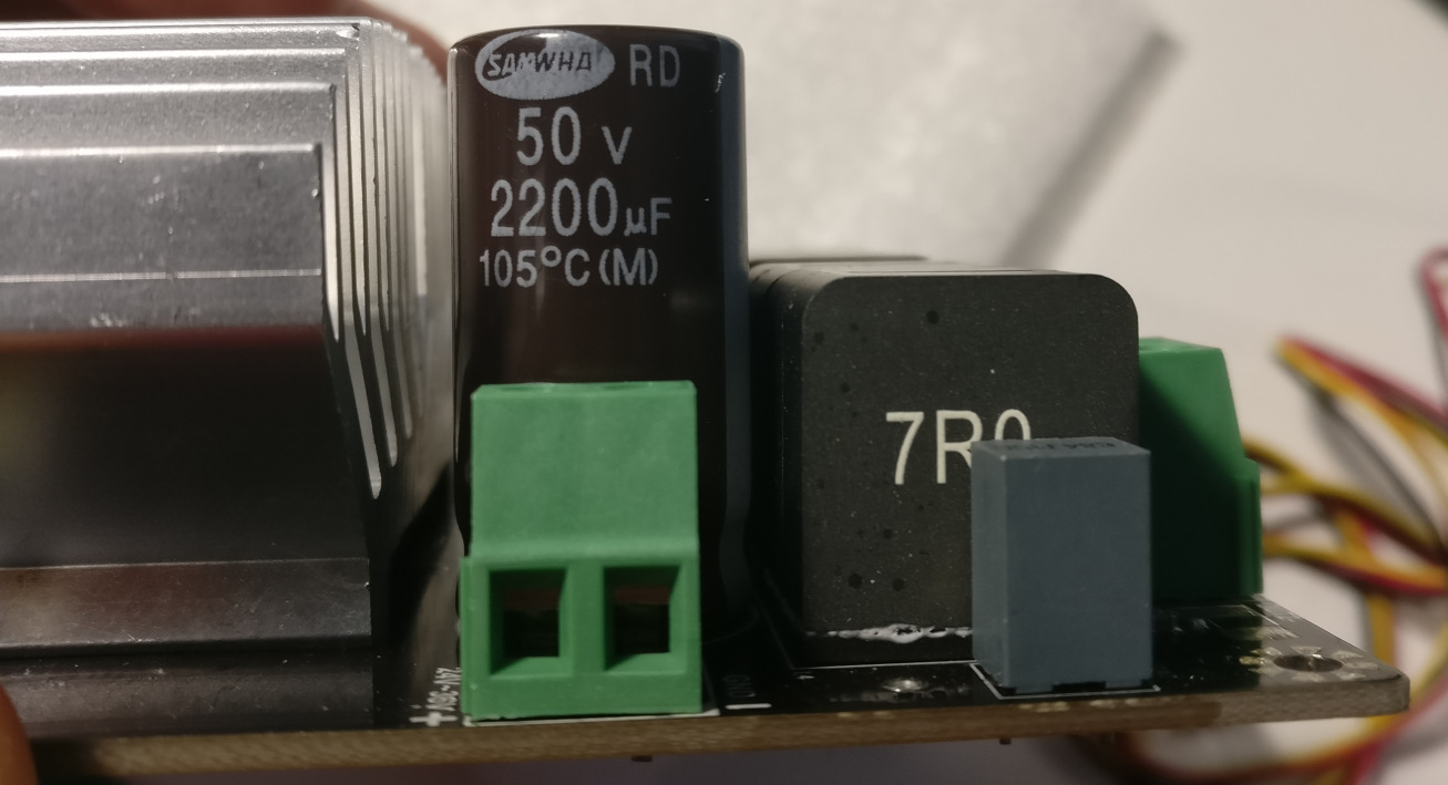

Anyone with the 3e-audio tpa3251 board using 24v supply by chance?
I got this board about a month ago as a gift. I finally got around to testing it out tonight. I want to use a 24 volt supply, in particular a Meanwell epp-200-24. When I connect this supply, the amp board's red power-on LED lights up, and none of the fault LEDs light up, but there is no sound.
I also have a 36v supply (Meanwell lrs-350-36). The amp works as expected with this supply.
Unfortunately, the EPP series 24v doesn't seem to have an adjustment pot, as I was thinking maybe if I could bump up the voltage a bit the amp would work. My cheap DMM says it's output is 24.1v.
Anyone have any thoughts?
Thanks!

According to the datasheet there is an adjustment, but only +/- 5% so not quite enough according to the comment from 3e.Unfortunately, the EPP series 24v doesn't seem to have an adjustment pot, as I was thinking maybe if I could bump up the voltage a bit the amp would work. My cheap DMM says it's output is 24.1v.
Where are you seeing that? I combed the datasheet several times, but am not finding that. Even if it's not enough it's a trivial quick and easy thing to test.
There seems to be a 27v version, might be easier to return/exchange the Smps.
Nice find. Although the 200-27 comes with a lower max current relative to the 200-24, the 300-27 might be better suited (though physically bigger and more expensive).

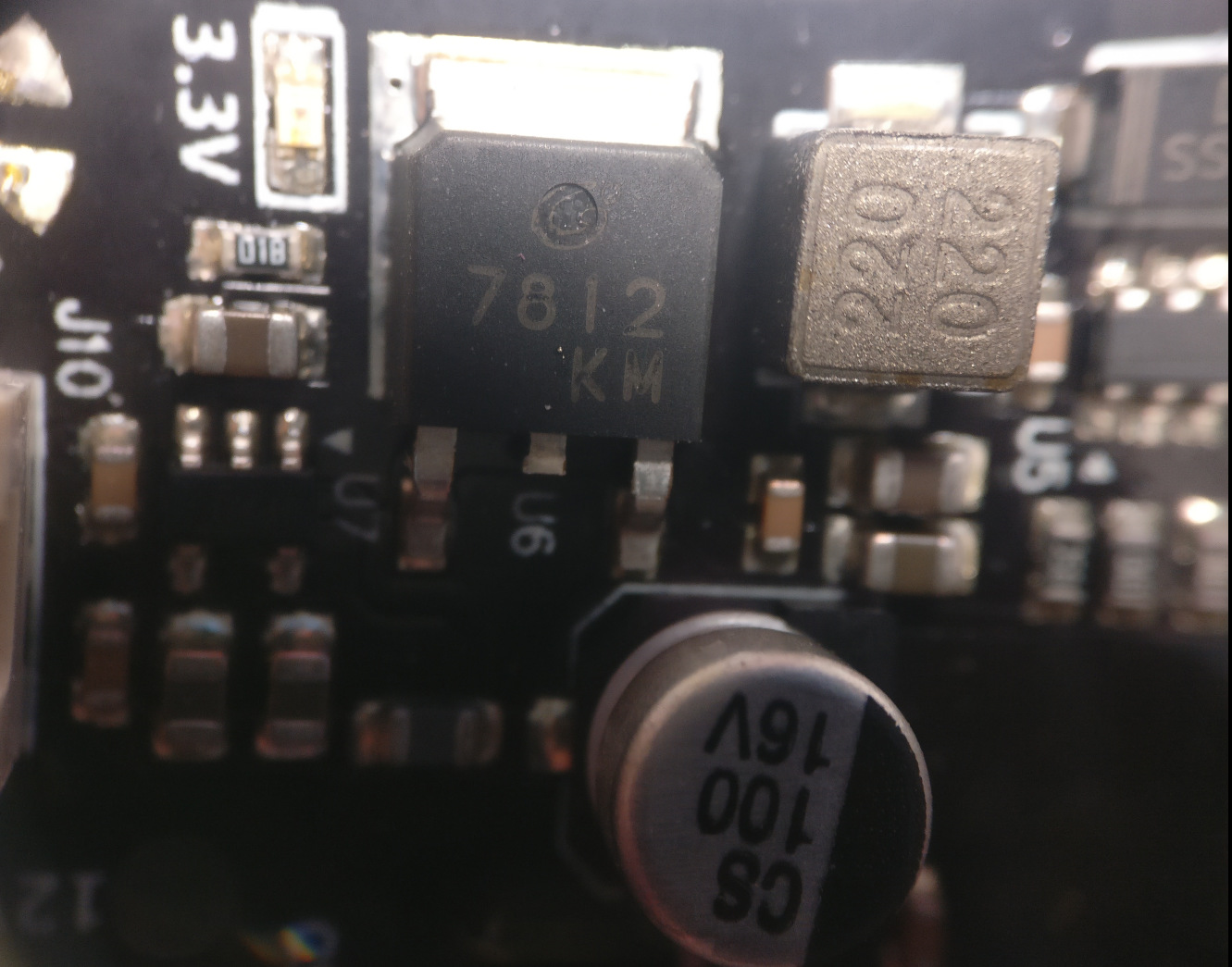

Hi ,there is some tolerance on the setting regarding Zener diode and resistor,please use input voltage higher than 26V to get a good margin.
FWIW, now that I've found the trimpot on the epp-200-24, I was able to get your tpa3251 to turn on at 25.5v. I wanted to see where the actual cutoff was. If I barely adjusted the voltage down, to where my DMM kept jumping back and forth between 25.5 and 25.4, it turned off. So at least mine will technically turn on at 25.5v, but I doubt it's wise to run it so close to the edge like that.

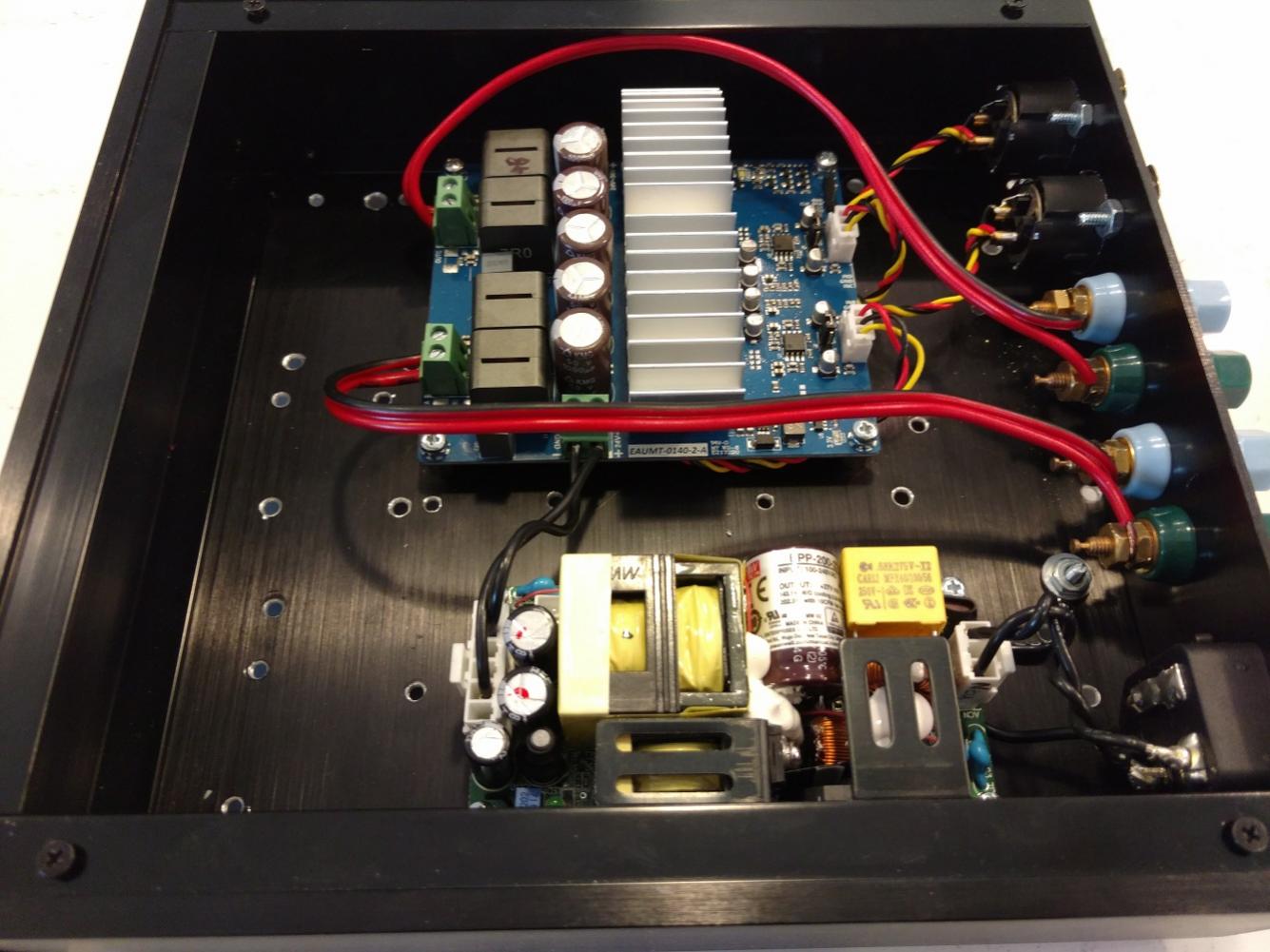

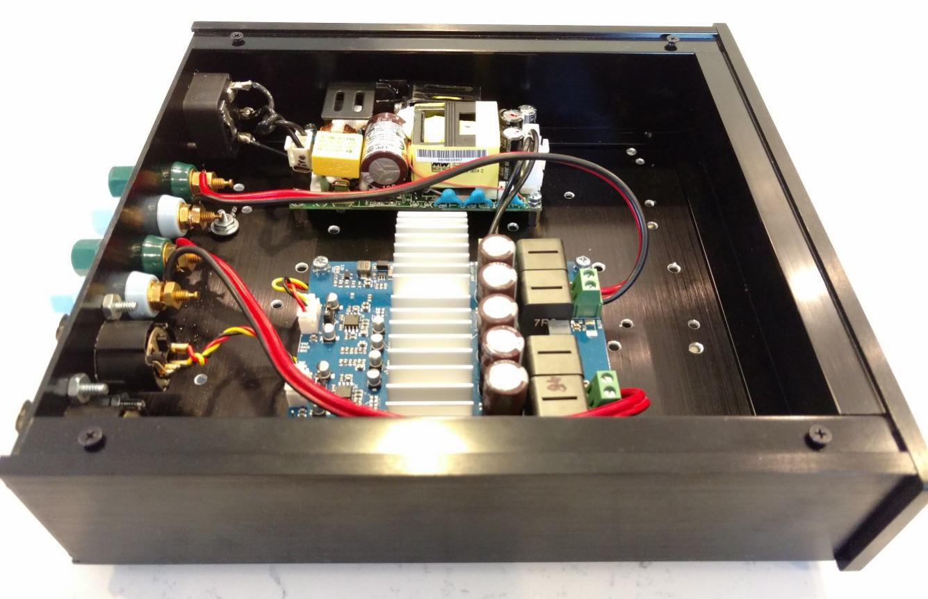

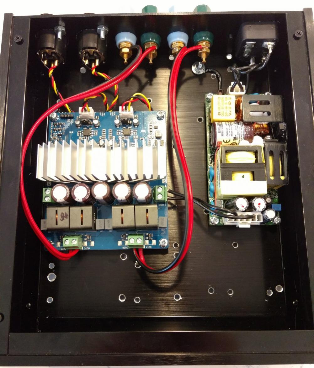

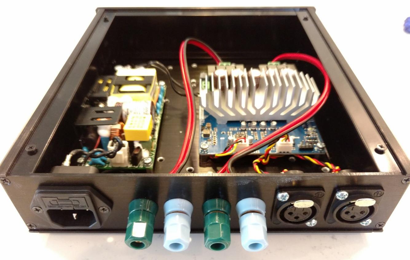

I decided I'd rather get a new power supply than hack the 3e-audio tpa3251 board. So I went ahead and grabbed the MeanWell EPP-200-27. (Technically I'm supposed to install a fan for this PSU if I plan to draw over 140 watts, but I'm quite sure I'm nowhere close to that... need to find my Kill-a-Watt so I can measure this.)
The chassis is the "2205" that is sold by many Chinese sellers on ebay. You can see by all the holes in the bottom I've used it for a number of other projects.
Only thing left is to install a power-on LED on the front.
