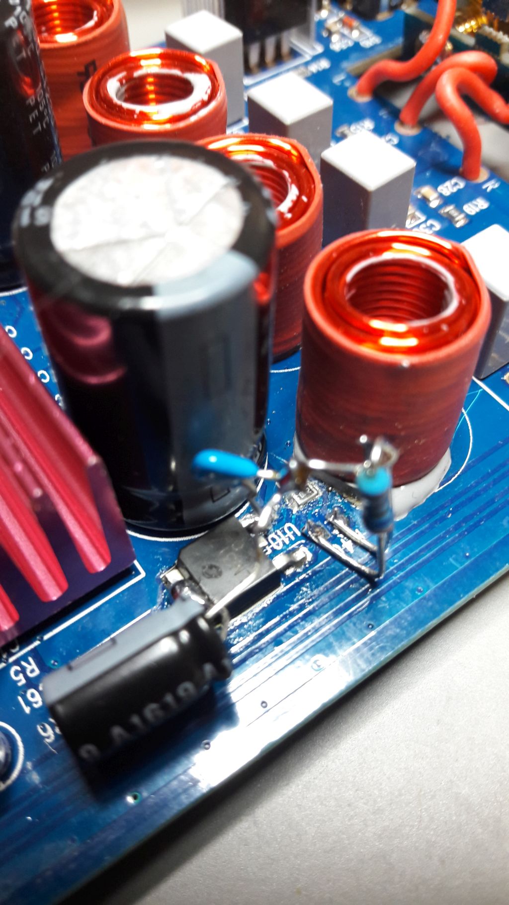

Hi
after checking my boxes i changed my mind and I desolder the 4300 ohms and used a normal resistor 1/4W- 3k6 (3584) to set the LM317 to 20V.
i used a 47µF for output and a 220n (blue) for input of the LM317. both caps are missing at the pcb.
i checked the Voltages:
IN 23,97V
adj 18,77V
OUT 20,03V
:cool::D so the original psu can be used correctly.

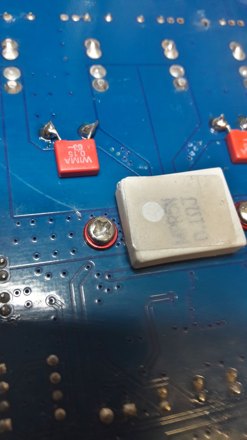

the 2nd pic you can see the parallel wima caps 150nF/63V to the 1800µF Rubycon -back side.
test will be done..................

output cap on lm317 is there but a little distant next to opamps, lm317 doesn't really deteriorate here without outputcap btw inputcaps are rubycons and now those bypasses plus the blue one, noise reduction would be a cap parallel to the 3k6 resistor 10-22uF

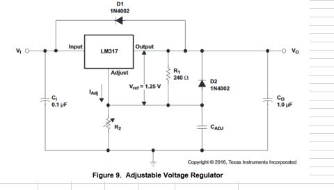

ok.. i want to follow the datasheet...
Ci and Co
you mentioned the Cadj?
