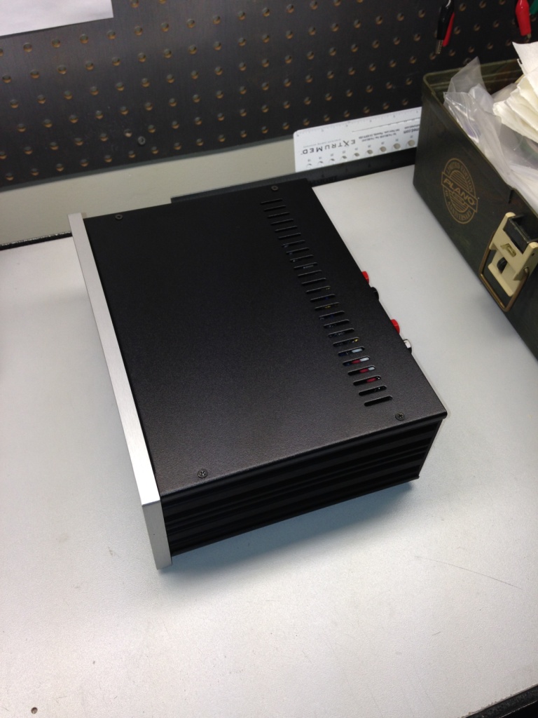

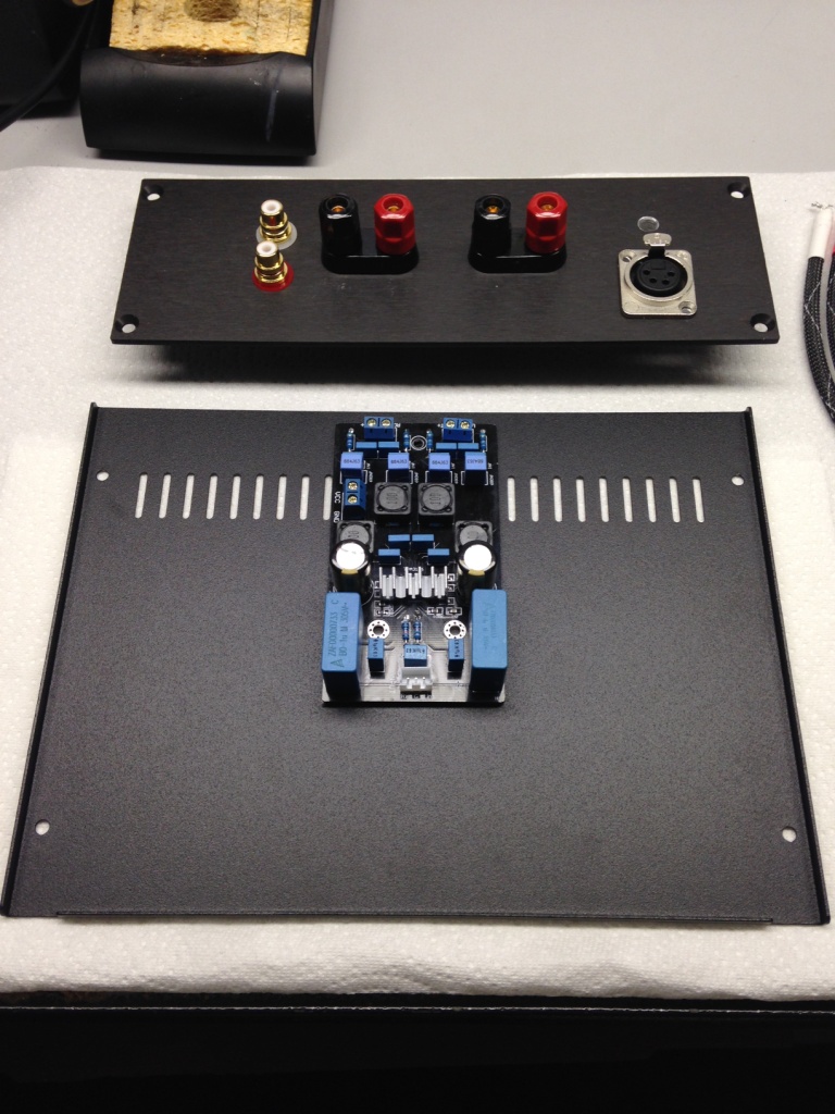

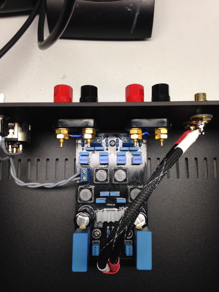

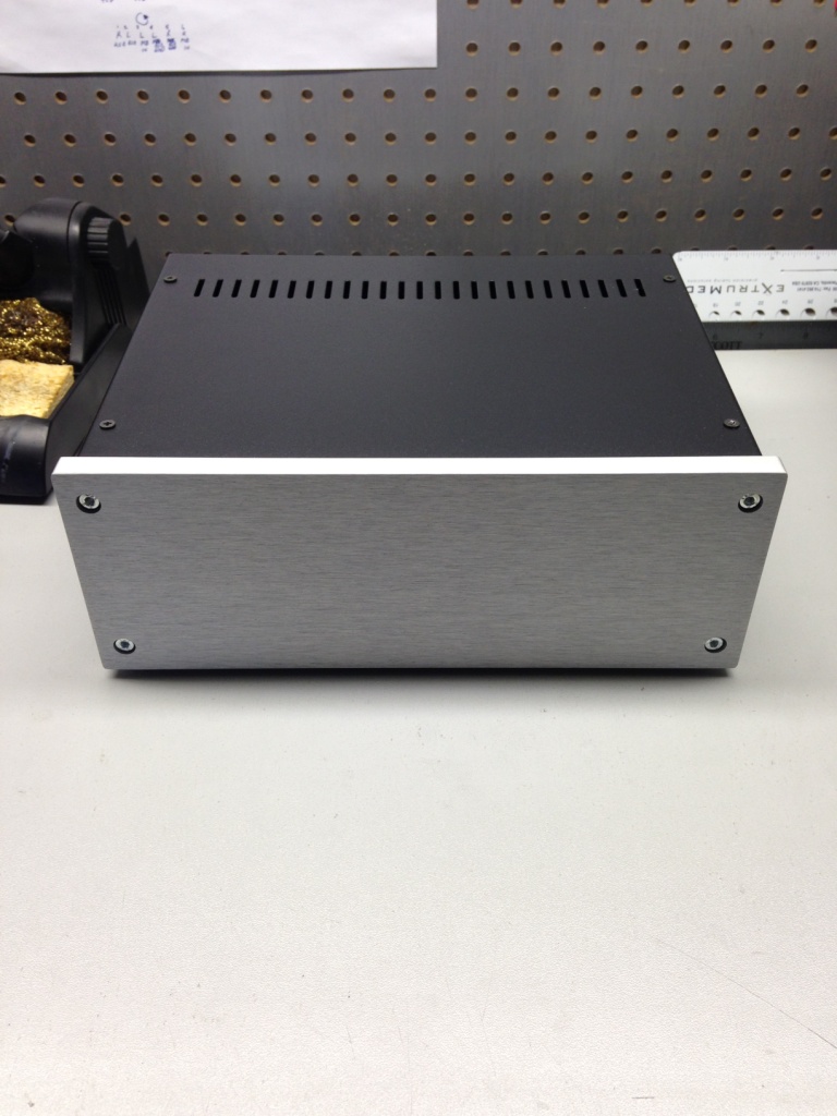

Following KJA 2013's lead, I decided to use Neutrik 4-pin XLR connectors for the power supply along with a DC power cable made of a twisted pair of 16 AWG Teflon-insulated stranded Copper wire. I also installed my YJ "blue" amp in a Modushop Galaxy 237 chassis I bought a few years ago when they had a sale. The chassis is large for the small Class D amp, but I'm considering input transformers for this amp in the near future, so the space will not go to waste of I go down that route.

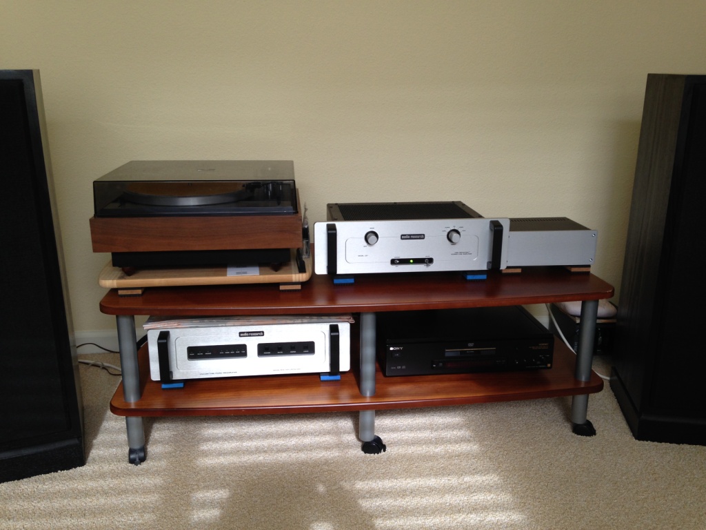

Besides, the amp now nicely matches my Audio Research phono stage and line stage preamps.
Maybe I'll install a muted green LED in the faceplate for a more finished look.
