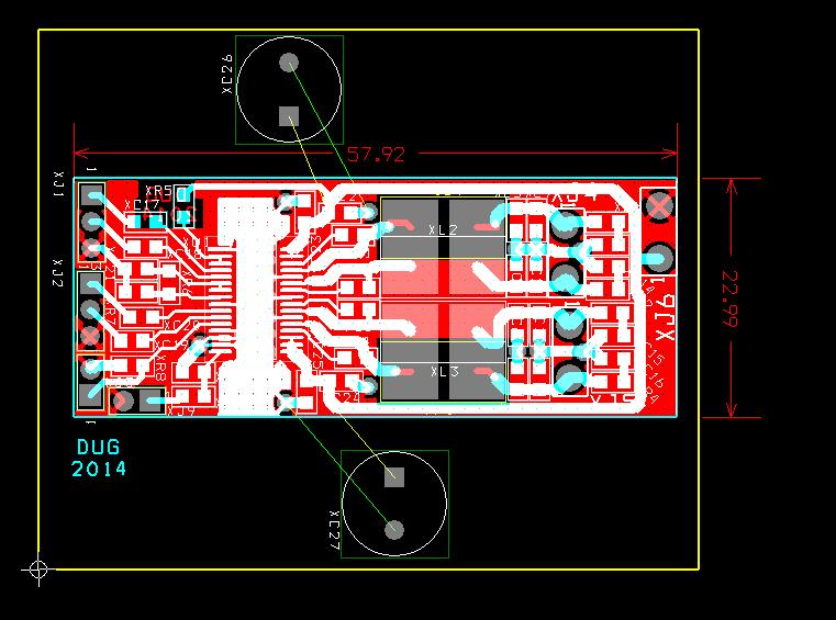

TPA3116D2 Amp
TH Parts + S/D PIN + MUTE and Smaller Board Design [ 50 x 50mm ]
Keeping in-used the Shielded Inductors.
Layout Done and Summary Features:
- TH Parts
- S/D PIN
- MUTE PIN
- SYNC PIN ( For Multi-Boards Linkup e.g 2.1)
- BTL and PBTL Option
- Shielded Inductors [10 x10 mm]
- Board Size: 1.96" x 1.96" / 50 x 50 mm

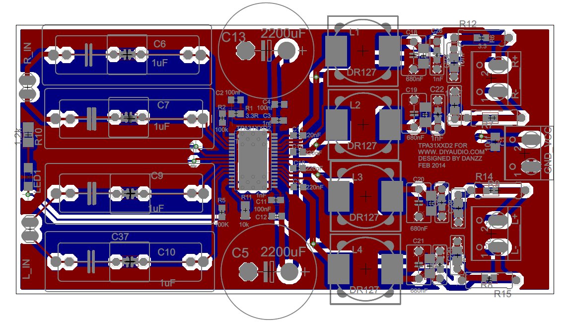

Just finished the last draft of my updated 5x10cm design.
This board was designed with a main porpous, wich is the posibility of choosing diferent components at the inputs and in the LC and C-RC snubber filter, another
factor its to choose between the use of a filter or ferrite beads chips.
Putting 50-470uf caps as close as possible is good. It's especially good for crunching room down and making it all small so you get real low inductance between input and output filters.
However none of these amplifiers sound worth a damn without significant capacitance behind them. Your ripple might be low, but your bass is going to suck without a LOT MORE power on tap. I don't suggest one large 15kuf cap, but rather using several 1000uf caps (I use 10x currently). It keeps the ESR/ESL low, and the bass high (and you can do it for $5 isntead of ludicrous amounts for fast big caps). Yeah the inductance isn't good, but the improved near-chip network of caps will help a lot.
It's a price worth paying. It's better to have them onboard, somewhere near the power in, so you can squeeze all the more critical small stuff in a tighter area. In fact even off board it's better to have them than not. I mean literally it's better to have them dangle on wires off the board than not at all. Without PSU capacitance class D is the flat and boring class (I know a guy using 20ah+ batteries to offset the issue, but no caps). Unfortunately it still lags a tiny bit behind class A, but I think we all know the little difference isn't so little on the electric bill.

Just curious, are you going to build an amp using this board? I am interested to learn how it will sound. And if the amp is priced right, I might get one or two to try it out.
Some DIYers ask for TH parts and small size. Therefore, I make it for fun and use it in my new amp.
The DIY KIT is available at est. 19 Feb. if you want to have receive more information, Please PM.
Now the PCB factory and chips / parts suppliers are closed already in Chinese New Year Holiday period.
