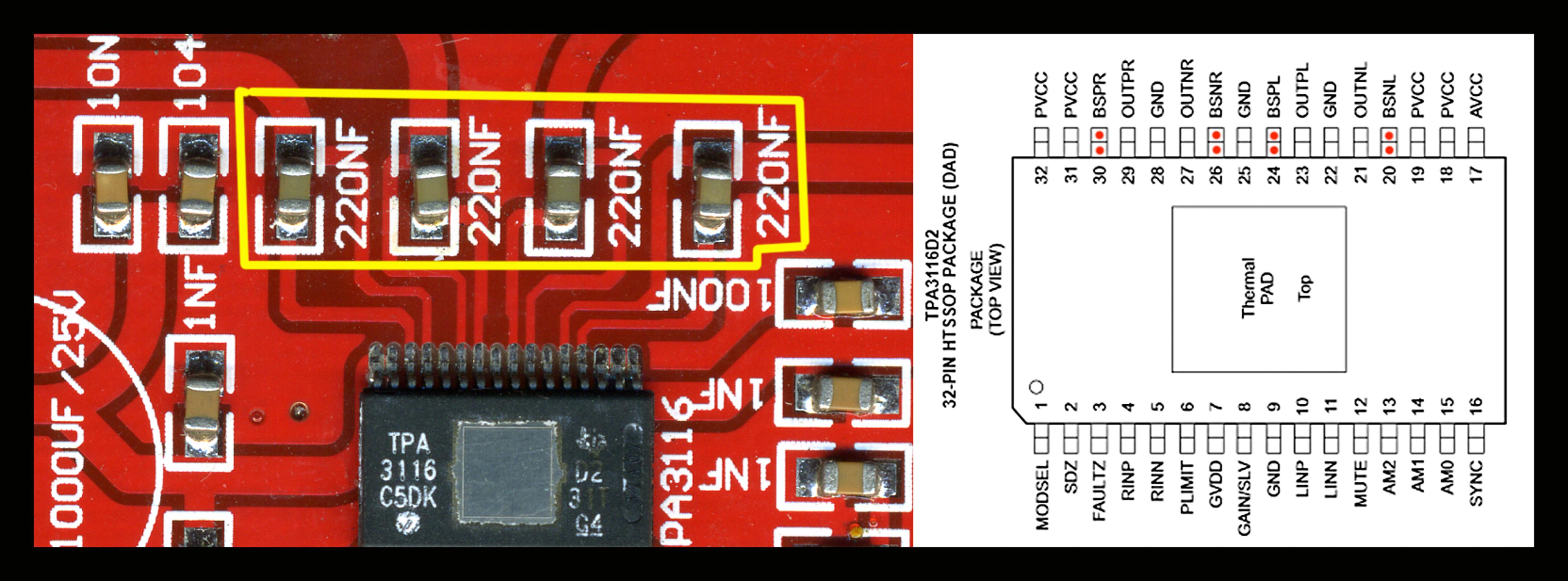

If I were to pin point a single element that by changing it could improve the vast majority of chip based class D amps, it would be the bootstrap capacitor as it's often forgotten that the output signal runs directly through it as part of the commutation current cycle of every single half cycle.
Often this is too far from the chip as maximum recommended distance is usually 5mm or less, often the value is downsized, the quality and type not considered with care, I could go on.
It should be a ceramic X7R capacitor of 10 times (or at the very minimum 4 times) the voltage rating of the amplifier to ensure frequency stability and lowest possible noise. Or alternatively a niobium oxide of 2 times the voltage rating of the amplifier for same.

What part would you recommend for replacing the stock bootstrap caps on the YJ TPA3116?
Looks like 1206 pads to me those and as far as I know 220nF 250V X7R only comes in 1210 sizes or bigger but that should be possible to squeeze in. Search digikey or your regular supplier for what is readily available of those. I have no particular preference about brand. +-10% variants are fine.

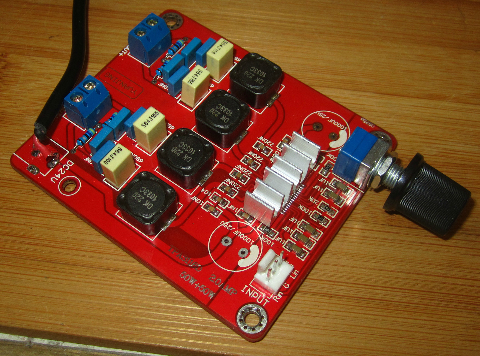

Still haven't found the time to build the boards in cases. Did anyone of you notice the fact that the thermal pad is not soldered ? Thechip relies on the heatsink it seems.

.... Did anyone of you notice the fact that the thermal pad is not soldered ? Thechip relies on the heatsink it seems....
The stock YJ 3116 2.0 board comes with a heatsink. This chip runs quite cool though and I've had one of them running for 4+ months straight (with a 21VDC supply) without a heatsink. The thermal protection has never even kicked in. While I don't recommend running one without it, I know that it's not going to immediately self destruct like many others would.

Let me second this. These chips run very, very cool.
For comparison, the HIfimediy T1 and T2 (both good sounding amps) run MUCH more warmly. I am not sure how long one would last in an enclosure even with serious ventilation.
The YJ TPA3116 occasionally becomes warm enough that you can sense that it is warmer than the ambient temperature, but not by much! I am running at a little under 20 volts.
One of mine is mounted in a miniature Lane cedar chest with just a few holes for ventilation. I can leave it on overnight and the enclosure is barely warm at all.
