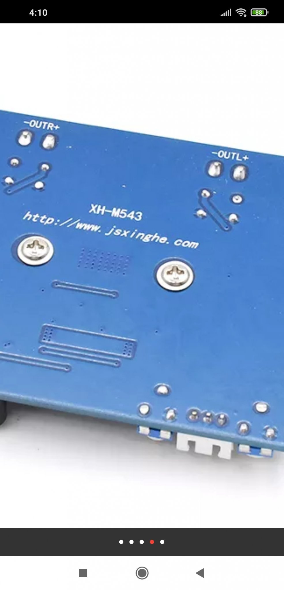

I'm seeking in Aliexpress about 2 hours trying to investigate .
I think "kaisaya" only have the real "thing" (but cost 12,98 euro) + the company on the att photo and the only way to distinguish from the fakes is that the heat sink is attached to the chip/board with 2 screws. The head of the screws are from the back side of the board.

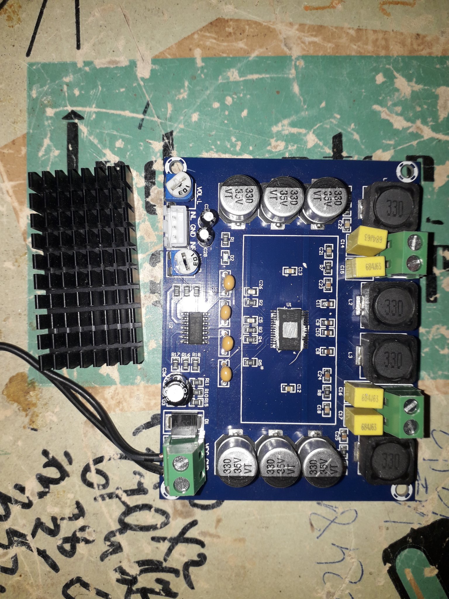

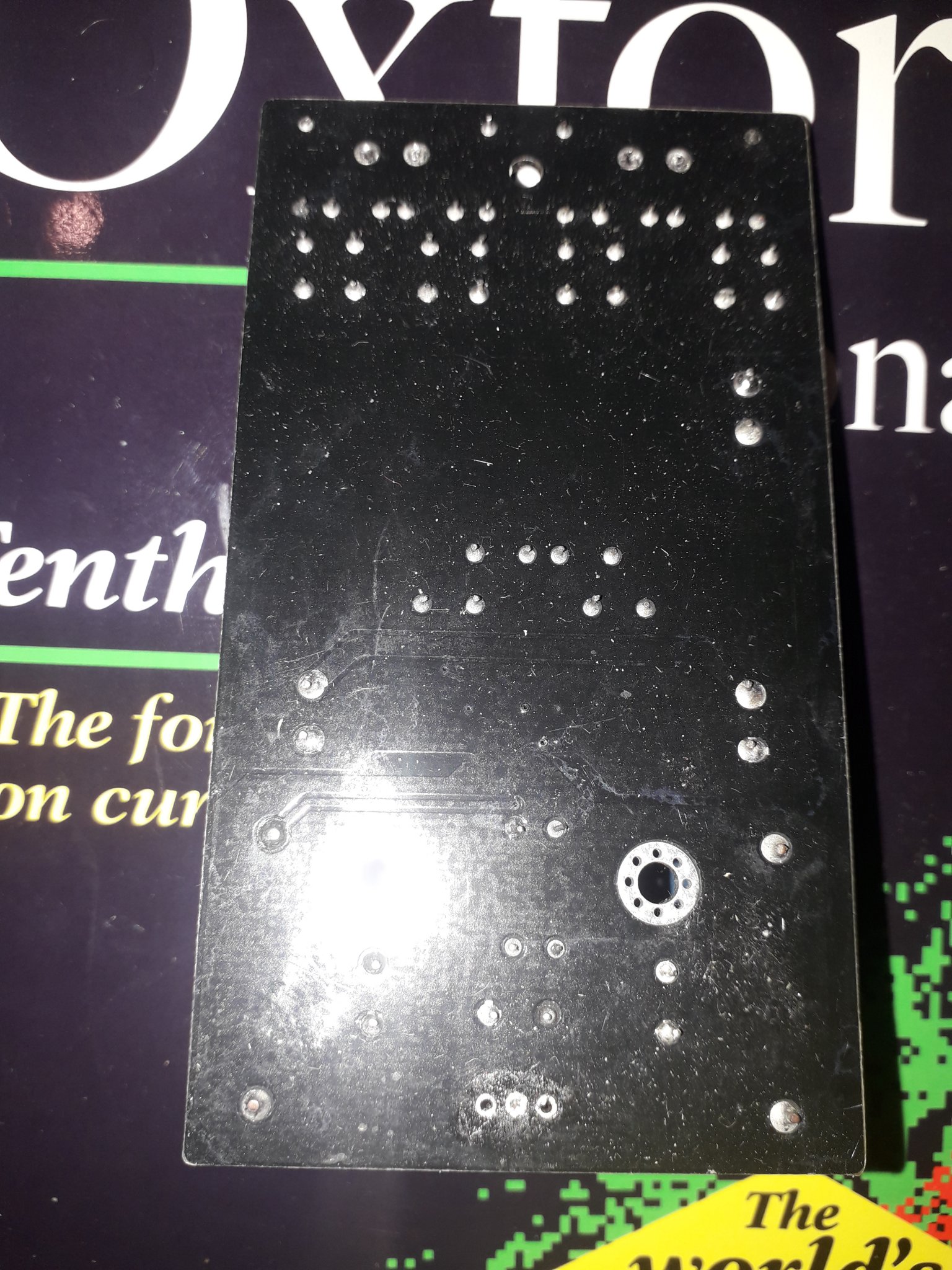

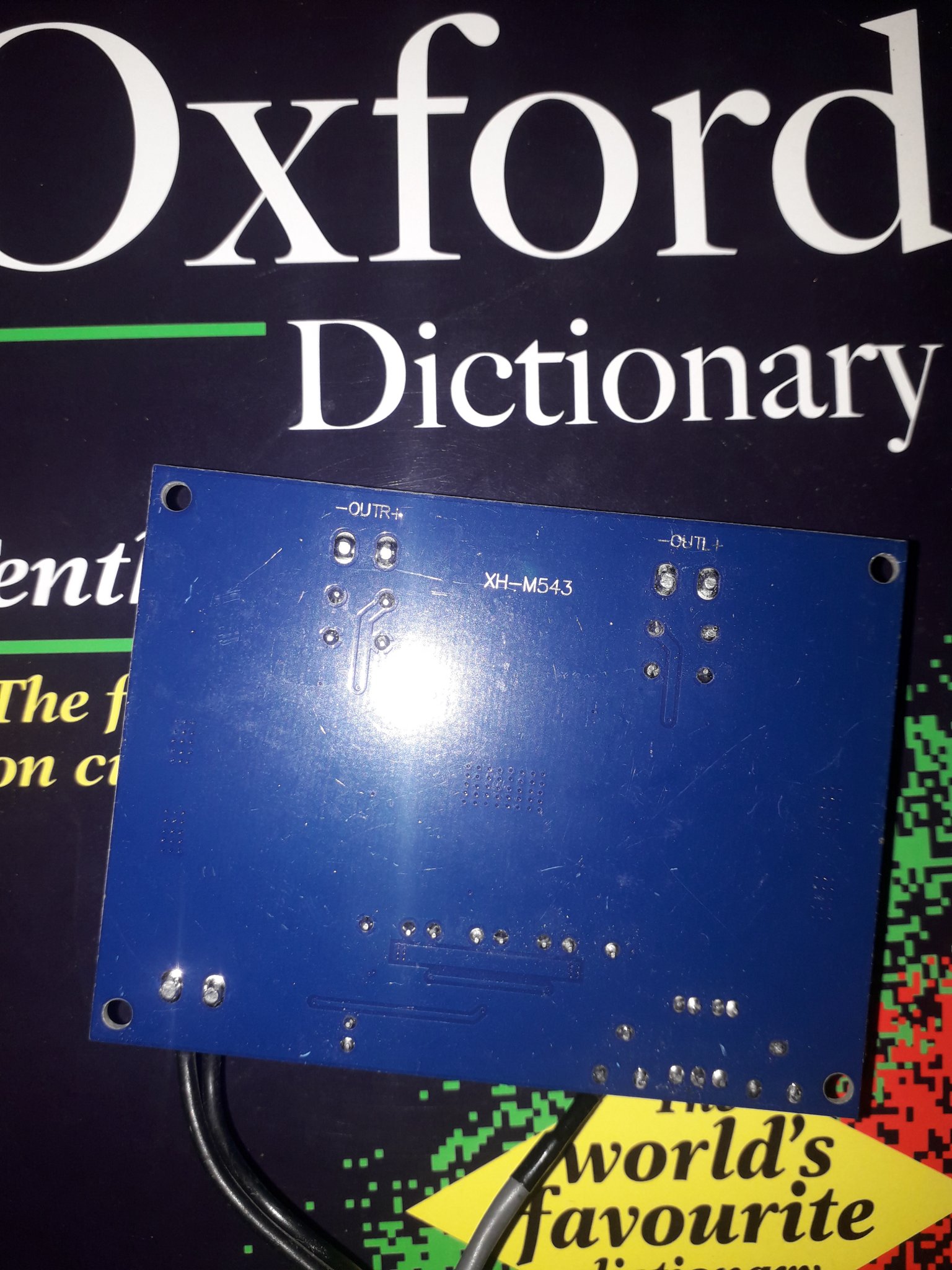

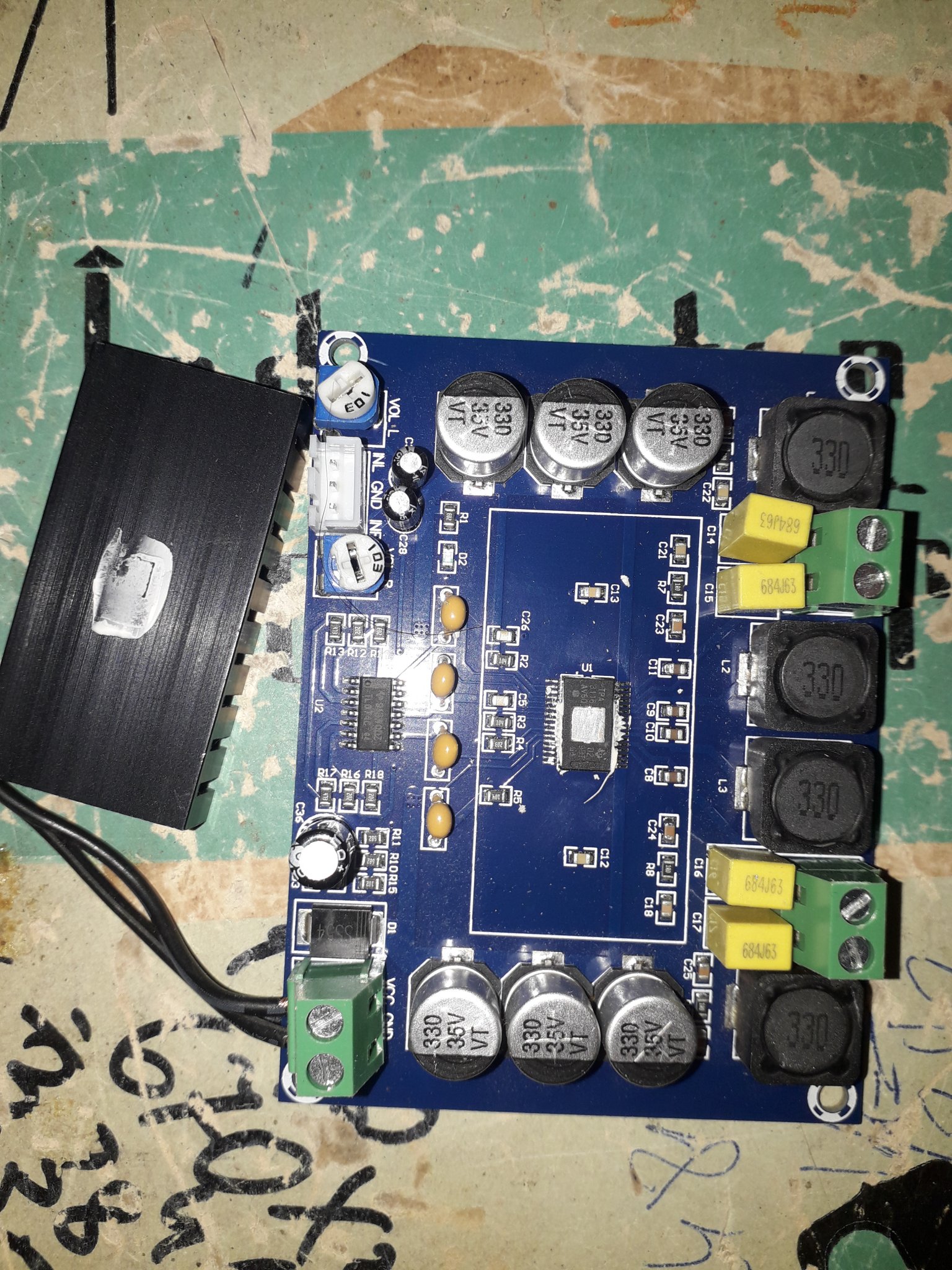

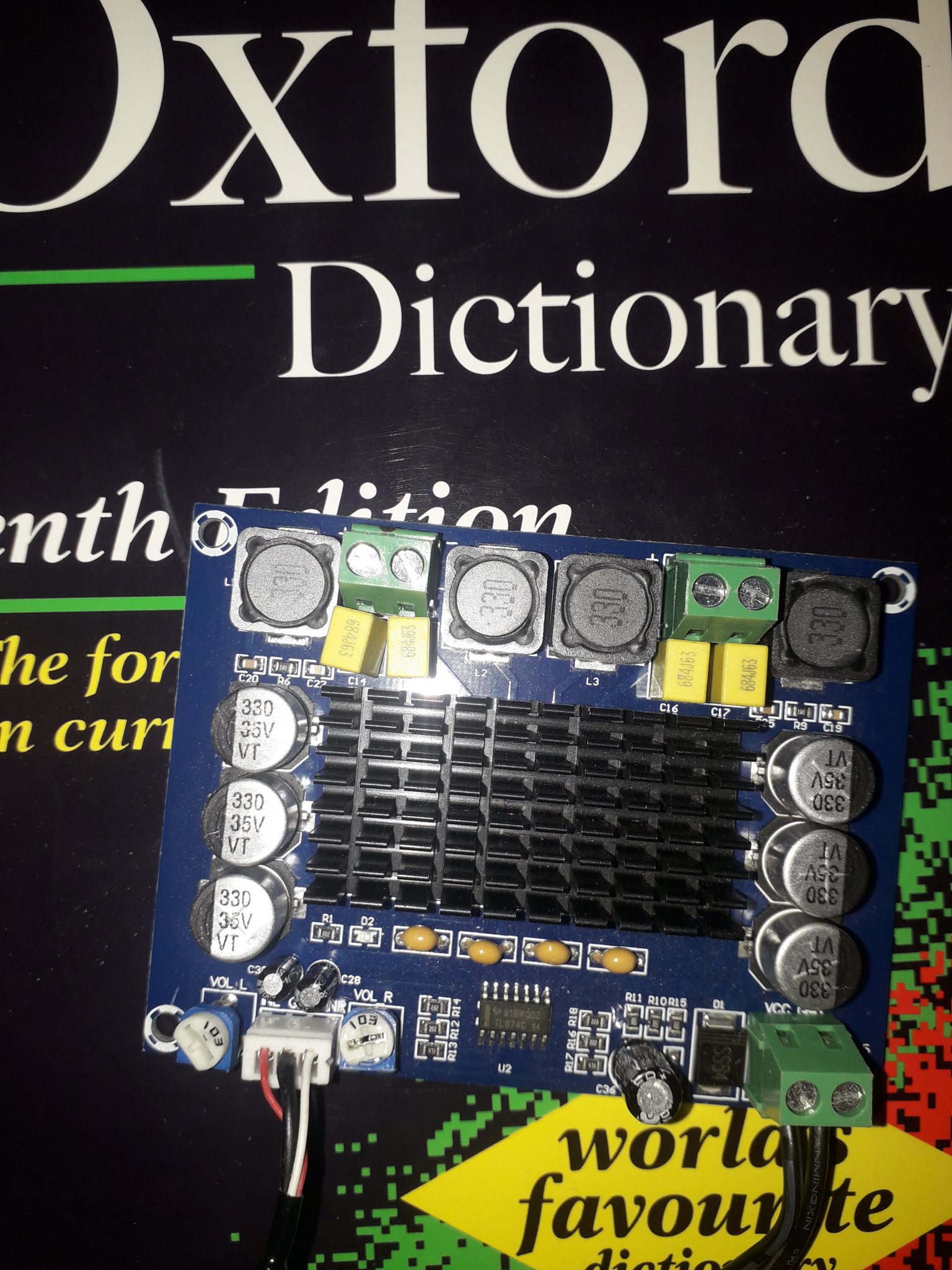

So mine's identical to the bad one...but why yours have the vias for cooling also through the pcb if it's 3116 and not 3118?
I have a true 3116 with a much smaller heatsink and you can see it has no cooling vias underneath the chip.

Apparently mine's not fake even though it has no screws.

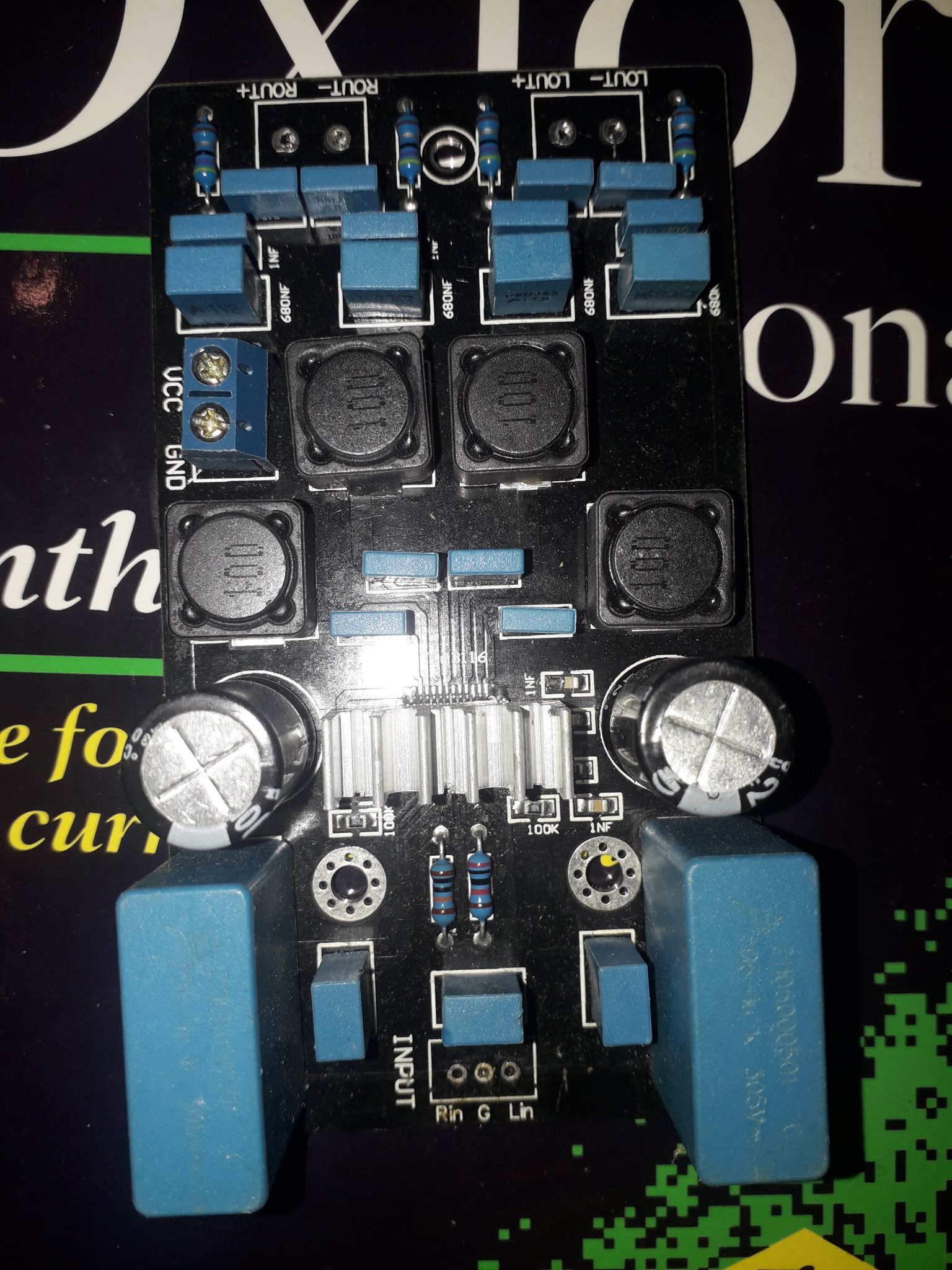

There are different configurations of output filters on those boards. Most of the time you will see 33 uH output chokes and 0.68uF capacitors, like here:
I have been measuring those and in my opinion they are only good for 8 Ohm speakers, if you need a full range amp. Because you will get a significant roll off soon after 10kHz, when using 4 Ohms. I didn`t even bother to try with 2 Ohm (and I don`t have any as they are usually subs for car stereo).
But if you need it for a sub amp it wil be OK, obviously...
Sometimes you will find 10uH and 1uF configuration:
(I have ordered 2 of these but I am still waiting for them... hopefully they will be better at 4 Ohm).
I also had version of 10uH with 0,47uF but I mistakely burned it before I had a chance to measure it :)
Factory datasheet suggests 10uH and 0.68uF (or 1uF, depending on speaker resistance).

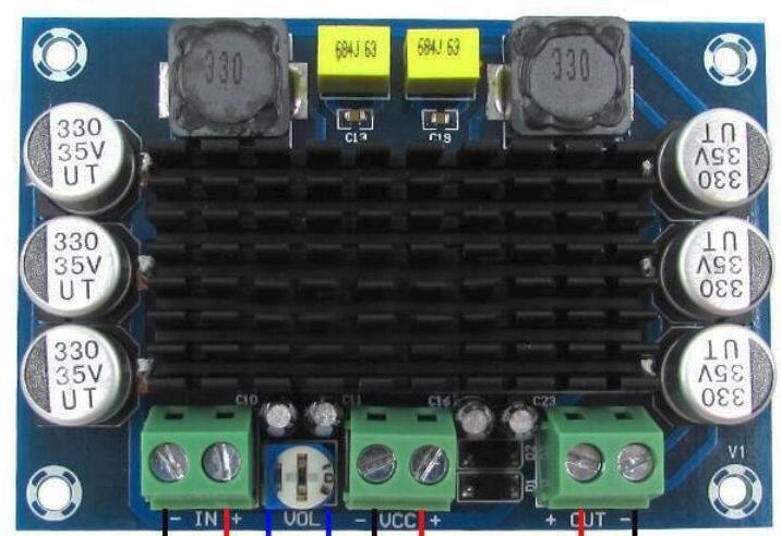

What are your opinions or experiences about that? Maybe someone can share some knowledge?
BTW, I am interested only in mono version. Since they are so dirt cheap it makes sense to me to buy 2 mono items (already bridged) and thus build a stereo amp. The power, distortion and thermal dissipation characteristics are for sure better on two mono version compared to single stereo one.

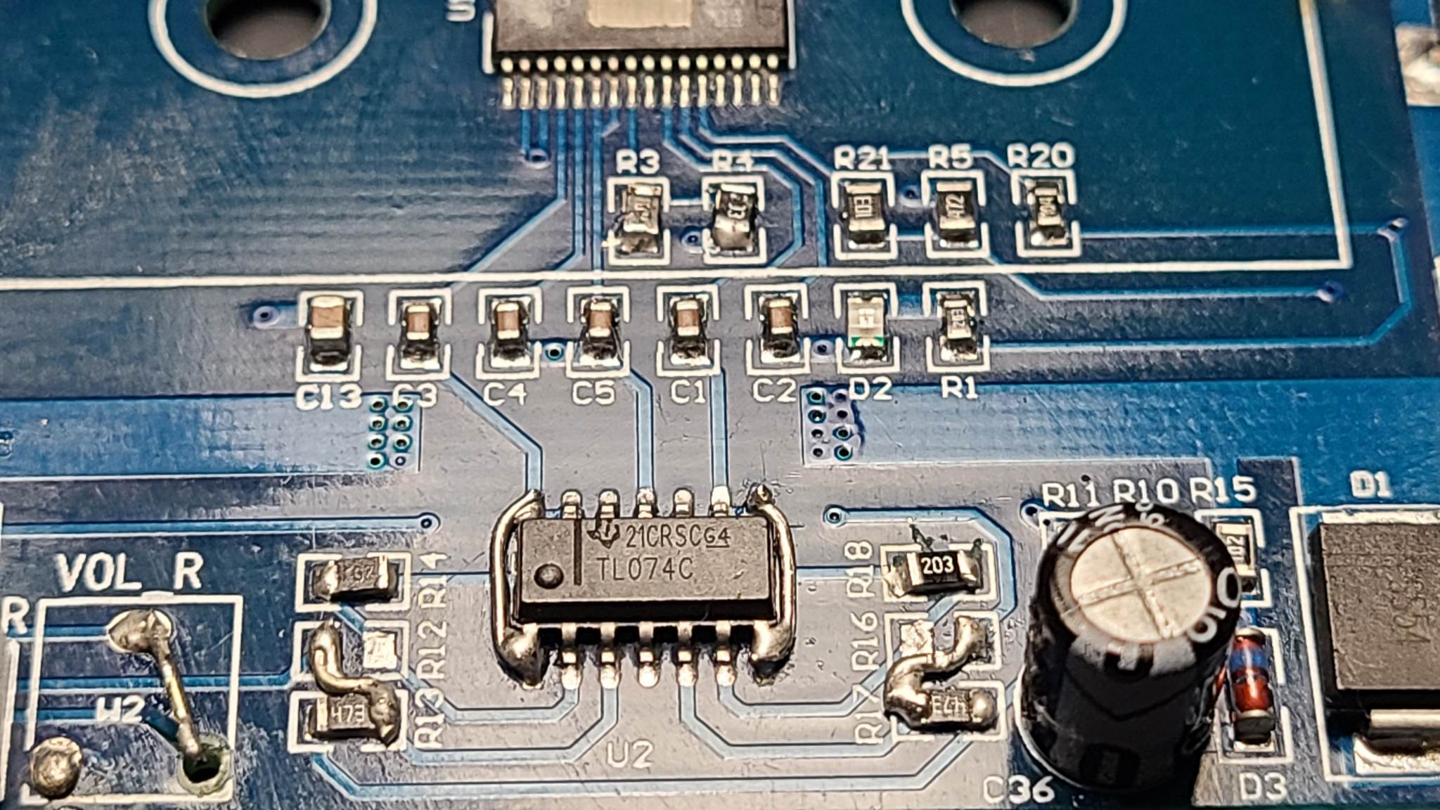

I'm trying to follow CyberPits XH-543 mod plan items 1,2,6,7.
I'm struggling to understand what is done to R14 and R18. The modified schematic says OR, and R12 and R16 say NOP, which I assume means remove them.
Also I have a dead XH-543 that had a glued down heatsink and has 4 1uF caps right infront of the tL074 chip. I was hoping there might be a 100k SMD resistor on it somewhere I can use for the R3 and there was on the R3 :D
Could anybody help me with this stuff?
0R is a convention to say that it is a zero ohm resistor (aka bypass wire). R12 and R14 are changed to be open. :)
His change just makes the first opamp a unity gain buffer and bypasses the second.
This has the advantage of buffering the input signal and giving it a very high input impedance.
In my testing I felt that the opamp was a fake on the board I was working with so I bypassed it completely. I also ended up lowering the gain down to 20db. I set them to 26db at first but found that the board still had a lot of hiss and it was much improved at the lowest 20db setting. I have a preamp in front of my board anyway so the on board preamp is not useful to me. I did increase the input decoupling cap to 2uF by stacking an additional capacitor on the positive and negative inputs (C1/C2 and C3/C4) on one baord to improve the low frequency response. I did this when I had it set to the higher gain but it is no longer necessary at the 20db setting.
I posted pictures previously on how to just bypass the on board preamp with solder balls which accompishes almost the same thing just without buffering. It is very easy and it makes this board much more like the bridged mono XH-M542 boards that have no opamps that I am using for L/R/C along with the 543 board for surround channels in my custom 5.1 receiver (5.1 decoder with preamp and amplifiers)
