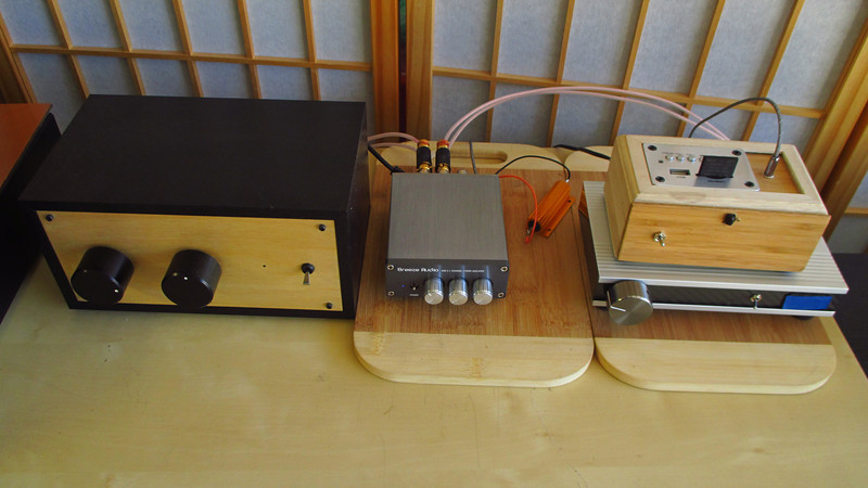

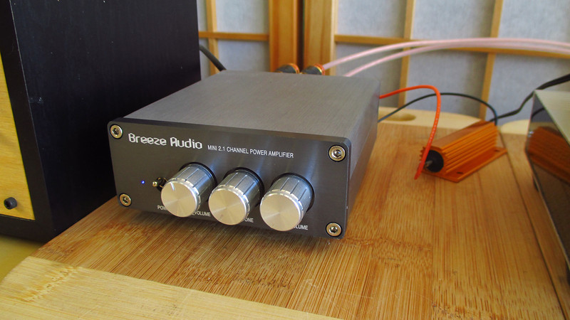

My friend brought over his recently acquired Breeze 2.1 amp using a pair of TPA3116D2.
We've been listening to it as a 2.0 for a few hours and will hook it up 2.1 shortly and let it cook for a day or two before comparing it to my modified 3116 amps.
KJA,
The Breeze amp is a very good looking package. Definitely looks different from your amps - your "bamboo chop board" series have more character though

I don't understand why they don't make enclosed versions of the 2.0. They would sell so many more. No one cares about tone controls.
I agree!! They could make this one a 2.0 and reassign the sub out RCAs for RCA input.

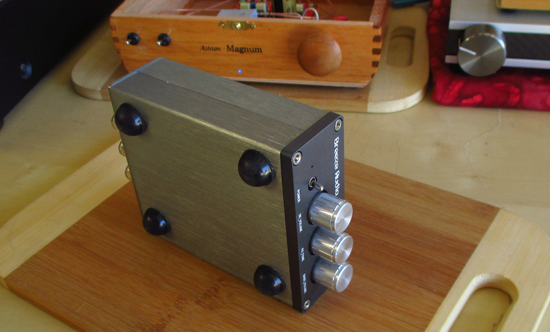

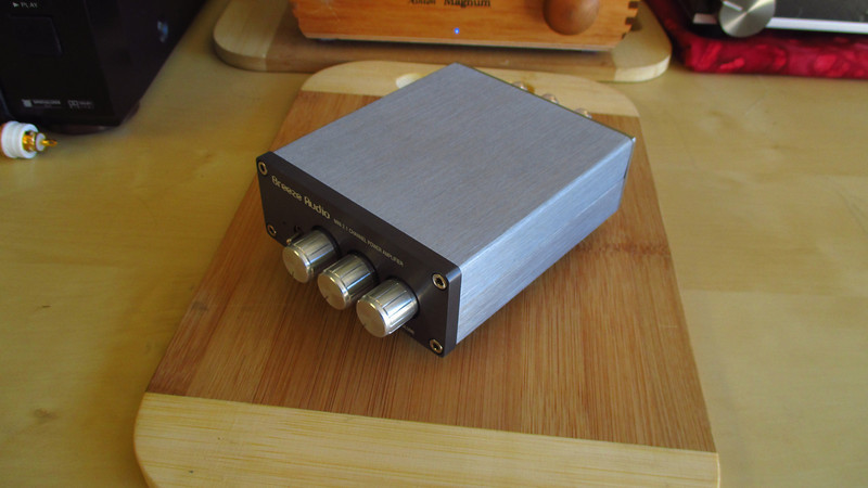

That is very cool KJA. I'll eagerly look forward to your comments. My Breeze unit just arrived in the post today. Damn this thing is small (about half the size of the already petite Dayton DTA-1. Seems nice and solid tho. Just to be clear, the Breeze does NOT have tone controls. The controls from left to right are; vol for stereo channels, sub xover from 40Hz - 500Hz, and vol control for the sub. This makes it different from the other finished units that do have tone controls. Haven't gotten a power supply for mine yet but that will be a treat for the new year.
That's true.... and this arrangement seems to work quite well too.
One odd thing I noticed is that the blue power LED is always on...even when the unit is turned off... I'll have to see why that is when I open it up.

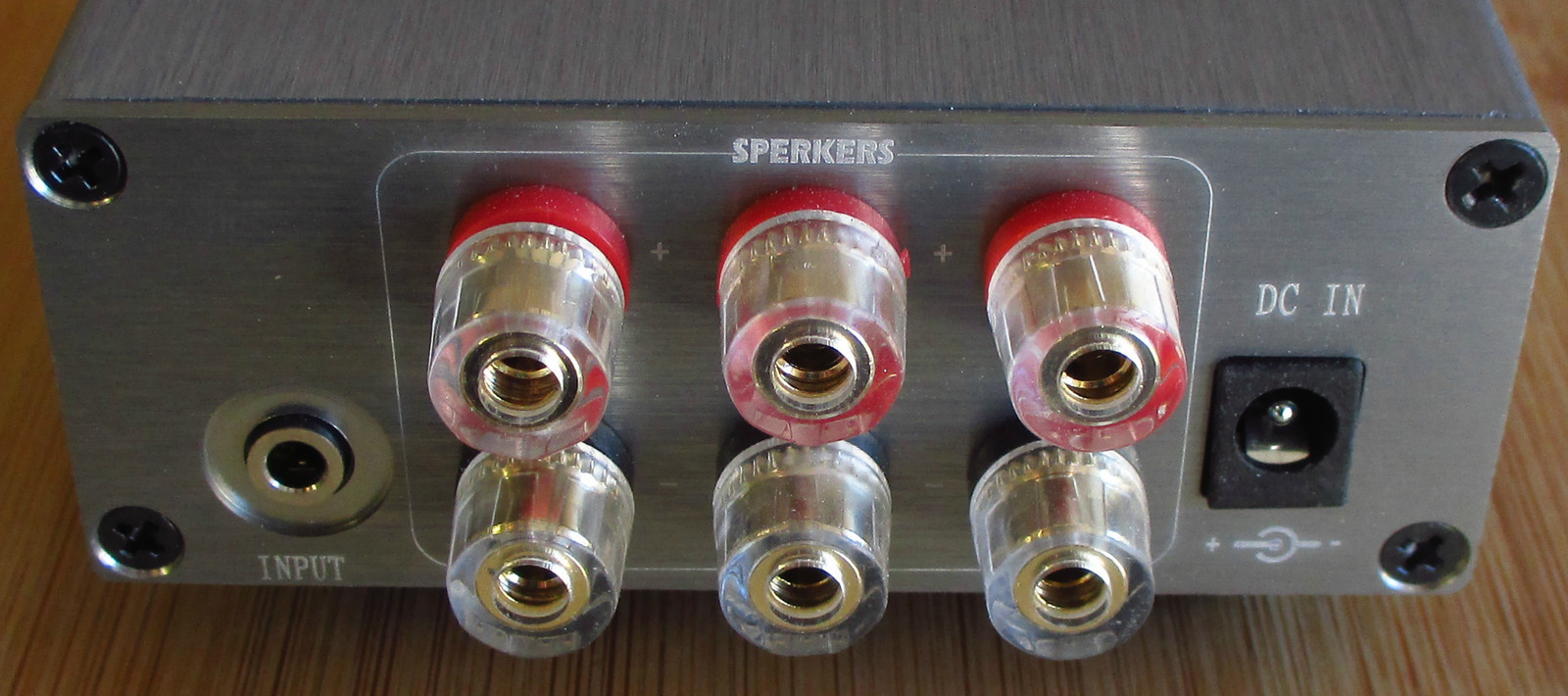

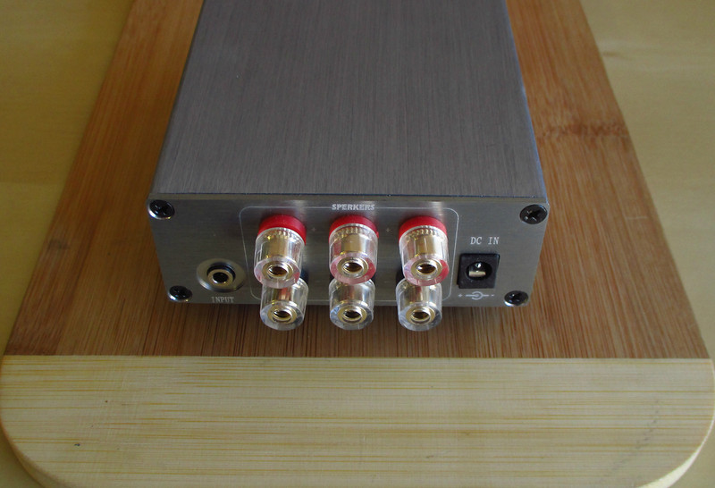

Oh, and of course the left and right channel assignments are reversed. It seems like many of these overseas manufacturers just guess at it and are content with the 50/50 odds of getting it correct... so remember to swap your left and right "SPERKERS" when hooking them up.

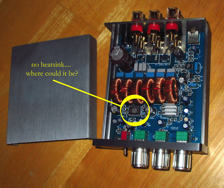

Before you power up your Breeze TPA3116 Mini Amp….
You may want to take 2 minutes to remove the topcover and look inside.

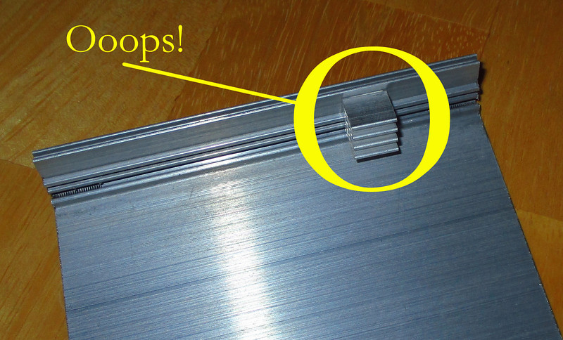

I opened her up and the first thing I noticed was that there was no heatsink on one of the chips. This didn’t bother me because I know these devices don’t get very hot and they have thermal protection built in…. but, what DID bother me was when I found the heatsink attached to the inside of the aluminum top-cover. Lucky for me the adhesive was strong enough to stick to the top cover.
Chances are you won’t hear the heatsink rattling around inside the unit since it will probably stick to something inside, but you might not be as lucky and it could be shorting something. I highly recommend that you be proactive and make sure everything is right before you power it up. You need only a #2 Phillips Screwdriver, a 2.5mm Hex Driver and a couple of minutes.
